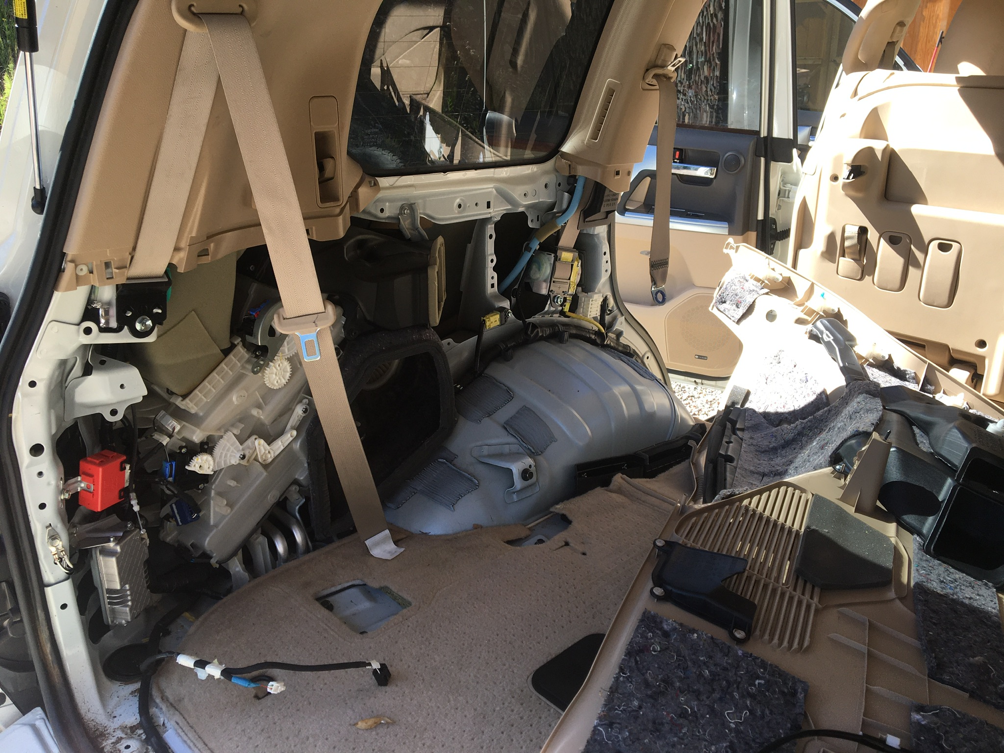

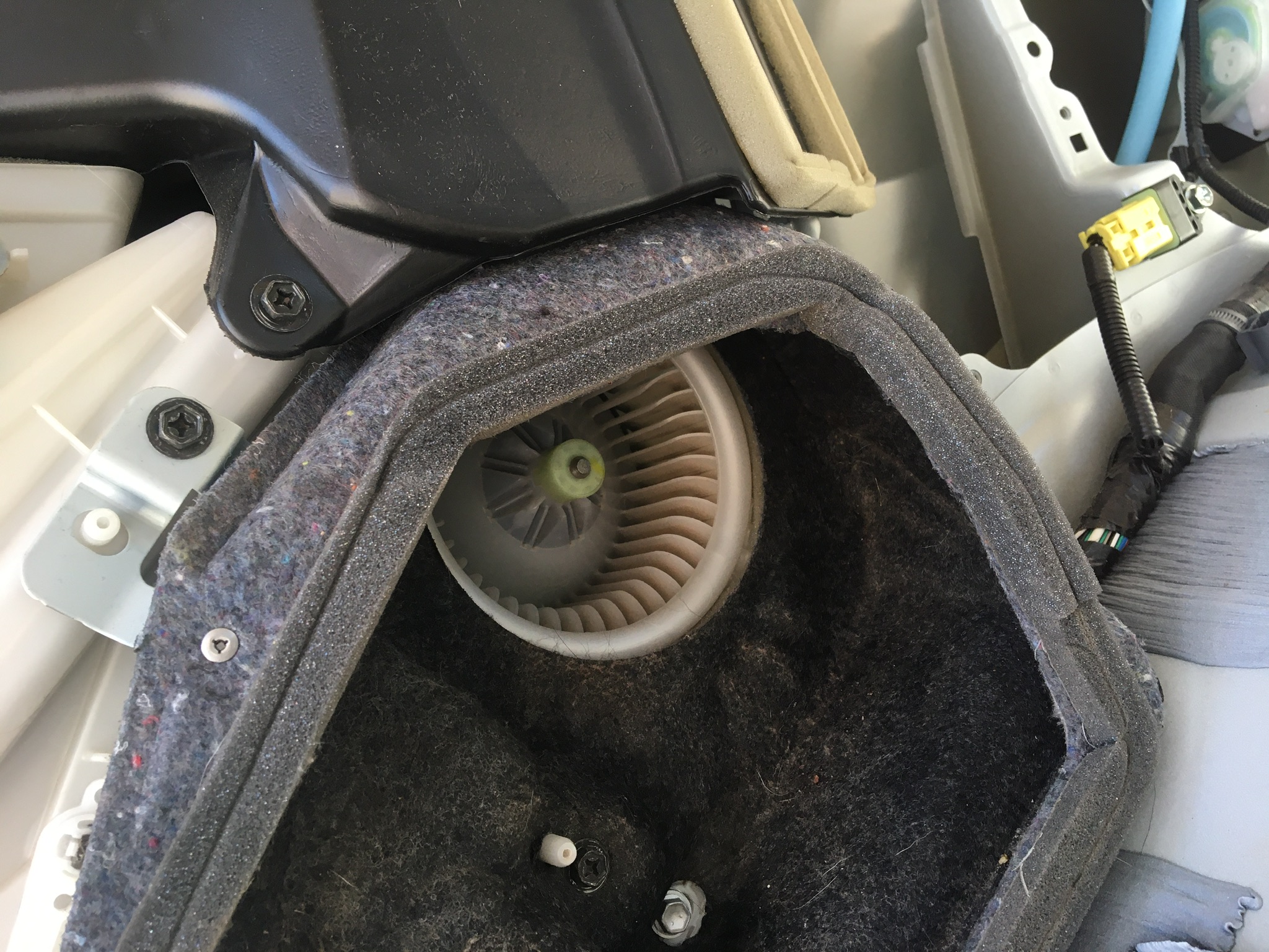

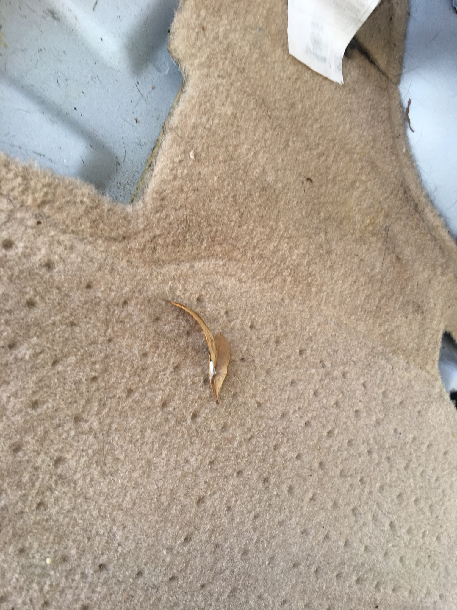

The “grille” in the trim is the air intake for the rear HVAC. Does the sound stop when the rear blower fan is turned off? Years ago I had a leaf make its way into the rear fan, causing an imbalance and made similar noise. Removed leaf and all good again.
Thanks! Very much thats the case. Seems a lot of work to get access to? // I'm going to try a vacuum from outside the grille first
If the vacuum doesn’t work the rear side trim comes off easy enough imo, a few fasteners and clips.
Edit: the third row seat on that side will need to come out if still installed.

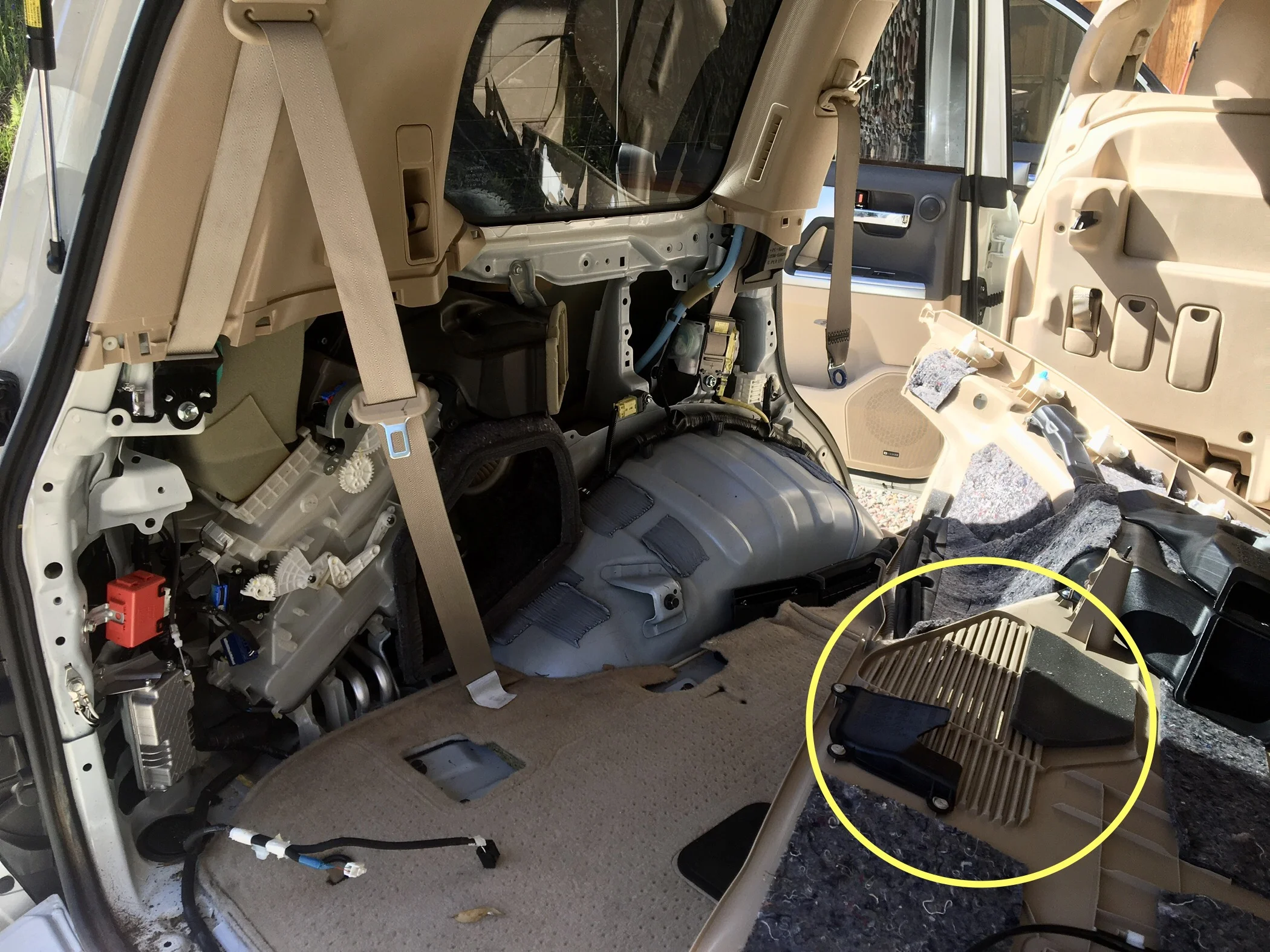

Like @bloc said, there is no filter. Though, as I understand it, the rear HVAC does not draw in fresh air from outside. Any contaminants would have to come from in the cabin through that grille in the trim. On the back of the grille, there are provisions to help keep things from being drawn into the fan(yellow circle in pic below), and the fan is mounted high in the duct. Aside from the stray leaf that made it to the fan, the intake duct was very clean.

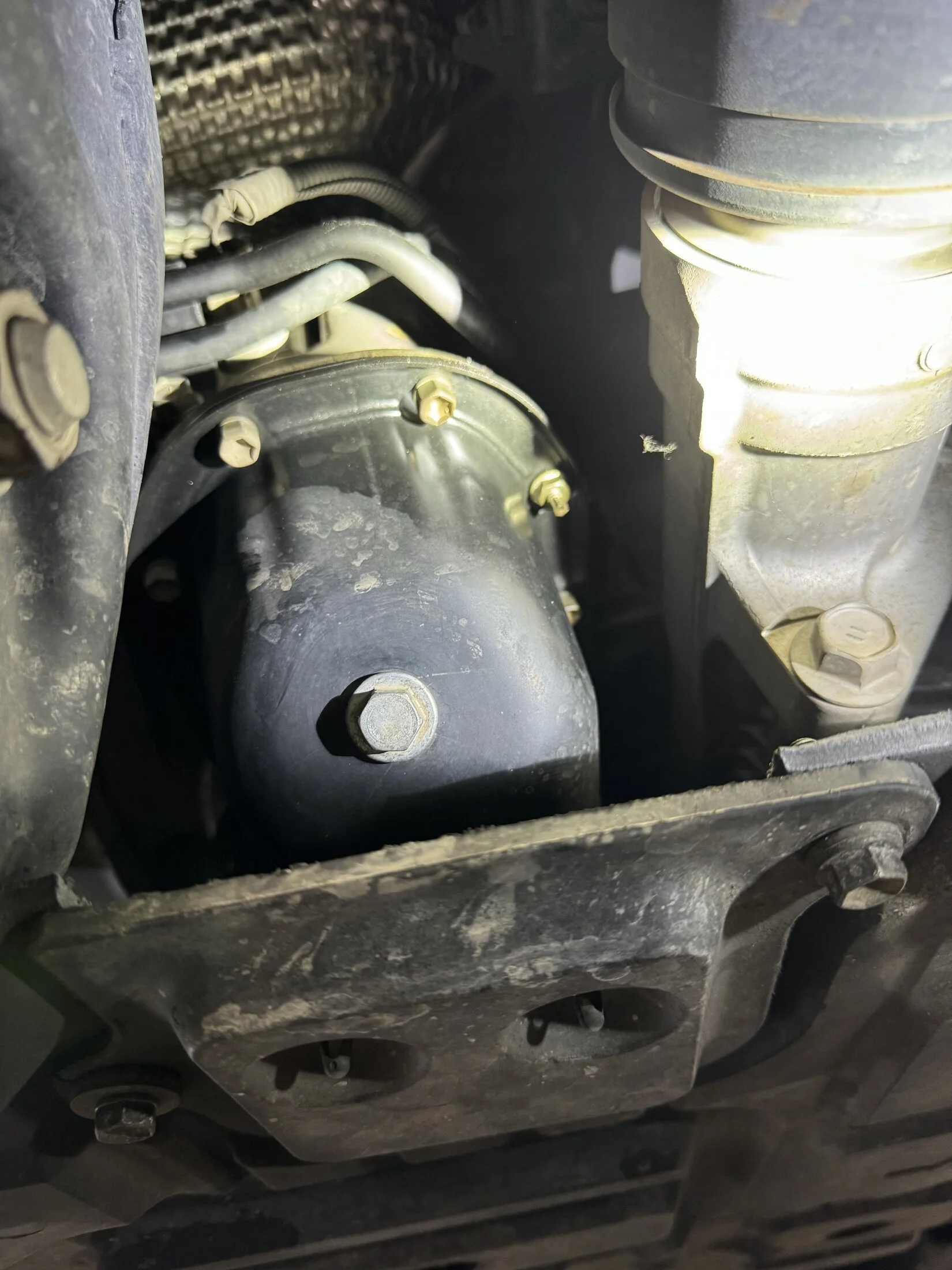

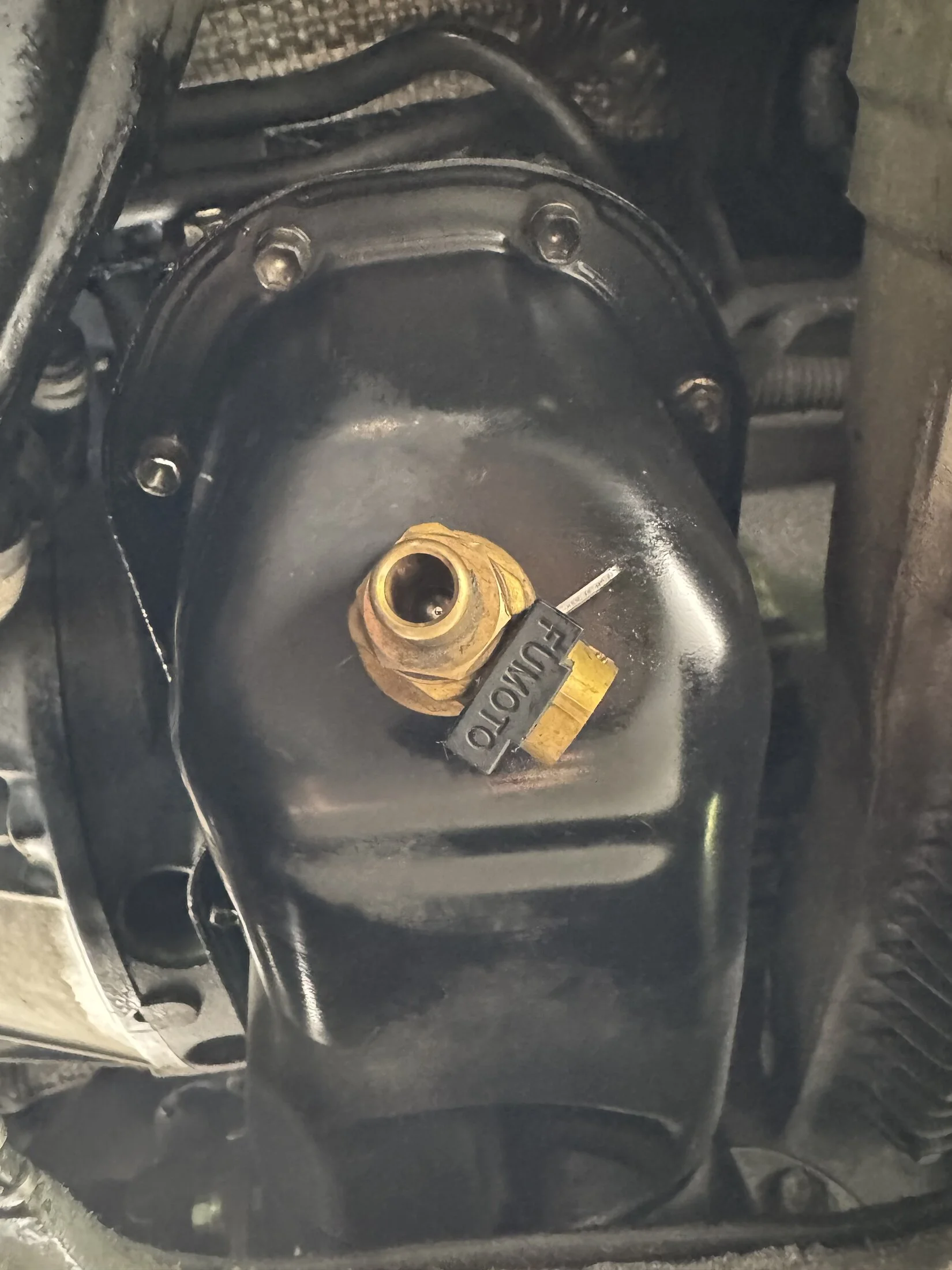

Odd observation here. I did my 200k oil change and noticed oil spotting on the driveway for the next two nights. Crawling underneath, it appears to be coming from the oil pan itself (pics below). I did barely overfill the oil.
3rd morning out and no drips on the driveway. Same dipstick reading.
I wish I had taken a pic before I wiped it. But it seems like it was coming from around the bolts where the pan mounts to the block. Maybe a gasket issue? Did my barely overfilling it cause it to leak for two nights and stop? Fumoto was fully closed and new filter and housing installed tightly before I began filling it with new oil. I don’t see how I couldn’t got a bunch of oil on the outside of the pan or on top of the skid plates. The drips for two nights were new oil, too.
Weird.
Yeah, Toyota FPIG. I had to replace mine when the Lexus dealership cross threaded my drain plug and ugga dugga'd the hell out of it.
I resealed (Toyota FIPG as mentioned) my lower oil pan because it was seeping. Pretty easy job really - just take your time cleaning things, and be careful torquing the pan bolts.
@LX Cruiser I can't see how you overfilling it had anything to do with the leak - just a coincidence IMO. Also, it would have to leak a LOT (like a whole lot....) for you to notice any change in level on the dipstick.
Dealerships, man. :bang:
Yeah, I think it's coincidence as well. Just weird that it did it for two nights only immediately following an oil change.
To me that suggests you spilled some up top and it worked its way down to the exterior of the oil pan over the course of a couple days. 🤷‍♂️
Yeah I thought the same thing at first, but nothing was wet above where the oil pan mounts to the block. I’m also extremely spill-averse when I change oil. I use a fumoto valve and another filter drain tool both with hoses straight into empty jugs, and I use the APSG funnel that screws on tightly when filling.
I’m going to order some FPIG and reseal the pan in 5k miles.

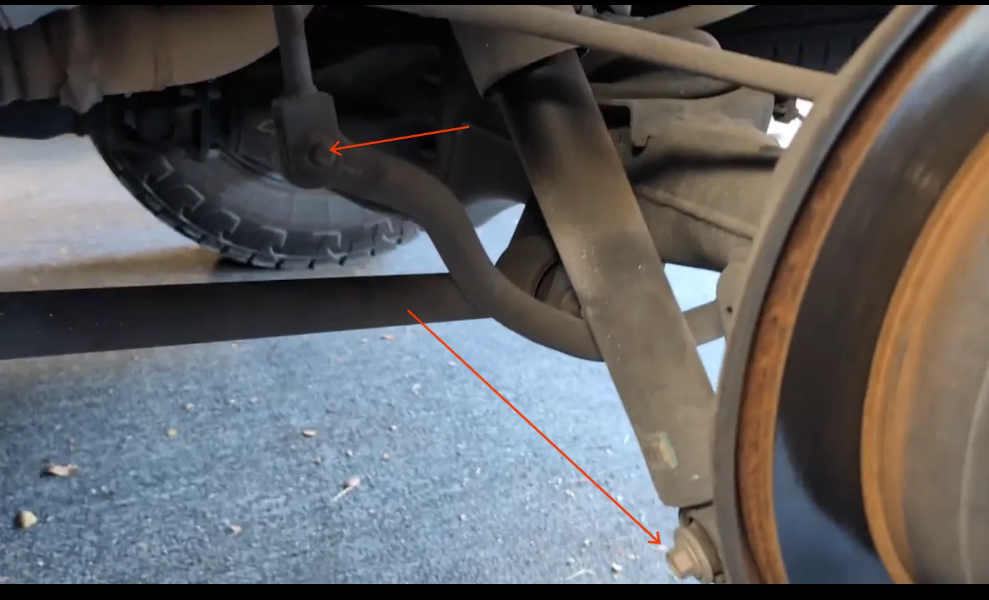

I plan to add a 20mm spacer to the rear of my 2018 Lx570, and I believe I will need to take out sway bar end link and shock, what is the torque spec for them?
And do I need alignment done afterwards?
Lower shock bolt 72 ft-lbf
Sway bar link nut 35 ft-lbf
Alignment shouldn't be necessary, but judge it on how it drives afterward.
