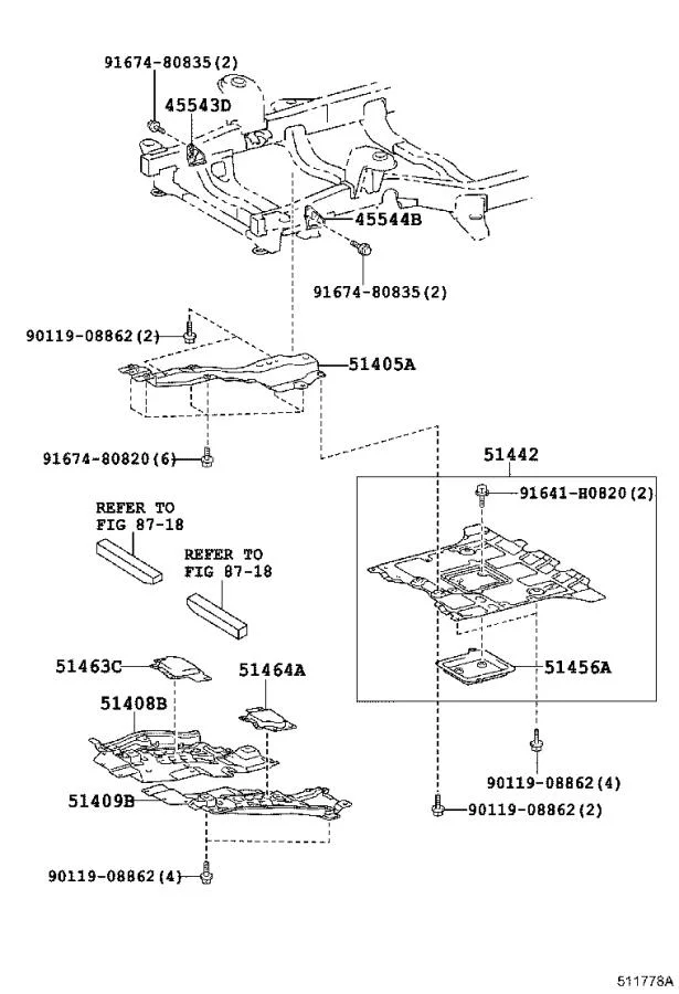

Thanks! So looking at an online parts catalog, the diagrams for the various systems don’t list the fasteners needed?
Where do people get diagrams like this?
Or to get to the point, what bolts are needed for the exhaust system? I’m going to drop the exhaust and I’m expecting it all to be badly rusted.
From the exhaust system section under tool, engine, fuel.
An online source for those is any dealer parts website.
I’ve spent a fair amount of time staring at partsouq diagrams.
thanks for that. the dealer site i was on just wasn’t giving it to me. partsouq had the diagram right away.

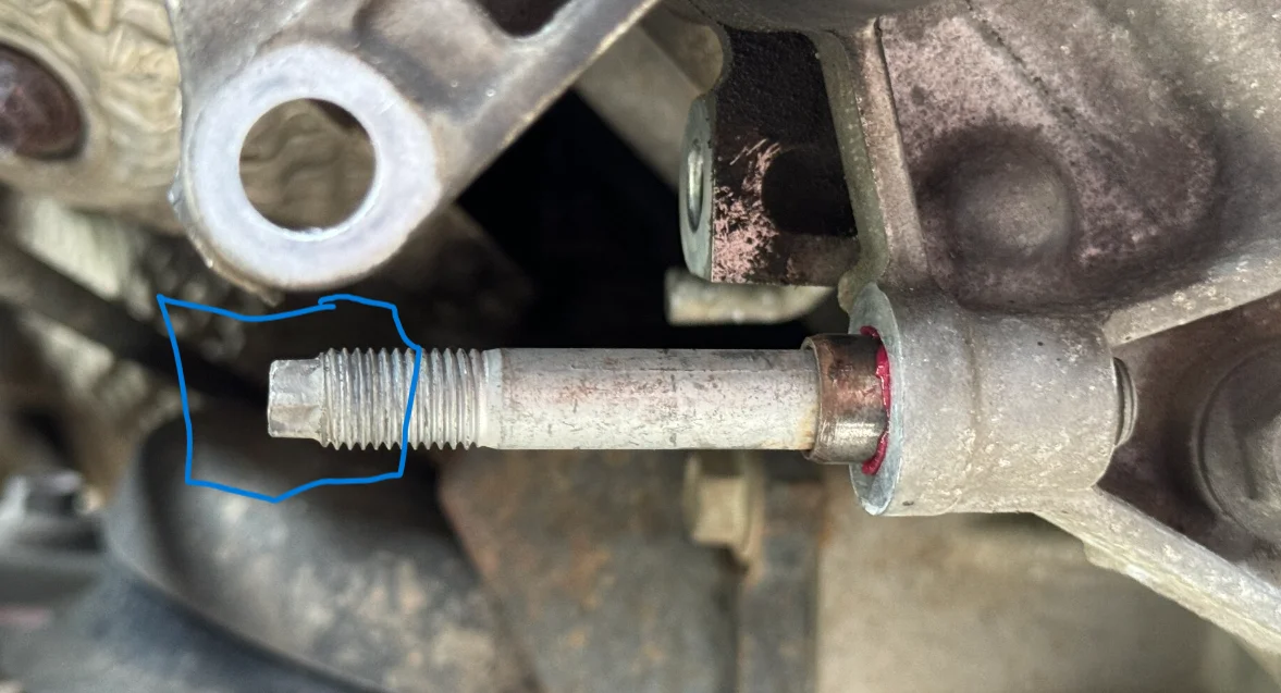

Thank you very much for the great information! Pump came out without problem this morning. What type of drive is used to remove the bolt in the attached pic.
Thank you very much for the great information! Pump came out without problem this morning. What type of drive is used to remove the bolt in the attached pic. View attachment 3964638
That is an inverted torx, sometimes called e-torx. I don’t know why it would need to come out though? Just remove the nut on the end and the alternator slides off.
If the alternator seems stuck it’s the metal sleeve to the right corroded into its spot on the alternator. I wrote about that specifically in the brush change thread.
