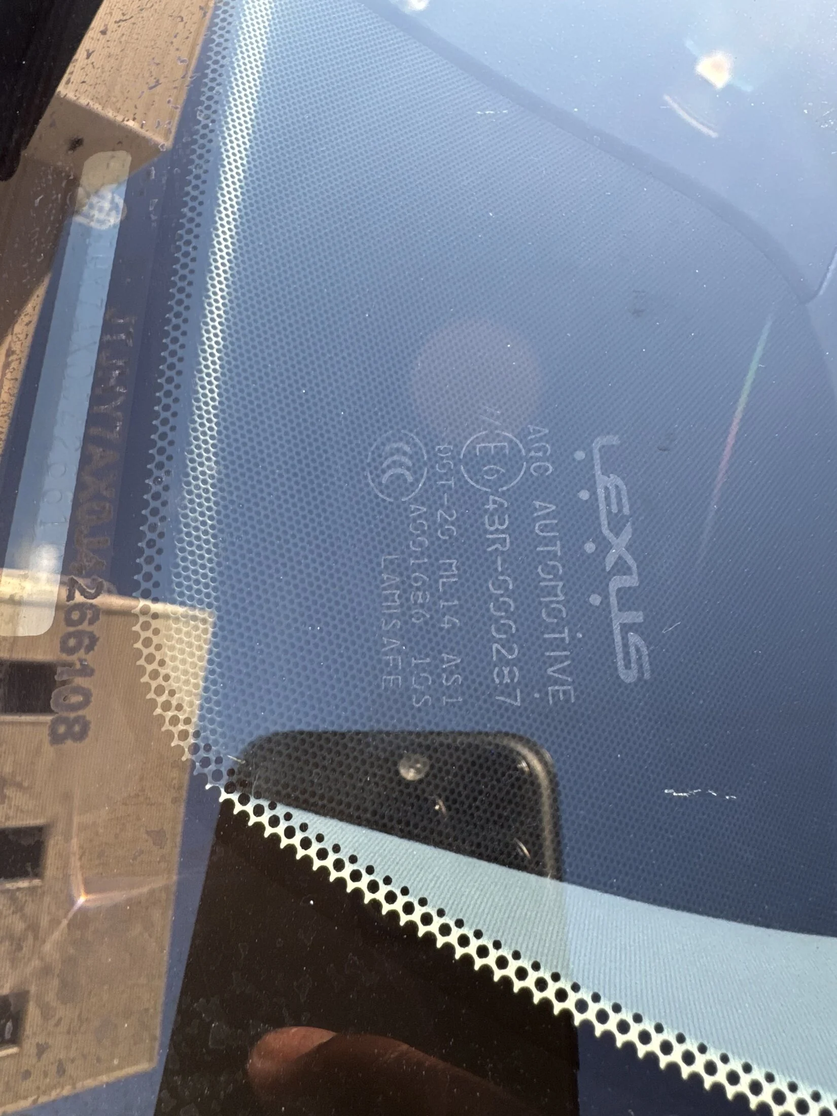

Regarding windshield leakage, does this one from an 18 look oem? I know it says Lexus, but wanted to ask anyway.

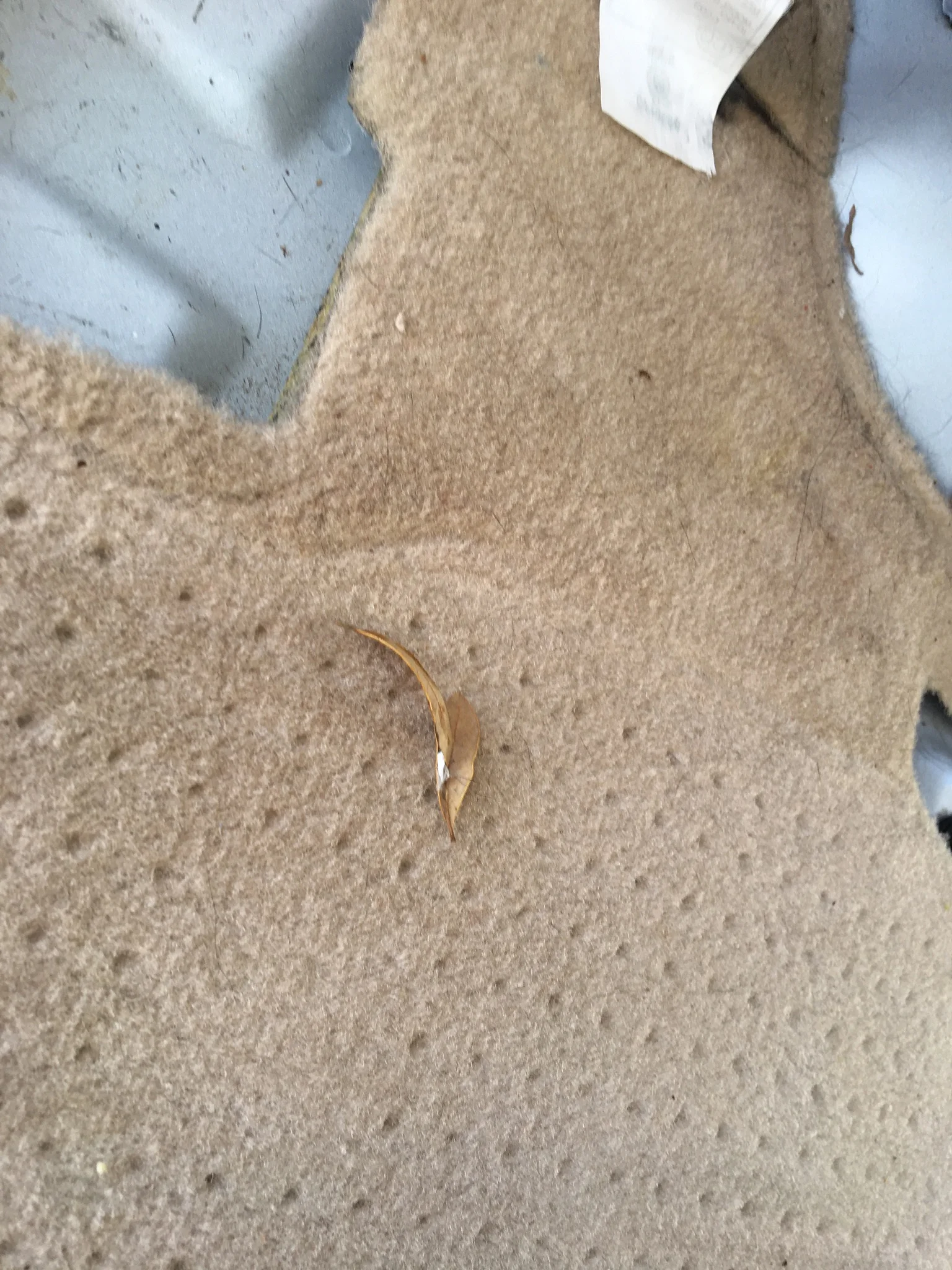

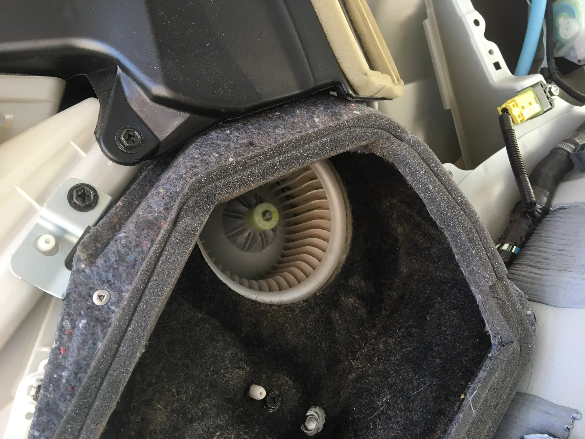

What’s going on with this new sound from driver side third row? Noticeably loud and distracting
The “grille” in the trim is the air intake for the rear HVAC. Does the sound stop when the rear blower fan is turned off? Years ago I had a leaf make its way into the rear fan, causing an imbalance and made similar noise. Removed leaf and all good again.
