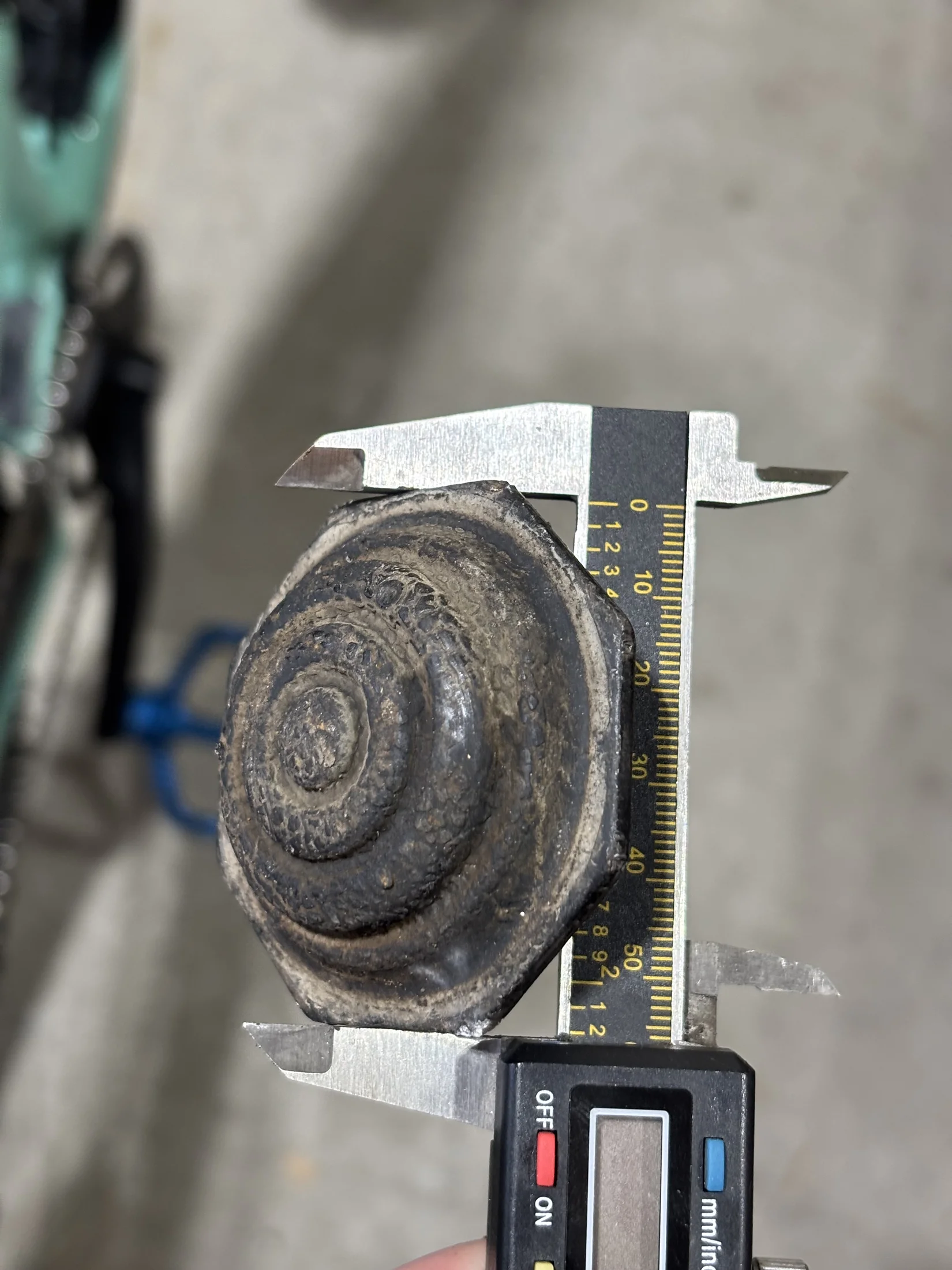

Is the front bump stop hex head M36 on 2018 LX? Having a hard time with a plumber wrench and gave up
It’s 8 sided so you could just use your plumbers wrench to break it off the rusted threads, then drop the LCA and drill out the stud, re-tap the hole and then put your aftermarket bump stop in like I did.
Here’s an actual measurement:
56-57mm? Maybe a big 12 point socket would work

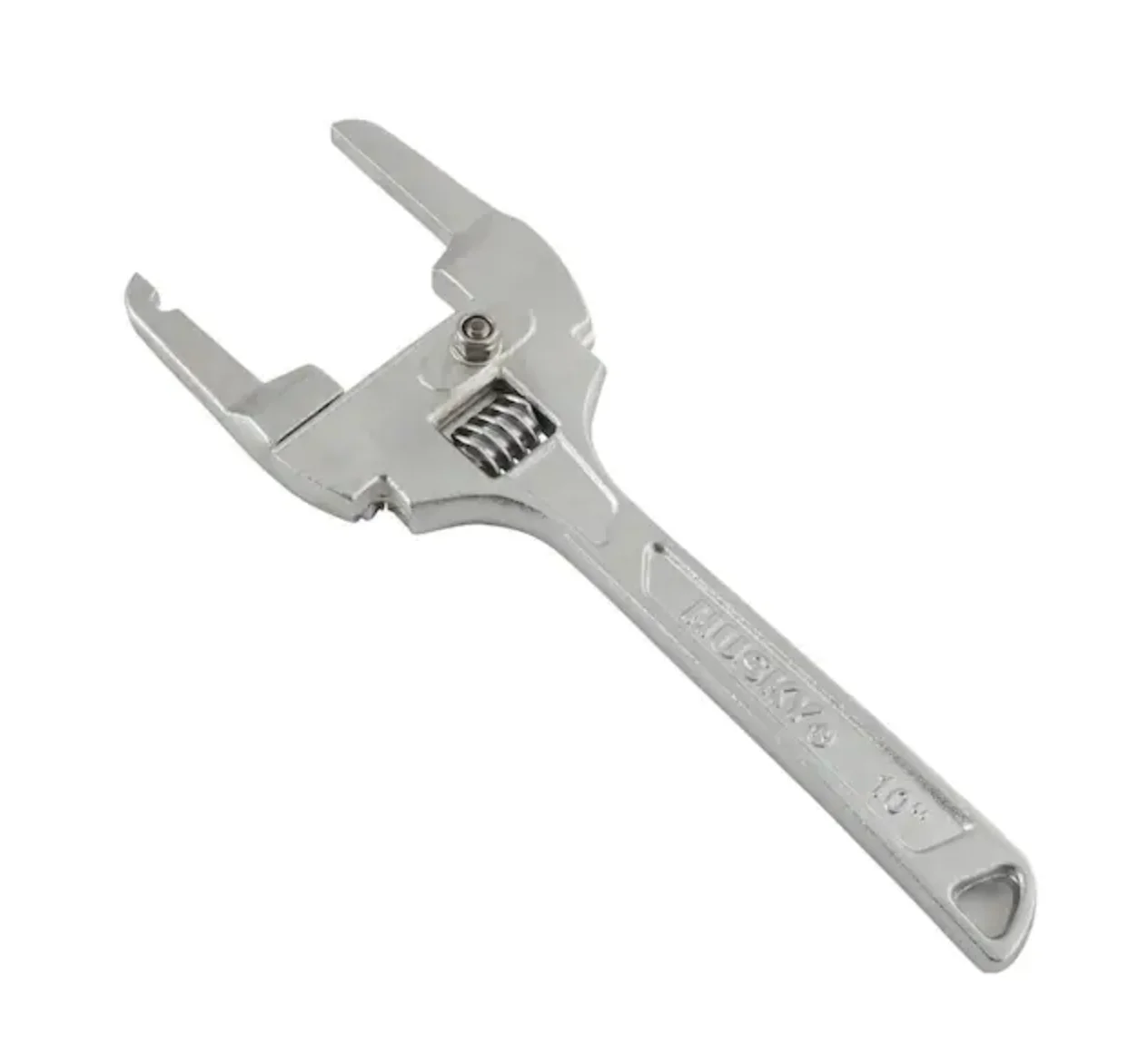

are there better plumber wrench? I have something like below, the grip is not great and doesnt offer much leverage, the bolt is just not budging
I’d hit the back side with a generous amount of penetrating fluid (there should be a hole in the LCA in the top to spray into) a day before you try cracking it free. I used a regular pipe wrench (monkey wrench) and got one side free but broke the stud on the other side.
It’s only an m8 thread so it shouldn’t be super tight but more likely rusted in place. Just be prepared to have it break. Of course, you’re in CA so you might have better luck.
Need something more like this. Maybe a 24” version.
