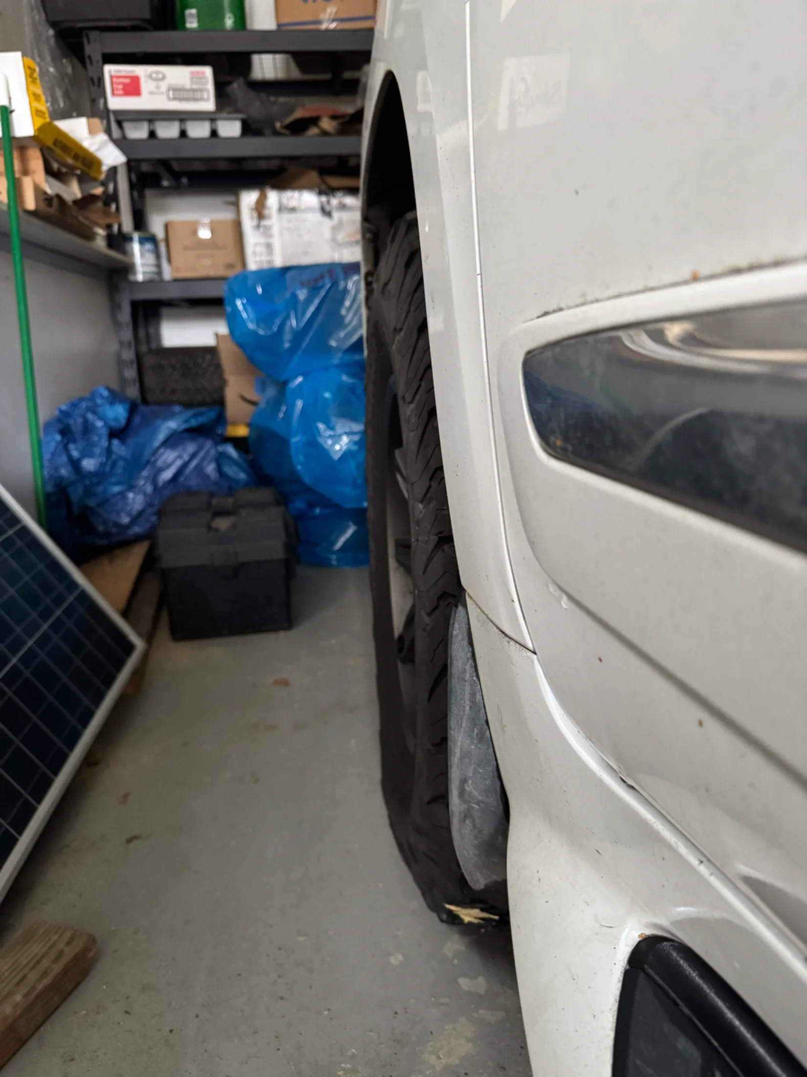

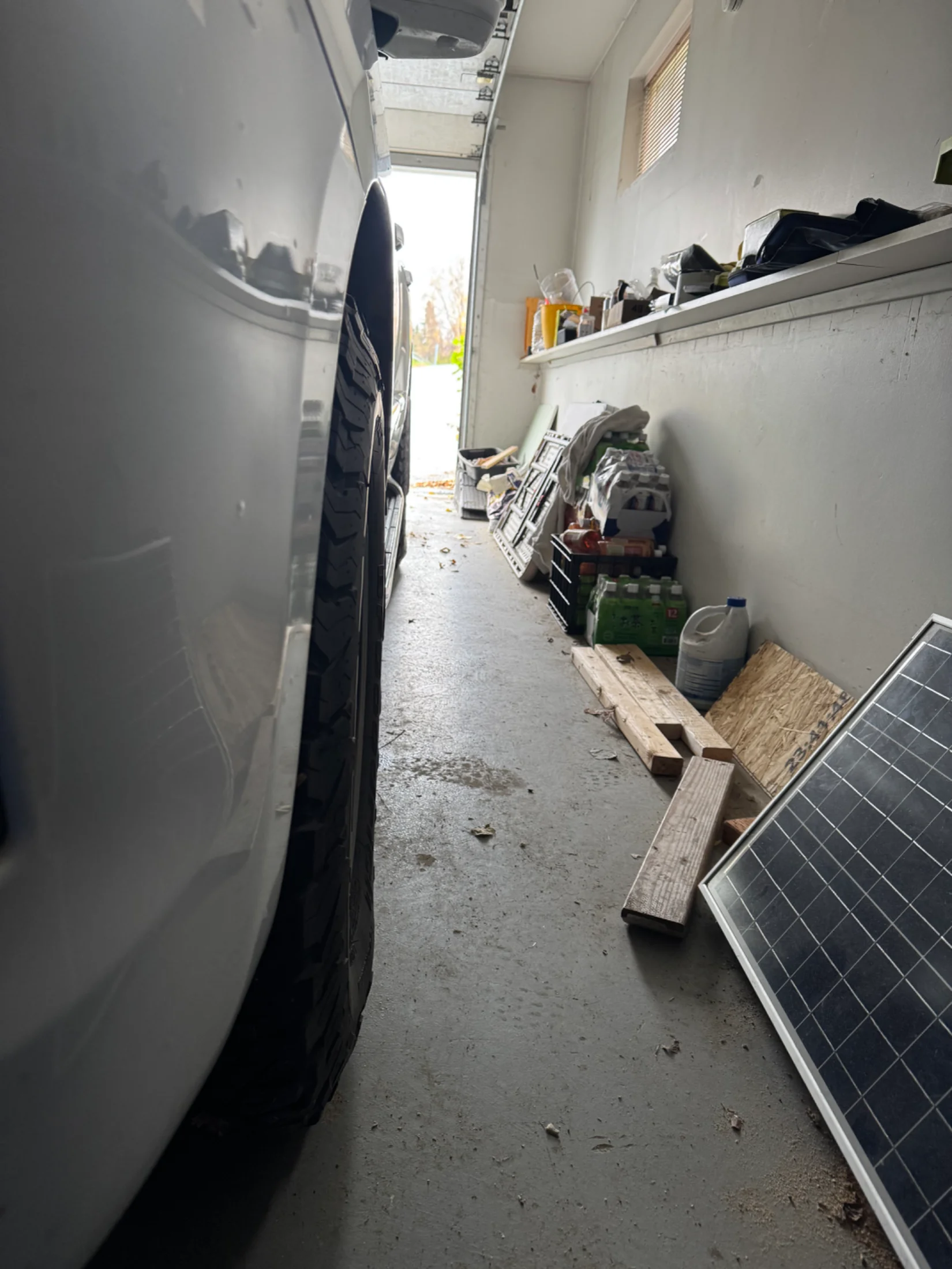

I have +35 and wish I had more + offset as my paint gets trashed from tire sling when I off road (often) and winter roads. But I’m running 17’s in the summer, so the only OEM option is RWs and those things have pretty much turned unobtainable.

Most people don’t do a few thousand miles a year off road like I do. No spacers. The outside of the tire is defiantly outside the wheel well

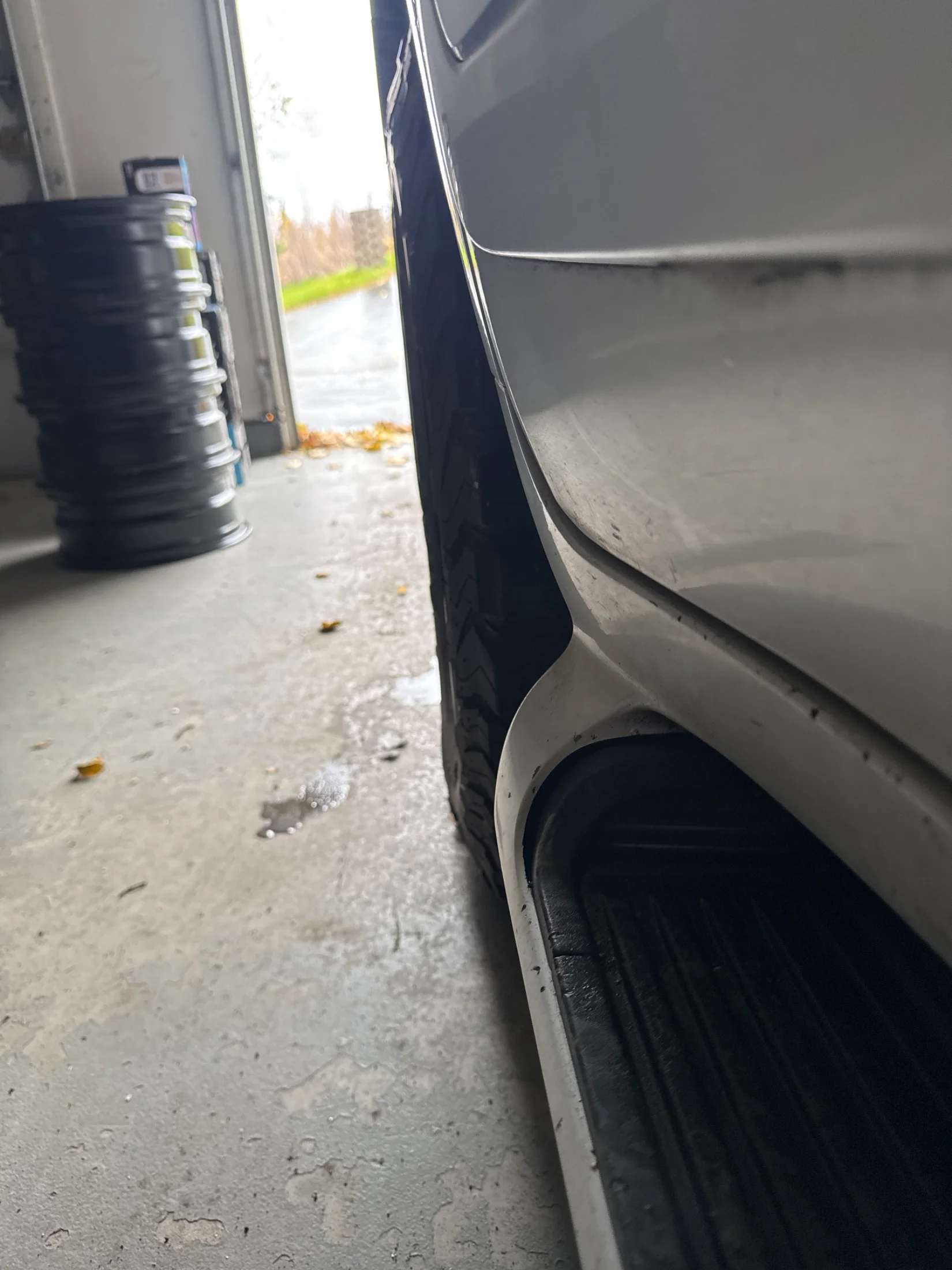

Thanks for photos. +35 you’re basically going out an inch from oem and with sidewall tread yeah. This is good info!
For completeness, I switched to my winter tires last week. Tundra take offs with OEM offset. Tire is inside the wheel well and mud flap.
