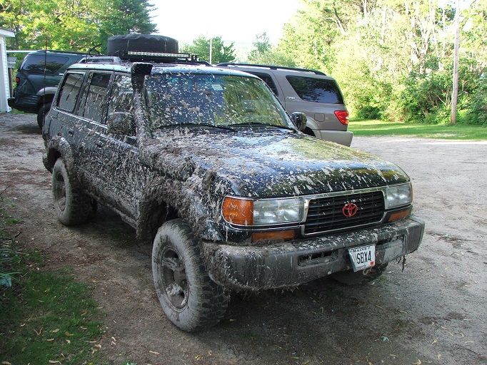

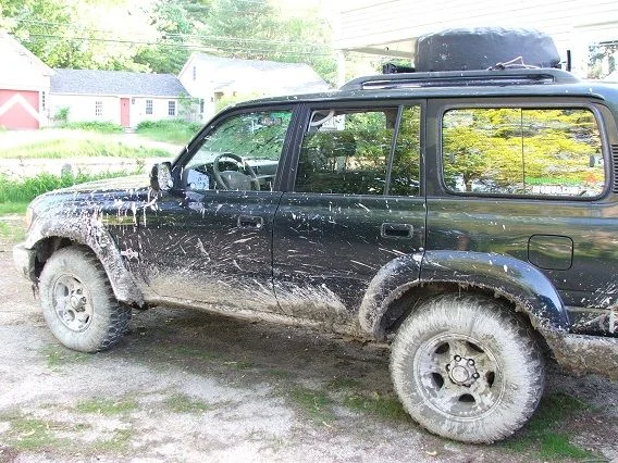

This one is set up with one inch (30 mm) spacers on the factory springs. 265 tires, or about 32". I added air bags to the rear after this pic was taken, but only really use them when loaded or towing. Goes pretty good too!
