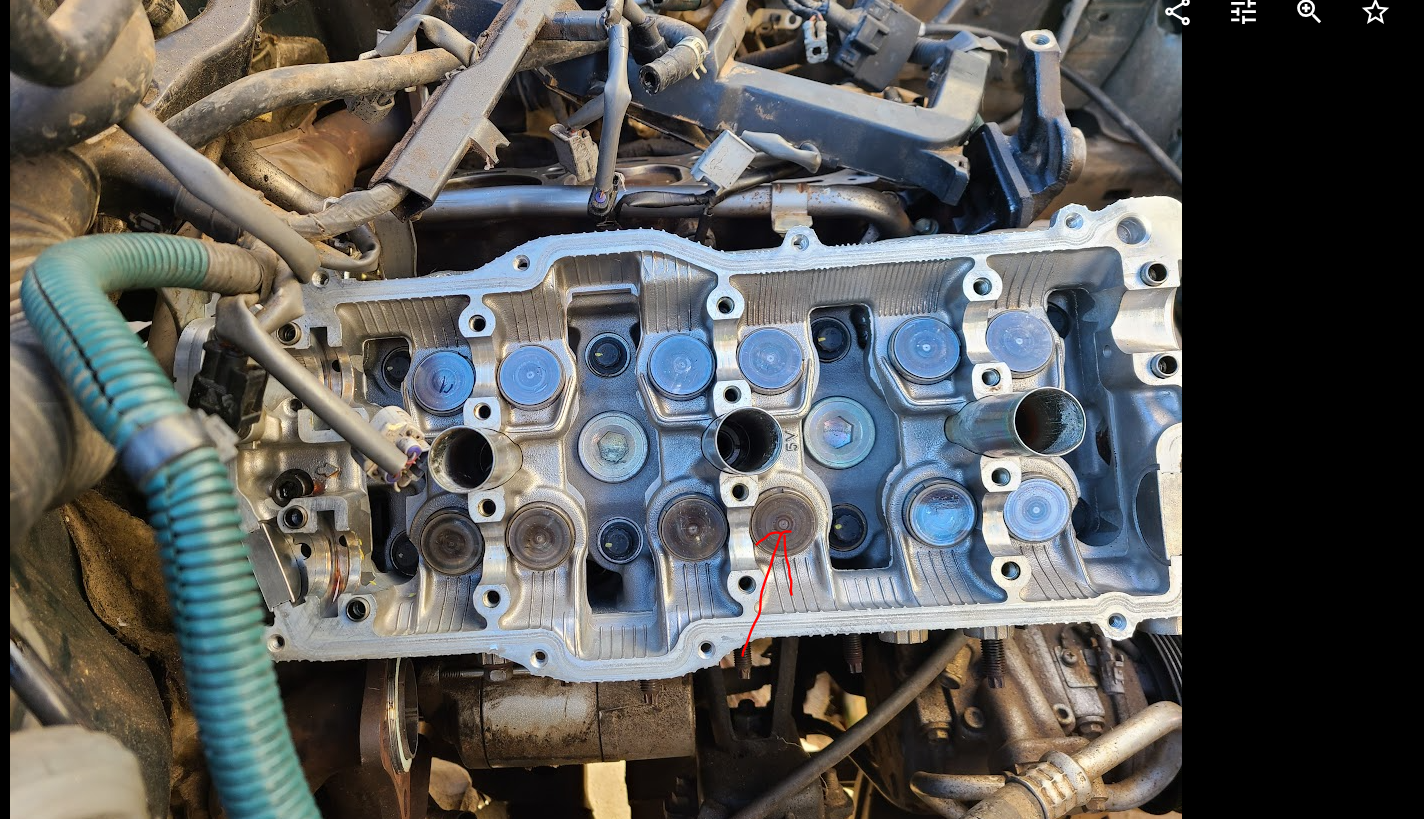

I'd remove the valve cover then have a close look at everything. This is an overhead camshaft engine so the camshafts ride on top of "valve shims" as shown by the arrow below. You might have a ticking sound from excessive clearances here. Go under the resource tab and download the appropriate page of the FSM (factory shop manual) and study it. I'd pick up a set of feeler gauge then check the clearances per FSM. It goes w/o saying, always check vids of this process on YT to get more familiar.

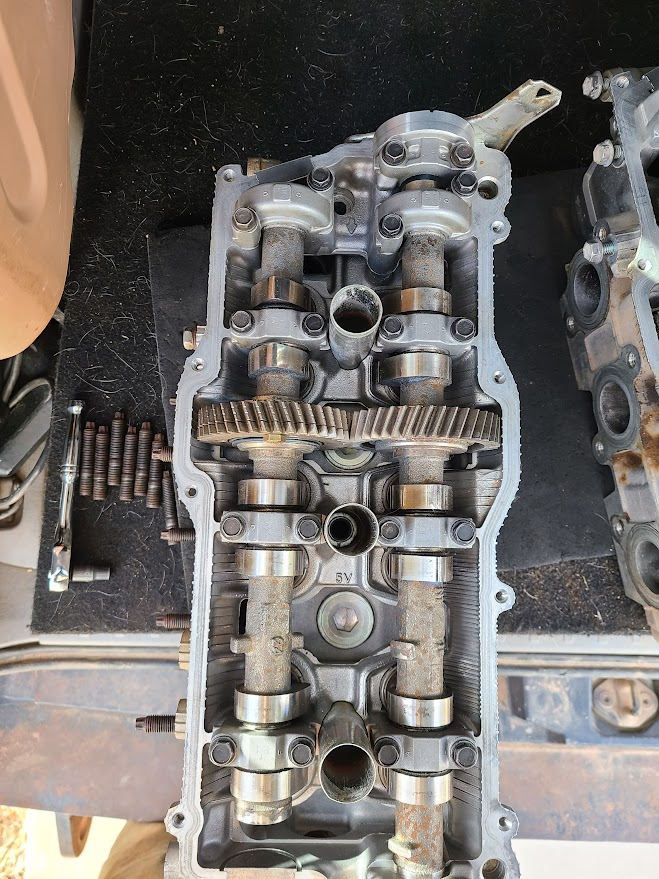

These pics are from my daughter's V6 engine but the same concept as our engines.
View attachment 3832489View attachment 3832490
