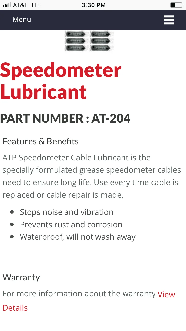

ATP makes the AT-204 stuff - apparently specially formulated for speedometer cables? Don’t have any real world feedback from it being used.
