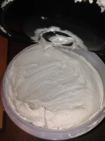

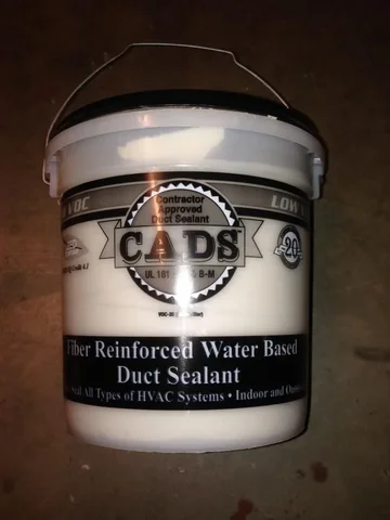

U can us mastic its in lowes,homdepot in ac duct department. its water based so clean up with water . when it drys its water proof and stops vibration. its used for ac duct sealant in homes ac duct work. i know it works for vibration because i used it to stop bass vibration in my cars. and keep the sound in. with big systems . u can brush it on or smear it with hand with a glove on. so were ever u can put hand u can put mastic
Interesting. How durable has it been when you have used it in vehicles? Not exactly the normal usage for the stuff.
If it really works and even if you need to do 2-3 layers to get up to a comparable thickness you are only talking about $1/SF rather than $2.50-$4/SF.

its in my truck inside doors on outer skin if u look in the truck door behind the support bar the factory uses a similar product in time it gets pretty stiff ive had it in my 1987 toyota van for 10 years and still good you can buy it in pints like 6 buck smear it on something let it dry and check it out.
