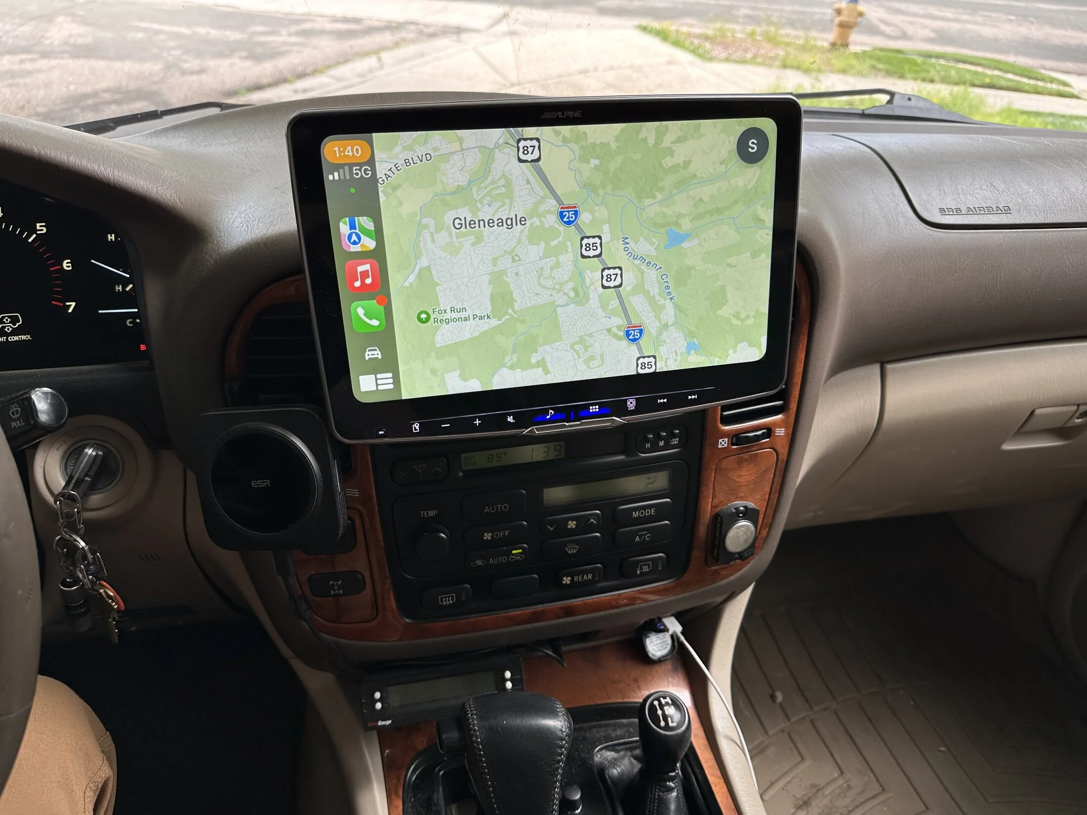

  • Stereo: I knew from the start that I'd want to upgrade the stereo at some point, so that helped me avoid 100 series options that had navigation and stick with the models with dedicated HVAC controls to make for a more straightforward upgrade later. I've always enjoyed high quality audio, and dreamed of having full-range, rich enveloping sound with a deep low-end in my daily driver. This setup got me just that.
    • Alpine Halo 11 - Selected for the large 11" display, wireless CarPlay, and some of the audio features (fully adjustable timing and EQ for each channel, HD Radio, preamp outs, etc.), as well as front and rear cameras.

Nice job!
Do you happen to have any photos of the Halo 11 installed?
While I love the Focals, its time to get rid of the janky Pioneer h/u.
Nice job!

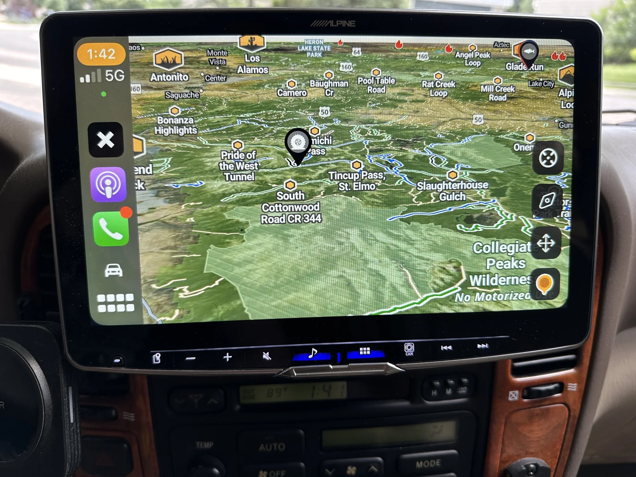

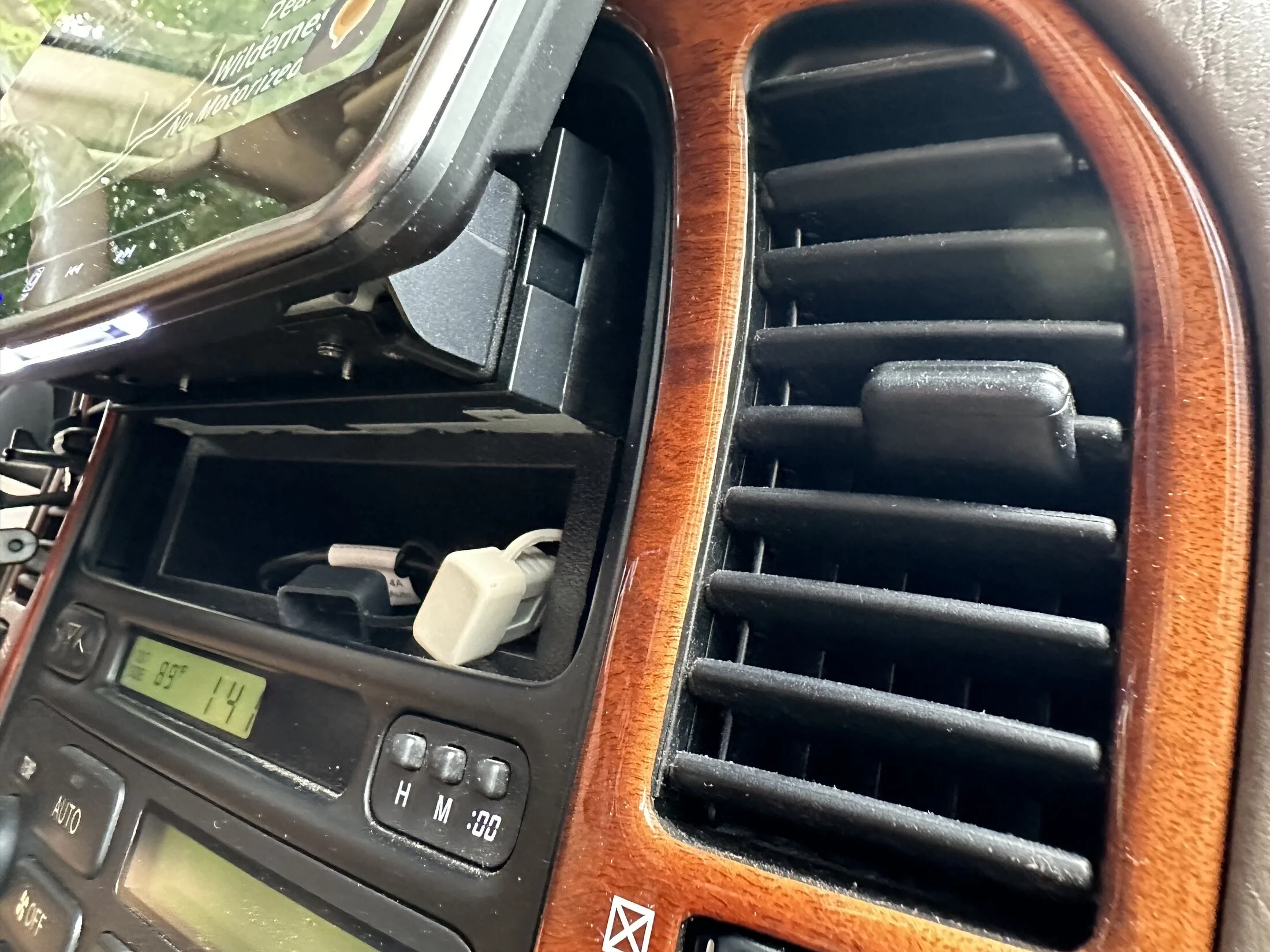

Here you go! As you can see, I skipped the insanely priced vehicle-specific bezel/trim. You can’t see the gap unless you’re leaning in to look behind the screen.

Thanks! Yes, one of those photos shows OnX Offroad, which has been nice to use on the trails.
Day to day, it’s nice to have music/maps/homekit controls on screen (depending on the view you select), but on the trail, OnX full screen is where it’s at. I sometimes will have downloaded offline Google or Apple Maps up on my phone at the same time to cross reference.
I will say, I think that all head units above entry level are significantly overpriced, but I waited years for that to change and it didn’t, so I finally pulled the trigger. Still not happy about cost, but really happy with the overall result.
