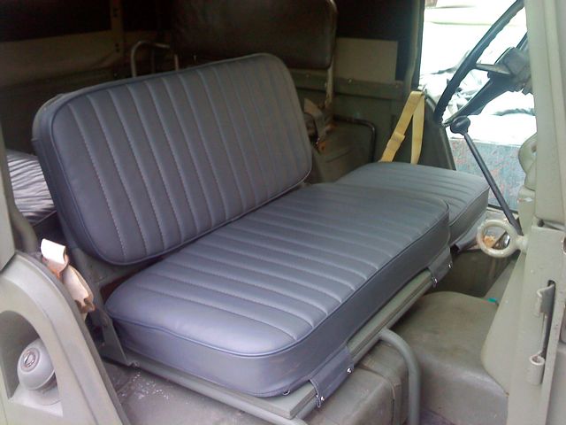

I used the silver/gray covers on my '65 FJ45 (which came with orange seats), as there was no other choice at that time.

i used SORs grey covers since that was all that they had at the time
I see you put a board (?) under the passenger seat cushion. Was this because it needed more support? I have the same seats (I think) in my early ‘63 FJ45 and there are just three zig zag springs in the bottom frame and was wondering if that was enough. Also wondered if originally those zig zags were tied like zig zags in interior furniture? Here’s a pic of mine with the SOR covers - the cushion isn’t attached yet at the front:
Yeah the ‘65 seats have the solid bottom and the springs on top of that, then there’s foam on top of that and the covers wrap around everything and are screwed to the bottom frame rail. With the 25 and very early 40 series seats (which were just 25 seats really) the “box spring“ was incorporated inside the bottom cover (with 1” foam, or horse hair back in the day) and that assembly was then attached to the frame by just two flaps along the front and screws. The incorporated box spring is only a couple of inches tall (thick) compared to the later springs on the solid base that are a good 4 to 5 inches tall. Without the incorporated box spring the base sags too much as the frame’s three zig zag springs don‘t provide enough support on their own. The sag reaches to the top of the fuel tank even with 2.8LB /ft3 density, 50LB ILD foam at 4” thick, which is what I have right now.
These are the SOR 25 covers (passenger) with 4” 2.8/50 foam only in the bottom. I don’t have the OEM internal box spring.
Works but worried about clearance for tank, fuel sender.
I made a reinforced thin board for under the lower cushion, helps with sag but sits too high. Maybe time will sag it, like me. But my 1/2 generation driver’s seat will sit a lot lower than the passenger if I mod it to fit the SOR 25 covers.
