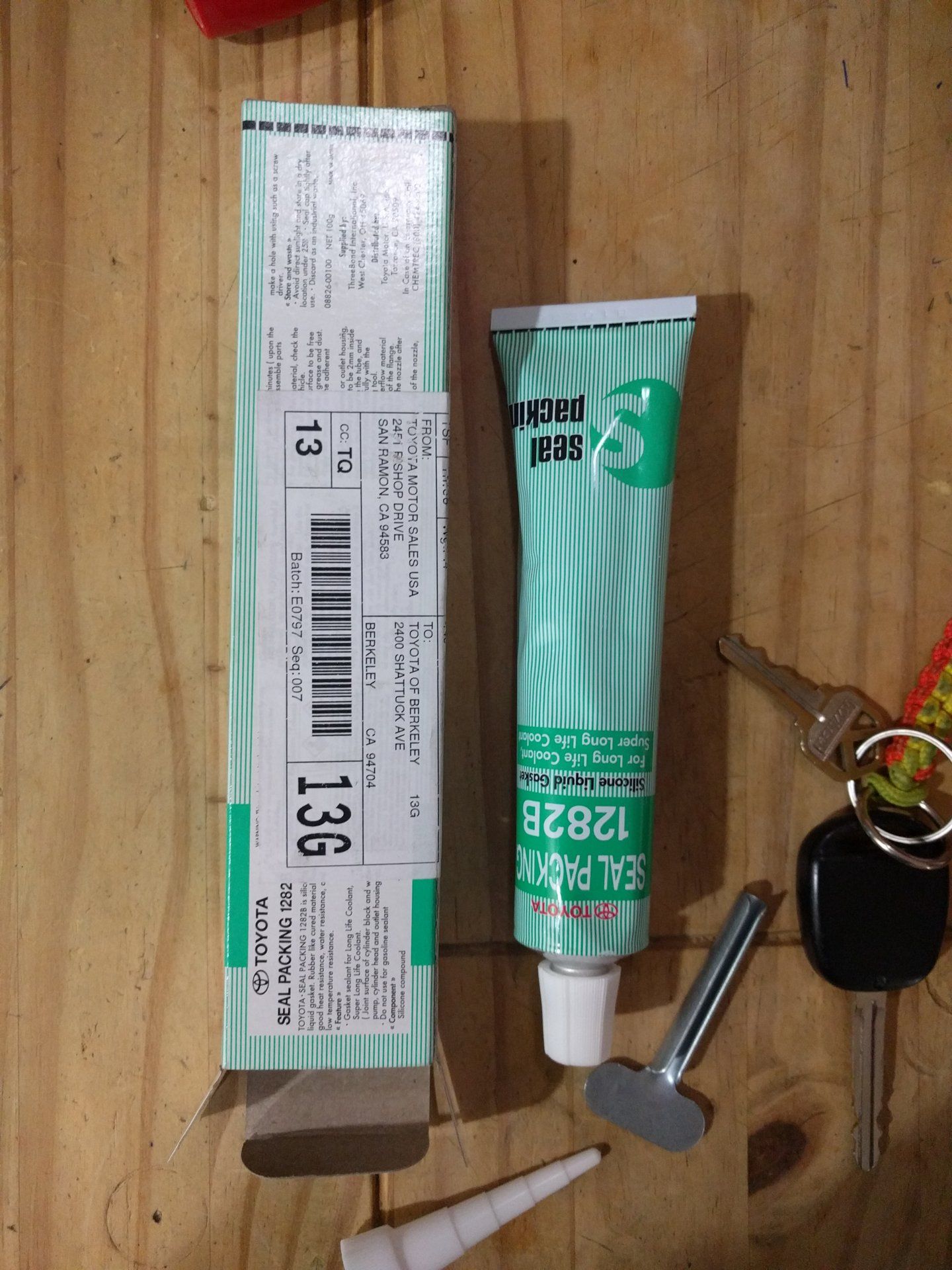

whats the deal with the 1282b on ebay for 29$ is that fake?
Yeah has to be.
I emailed a seller with a similar low price and asked some questions, never got a reply. For as much labor/hassle it takes to get all the way into to the water pump, I didnt want to risk getting generic black rtv for saving $30.
I ponied up & bought a whole stink’n tube of the real deal from the dealer.
idk, it has a Berkeley Toyota shipping sticker on it. Looks legit to me but anything is possible. ebay out of california, shipper name A. Rowdan

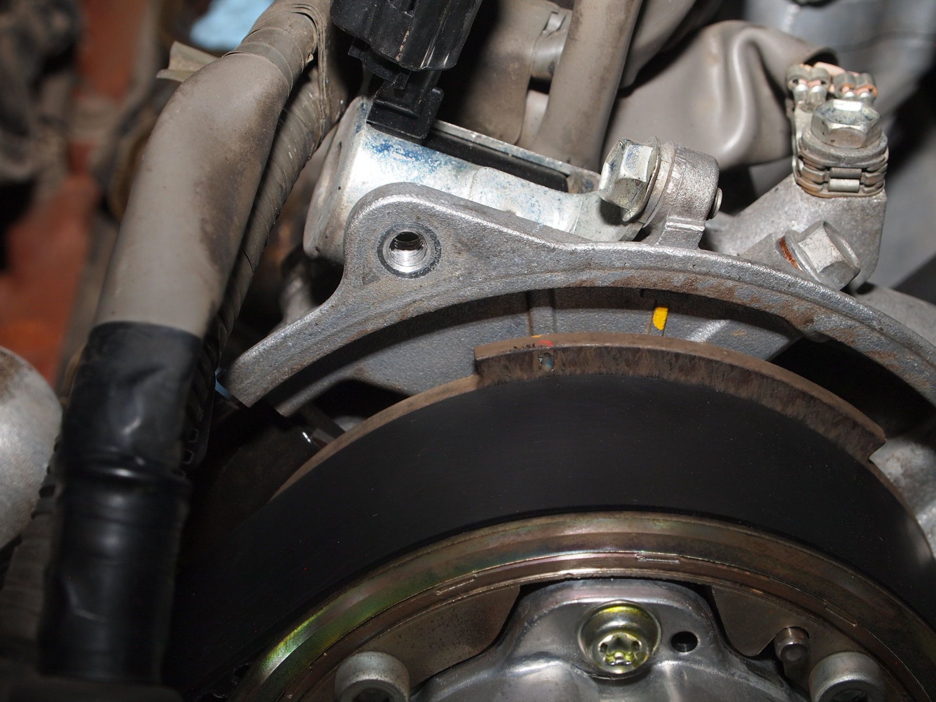

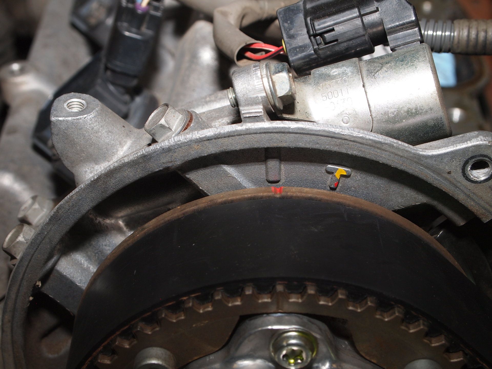

Timing marks on crank and cams. If you put a long screwdriver in through #1 spark plug hole. It will rest on top of piston and you'll see it raise as you turn the crank to TDC (Top dead center). This will give you the confidence your piston is up, just as timing mark indicates. The cams will have to be turned into position also. Just remember the "T" above each cam is NOT the timing mark.
Tip remove all spark plug, makes life easier.

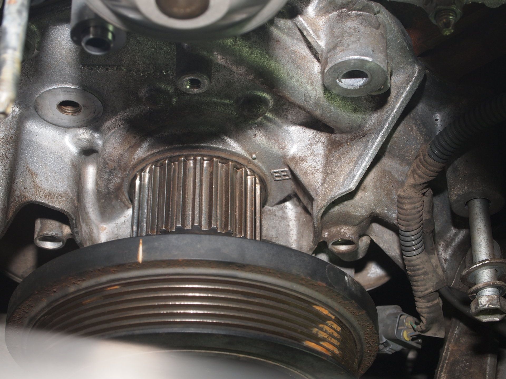

See the bump on the oil pump case and notch on the crank gear, that's TDC,
These look a little different then you'll see because their VVt actuators on the cams. But mark are the same.

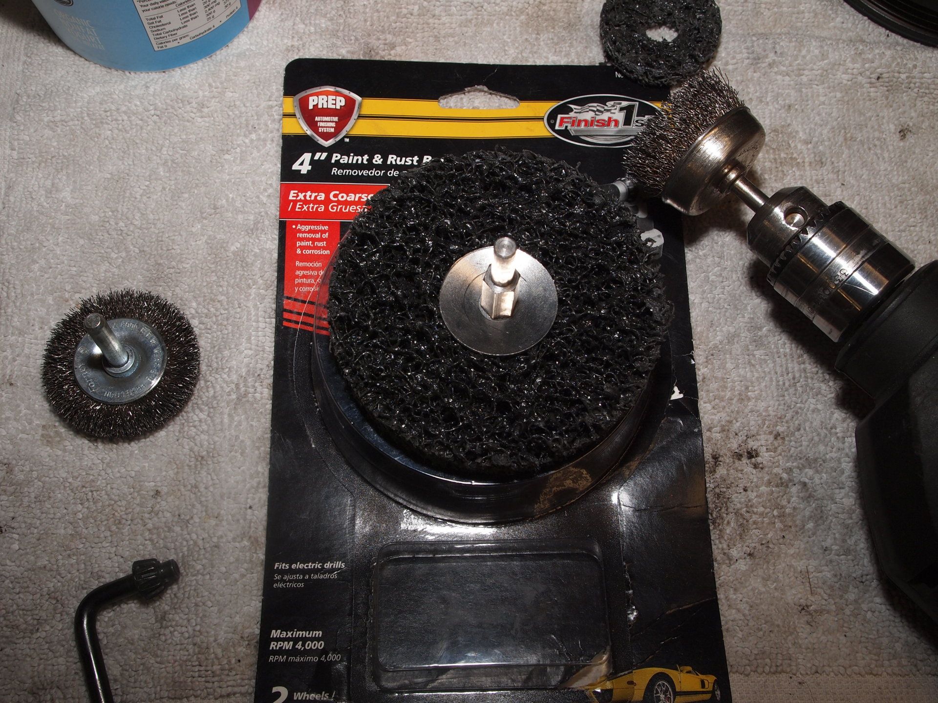

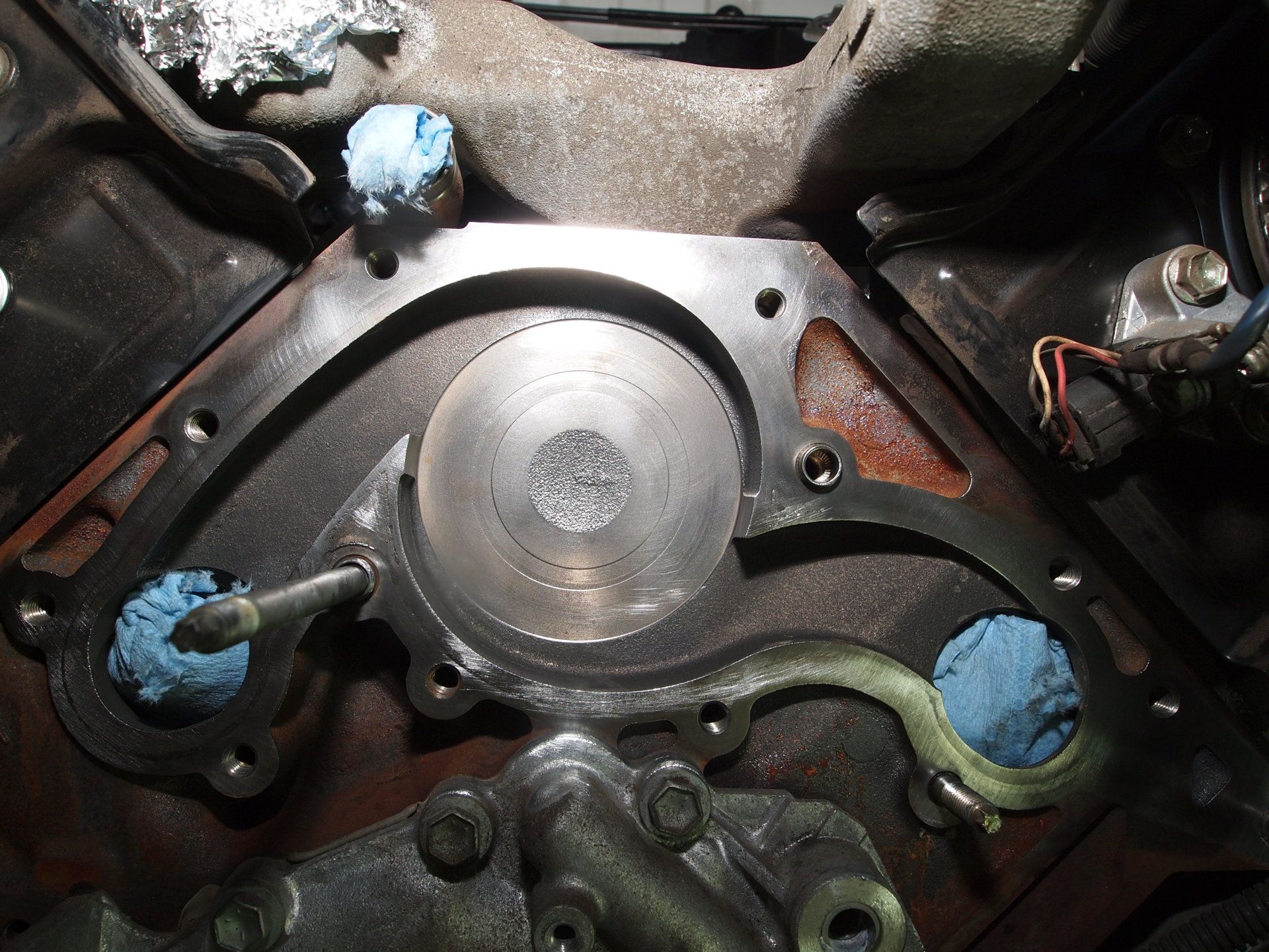

These rust remove wheels work nice for cleaning off old gasket. The medium would be safer, then this Extra Coarse.

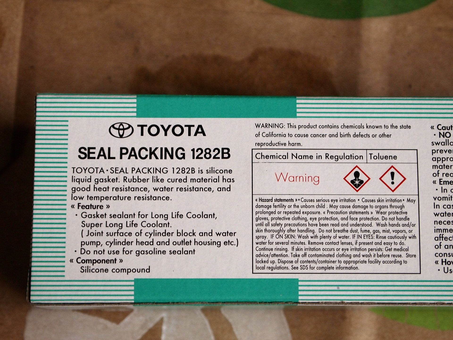

I bought a tube from an eBay seller tj408. I believe it was legit and it had a Toyota shipping sticker as well, but the ship date was a little over a year old. I contacted three bond and they recommended I not use it. Whether they were covering themselves or not, they said it had a shelf life of 1 year. I returned and purchased a tube from dealer (I get 25% off) and used that. Funny thing is that I have no way of knowing how long it sat at the dealer.
Good Morning Scott,
Following up on your question whether your tube of 1282B is still in acceptable condition to be used if stored properly. This product has a one year shelf life and while it still may be in acceptable condition to use, we would recommend using a more up to date product.

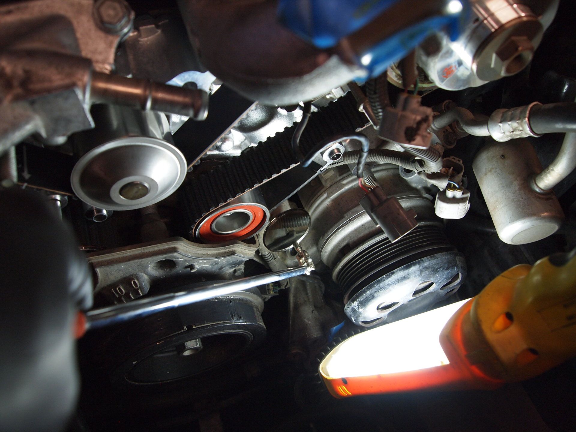

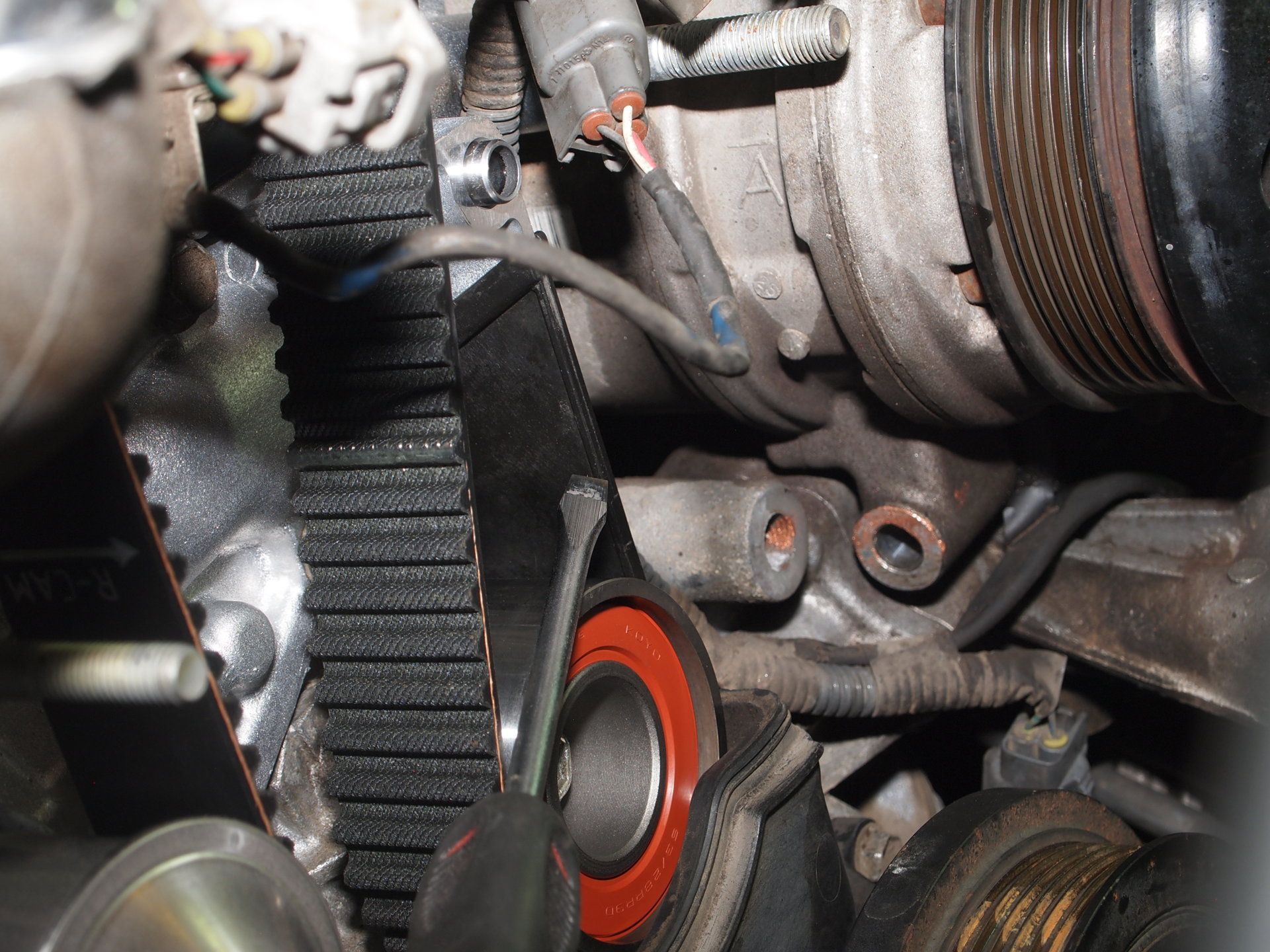

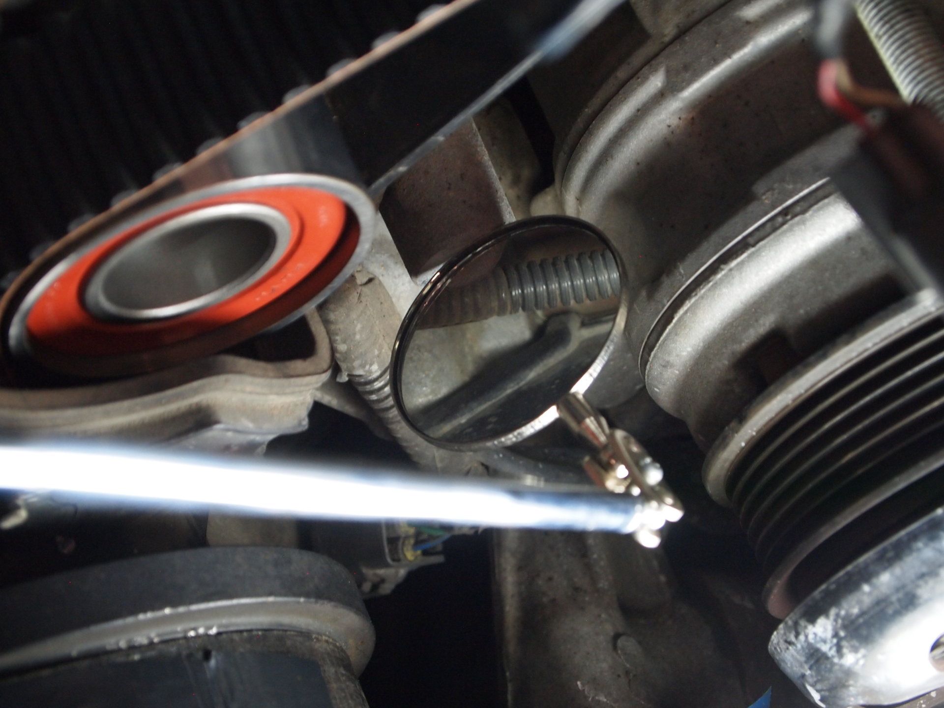

Follow the FSM to the letter. There's one thing (IIRC that's not in the FSM clearly) so often left out, it's these two tiny plastic pieces (shield). We had a report of one mud member leaving these out. A mouse got in belt area through the opening and took out the belt. Yes that's right Mickey took out a Cruiser!

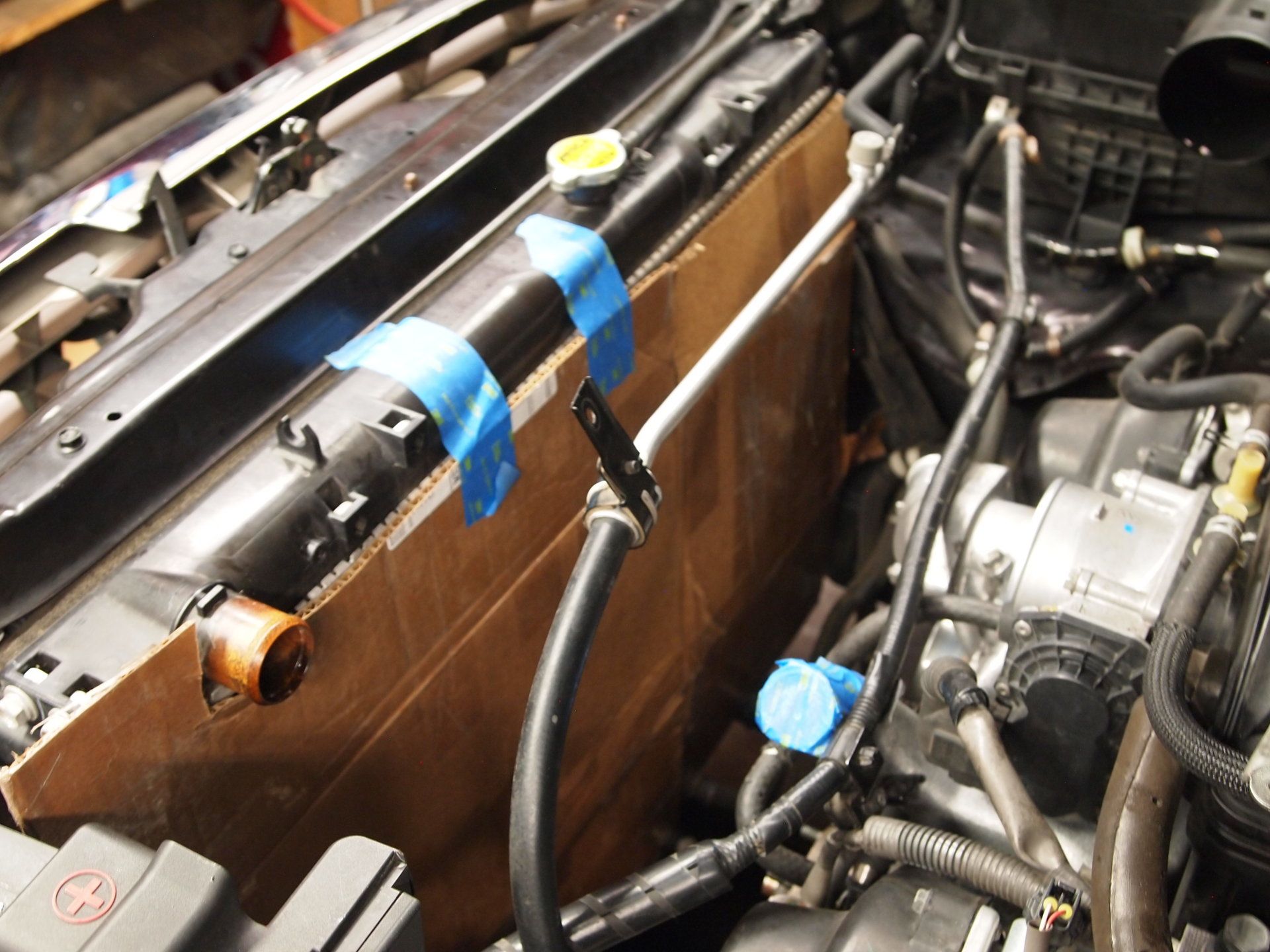

Oh don't forget to protect your radiator.
A Paint & Rust removal wheel (fine or medium probably best), makes short work of clean off block.
Living proof of this. Forgot to put the small cover back. I got done and said, now what’s this??
