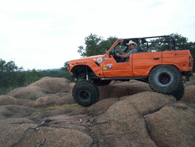

SOA on 37"s
Here was my SOA on 37's - Man-A-Fre shackle reversal, BTB 4" srpings, custom shackles, rear shackle hangers on both axles moved forward 1 1/2", 1 1/2" wheel spacers(really did'nt want to use them), cut fenders.
Dude...Dont take this the wrong way, but your rig is HOT!
Nice job!
