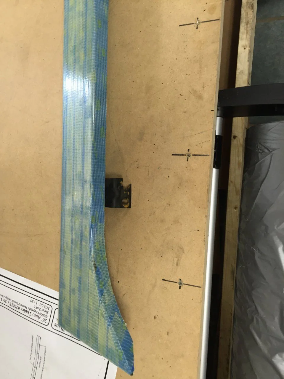

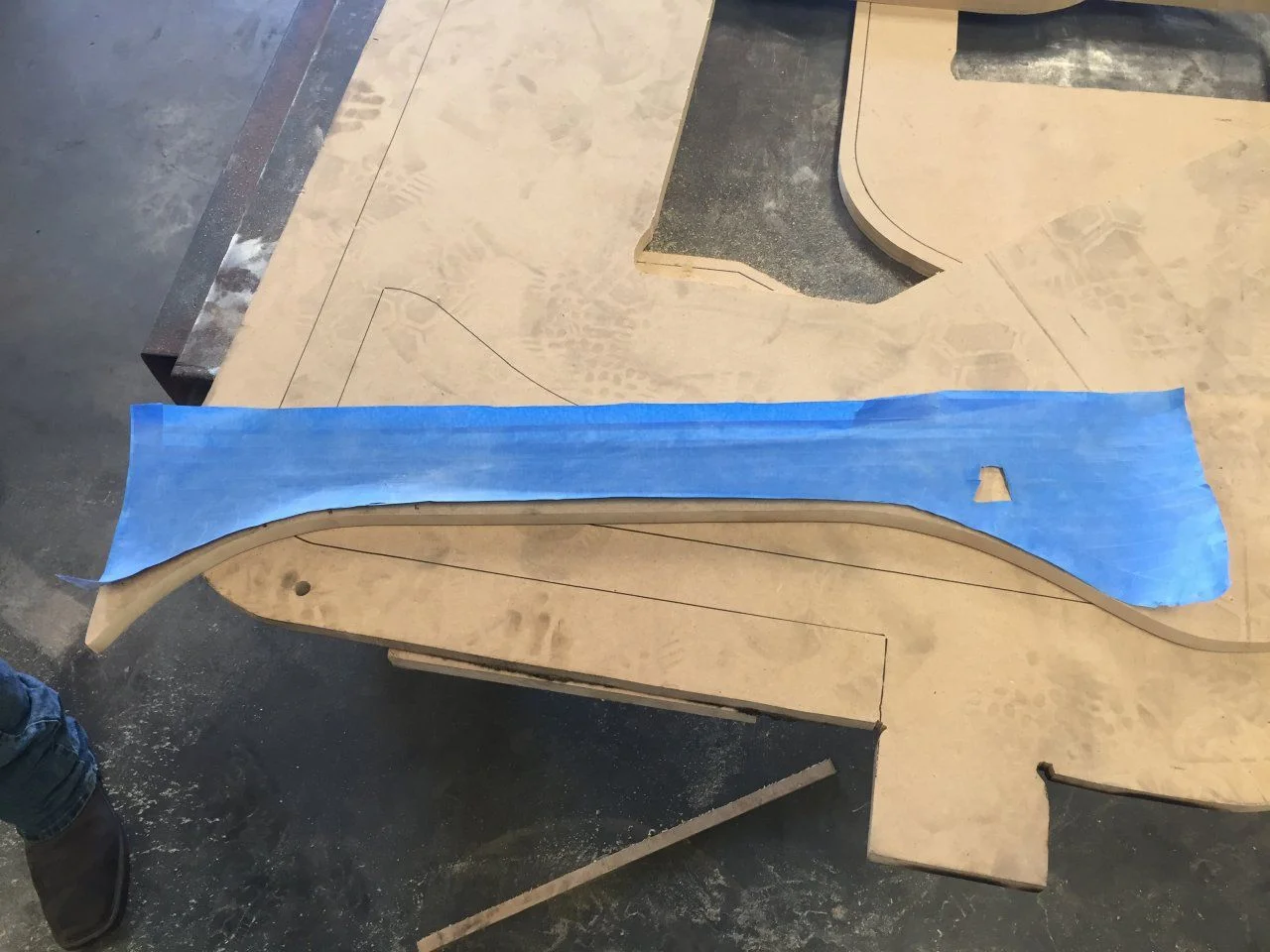

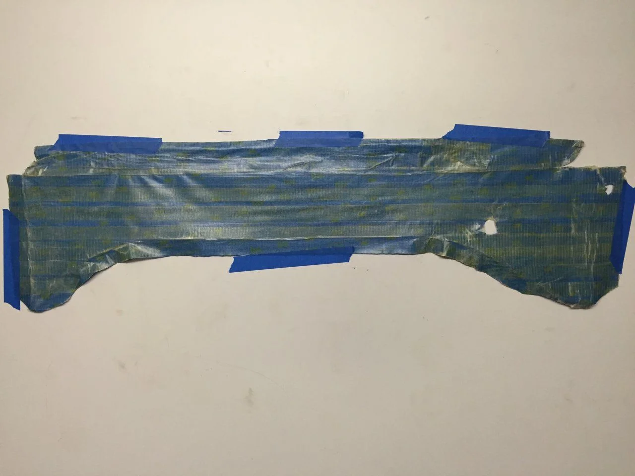

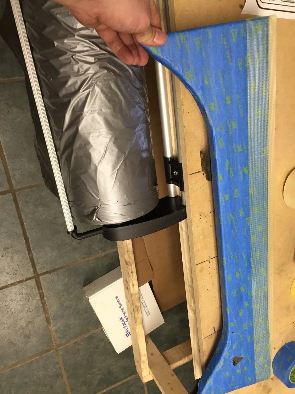

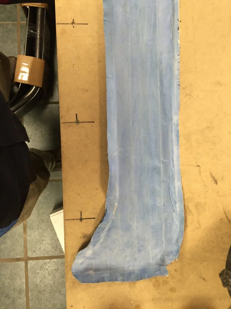

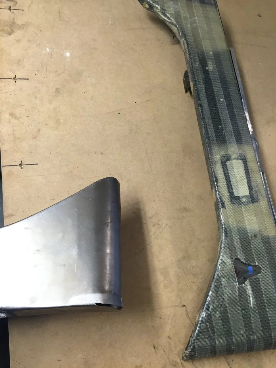

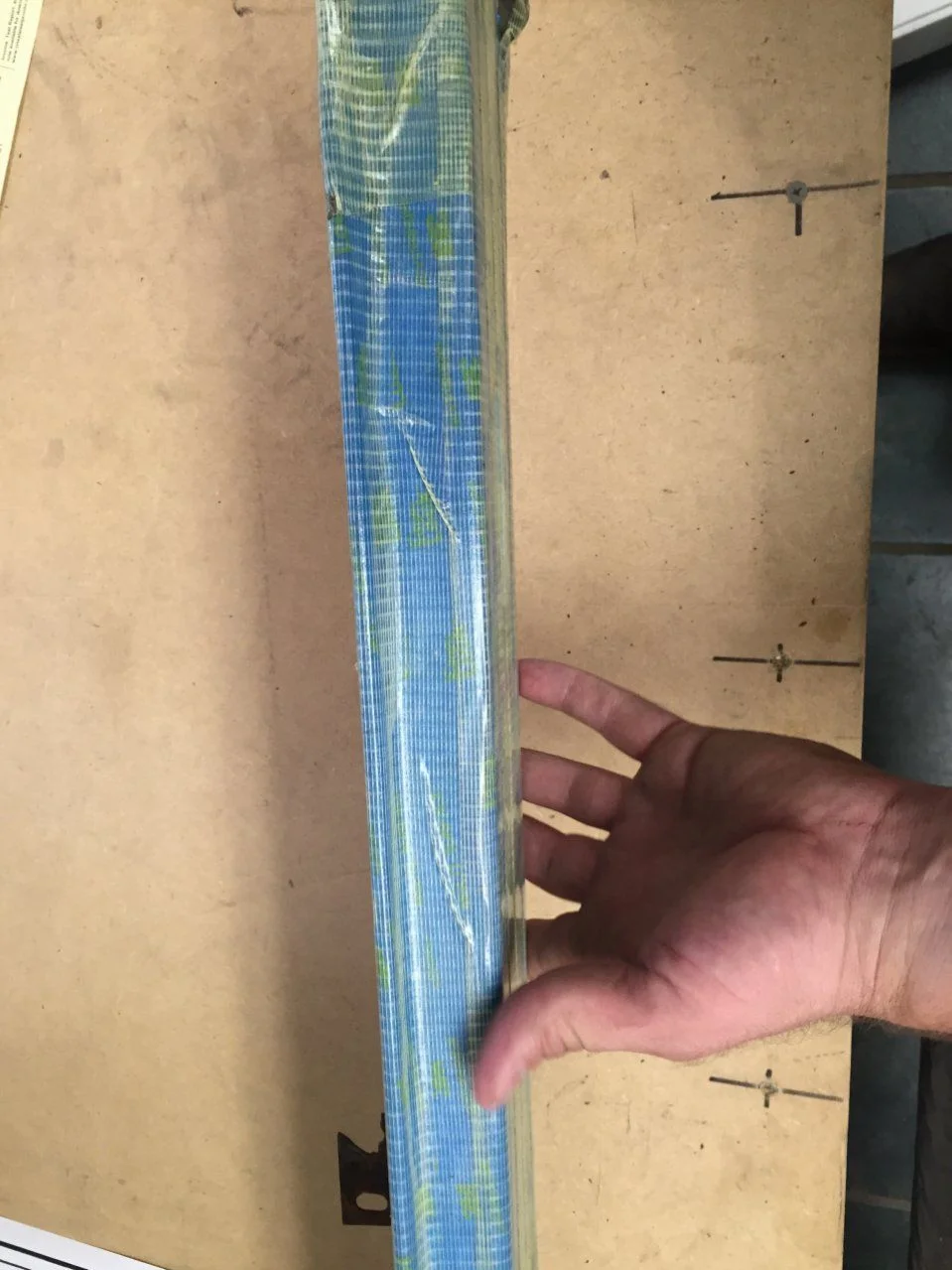

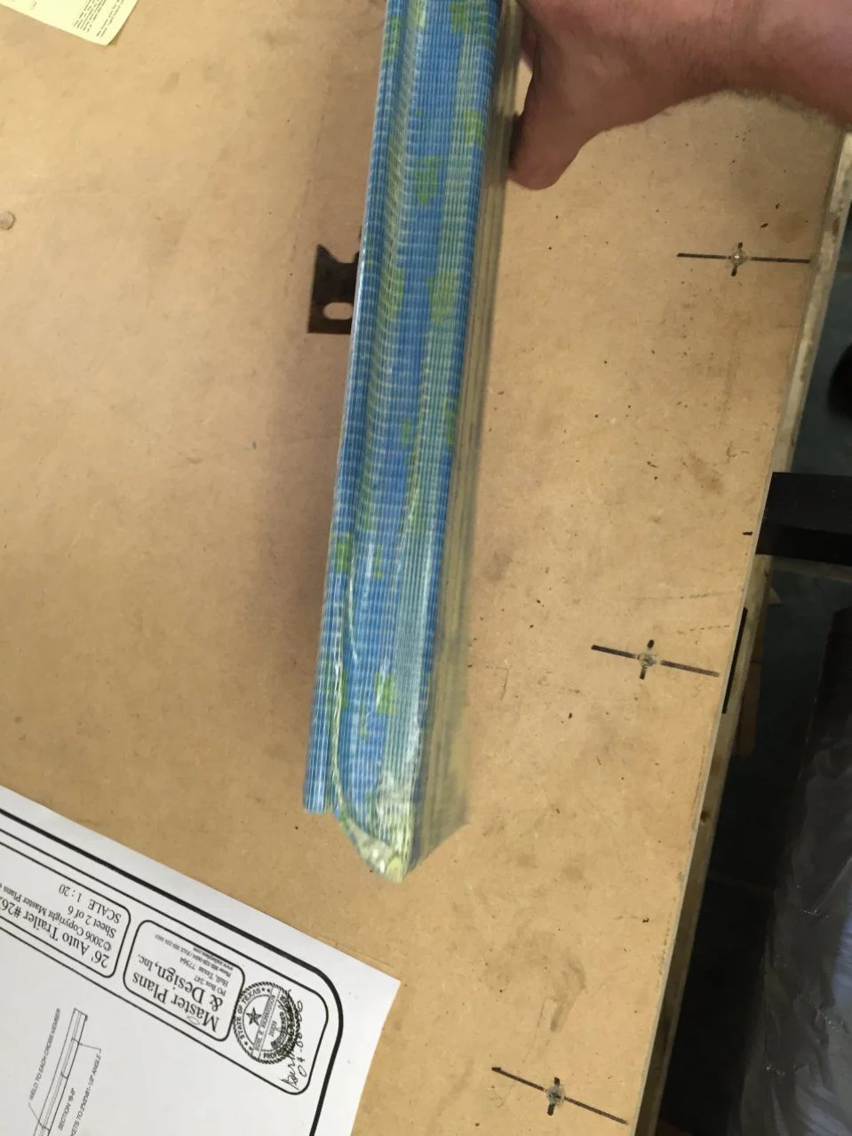

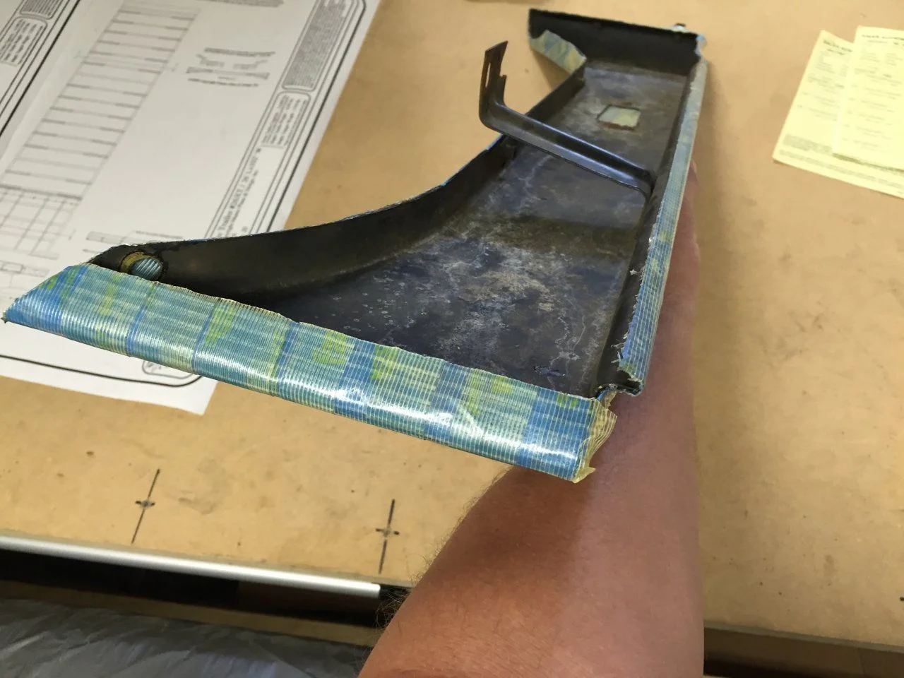

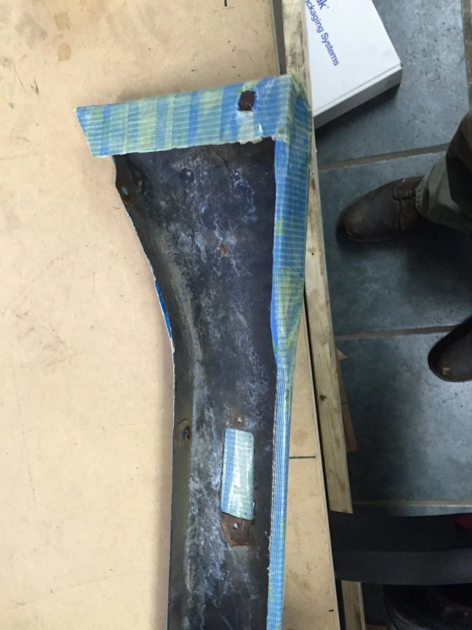

So here is a small lesson for anyone wanting to replicate a piece. Get some painters tape, the low stick kind. Cover your part completely and then come back over it with reinforced tape. Here I used duck tape. However this isn't a good choice when doing hot rods because it can move some because the duck tape is flexible. Just keep that in mind. Once you have both layers trim the edges to you have "hard stops". The advantage of this method is it will actually keep the shape of the item.

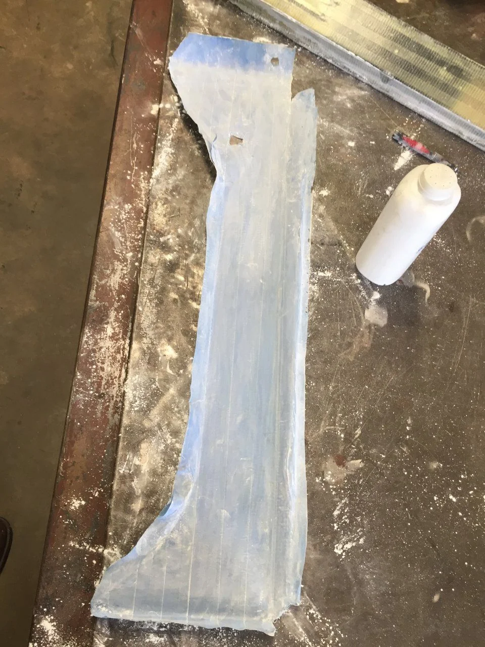

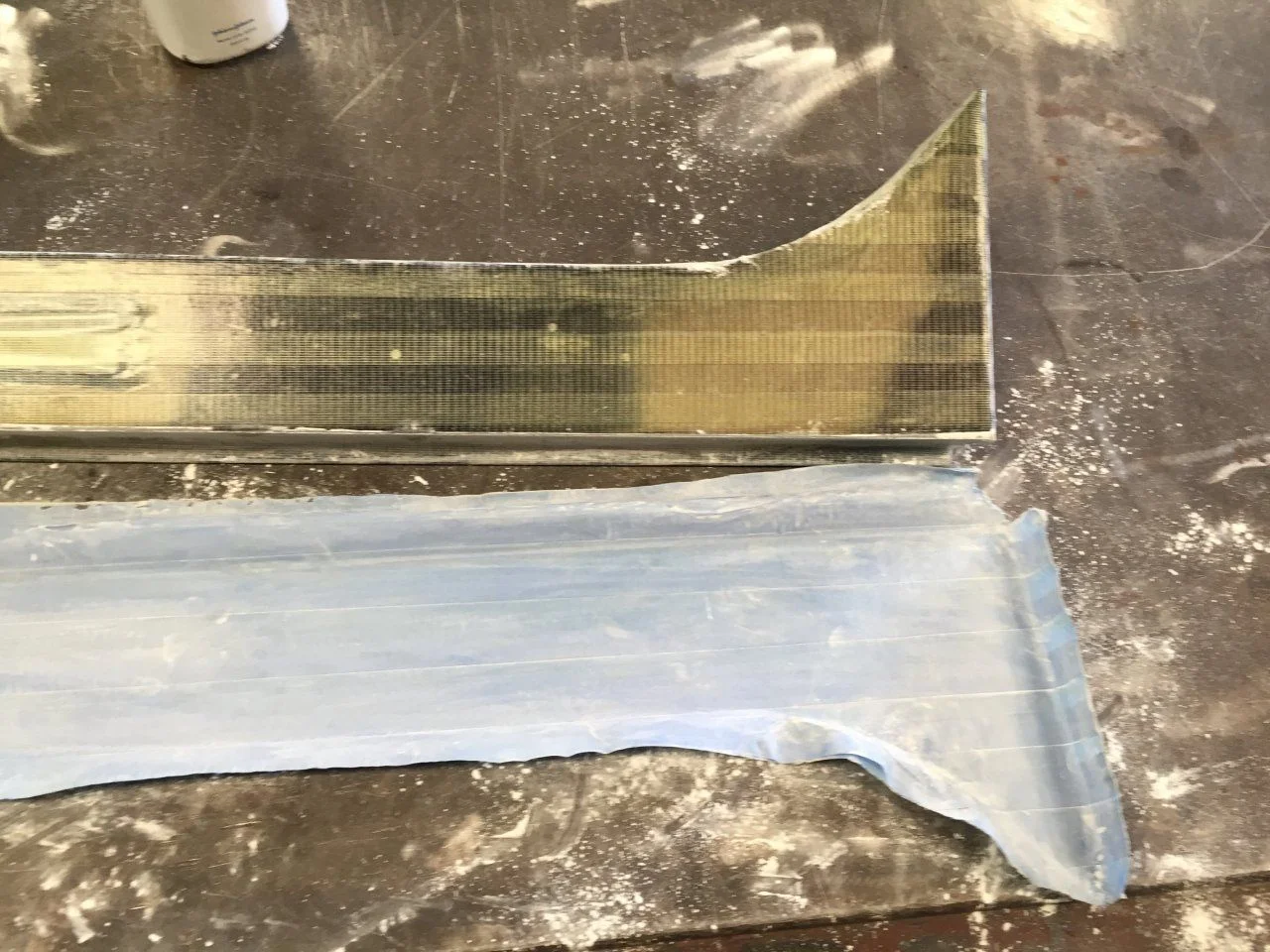

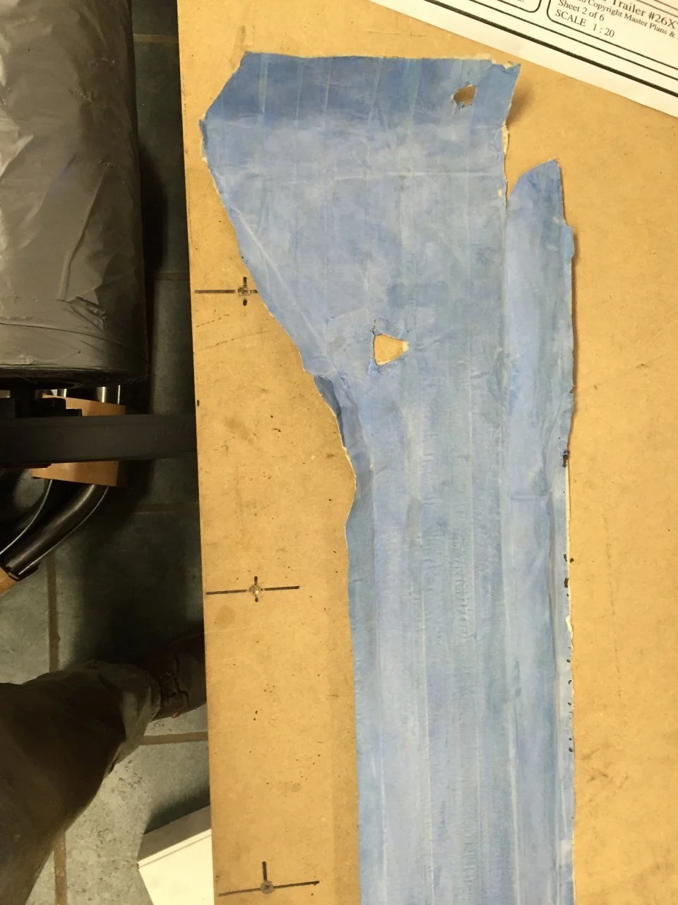

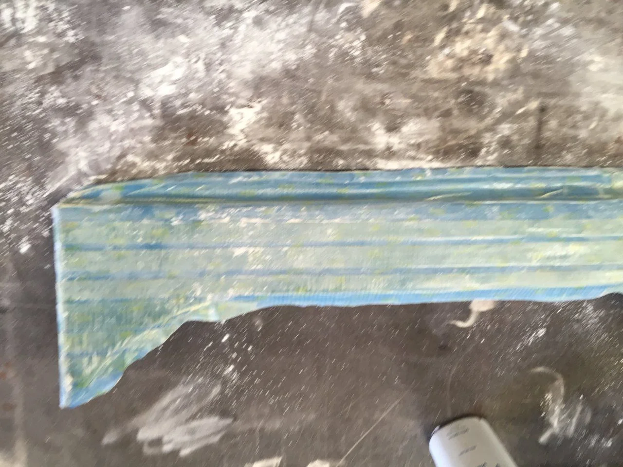

The next step is to slowly, and I mean slowing tape the tape off as one piece. For this part you will need some baby powder. As you peel the tape back dust it with baby powder so it nulls the sticky.

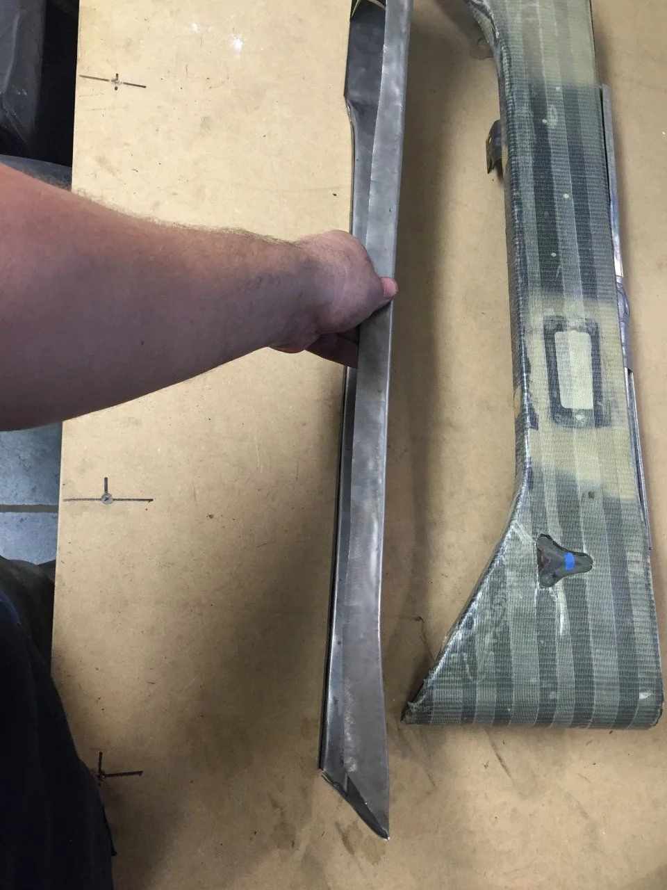

Now I out this on my digitizer so I can make my sheet metal blank on the CNC. Boy does this speed things up, both the digitizer and the CNC.

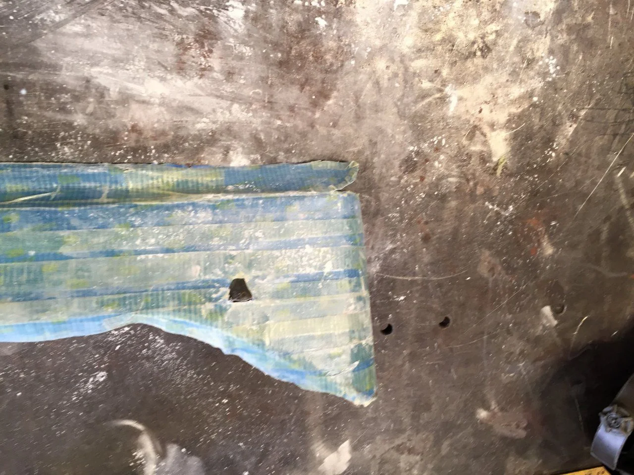

Oh, here is to where the template REALLY gives you a bunch of information. If you can see the area where there are wrinkles in the bends, that tells you that area is going to have to be stretched when being form
