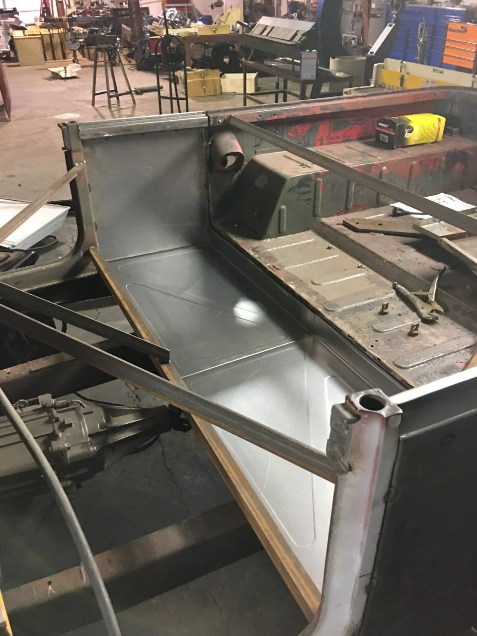

fantastic work.... I'd love more details on some of the stuff that seems so natural for you. on those side aprons I was right with you up until "and after some hammer and dolly work" as it went from a tape template to a beautifully replicated panel....I'll just try saying that next time maybe.... ;p

Basically all I did was hammer the edges of the steel over the edge of the wood. I didn't really do anything special for that.

Sorry for the delay, we have been very busy at the shop.
To answer some of your questions:
I had to do the other side so I took more pictures. Maybe this will fill in the blanks
