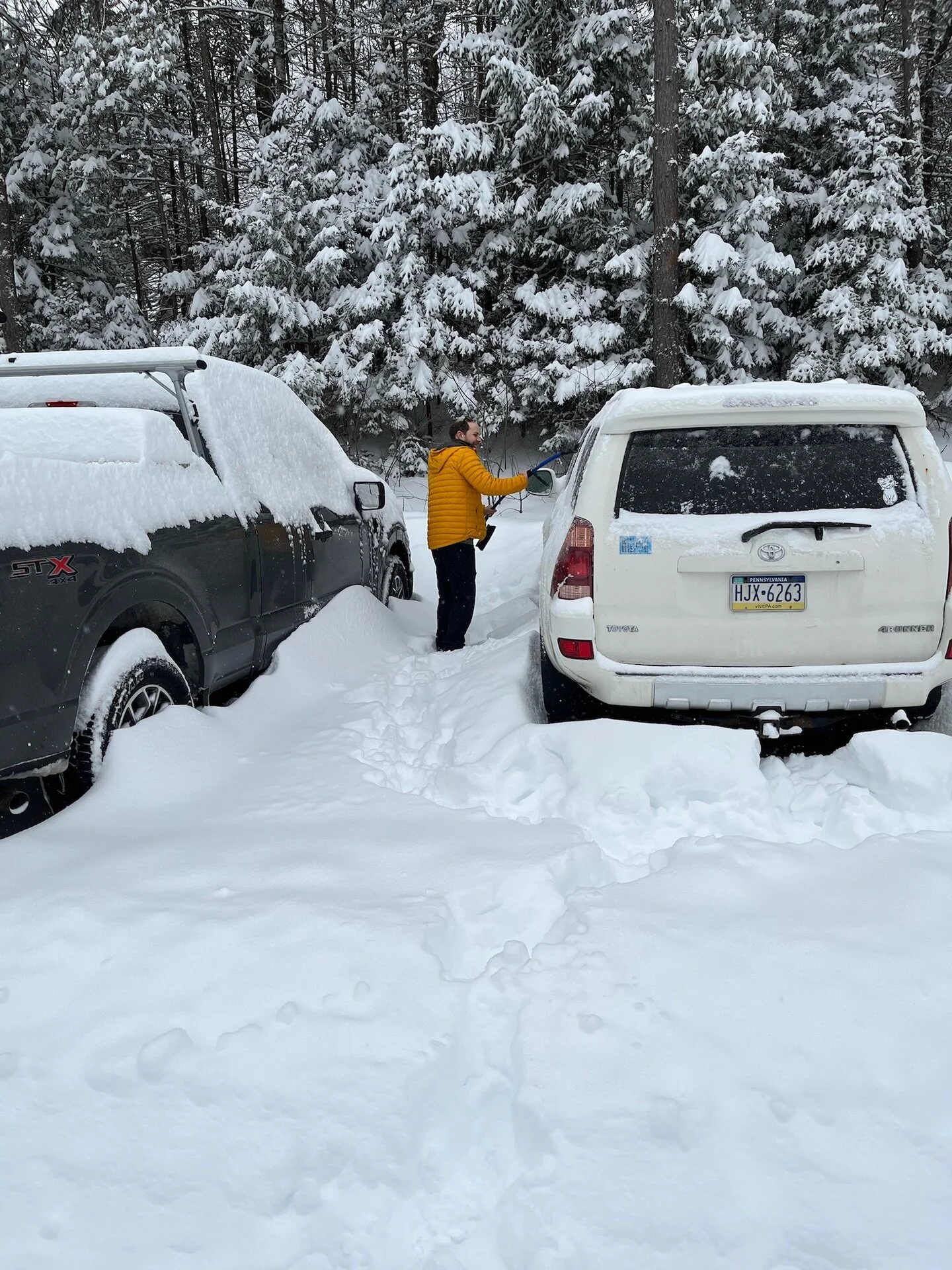

Yeah, this was what I woke up to one morning in the White Mountains…. Plates old and cars sold so not worried about it.

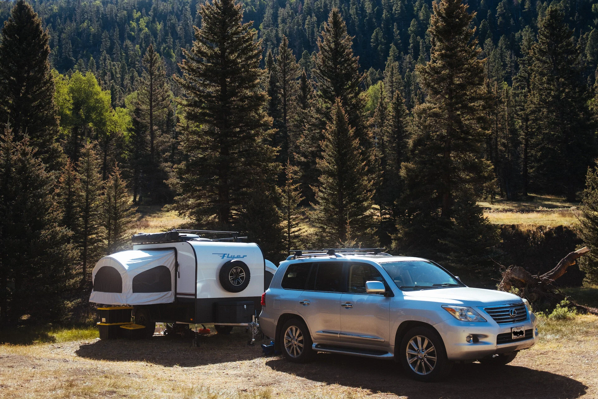

I'm currently running 285/50r20 LTX XL's on my 570. I have some 18" LC take off wheels that will receive 275/65r18 LTX SL's one day. We do occasional light camper towing (Intech Explore trailer). Empty weight is 1750lbs, loaded weight is prob under 2300lb. I don't know exact tongue weight yet.
I'd like to stay with SL for daily driving comfort. Are there major concerns with "downgrading" the 20" XL's to 18" SL's for occasional towing? Mostly tow to area state parks for camping (10-100 miles), with one annual 1,600 mile long haul to the mountains.

I have had P rated 275/65R18 Michelin Defender LTX M/S on my 2016 LC for around 40,000 miles now. I regularly tow a 21’ boat on a dual axle trailer, total weight is probably near 5000lbs. There have been no issues whatsoever with the tires. I usually up the pressure to 35-36 when towing. This is in Florida with high heat and strong thunderstorms daily in the summers. I wouldn’t hesitate to buy them again. Much better in rain than the stock Dunlops. Quiet and seem to be wearing like iron. I am doing 5 tire rotations every 5,000 miles. I have Firestone airbags to prevent sag from hitch weight. Love these tires for trailering.

Both of those tires in the Defender LTX M/S are 116, but one with the XL denotation (ie 116 SL vs 116XL). That means their ultimate weight carrying is the same. I suspect that the lower profile tire has to be built stronger to carry the same load as the higher profile 18" tire hence the XL denotation. You have to run higher pressure on the 116XL to carry the same max load.
