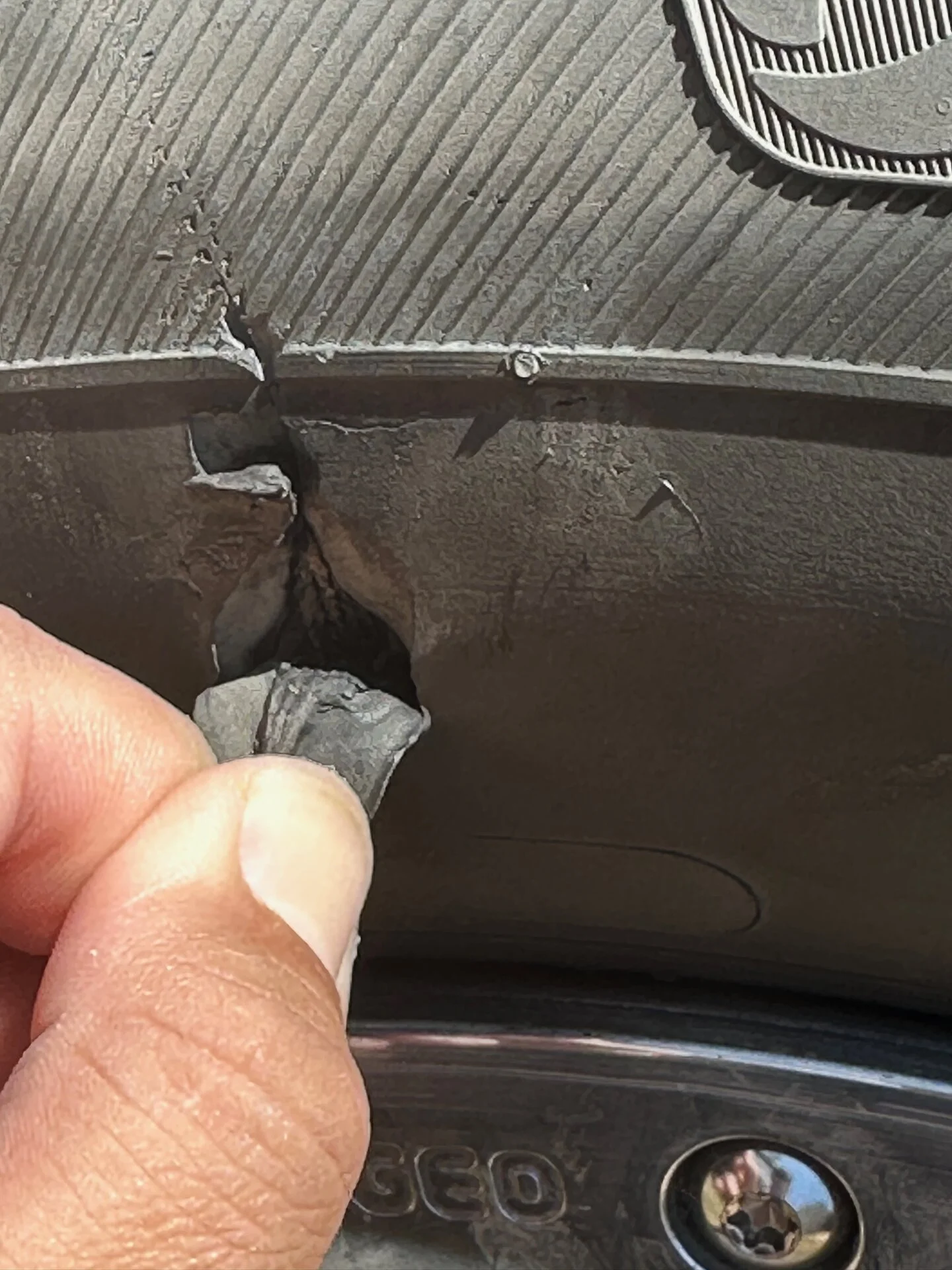

I have aired them down to as low as 12 PSI and never had an issue. When aired down they do burp occasionally. I should note I did gash the sidewall on Little John Bull in Big Bear, CA. The tire still held air though the cords were showing.

I was curious about the durability of the sidewalls, and while you had a failure it sounds like you were able to limp it off the trail. The majority of miles for most overland vehicles is on pavement, and I conjecture there are many built rigs that have never and will never see a trail. This tires seems ideal for piling on miles and for light duty off road. Fortunately I stopped having a daily commute in mid 2019, so the only time the 200 gets driven is on the way to the trail and on the trail with the occasional drive around town just for fun which means a heavier duty tire makes a lot of sense - especially since I hate changing big, heavy tires! I love the Ridge Grappler for my use case, but if I had a daily commute or did lots of highway trips without wheeling I would consider looking into the Defenders as a second set. I'm also interested to see how the new BFG KO3 performs on the road and in noise/snow/treadwear as that could also be a good option in between a street and full off road tire.

I think any tire I had on that day would see the same sidewall gash which leads me to think it was a piece of metal,

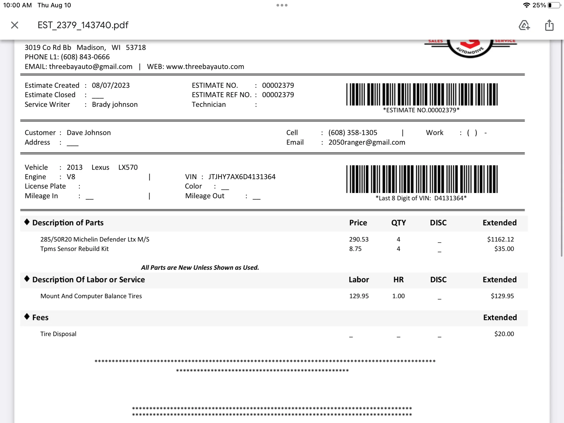

I have 13 lx. I also replaced my Tpms since I thought they were ten years old. Discount tires let me bring them in and had no problem programming. Costco would not but discount tire matched Costco price.
Thanks to @mceagle555 post about these TPMs being legit. I replaced all five and replaced five tires.
Denso 550-0103 TPMS 315-MHZ Sensor for Toyota/Lexus with Factory Alloy Wheel Options. (THIS SENSOR MUST BE PROGRAMMED BEFORE USE) https://www.amazon.com/dp/B00NQ05U24?tag=ihco-20
My guy is all over it! I adding a front end alignmen…..
The TPMS rebuild kit is only new gaskets. If your sensors are original, this is probably a good time to put new ones in as the batteries are probably getting close. The $8.75/corner is about 25-30% of the sensor cost anyways.
