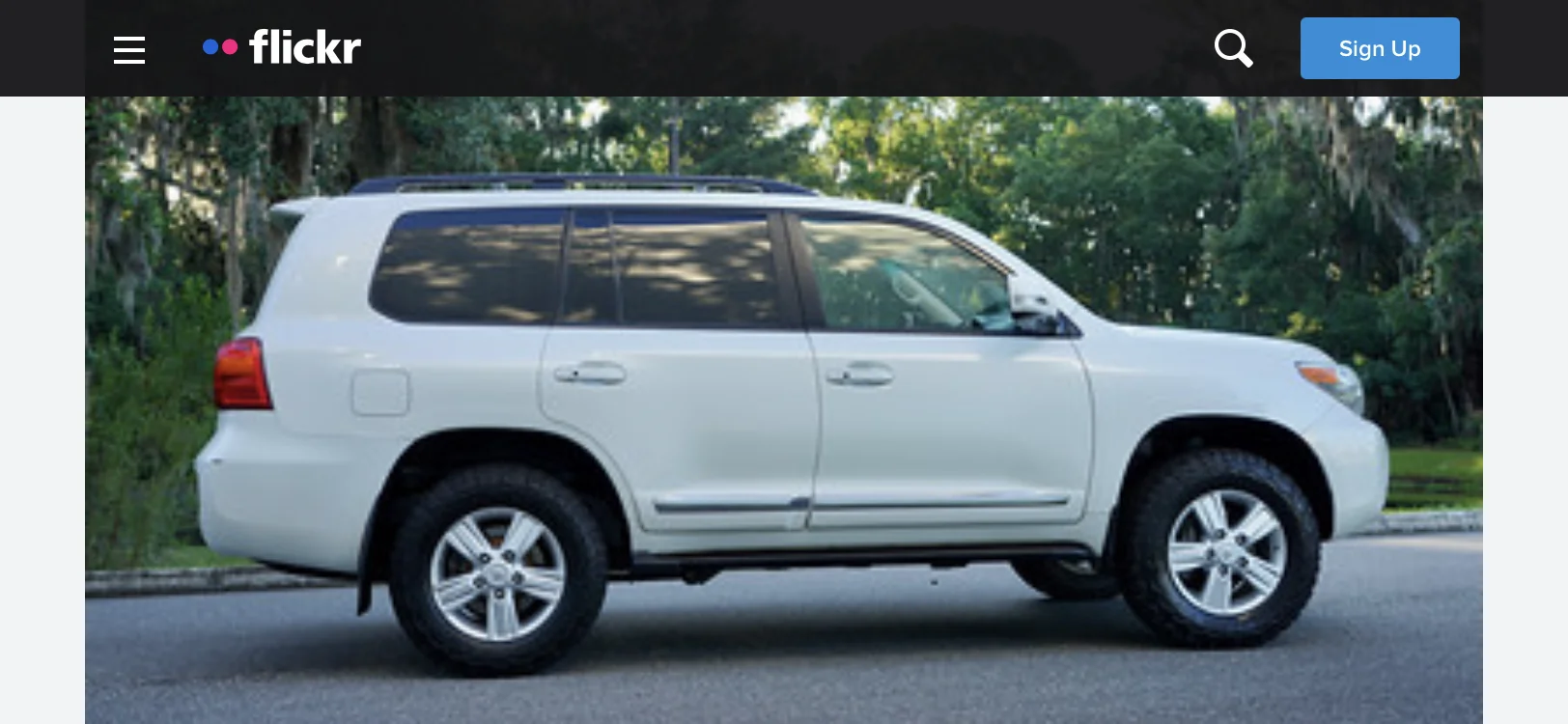

I added the OEM spacer to lift up front just a bit so I wanted that 65 tire to fill it out. I think it looks pretty good and ride has been fine so far
