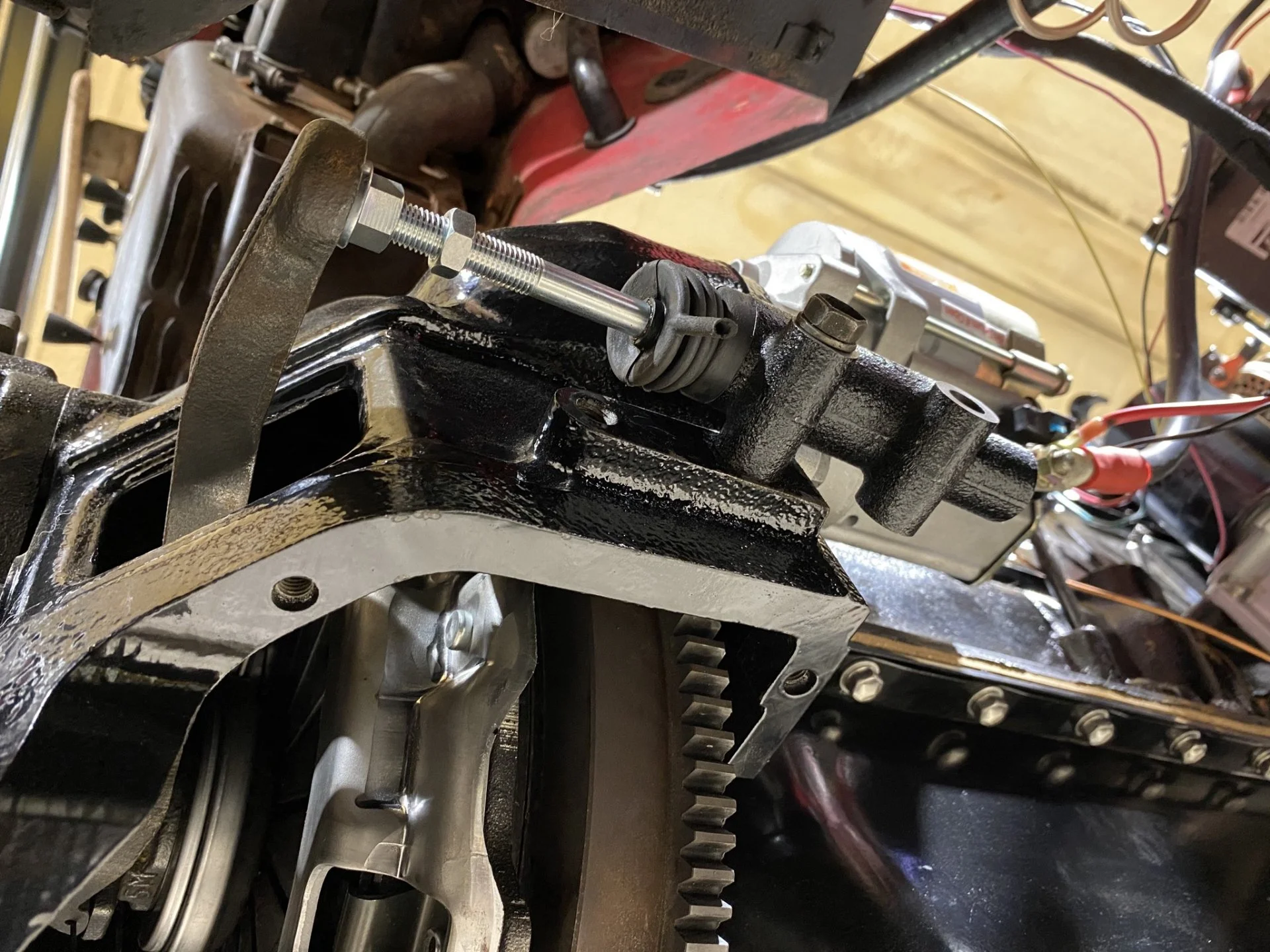

I’ve been converting later 60 non adjustable slave cylinders to the early adjustable ones on all my swaps. I can’t stand those little short throw slaves in a single fixed spot and no return spring.
Yeah, my slave rod is adjustable, but you can only go so far without losing your endplay. You don't want any pressure on the clutch fingers.
P/N, or application for the adjustable?
1984 FJ60. Make a bracket of flat stock. Added a spring later to the later arm using a hose clamp since it does not have a tab on the end
