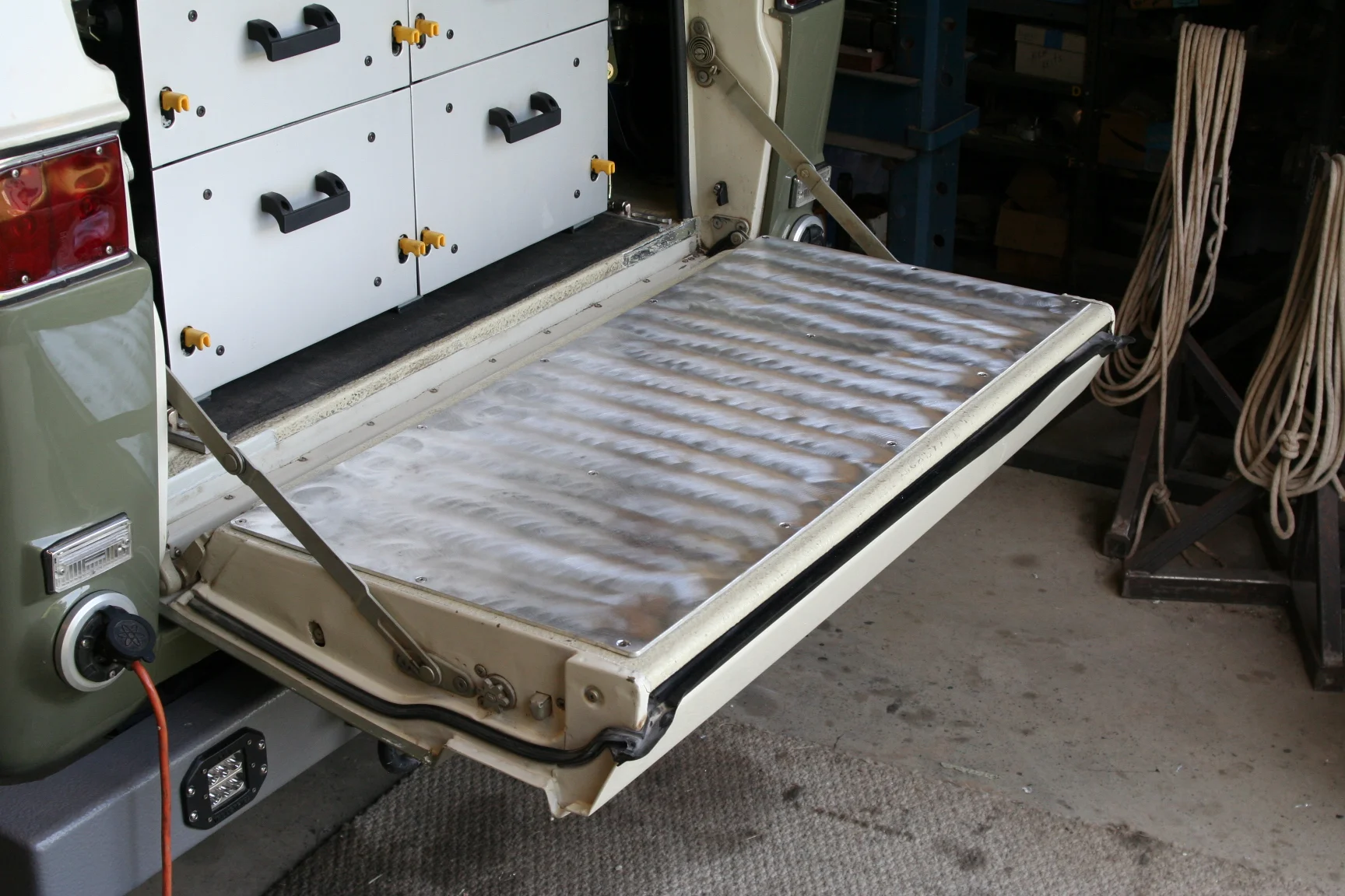

I'm trying to ignore it hoping it goes away. I did check the big connections from the battery, but want to replace my ignition switch, too. I've been searching the interwebs for the best switch ( aftermarket ), but haven't bought one yet. I drove it to a car show last week with nothing happening, but it needs to get inspected before anymore trips, the plate is past due. I've been making some alum. plates for the tailgate, so I can stand on it without bending and have a flat surface for cooking. With everything going on in my life, I wanted something easy to distract me. I'm back at it, the wagon is a needy thing and won't stand for any slacking. :)
