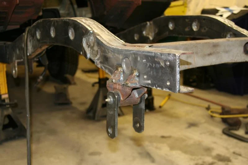

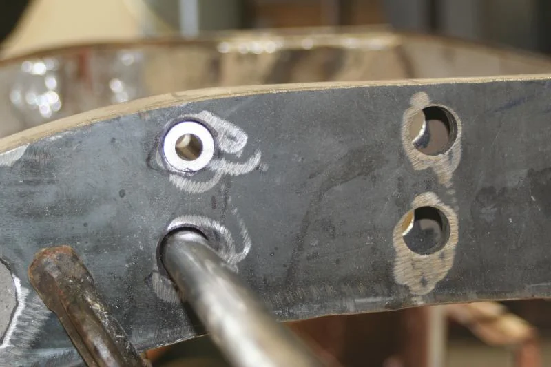

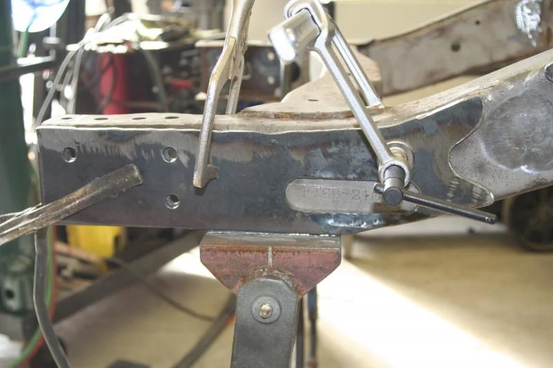

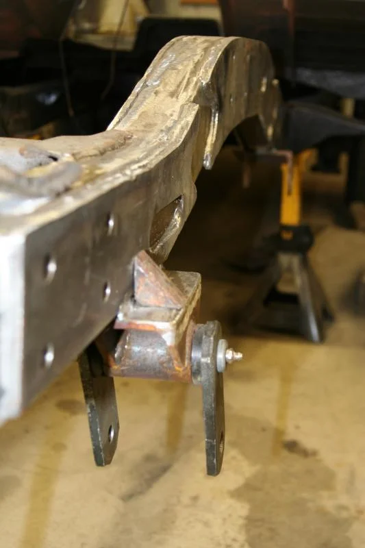

The frame had so many extra holes in it, I went ahead and fish plated it inside and out. I welded in DOM tubing for the power steering and had to modify the Ford shock mounts. I haven't decided which engine to put in yet, it will have the H55 5 speed with a split case transferand a PTO running the winch.

Thanks Bob,

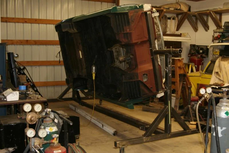

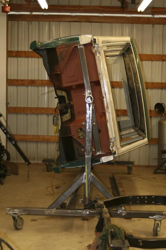

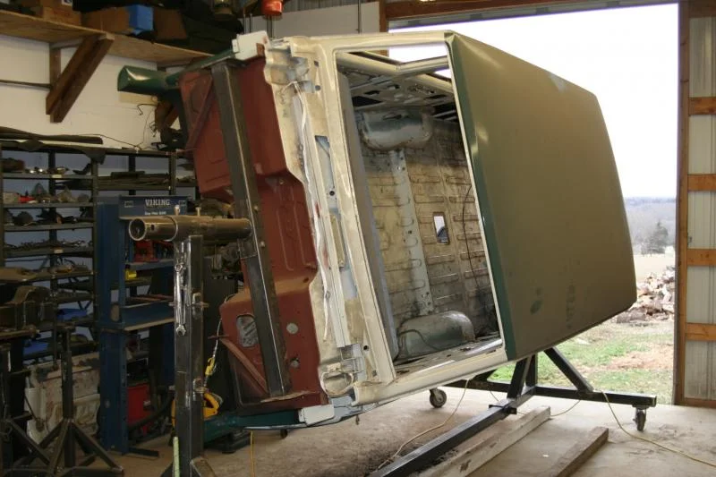

Yes I build it, getting too old to lay under it and work. It's so much nicer, to be able to stand and scrape! The out side of the body was repainted years ago, but the bottom wasn't touched. I figured while it was all apart, might as well get at it.

Thanks, that's about where I'm at right now, I work slow. Once, I get the bottom finished, I'll start on the axles. They're FJ60's with 3.70's in them. I want to rebuild with 4.11's and some sort of locker. I don't have alot of parts yet and not even sure what all I need. One step at a time.
