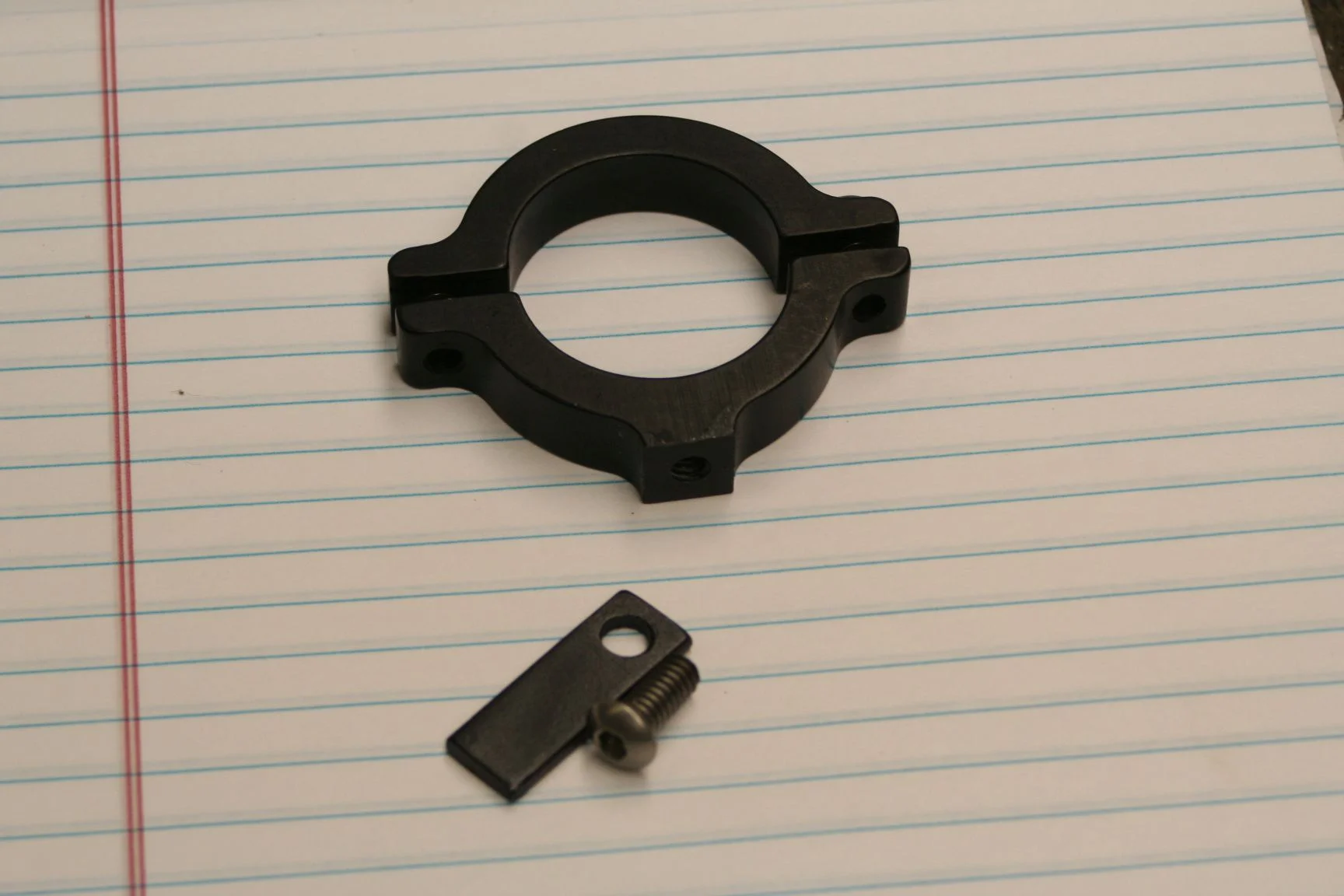

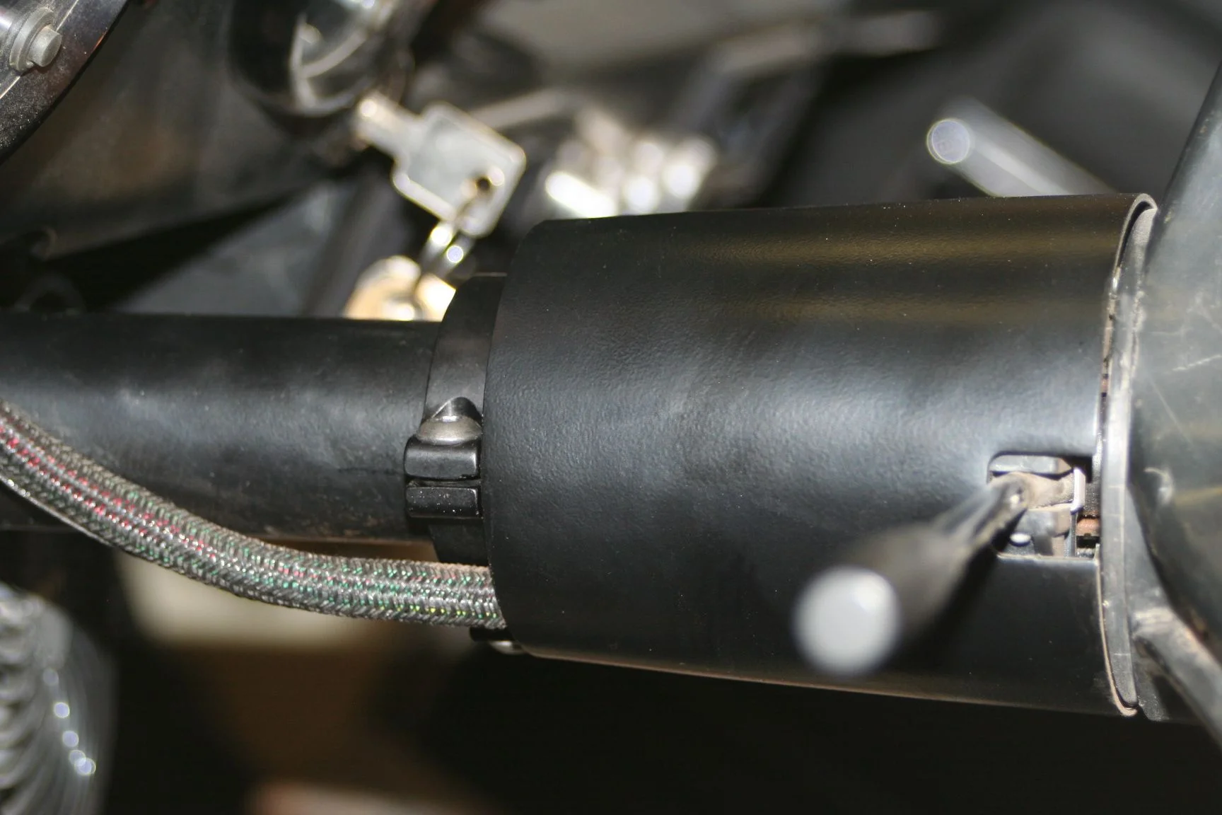

While I'm still waiting for real parts I decided to fix a recurring problem of the steering column housing. I'm using the 71 column, but removed the shift rod and went with the 5 speed floor shifter instead. In doing that it lost some support and the housing will slip in time where the turn signal won't function. We talked about this earlier and tightening the two little brass tabs which are supposed to hold it in place ( they don't ) isn't enough.
Here's what I did and I'll show you with another column I have in the stash. First I found a 1 1/2" tube clamp from Jegs with a threaded boss on it and then made a steel 1/2" tab that screws into the boss...
Here it's screwed together and will slip forward into the housing...
Fits perfect and holds the housing tight...
Finished project!
The things we do...

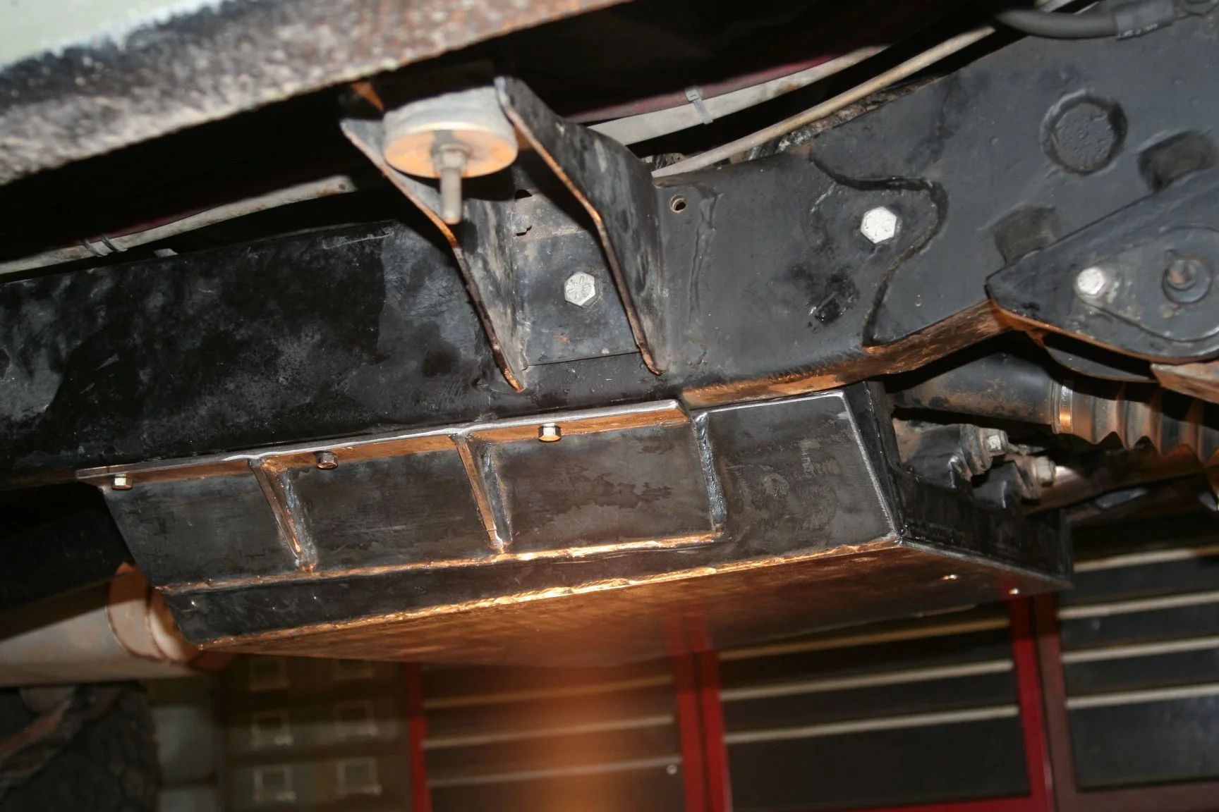

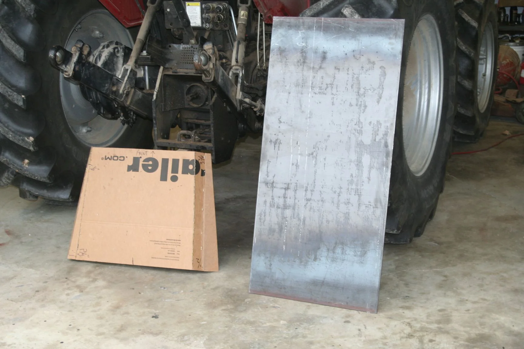

Picked up a piece of 1/4" plate steel for a skidplate and since I have the PTO and transfer hanging @ 5" below the frame, I'm just going to make a flat belly pan. Question for my fellow cohorts...How much of a gap between the lowest part and skidplate? I'm figuring @ 3/4" to an inch. I'll try to run some stiffeners down the skid and hope it doesn't cave in too much when I'm following J Mack. :)
To be honest I don't know what this steel is, just something I got at the metal scrap yard. I'm using what I have, so do you think a bigger space will work. I'm not rock climbing, so not too concerned with the least amount of space if that makes sense. If I run a 3/4" square rod on the inside of the skid it should stiffen it up.
Case International
I thought a 1/4" should be strong enough, but it's not hardened either, guess I'll find out. The PTO box is hanging out there just waiting to be wacked.

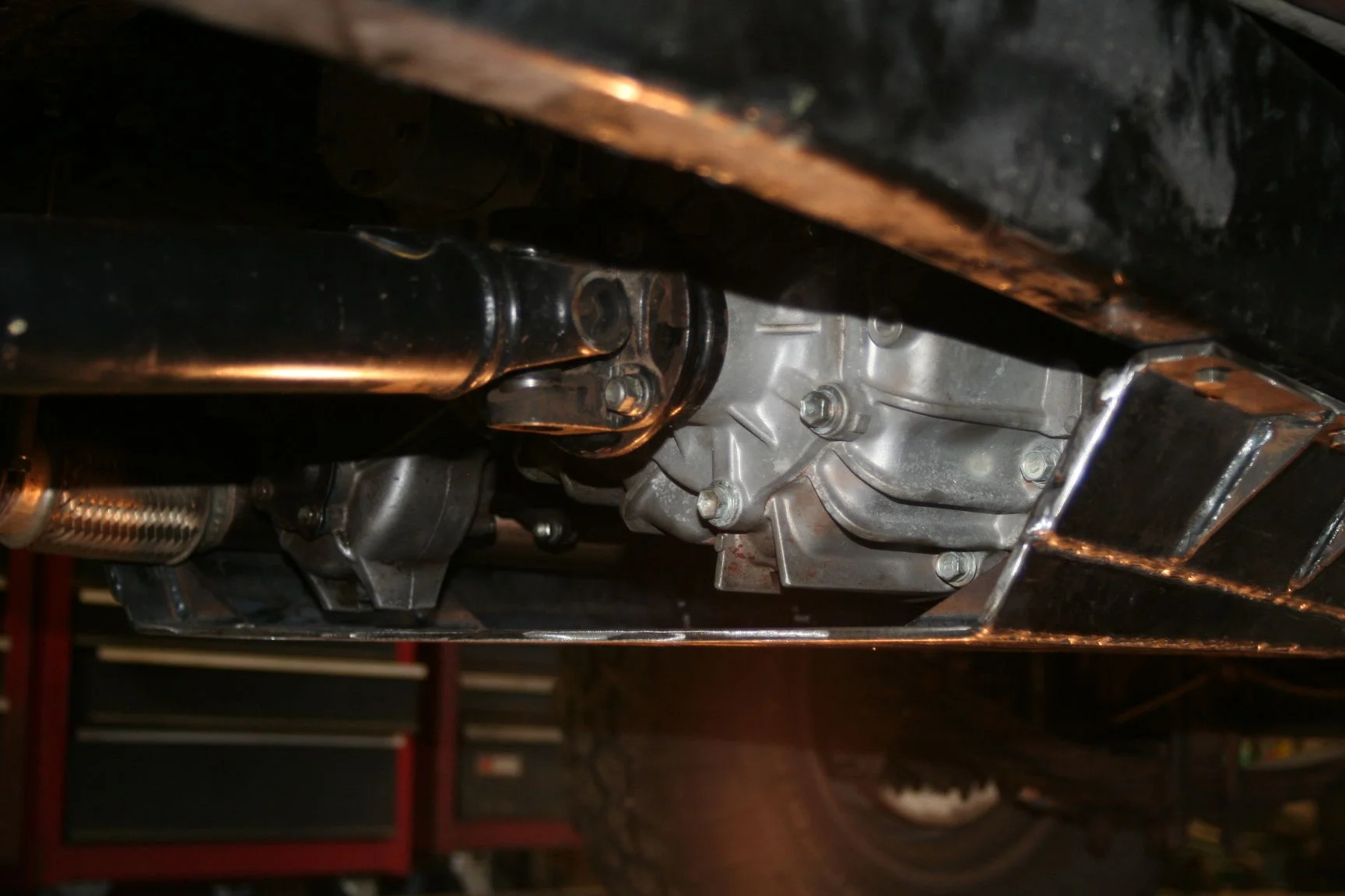

I got the plate welded up and it looks like it might work. She hangs down some, but so does the PTO. I've got to put in some drain holes and clean it up then get out the paint.
I've got room to run a stiffener from front to back (right up the middle), maybe a piece of angle flipped over, if you guys think it would help.
