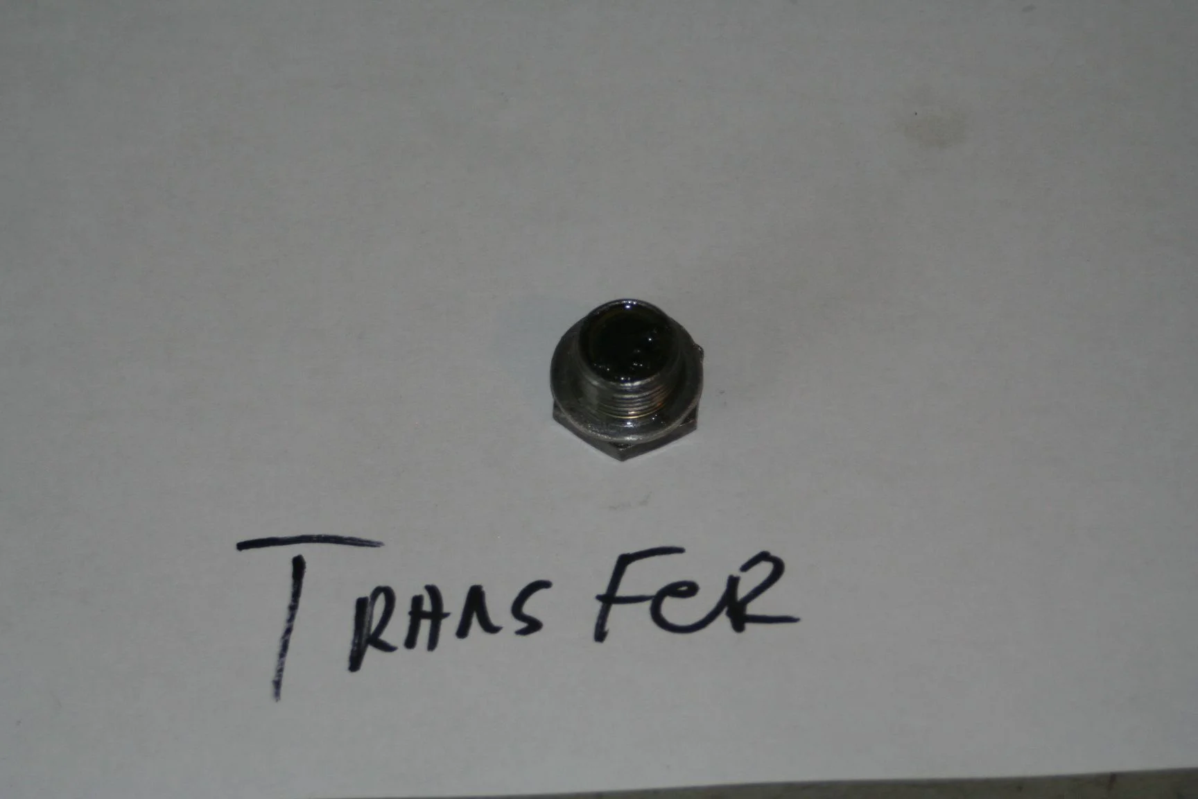

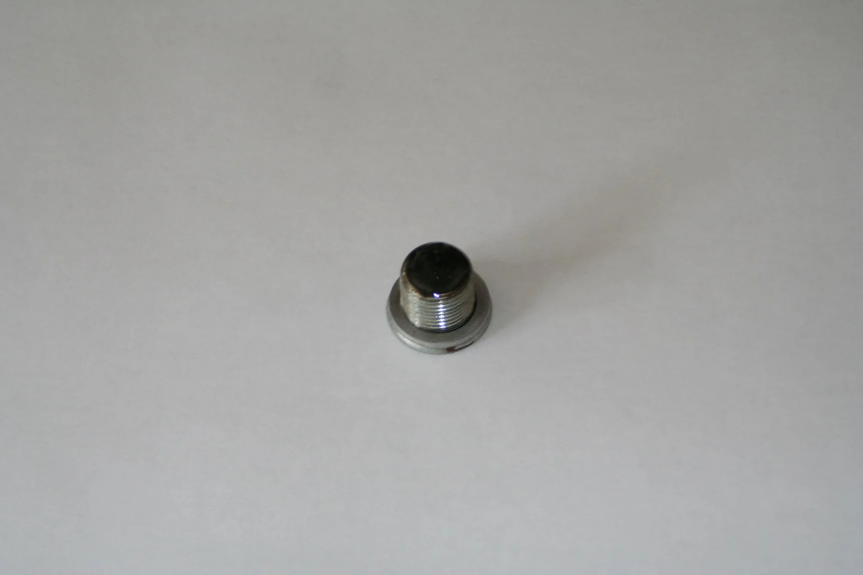

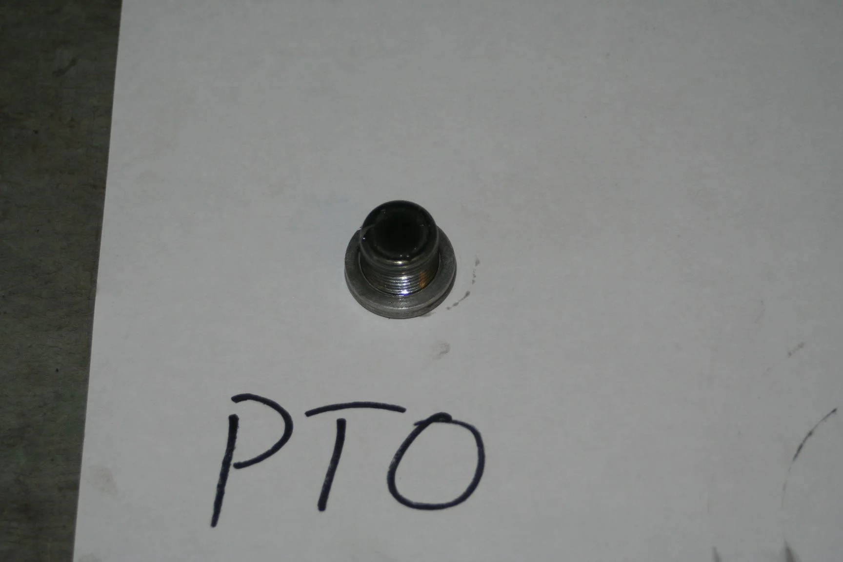

Pictures of the different drain plugs, unfortunately they didn't show up well. The Transmission oil was clear with just some metal sludge, common to see. The transfer case plug had sludge and several metal chips, the oil had a metal sheen with metal speaks in it. The PTO was the worst sludge and more chips, oil the same as transfer case. PTO was never used, so guessing transfer case has an issue.
The throw bearing looks and spins free and easy, clutch seems to work good, but will replace everything when pulled out.
