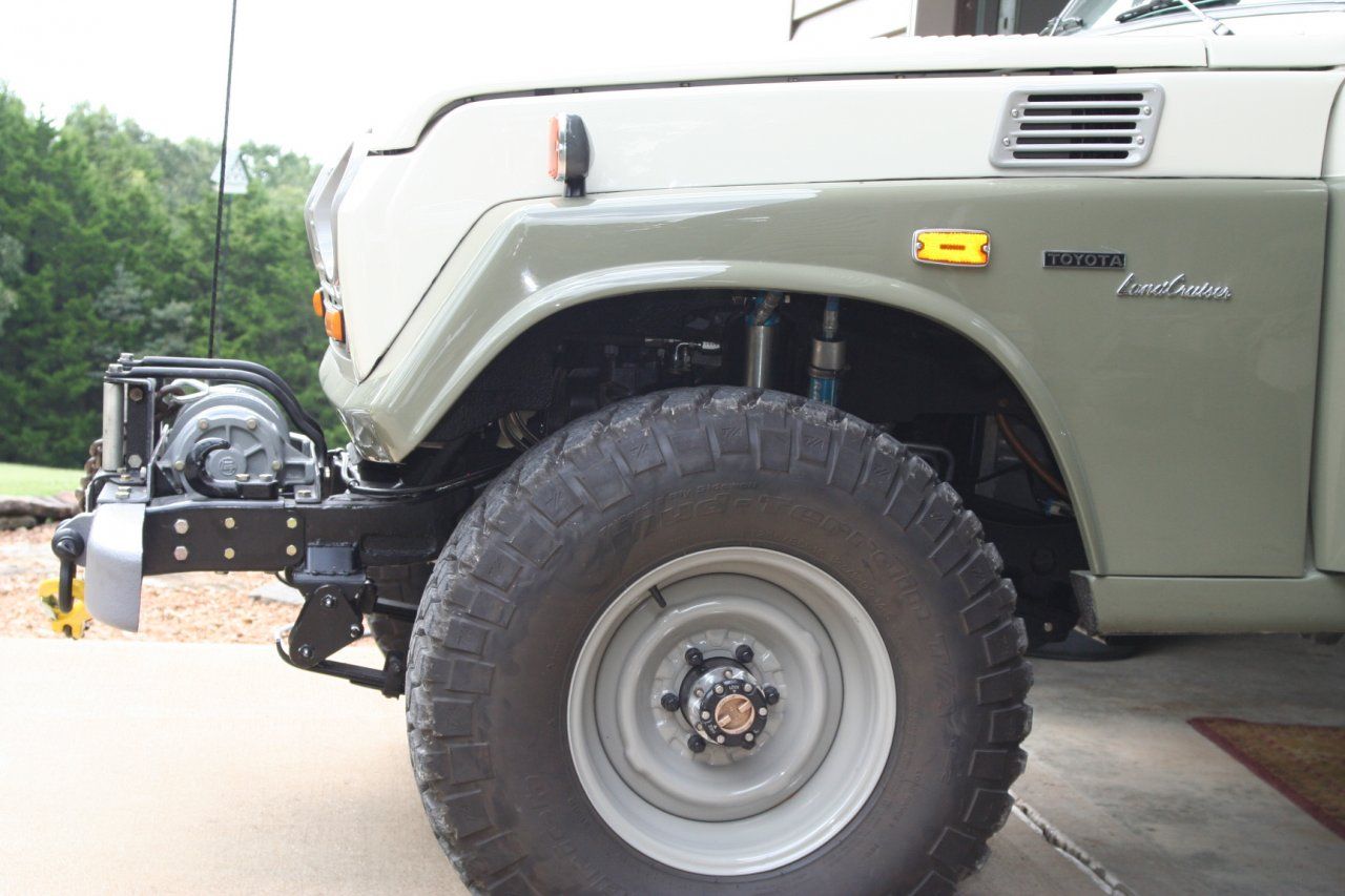

Well Guys, the plans have changed. I couldn't get in at Cruiser Outfitters until mid October to do the cut and turn, so driving out to Cruiserfest is out, which is in Salt Lake City also. We're packed and heading out to Wyoming in the morning for a couple weeks. Tent camping and just exploring dirt roads. I changed out the front u bolts for 5/8 bolts and put 6 degree shims in place of the 4 degree I had in. She drives perfect now, no wondering, etc.
The spring shop said to torque the nuts to 177 ft./lb. and I shouldn't have to worry about the dreaded "stretchy nut syndrome".
J Mack, I used the long ratchet with a cheater bar and put the smoke to them. I'll take some pictures and post up when we get home.

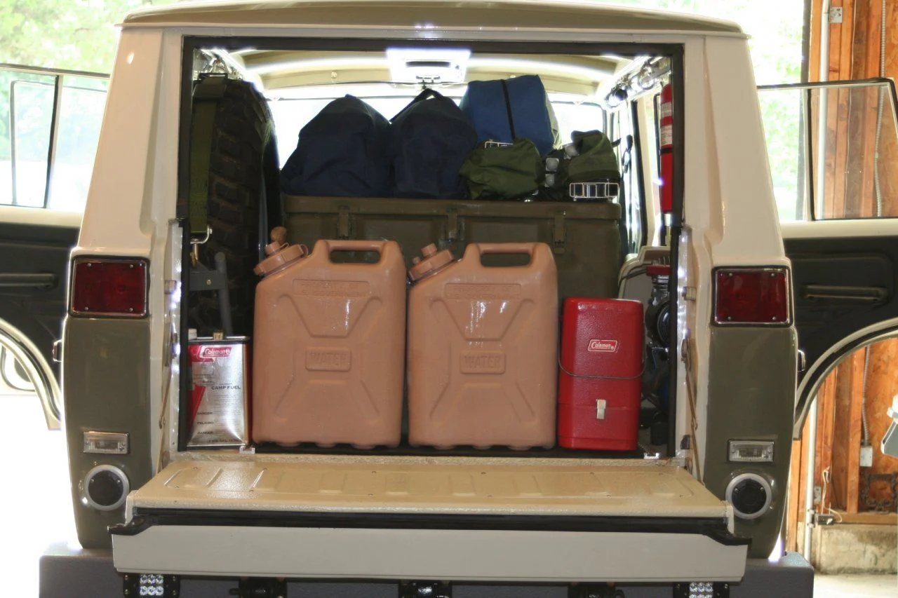

Talk to you guys in two weeks. She's packed tight! :)
