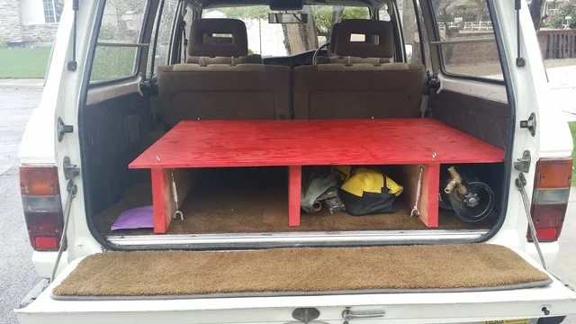

This is phase one of my build.
It has tons of room but will have a fold down portion with the 50/50 seats that will allow me to sleep one or two easily!
Yes I know the Left side is open so I can access the Toyota tool kit and jack.
