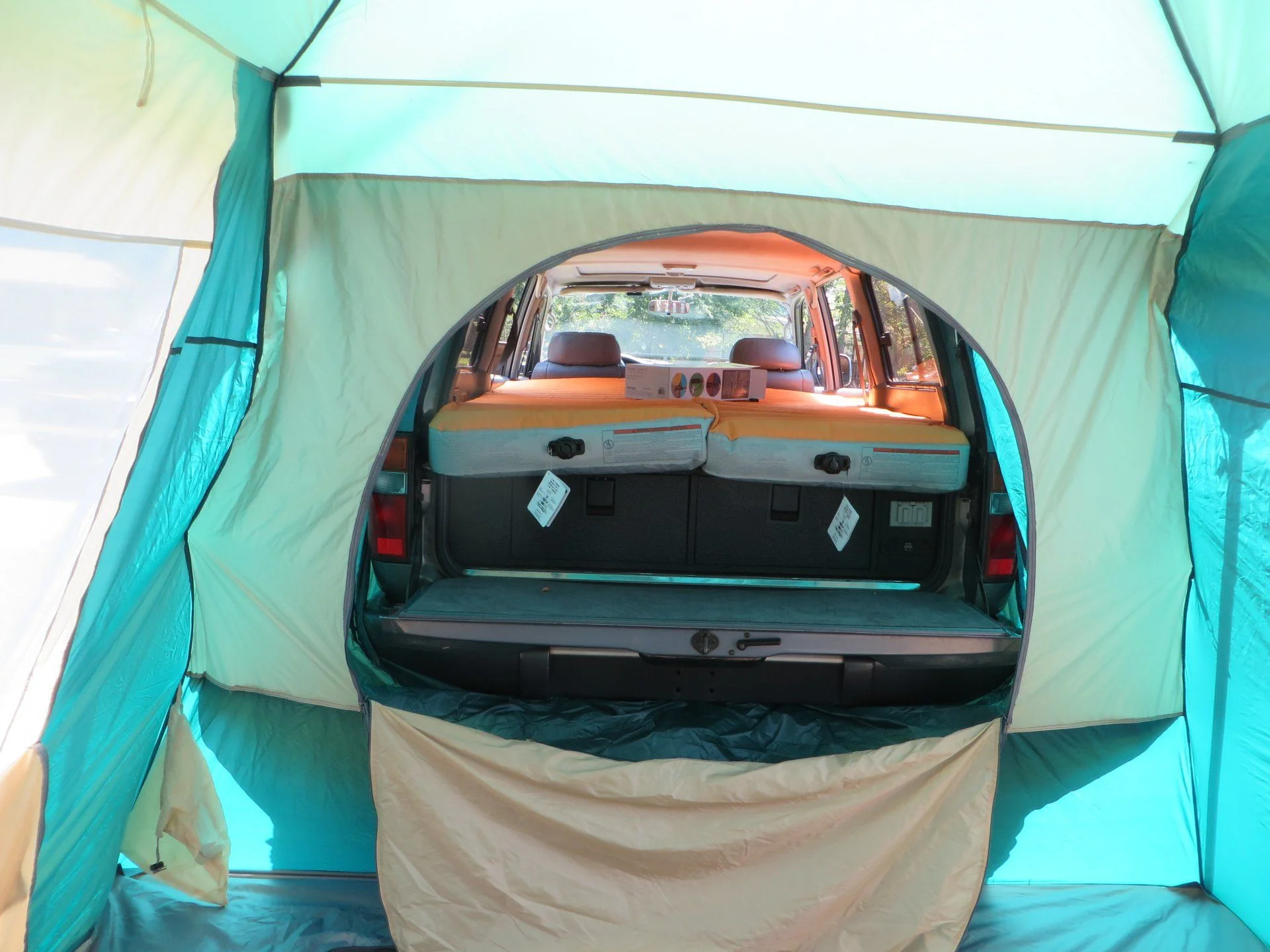

I love this set-up! I think I want this exact setup, but possibly slideable? So I can pull it back, when I want to put up the rear bench seat?
And when I want to use the full back area, I'll fold the bench down, slide this homemade deck forward and lock it in place. Then I would have 2 more rear deck sections, one to make full use of the rear compartment space to the closed tailgate. And a final section, that would add on and extend the deck onto the dropped tailgate.
Can I ask you? Where did you get that cool tailgate/window enclosure tent? Did you make that? I would like something like that, to keep the bugs and weather out.

Hi Jay... I responded to the pm comments but there's a text limit. Ya, if I were to build this again I probably would have built two separate longitudinal boxes so I could take one out for when "living" inside the truck. Getting in and out involves a lot of crawling around which gets pretty old, pretty quick. And now that I have a second Border Collie added to the camping mix I may really have to re-think this layout if I have to fit two large crates. Again, the tent is 1DAC large size. Fits the 80 perfectly but not sure about a 60 but it should be fine.

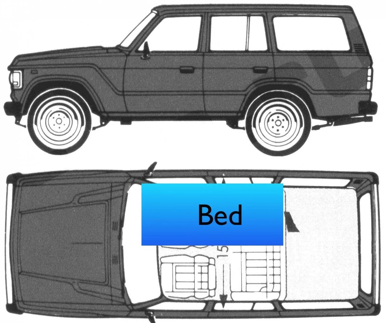

After perusing through this thread, I've noticed that everyone is setting up their sleeping arrangement in the BACK of the car.
When traveling alone, I sleep in the FRONT of the FJ60...On the modified and judiciously bolstered passenger seat that has been fully reclined flat.
The rear seat is removed from the truck, and the glove box lower support cut out to make room for the feet.
Stuff is placed on the passenger's foot well to create a foot support.
It is a most comfortable bed with a mid thick air mattress on top of the seat.
While traveling, bags can be placed on it, then when it's time to sleep, the bags can be placed to the side and you can literally just roll over into it.
The great thing about that spot is that you are facing forward with the back seat rest at your head. You can look out the windshield if you want and have plenty of head room. The rear passenger window is right next to your head so you can easily adjust ventilation.
I slept like that in the cruiser, car camping for two years in Baja MX and it was always very comfortable and relaxing.
It's also a good place for stealth quick sleeping, when you need to just pull over and get some sleep asap and leave first thing in the morning. Literally all you've got to do is roll over into the drivers seat, start the car, and drive.

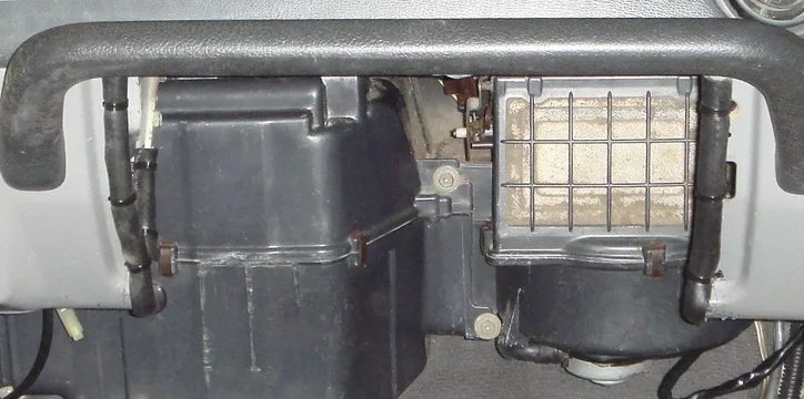

Got a pic of the cutout glove box though.
This is the spot:

The passenger's front seat hinge is modified so the seat will recline all the way flat. Stuff is placed under the back when reclined to support it flat.

I've played around with the idea of completely removing the passenger's seat for solo camping trips and building a dedicated flat proper bed in that location.. to have a flatter surface to sleep on, but the trouble of building something that was a significant upgrade didn't seem worth it, since I'm happy with how it works now.
I'm curious how you modified the seat hinge(s) to fold flat. Very cool!
I've got HJ61 seats in my 60 that I bought used from SOR in 1989.
They are the fuzzy velour upgrades with suspension brackets that we didn't get in the USA.
Bending the bracket to allow the seat to lie flat only required some determination and some Vice Grips. Don't remember exactly, but on that seat it wasn't difficult to modify.
