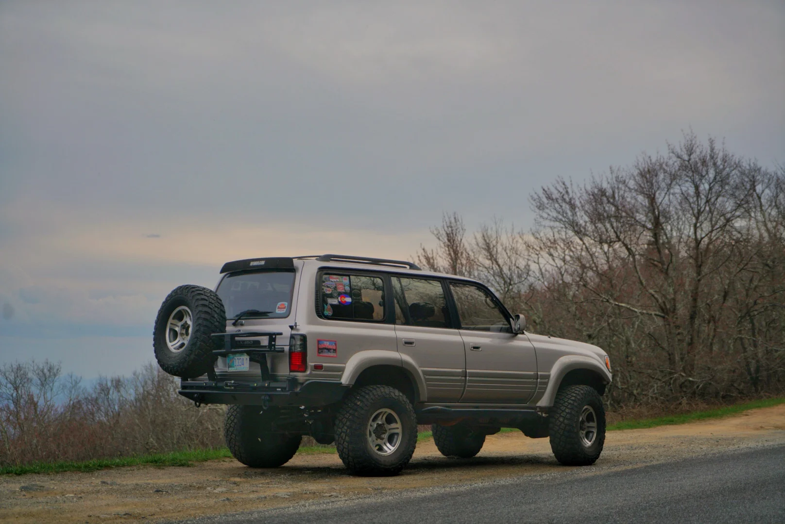

Here's how she sits now. I'm super excited to build it out and really use it for what it's built for!
