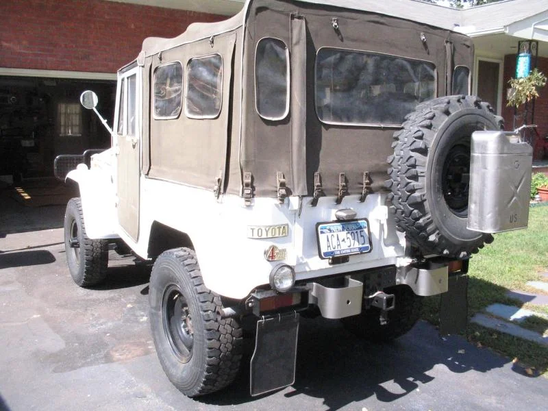

Here's mine modified stock tire carrier... And ice chest /Gerry can holder... Both swing out both attached to 2x2 steal cross bar bolted to rear frame
attachment.php
i prefer a more stockish look...and if i'm feeling crazy...i put the jerry can on the rear :)
Damn Johnny, I love your rig every time I see a picture. Who makes that can holder?
Thanks...
it's an old Conferr jerry can holder and bracket...
there are places that still make them...look up "Blitz Can Carrier" i think they run around $60 and you'll need the tire carrier bracket i think someplace around $30 for that
