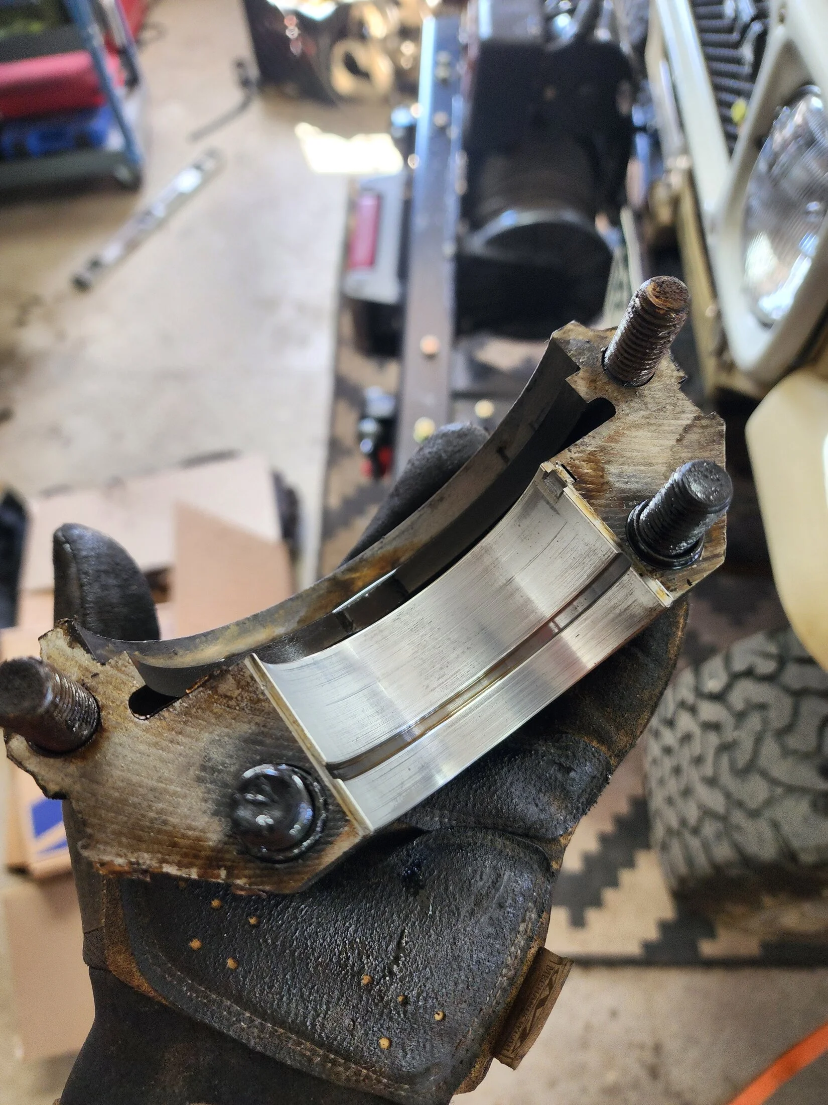

Replacing my oil pan gasket and rear main seal. How does this bearing look?
also should I use fipg on the cap when reinstalling it?
That bearing wear looks odd to me. I am no expert on bearings though. Does it look like there is more wear in the center (bottom) section? If so, it might make me wonder if that was the correct size bearing for that crankshaft? what year engine?How does this bearing look?
82 2f. fj40That bearing wear looks odd to me. I am no expert on bearings though. Does it look like there is more wear in the center (bottom) section? If so, it might make me wonder if that was the correct size bearing for that crankshaft? what year engine?
