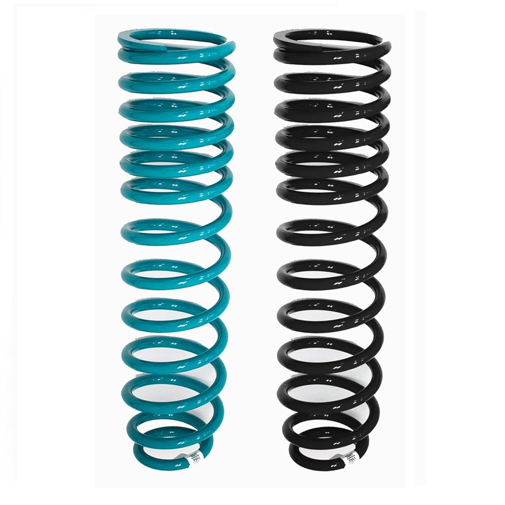

They may have expanded the part #. Or maybe my sig line is wrong. Here they are:
Note that Dobinsons markets these as heavy duty/weight 3.5” lift, but being dual rate coils they ride perfectly at low weight. I have a 38” spare in the back plus tools and axle shaft spares so there’s some extra weight, just nothing up front - that’s why I get 5.5” out of them although you’d need to be maximizing weight to get them anywhere near 3.5”.

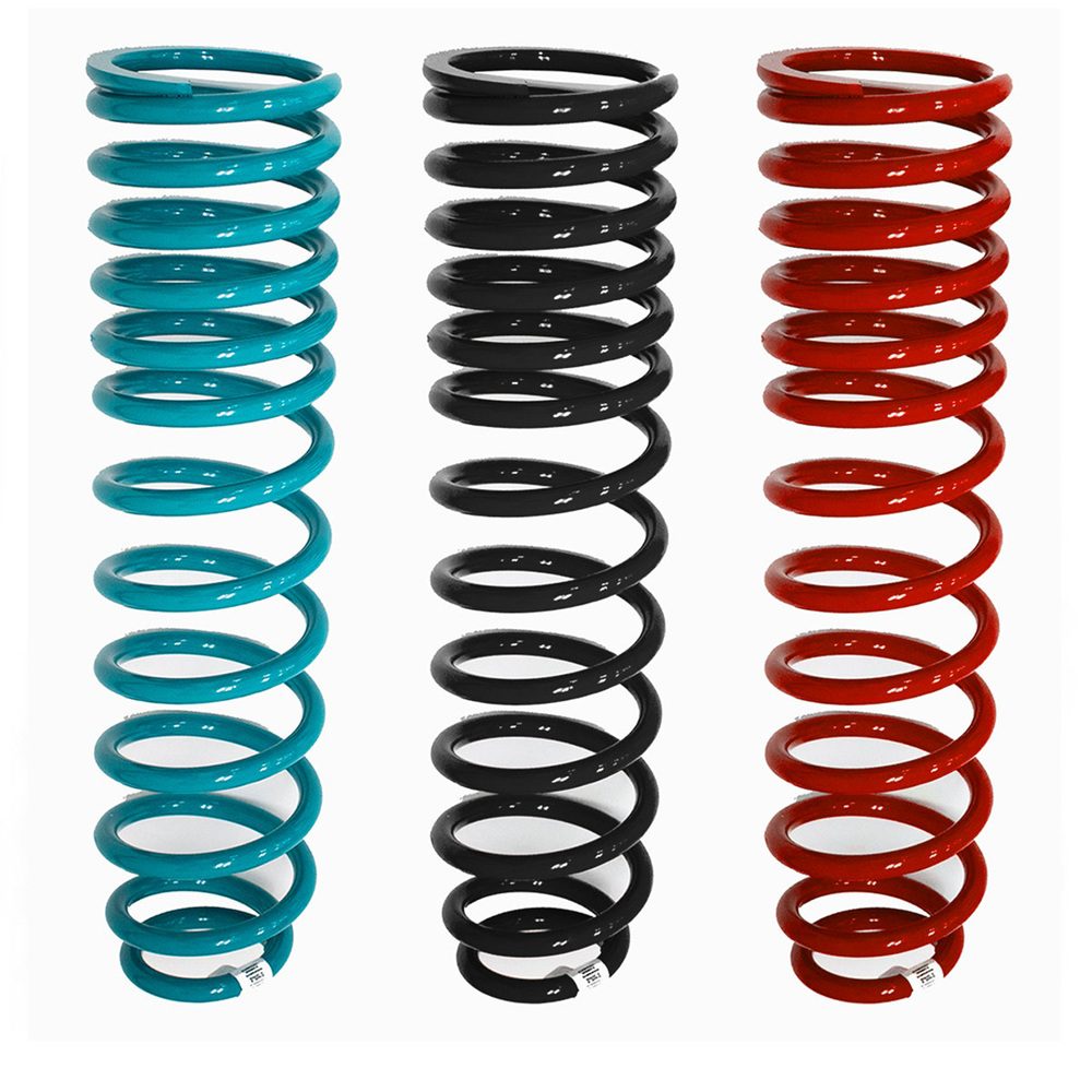

I'm on the first gen C97-146-&147VT's with 4-5" IMS shocks. They are rated as 2.5" but I'm pretty light (bumpers, winch and sliders) and am netting about 3.25" and sitting on 35's. Call this a shorter version of Nay's setup, although I still have the sway bars (dropped) front and rear. She's a DD that see's off-piste a few times a year and I'm happy. Found the springs lightly used on MUD for a song and added the shocks. Just another option that's shorter but that still has a lot of travel.
Are the coils Dual rate like Nay’s 3.5 VT coils? They don’t say Dual rate in the description? Does it matter/make a difference?
  • Dobinsons C97-147VT 2.5″ lift with 440lbs weight (lifts more with less weight)
  • Dobinsons C97-146VT 2.5″ Lift Variable Tapered Long Travel Heavy Load
