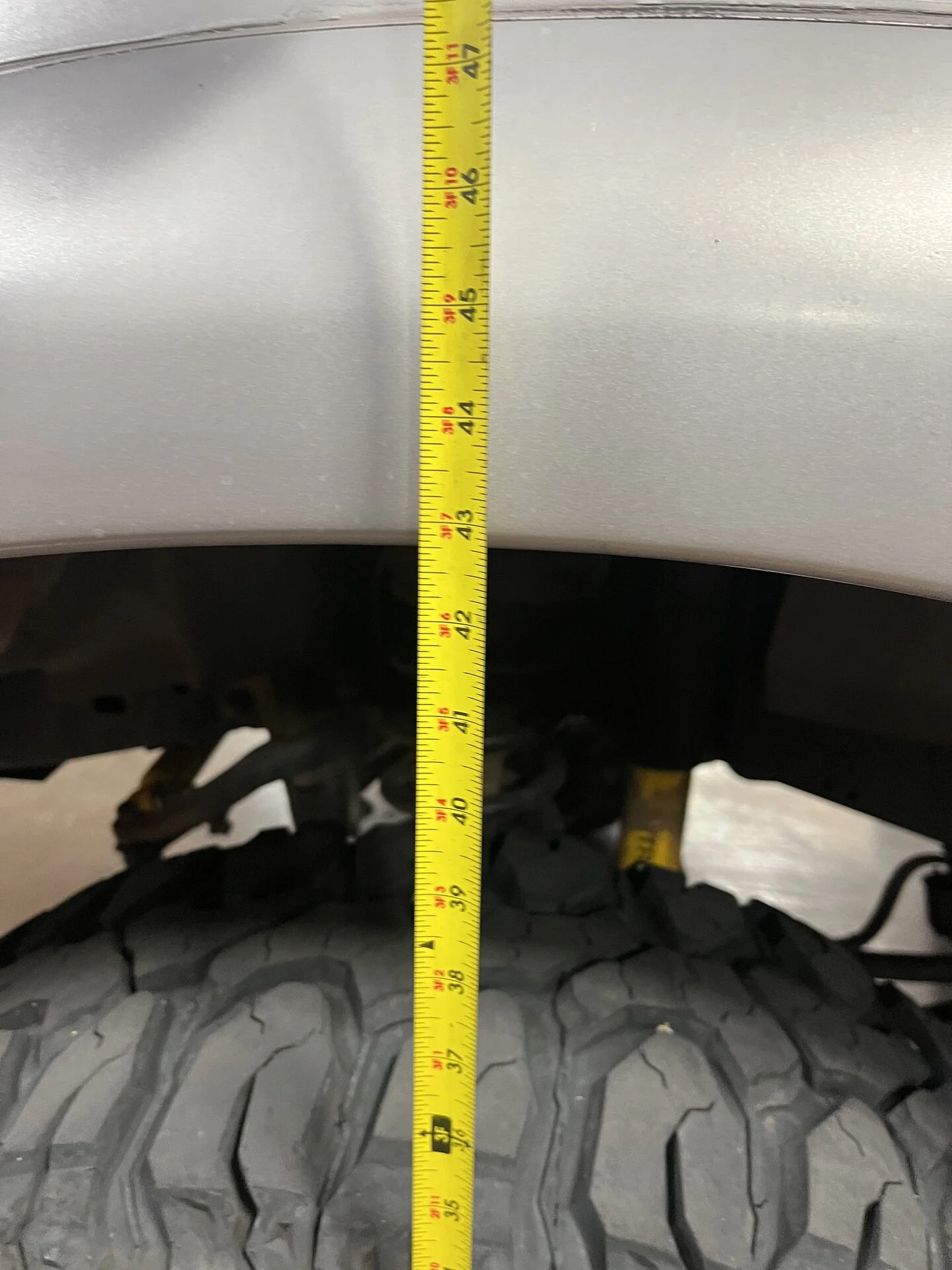

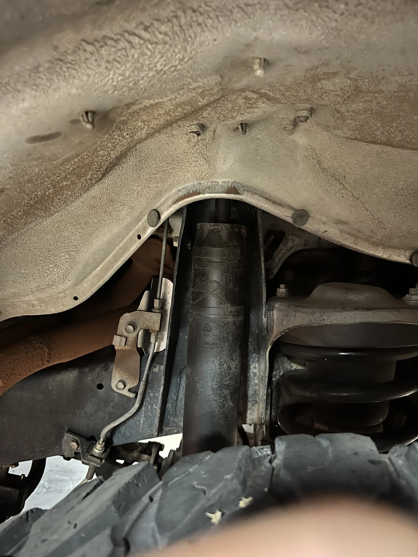

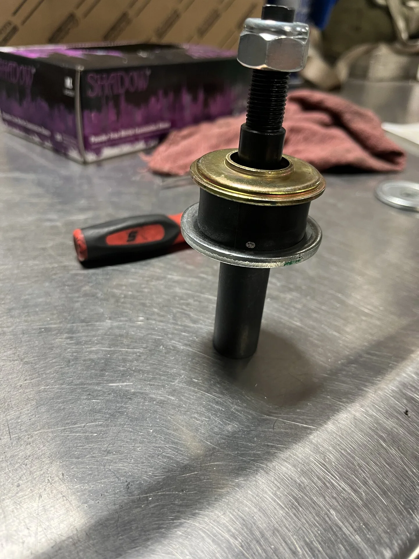

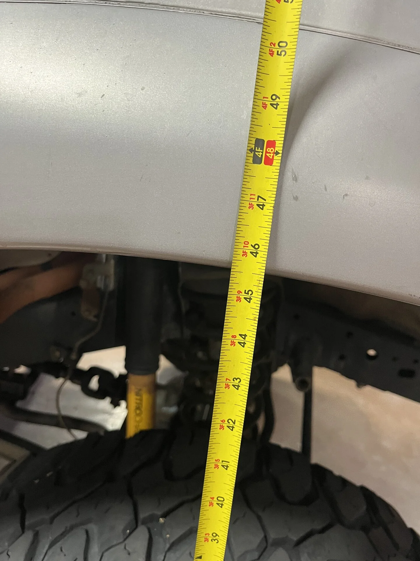

So…. What I ended up doing is just adding shock ext’s on the front. Almost 3” more straight droop than before. We’ll test out sat. And it still rides the same of course. And m pretty sure this puts me at L length if not a little longer. I forgot to measure. “Rushing”
This works great!! Btw. Thinking of adding a pair to the rear now. According to the dirt line on the shaft with stock bumps I still have 1” of shaft left. So they aren’t bottoming out either.
Rear extensions cam in hope to install this week and check for coil looseness.
