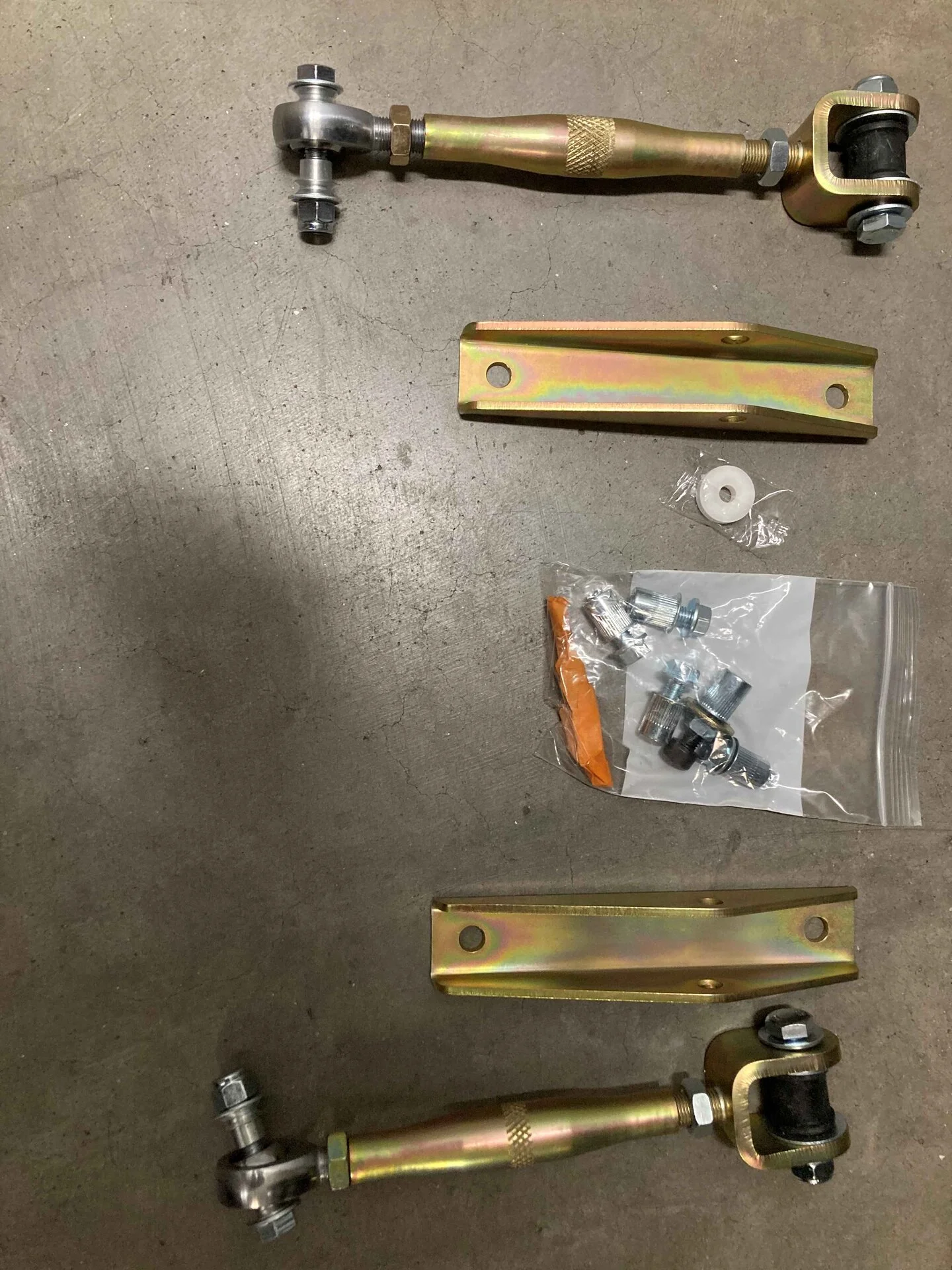

Do you have your front sway bar connected? You can gain some extra flex up front with disconnect kit from @LandCruiserPhil

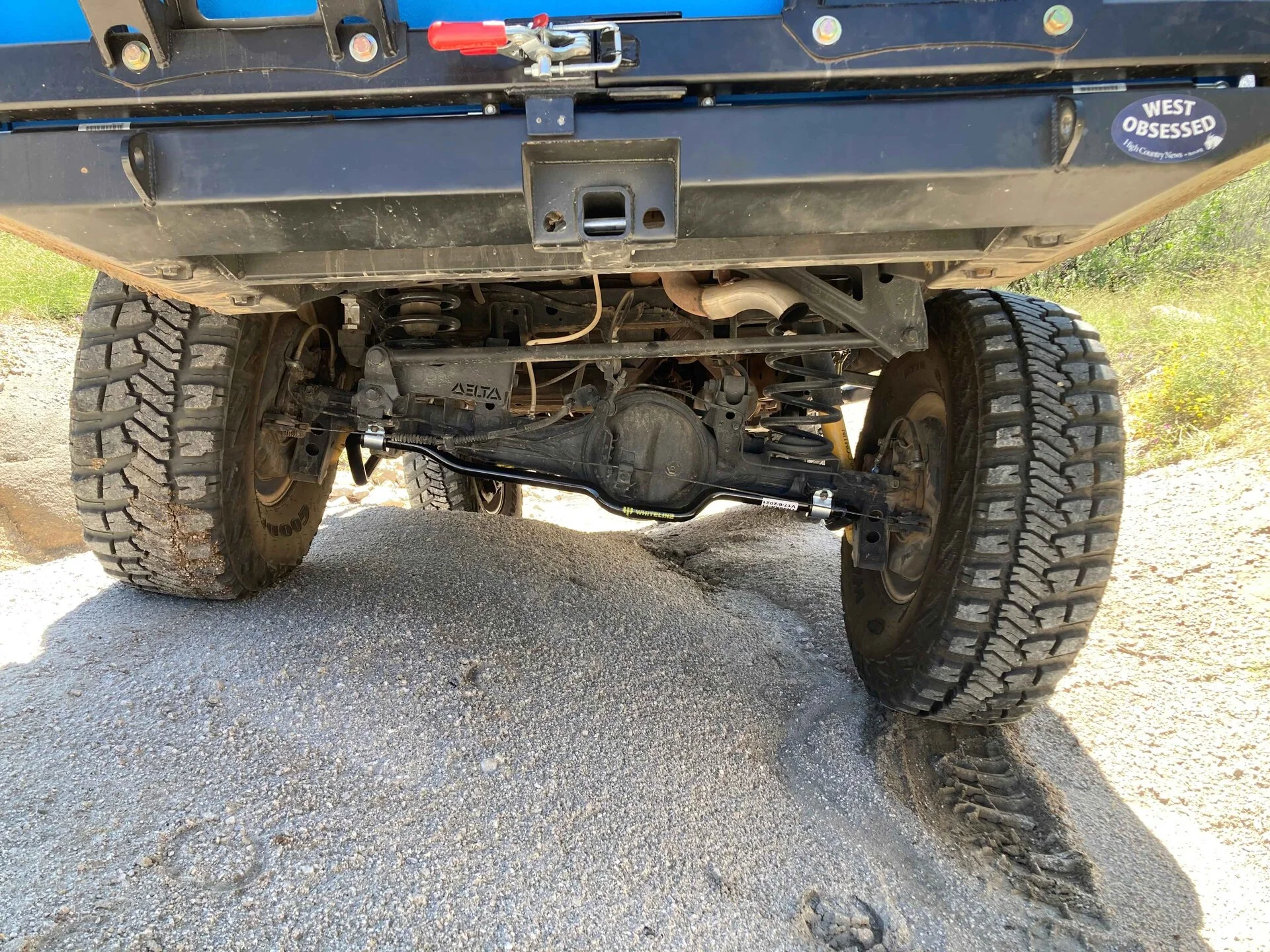

I have also found that the rear sway bar really limits droop in the rear. I have had mine removed for years now with no noticeable detriment to road manners. However, I do not recommend removing the front sway bar. I had mine removed for a brief period due to partially tearing off the axle mounts, and the road manners were horrible, almost dangerous. But again, the rear sway bar is long gone.
Pic is with 36" Swampers. Daily use is 315/75R16 Toyo AT3.

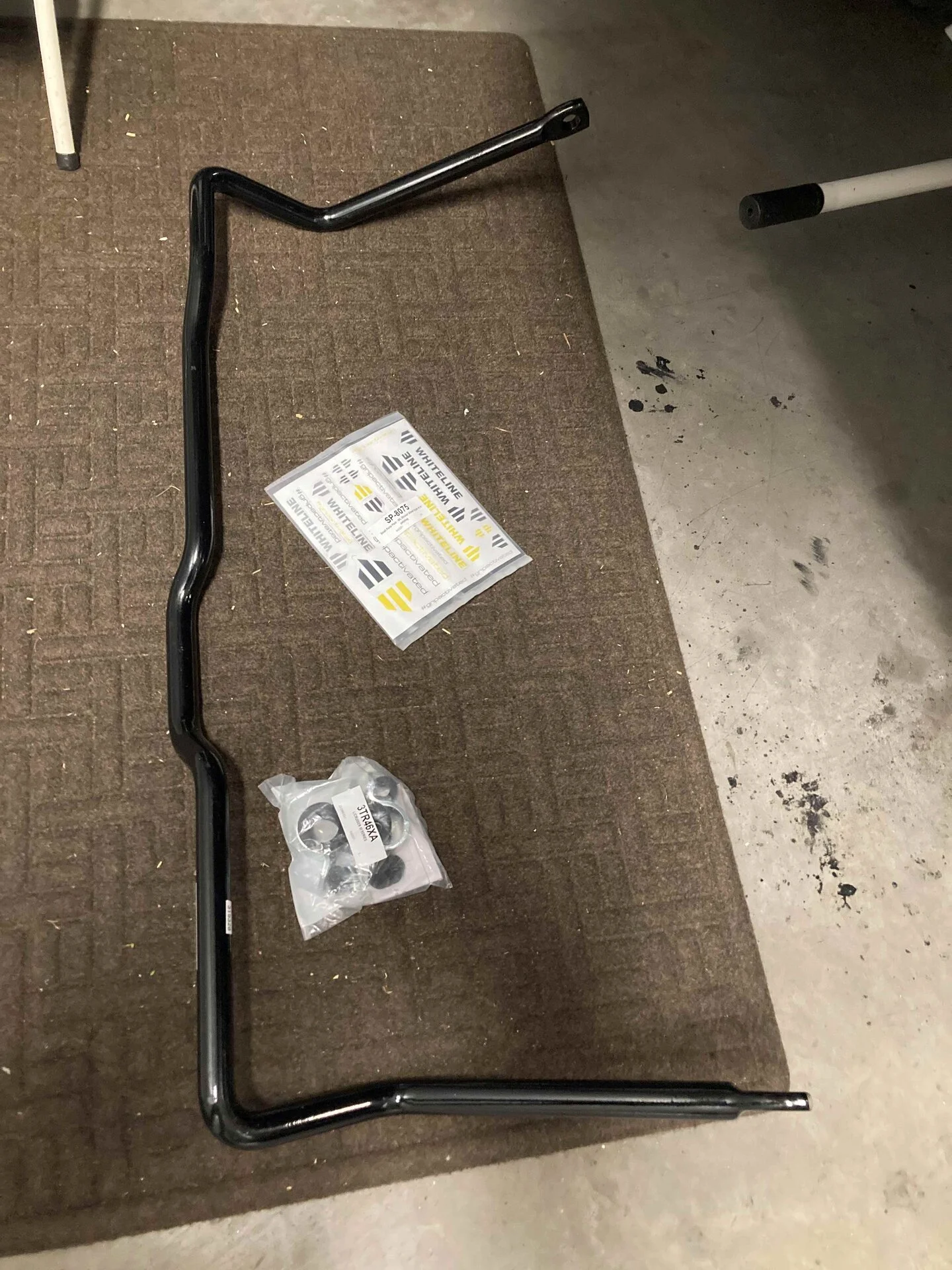

Get the LCP front swaybar disconnects and a whiteline rear swaybar (approx 15% stiffer) with the stronger LCP rear swaybar links.
More bueno than no rear swaybar and more control in rough ground. Can still stuff my 37s. And no rubbing in the front with disconnected swaybar on w/37s either.

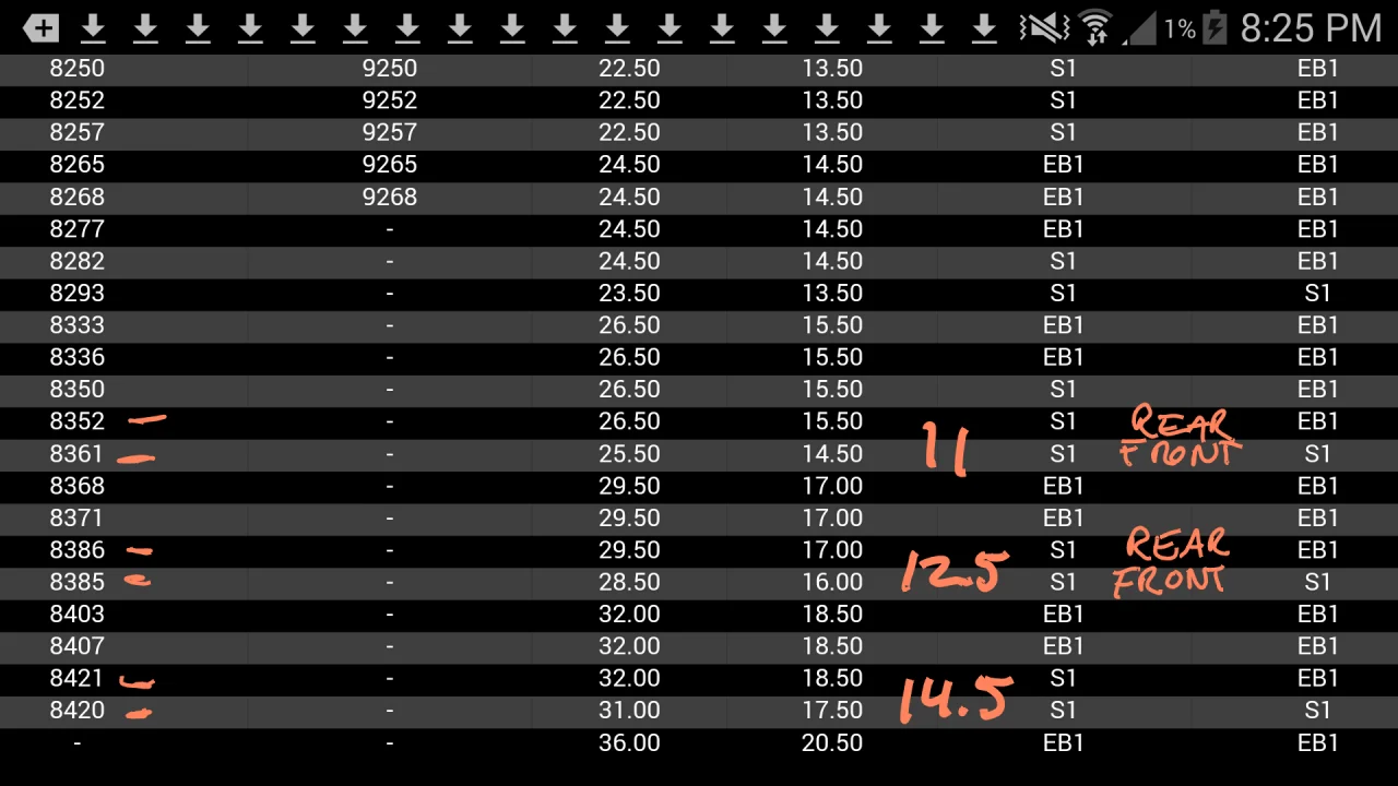

You have to limit uptravel a little bit for the longer compressed length of the shock. The compressed and the extended length for bolt on options for 80s is in the suspension sticky made by gwnugget

If you run smaller than 37” tires you may need to drop the front bump stops an inch so as to not bottom out the shocks. I’ve been running 37’s since 2017 with 6” lift shocks front only and the tires dictated how far I dropped the bump stops not the shocks.
Also consider that you run the risk of completely unseating a single rate spring when the shock is at full droop. 6” lift shocks are normally recommended to be used with long travel, dual rate springs when the advertised lift is something much less than 6”, say like 3”.
