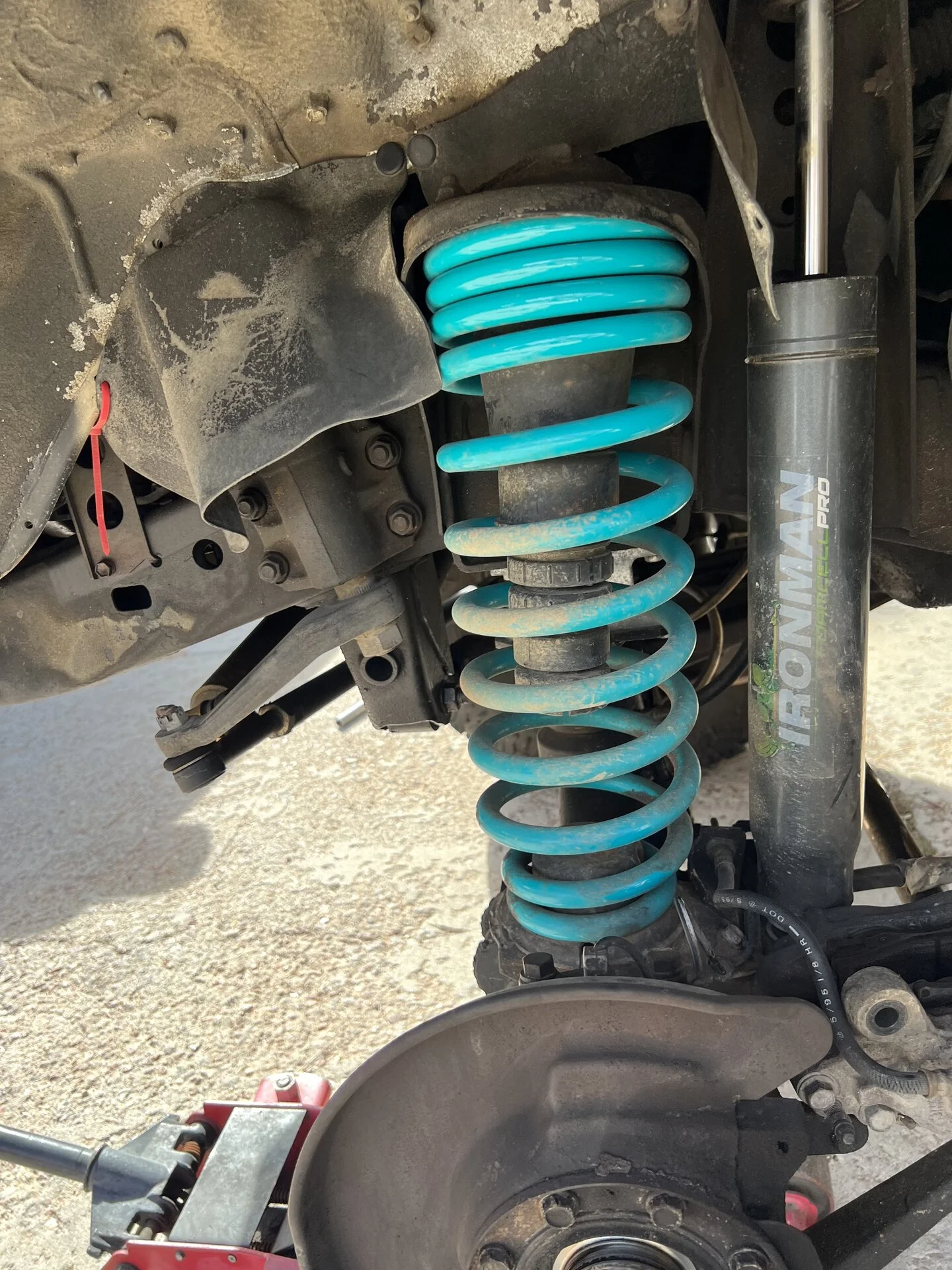

Higher end dual rate coils are not very expensive and dual rate coils function a lot like sway bars without the downsides. They are longer and will stay in a travel sweet spot throughout travel range - this provides exceptional stability and balance off-road.
Dobinsons is a good place to start. Ignore all the triple rate and tapered stuff it isn’t necessary for a basic build. I don’t run sway bars at all and I promise it is nothing like your XJ (I’m a founder of NAXJA :hillbilly:).
Here’s a view of a dual rate coil. This is 5.5” of lift with 6” lift Foam Cell Pro shocks.

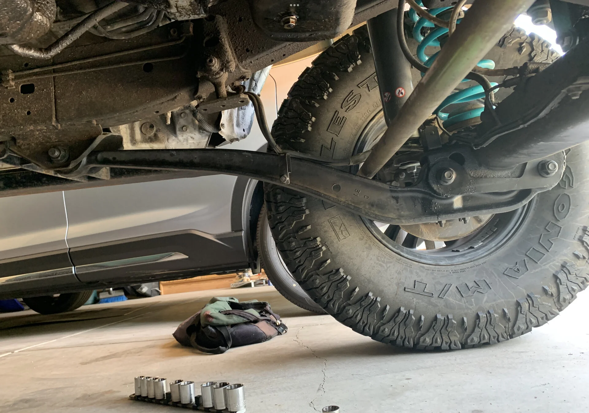

I run stock radius arms with @landtank caster plates, no trimming or other stuff - 38’s with no front fender trimming, my rear quarters are chopped and have been since I first ran 37” Trxus.
The factory arms are ideal when used with these caster brackets as the angles become flat under the axle on taller lifts (and they are free to you). Pinion angle is set for a double cardan driveshaft.

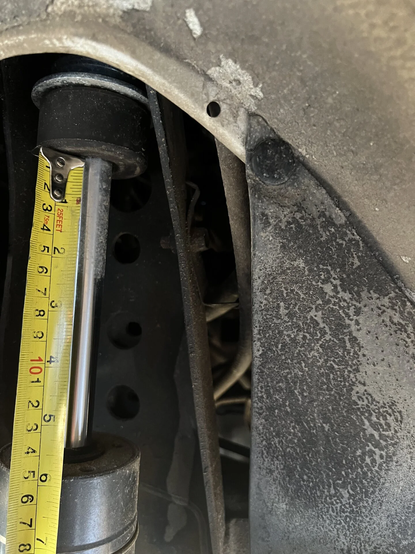

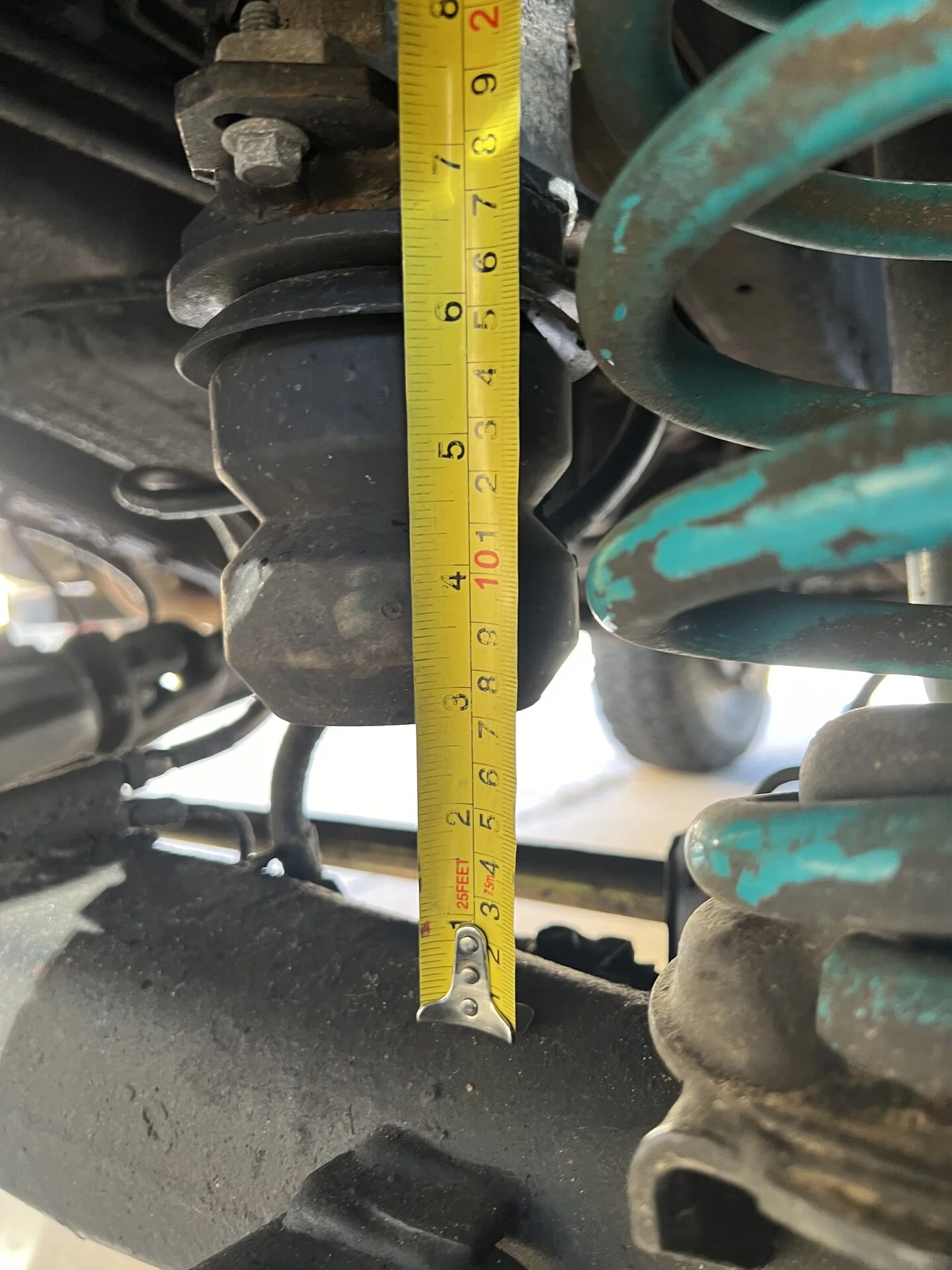

It’s tempting to think that. I design my suspensions to run as close to 50/50 up/down travel as possible so both the shock and the coil are in the sweet spot of their travel.
This is the front Timbren bumps. They will squish down to allow about 5” of travel at the bump.

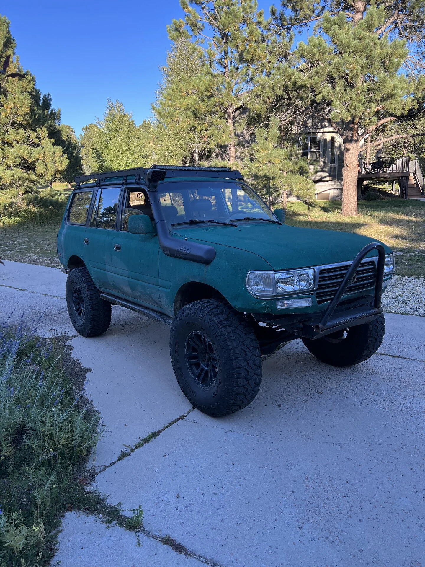

This is the available shock up travel.
I’m using all but the last inch so this setup is running 5” of up travel and 6” down (not all of that is useable with 80 series radius arms). I don’t try to engineer long travel into an 80 series - the 80’s superpower is its stability and the amount of traction is puts down, not super flex. Of course you can spend a lot of money working on both, but with upgraded upper and lower and rear control arms and adjustable panhards this ~$3,500 of suspension and that’s with $300/ea shocks.

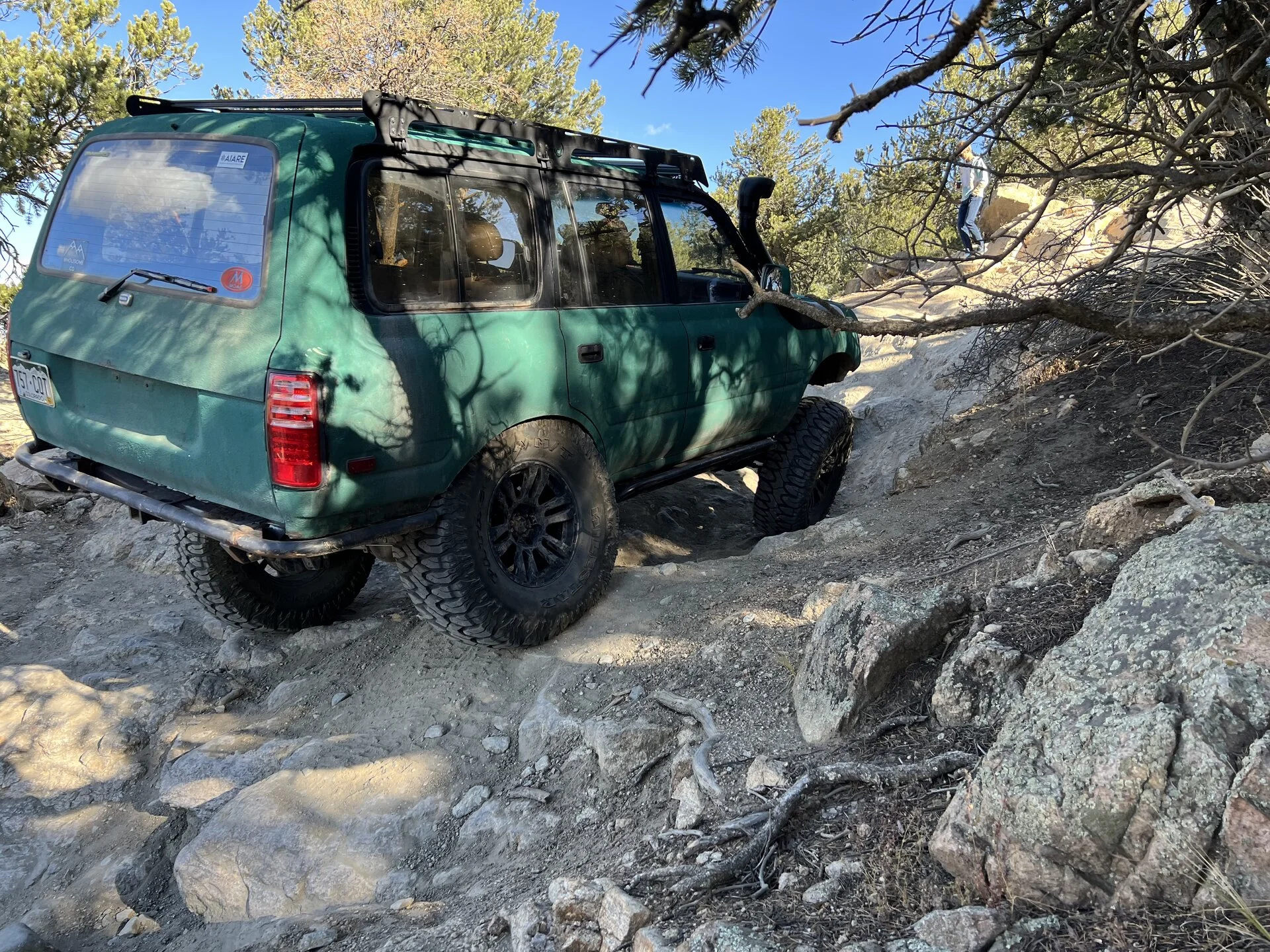

Nothing is rubbing in this picture. For reference the Patagonia 38x13.5 is as big as the BFG 39x13.5 KO2. We just had them side by side with the Ko2 unmounted and the Patagonia was a bit larger mounted on the rim. There is a lot you can do with how a rounded tire tucks into a wheel well vs a squared shoulder tire that doesn’t tuck. I also have custom 3/4” wheel spacers from BPOR.
