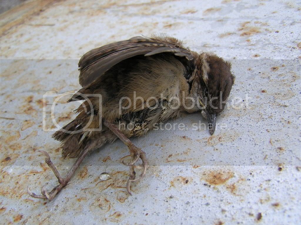

I was wondering where you were after pouring through Mel's post, and nothing but bird c#*p pics? Been following this thread with envy for a while.
Keep yer head up man she'll come together, diesel 60's are the tits ;)
I have no idea how long the little feller was in there, but based on what I know of avian biology, probably 4 or 5 days until dehydration. It was in the back laying on top of a pile of parts. Poor bastard.

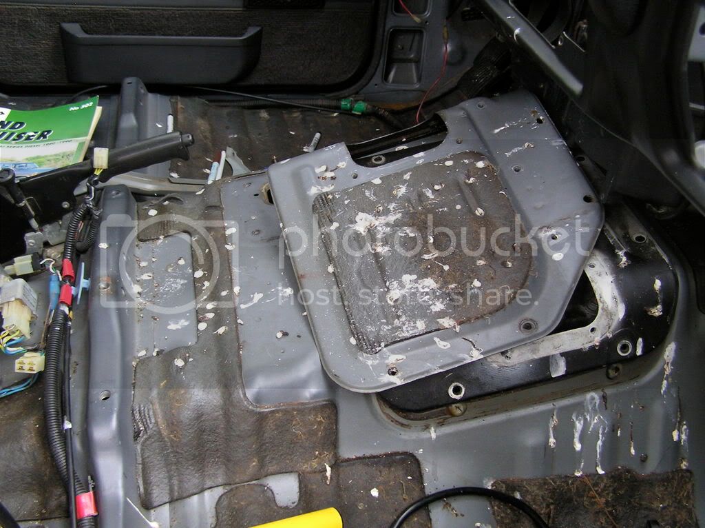

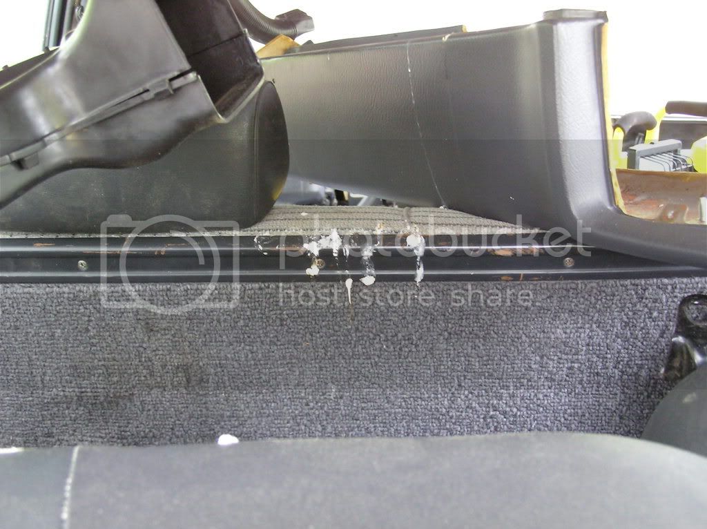

As you can see from the last post, this project has stalled out so badly that I have had to remove several birds nests from under the bonnet. Seriously.
