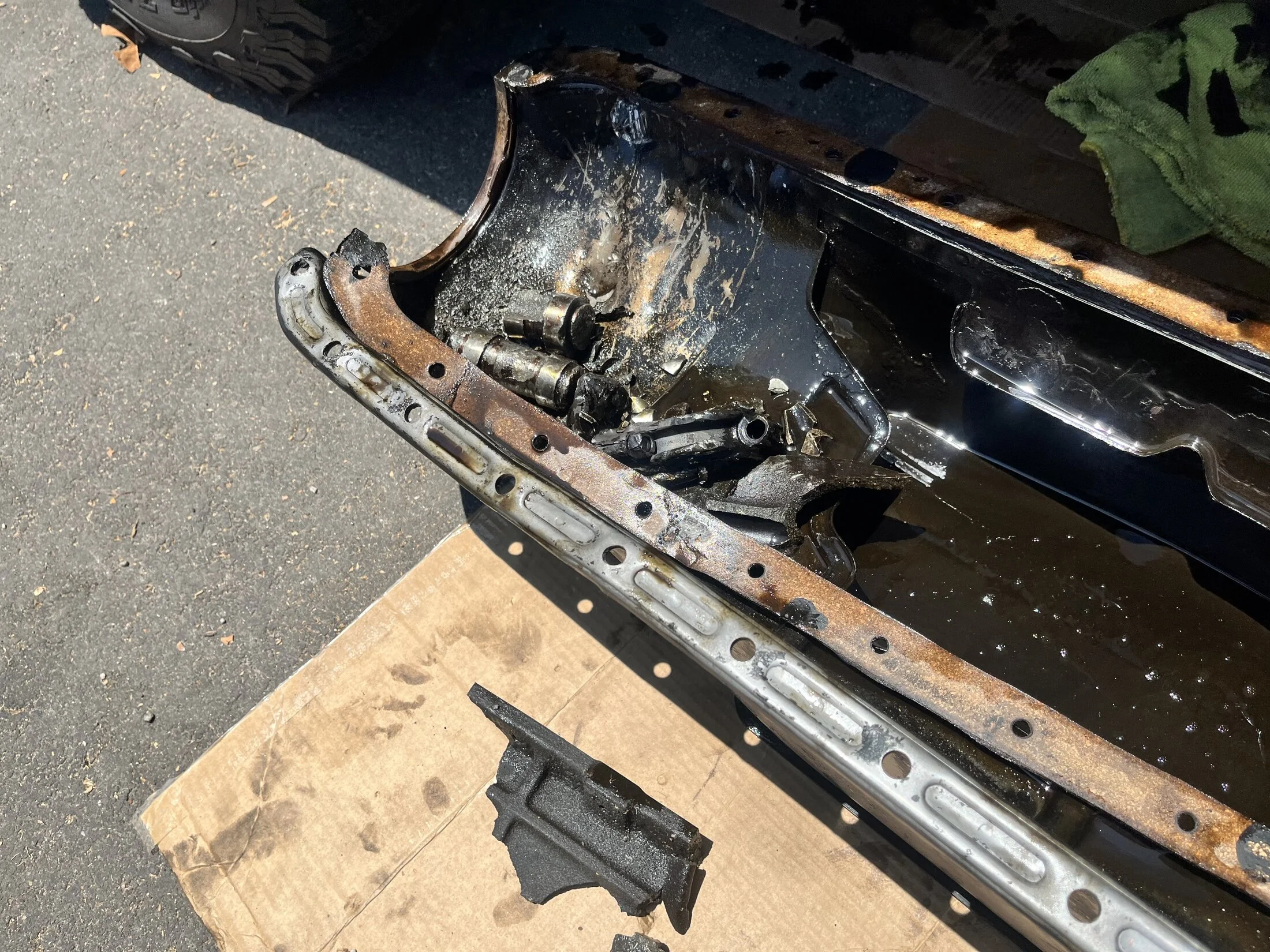

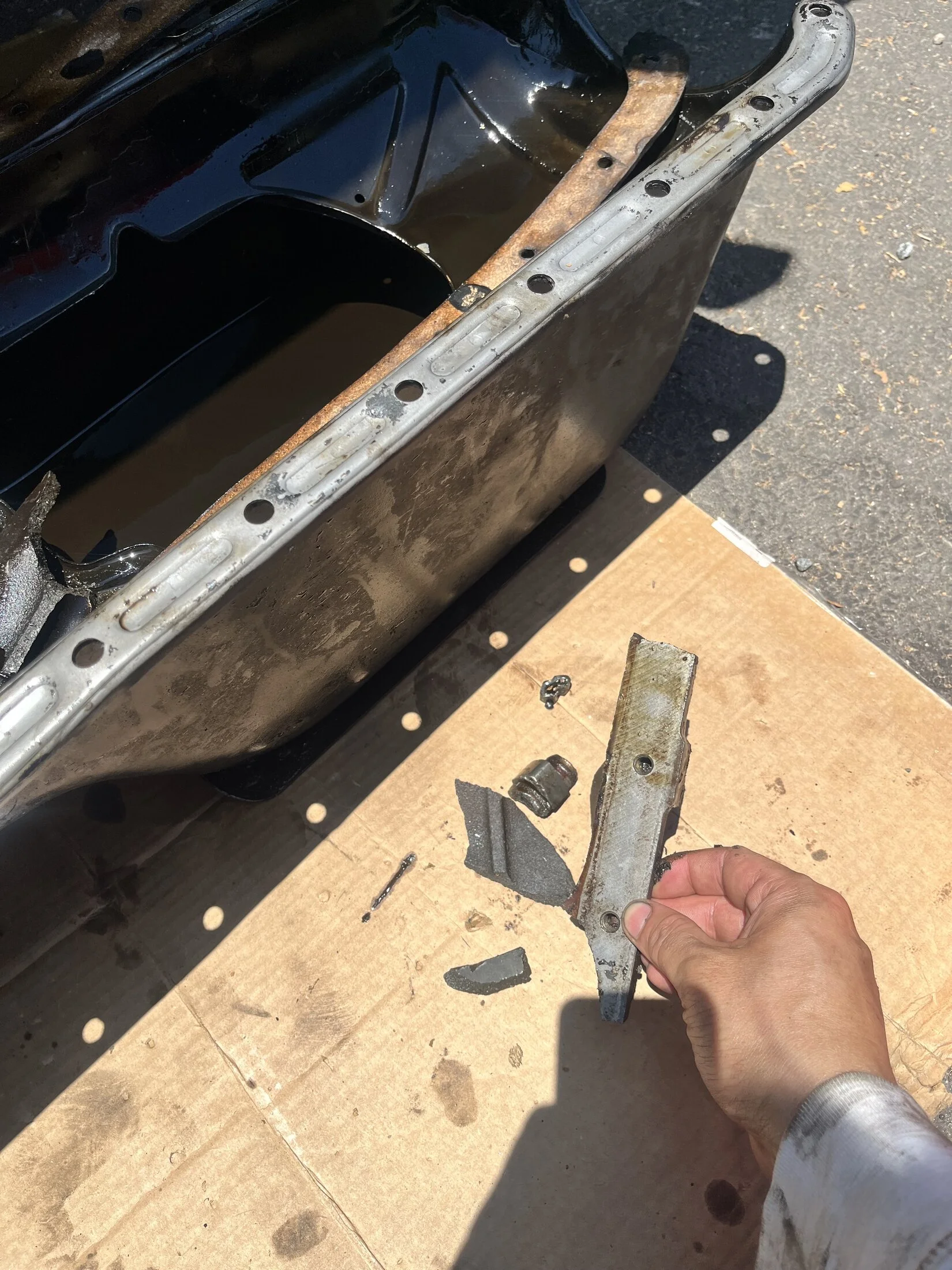

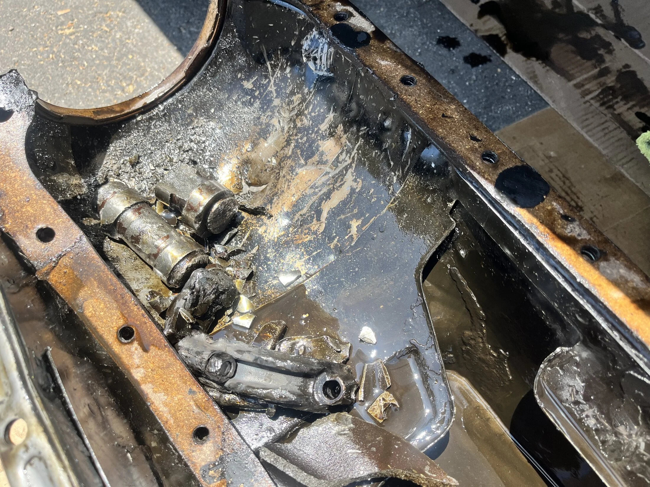

A fun Fourth of July update 💥 Getting the pan off was a real pain in the ass, since the hole that blasted out the side managed to be right where the last single bolt was. Spent hours with limited space, a hammer, and a punch trying to knock it back to get access, only to see the bolt warped. I can't imagine the lateral force that bolt took to warp the bolt head. Once I got the bolts off, the oil pan jingled and rattled like a set of janitor keys. A couple of pieces of the engine block dropped down on me as I was trying to shimmy the pan around to detach it. In some twisted way, I was excited about what kind of untold treasures awaited me...

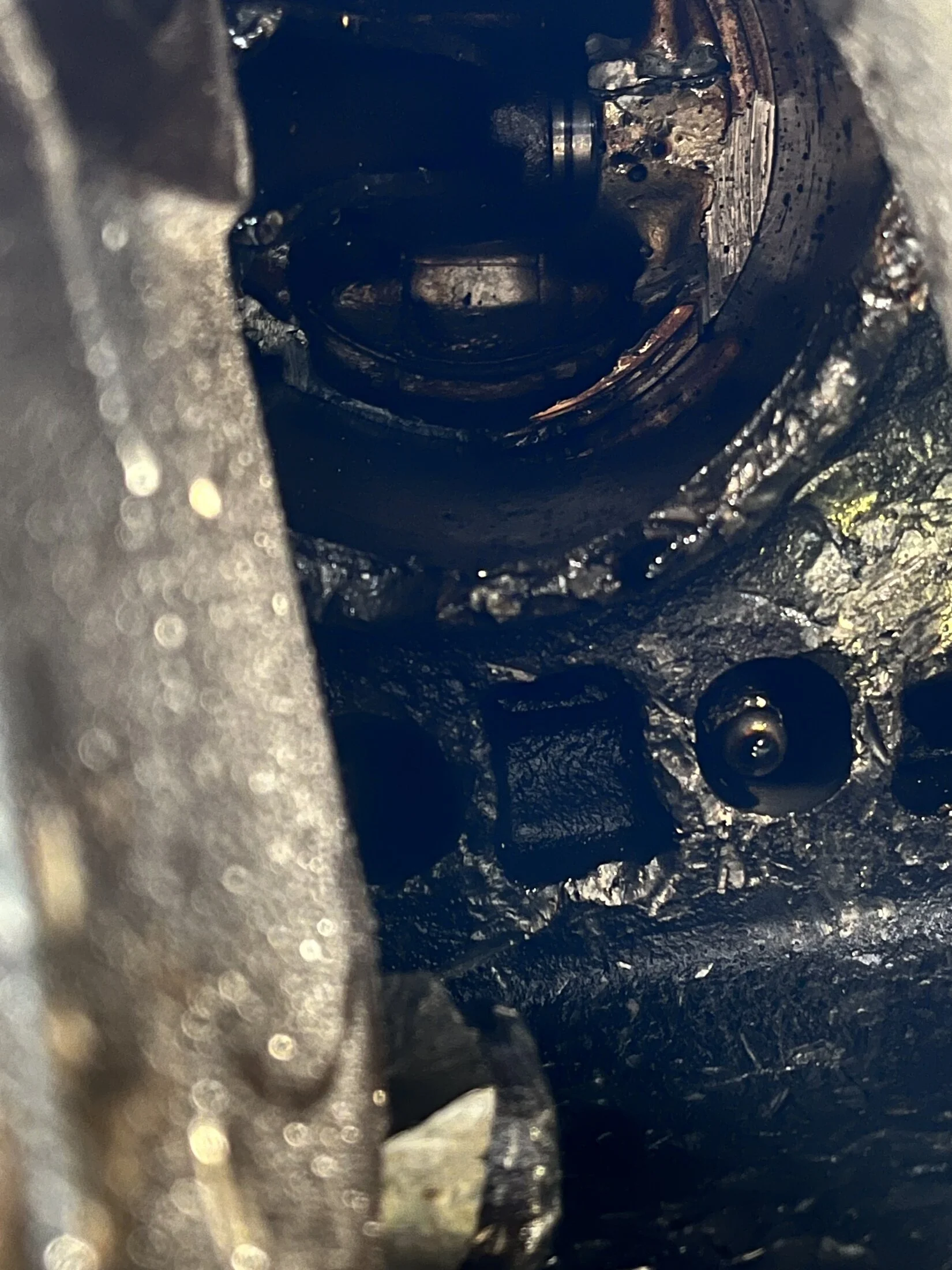

So now I'm left playing back at how the camshaft completely broke. Draining the metallic oil pan revealed a couple bent pushrods and more shards of metal. Tried to get a couple of shots inside the cylinder 1 and 2, to see how the pistons were... which didn't look great either. Any guess from folks at what could have caused damage like this?

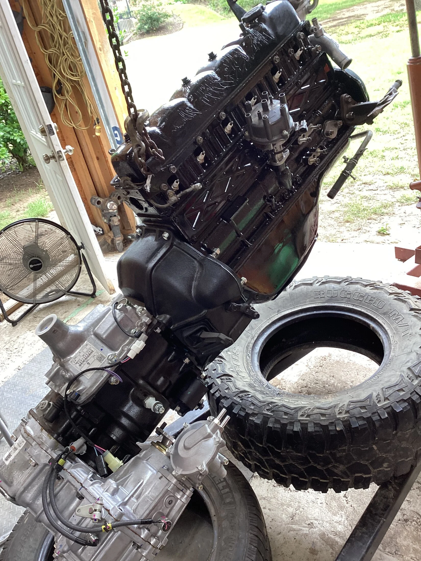

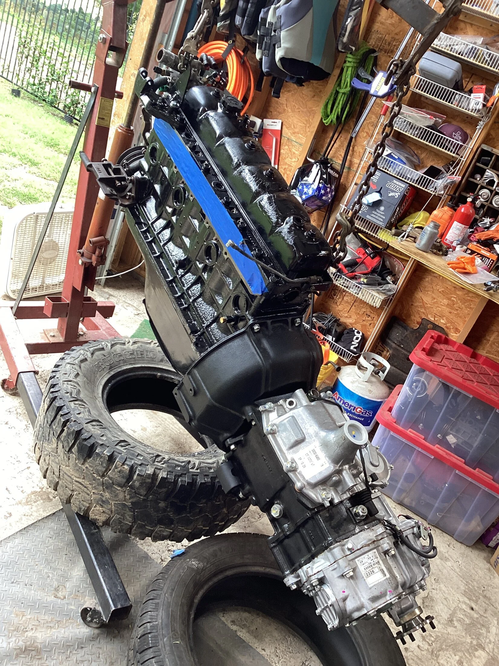

As for next steps, the hunt for a replacement continues. I'm leaning towards replacing with another 3FE. Just torn between whether to find used one to drop-in, a used one to rebuild (or already rebuilt), or a remanufactured 3FE. In the meanwhile, I might just start taking apart the engine accessories bit by bit and get intimate and familiar with it. Maybe just pull the engine out myself? I've never done stuff like that before, but figured why not. Would that make it harder for someone else to install a new long block or engine?

Looks like the #1 Rod Cap let loose, then caused havoc when bouncing around - I've seen those rod cap bolts break before. Not common, but enough that people have tried replacing them with similar ARP bolts when engine is rebuilt. There's a thread or two on here, somewhere. IIRC, they had to use something for a Supra? and shave the bolt heads.

For the “what caused it?”: I’d lean toward the front of cam broke causing the bent pushrods you have, not bent pushrods causing cam failure. Cams don’t typically break so I’d be thinking a rod or 2 let go and took out the cam and block, which took out pushrods, etc. It’s always possible something in the valvetrain like a really loose rocker, caused the pushrod to jump out of socket and bend but unless something very immobile stopped the front 1/3 of the cam spinning, not convinced it was a top to bottom failure.

@Spike Strip I recall that thread about using Supra rod bolts as well. Definitely remember something about having to shave the heads down too. It’s interesting that 99.5% of these stock F-family motors run just fine on the stock rod bolts … and then every once in a while one lets go.
ooooffff. I’m sorry. I wouldn’t beat yourself up thinking you did something wrong. This looks like others have said that a rod cap bolt let go and given the mass of the rod cap, it’s let go in the correct position to exert maximum damage based on its trajectory. The good news is that sourcing a short block being that you are on the west coast is easier.
