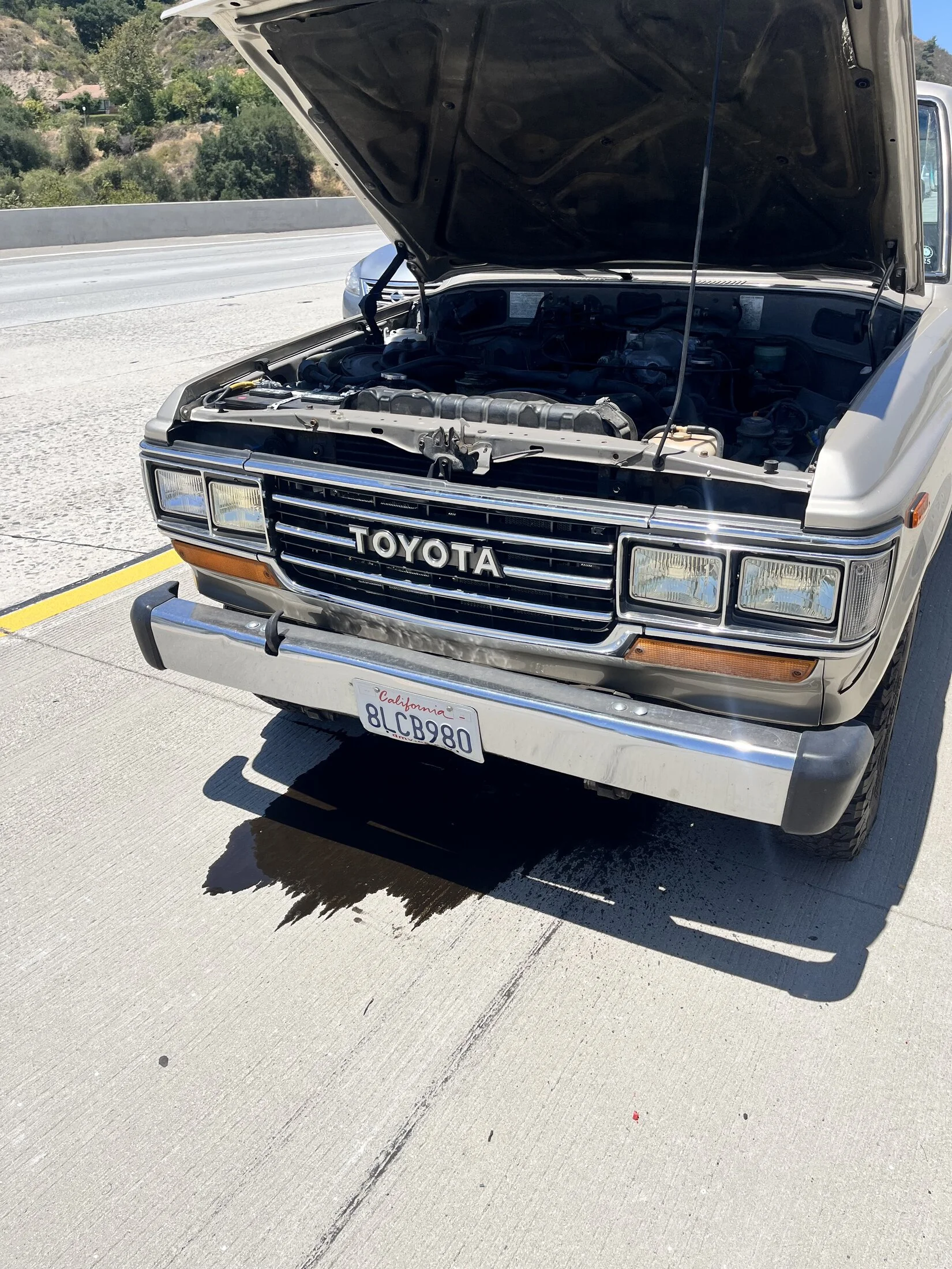

I'm decompressing from a drive home which saw the 3F-E fail. While driving on the highway today, the engine started feeling rough and an unusually loud ticking and rattling sound became a sudden knocking sound, and immediately saw a ton of smoke behind me. Was going on a slight decline 75-80 MPH (2500-3000 RPM). Engine light came on and I pulled over and parked the vehicle only to see a trail of oil and hear oil pour out from the bottom. Saw the transmission temp light come on so I immediately thought it was the transmission. Maybe still is. Took a look under the vehicle only see a ton of engine oil dripping onto the front axle.
My mind immediately went to..."whelp, I guess it's time for a rebuild or an LS swap."
Regardless of the diagnosis, I think this repair will be beyond my skill level. As I get it towed home, I'm wondering what things I can investigate myself at home to just get a better understanding of what some of the issues could be before getting it to a shop this week.
For example, should I try starting it? Would should I listen for? Would that do more harm than good? What should I look for when I take a closer look of the engine block? Galley Plug? Should I fill it with oil again? etc...

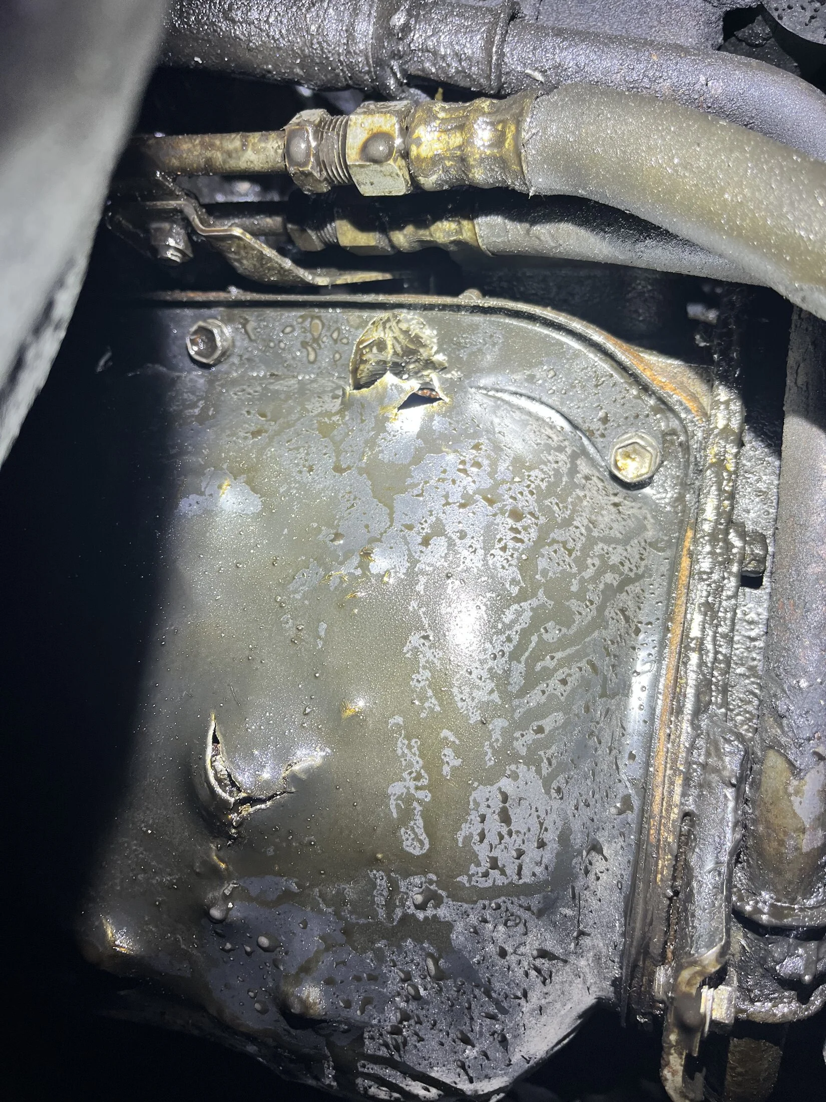

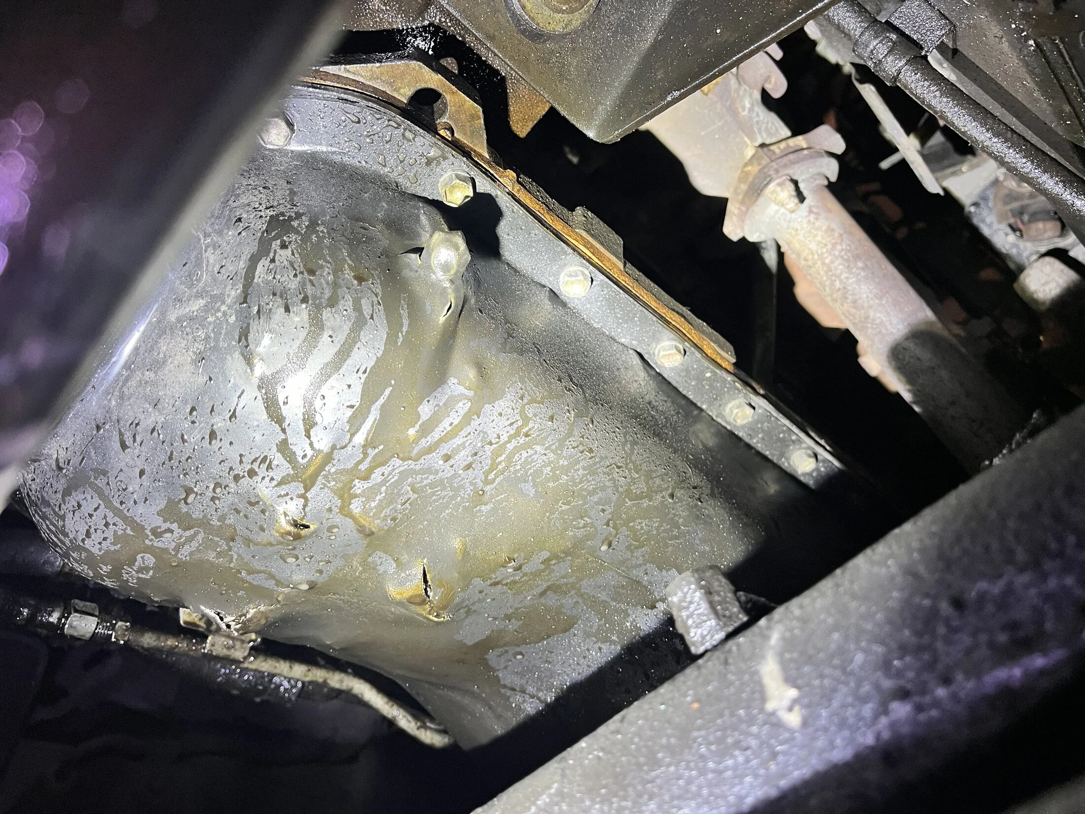

Good News! The galley plug intact and the top of the engine bay is surprisingly clean. There's still oil in the back of pan where the dipstick is, albeit not much. The Bad news: You know that chestbuster scene from the original Alien movie? That's what my oil pan looks like.
Dents have notable bolt indentations. So likely a thrown rod? Shards of peaking through the cracks. Huge 1" diameter hole out the side of the pan. Something must have blown out of there. Thank you for the recommendation to "not start the engine". Debating if it's even worth while to take it to the mechanic given how this is starting to look...

Yeah something let go in there. WOW!!

That’s what is called “catastrophic failure”. Unfortunate. Rebuild this block would likely be cost prohibitive, another block or complete engine would likely be the best route (outside of a swap).
That said, there could be some salvageable parts off your engine, depending on what occurred.

It's almost assuredly a rod was trying to escape.
If you can get it home and drop the pan, you'll better know the extent of the damage and how you want/need to move forward.
