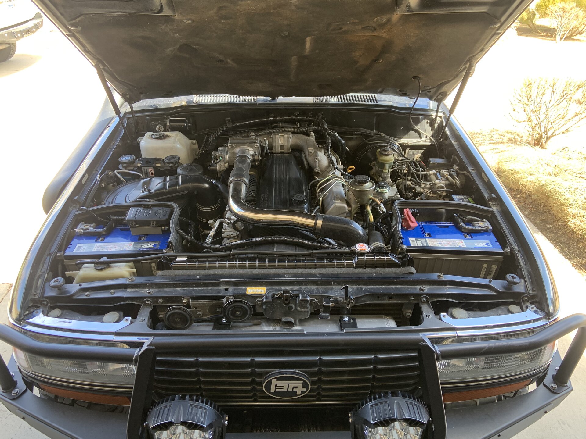

I chose to rebuild my engine 100%.
Bottom end/top end.
Everything is brand new.
Almost everything under the hood now is replaced and brand new. I have now roughly 4k miles on everything under the hood.
It was not low cost and sure I may have been able to do an LS swap or something for less.
But now I have the Toyota reliability and it’s all stock.
