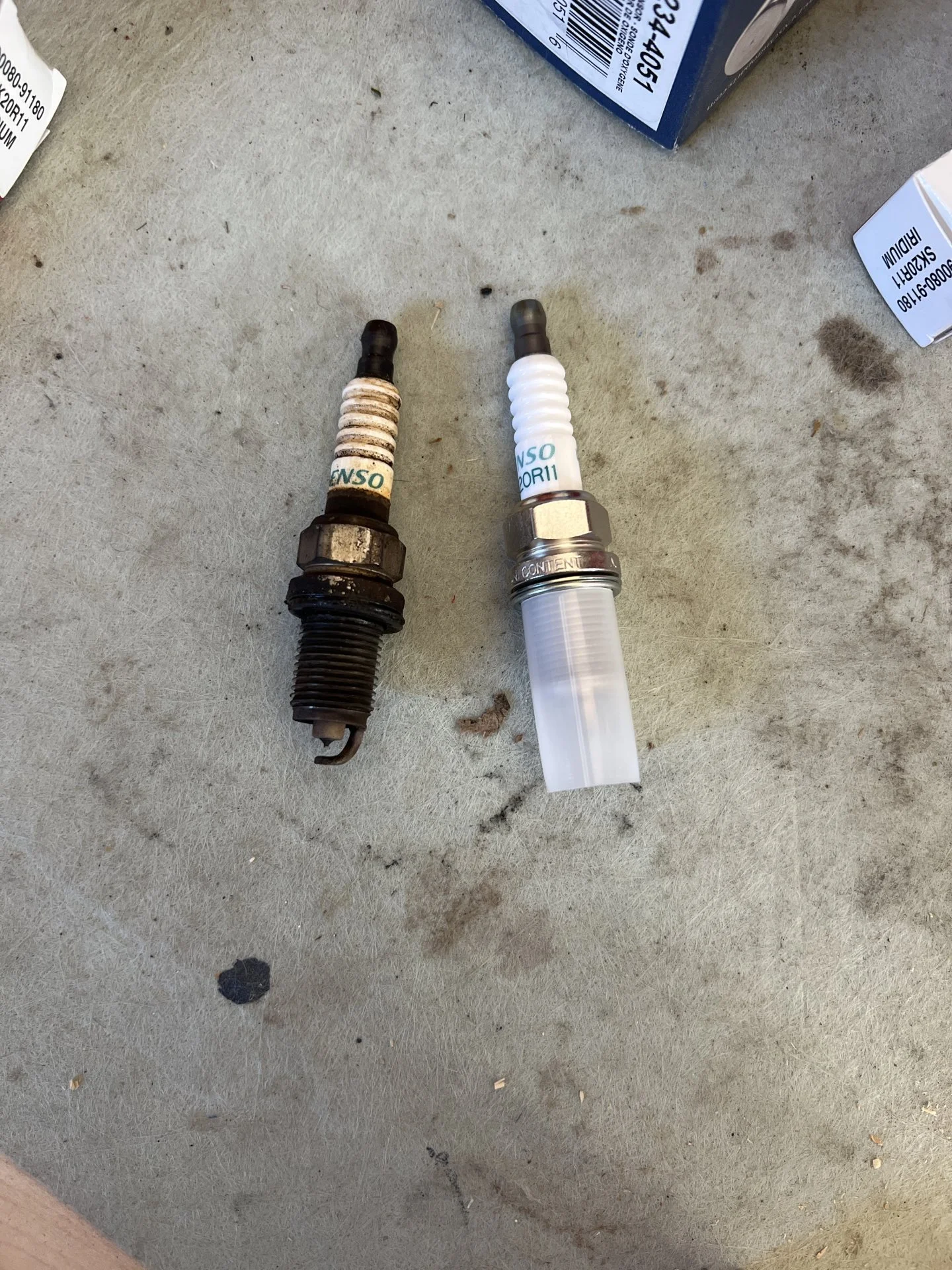

Seized #7 spark plug (DS, closest to firewall). Replaced the plugs and one is seized. Really tough to move in either direction. Soaked over night in WD40, tried again this morning to re-tighten and only moved about a 1/8 of a turn. I am considering trying the 44K fuel cleaner method mentioned here, but what if I cannot get the plug to tighten back to it's seated position? It'll run like crap I assume, but what other options do I have?

Ditch the WD40 and use a dedicated penetrating oil. There is NO option....the plug has to come out or eventually it will fail to fire and will only be building up MORE deposits on the threads with the passing of time and use. You have two issues. The spark plug and head are dissimilar metals....so galvanic corrosion occurs at the threads. To make matters worse, some amount of the threads (spark plug) stick down into the combustion chamber and can get a build up of burned gas and oil on them.
IF you can move it at all....then penetrating oil and TIME will get it out. It might only turn very small amounts at first, but that is progress. IF you force it.....you'll either strip the threads or gall them so badly that you need to install a helicoil or source another head.

I have now used a penetrating oil and having it soaking (I only had WD at the time). Thanks for your reply, it gives me hope that it's not cross threaded, just a PITA spark plug.

Yes, lets hope it is not cross threaded. A 'sticky' spark plug on the other hand is a very common problem. IF you have the time to be patient with it, soak it and move it in small increments... it will come out. You'll reach a point where you are getting 1/4 turns and it doesn't bind or chatter. Then you are almost home free. Just go slow. Best of luck.

With patience and good penetrating oil, the problematic spark plug came out after soaking for 4 days. No damage and the new one threaded in nicely!
