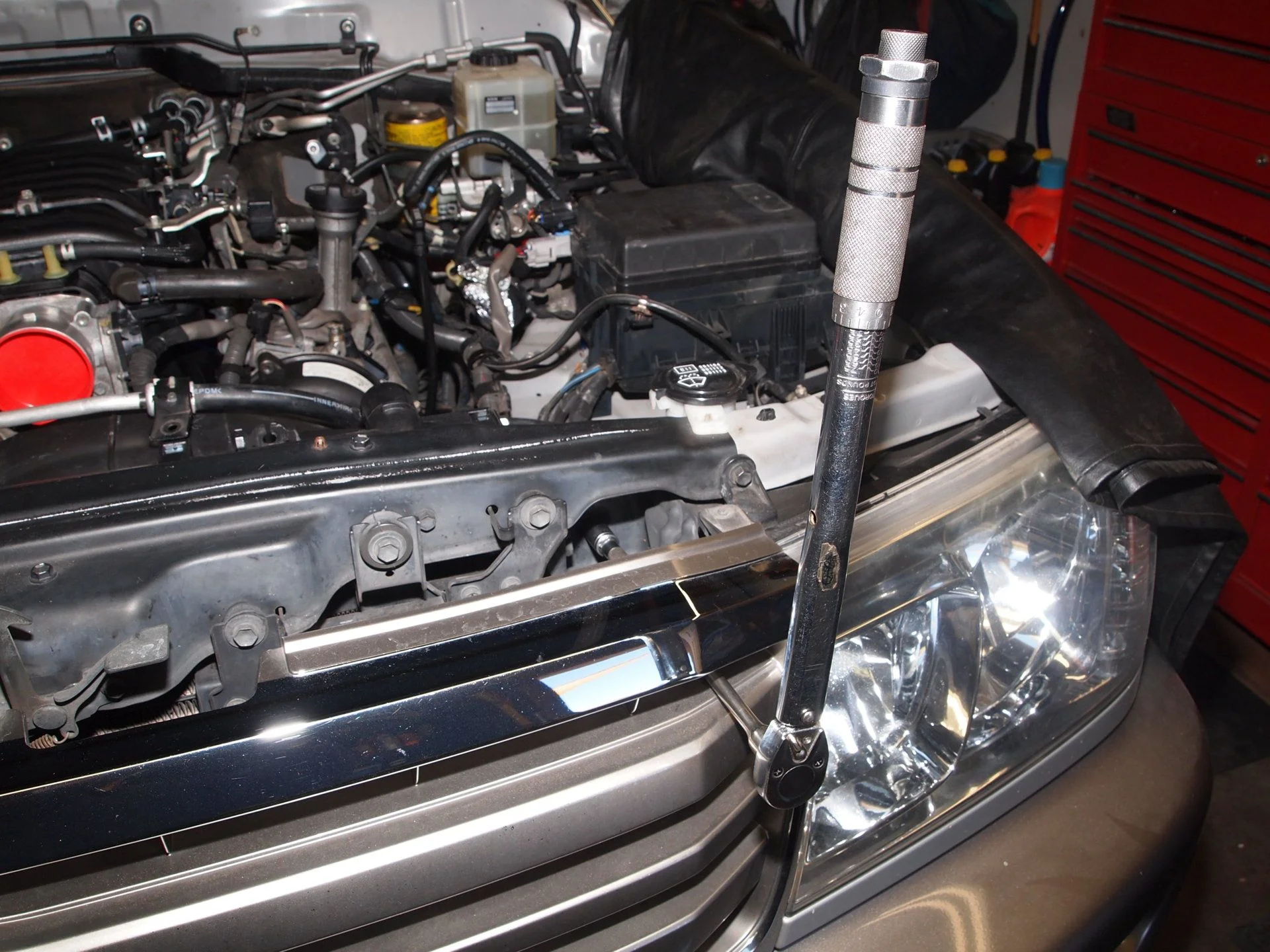

Installing vane pump (power steering pump) torquing 3 mounting bolts to 13ft-lbf.
Attache HP line to pump with new gasket, torque union bolt to 37ft-lbf

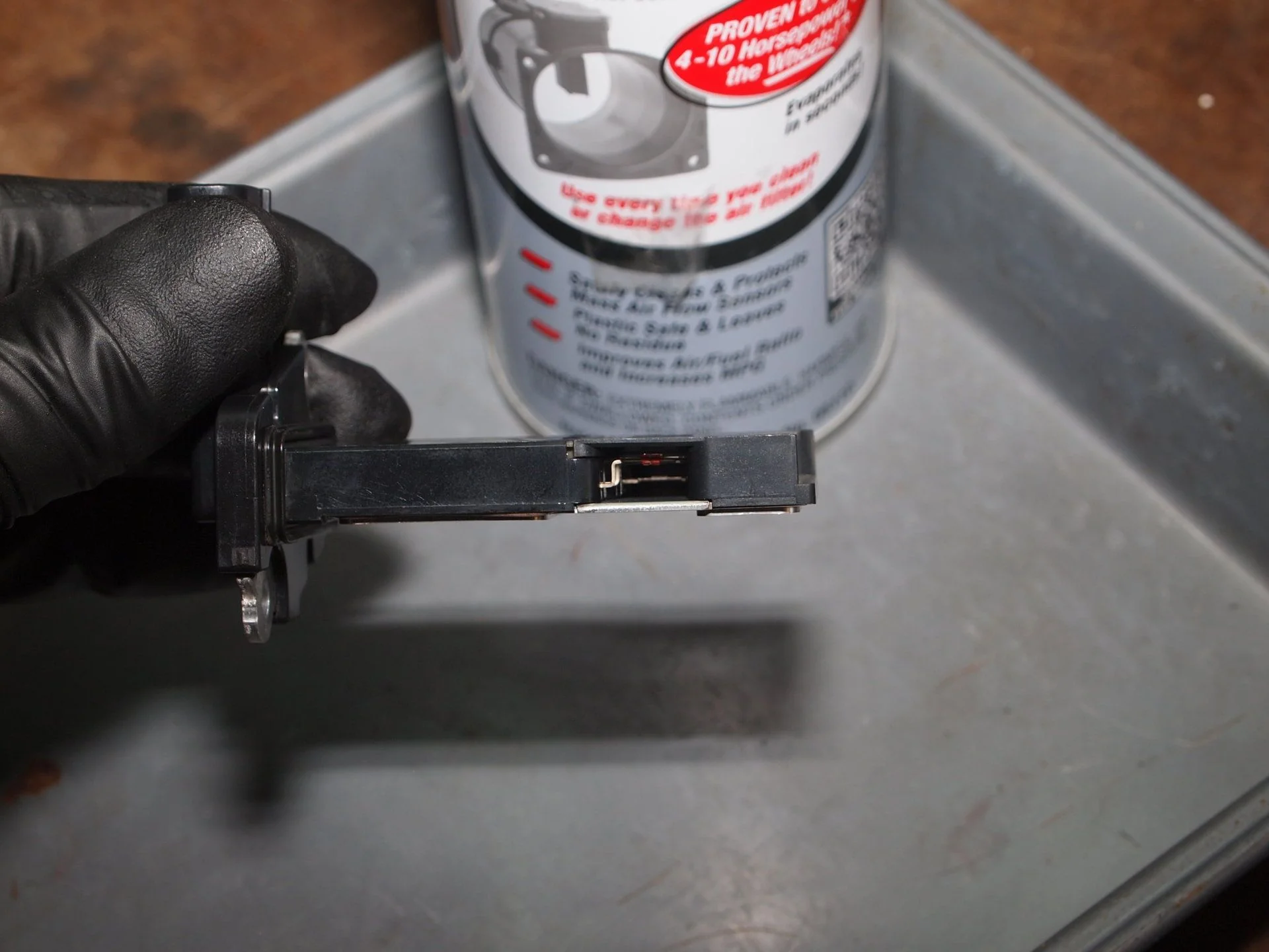

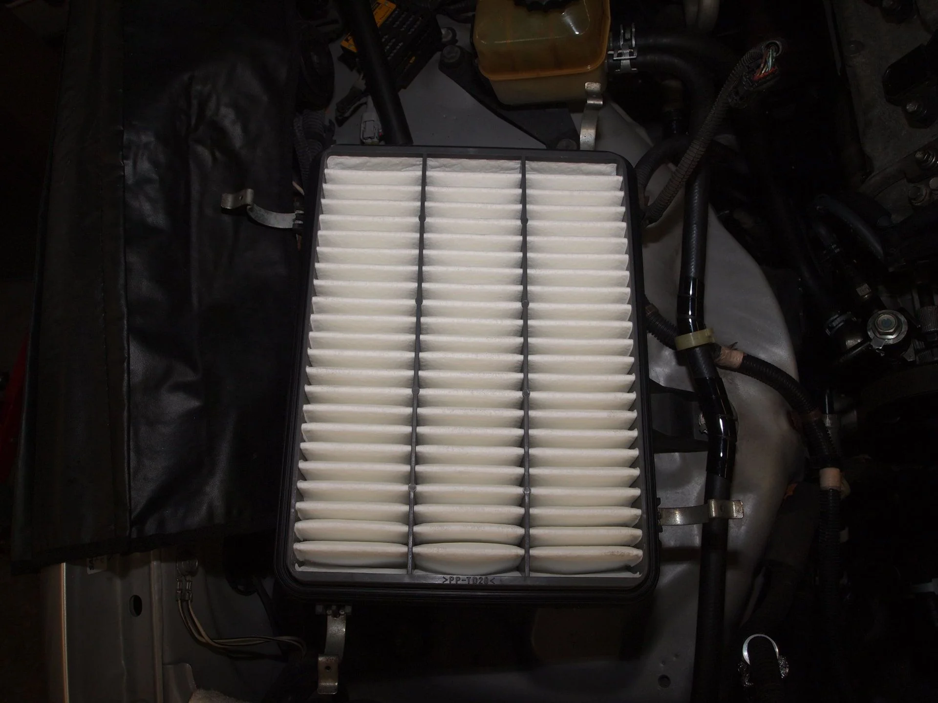

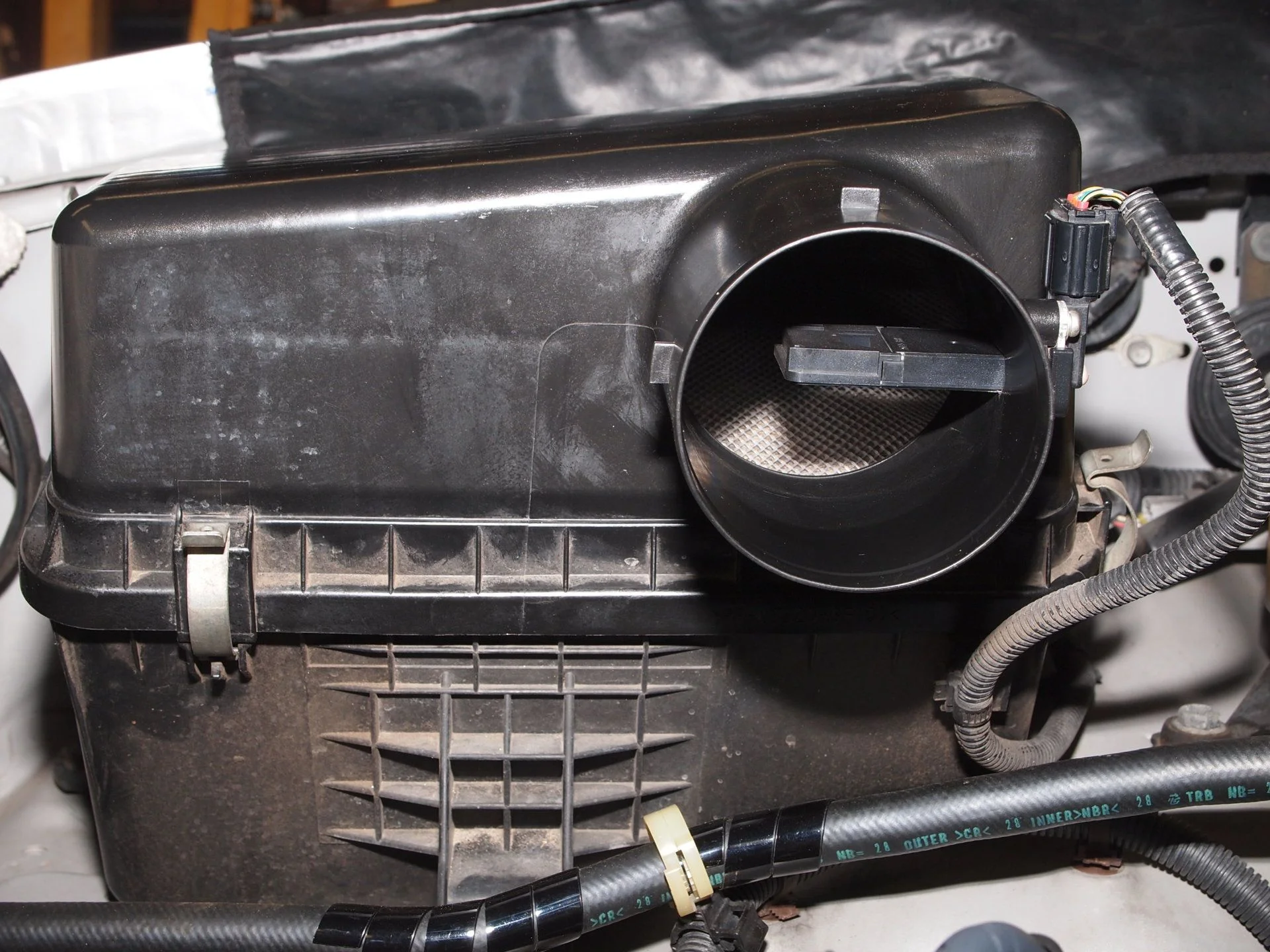

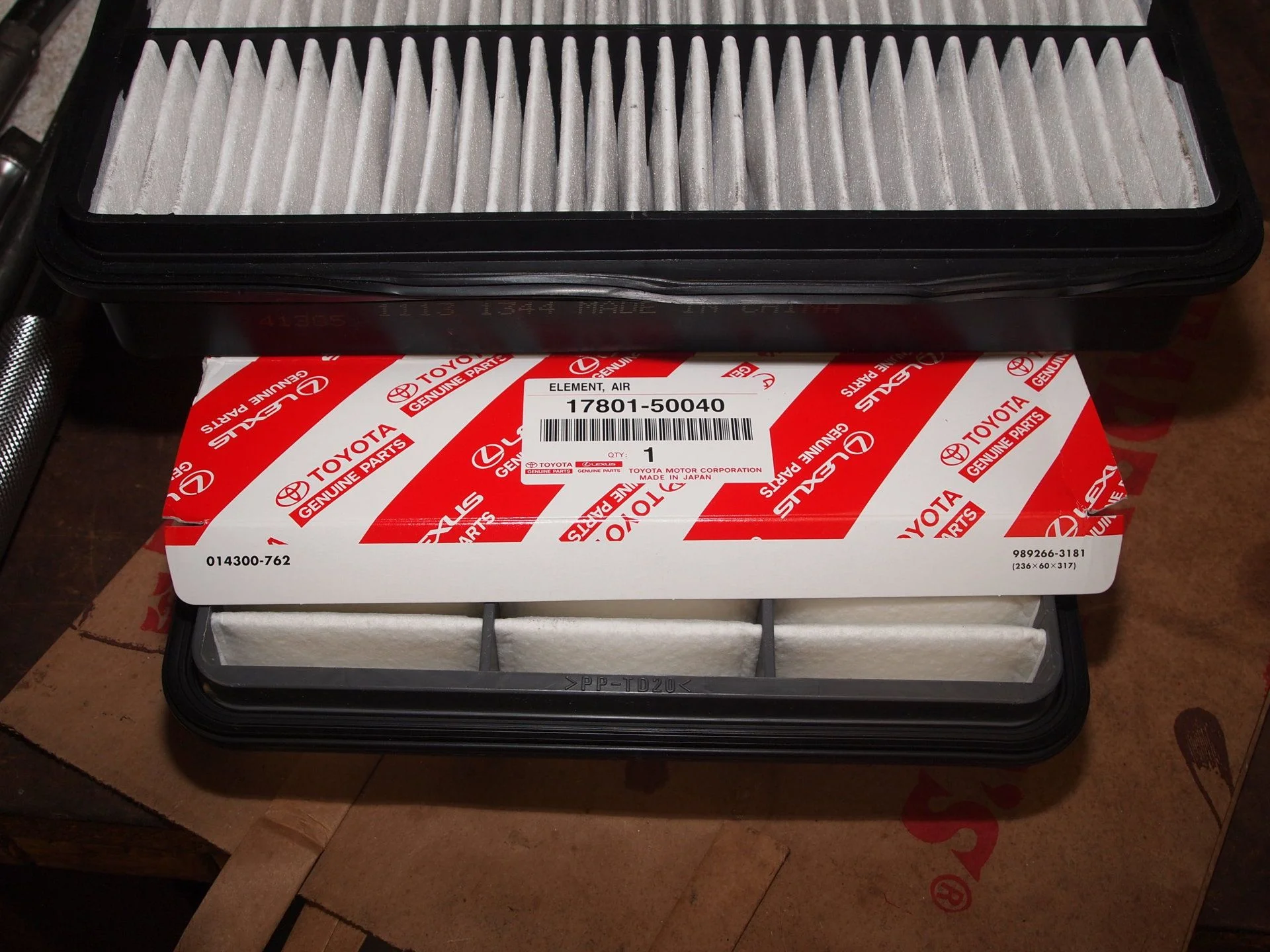

New Air filter & MAF sensor cleaning.
Old filter's (600 miles) rubber seal was deformed, so I replaced it. I just like going with OEM these days, it's the safest bet!
View attachment 1687466 View attachment 1687467 View attachment 1687469 Used some CRC MAF cleanerView attachment 1692218 View attachment 1687471
I want to do MAF Sensor cleaning just cant find the product to do it with here CRC is there anything else I can use ?.

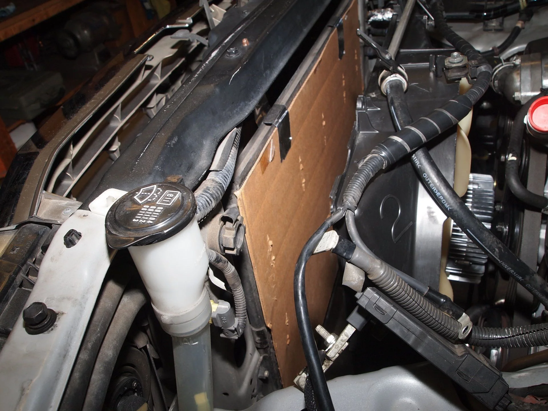

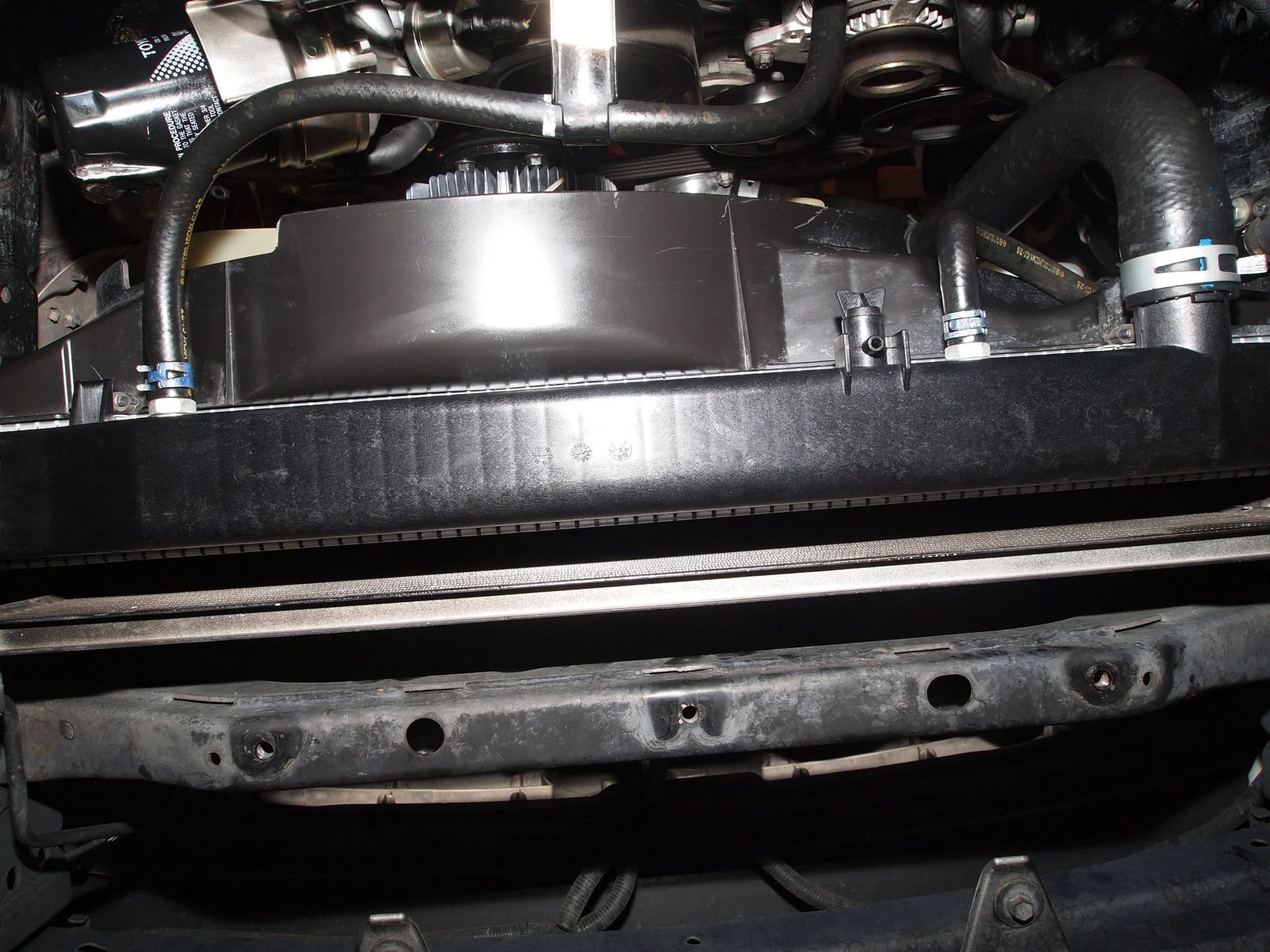

The install was easy. Just place the fan shroud over the fan. Removed my cardboard protector and drop in the new radiator. I then bolted up the lower then upper securing points. Followed by bolting on fan shroud, wire brackets, reservoir and NEW OEM upper radiator hose. Then attached the lower hose, transmission cooler lines and NEW OEM radiator cap.
View attachment 1688090 View attachment 1688091 New OEM capView attachment 1688092 View attachment 1688094 View attachment 1688093
With the radiator cap is it good to get a new one once miles get up and how do you know it's no good ?.

MAF cleaner is a solvent that is safe on plastic, that is very "clean". Clean meaning it dries without leaving a trace. I'm sure you can find something in parts store or online.
Radiator cap can be tested. But it hard to find a tester, so we just replace. This is a new radiator, so I replaced.

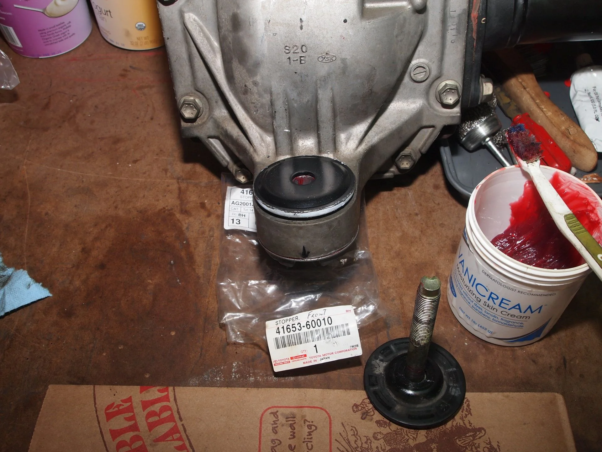

With both front drive shafts out, half the work of pulling front differential is done. So pulling and replacing front differential bushing makes sense. This also gives and incremental benefit in reducing D-N-R clunk.

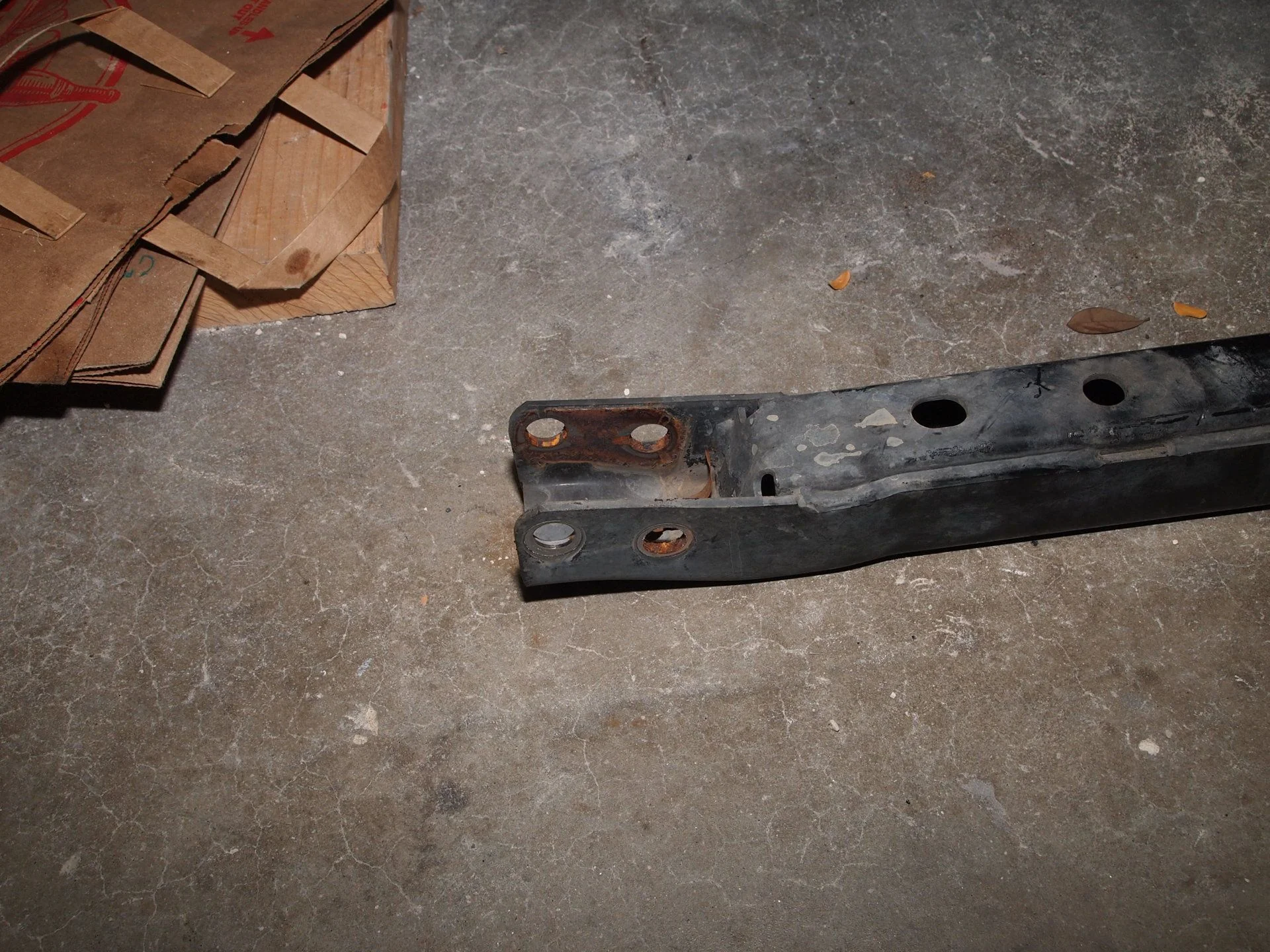

Pulling #3 crossmember is done to make pulling differential easier, but can be done without pulling. I've learned we have and issue with the #3 crossmember securing points rusting out. These crossmember may also be loosening, adding to movement of front differential and clunk. So I recondition this as well.

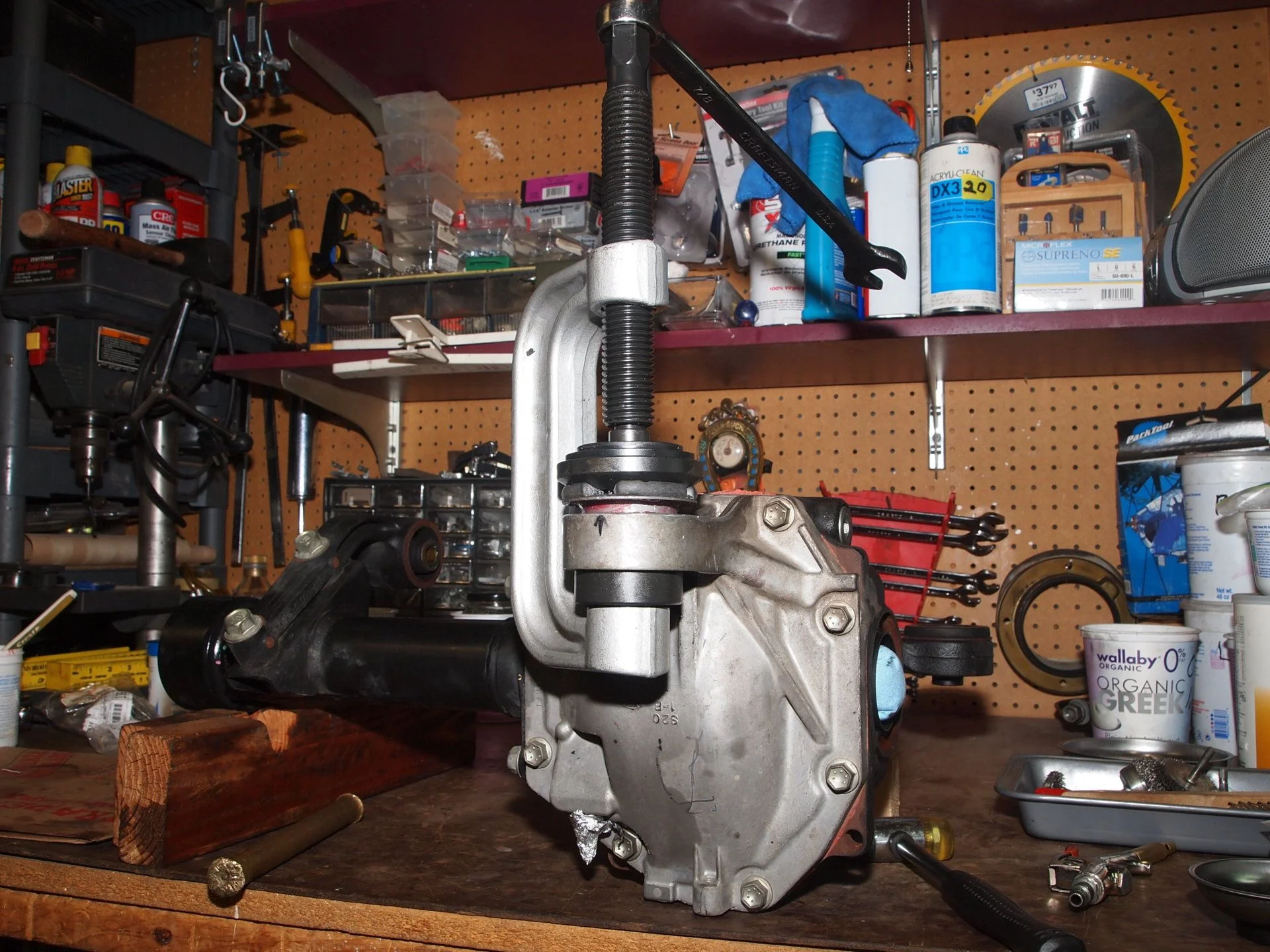

Front differential bushing is much easier and less risk of damaging case when done on the bench.
A little penetrating oil really helps out.
Really didn't look to bad, just some mild surface cracking. What do you think?
Note: I place match marks on propeller shaft before removing.

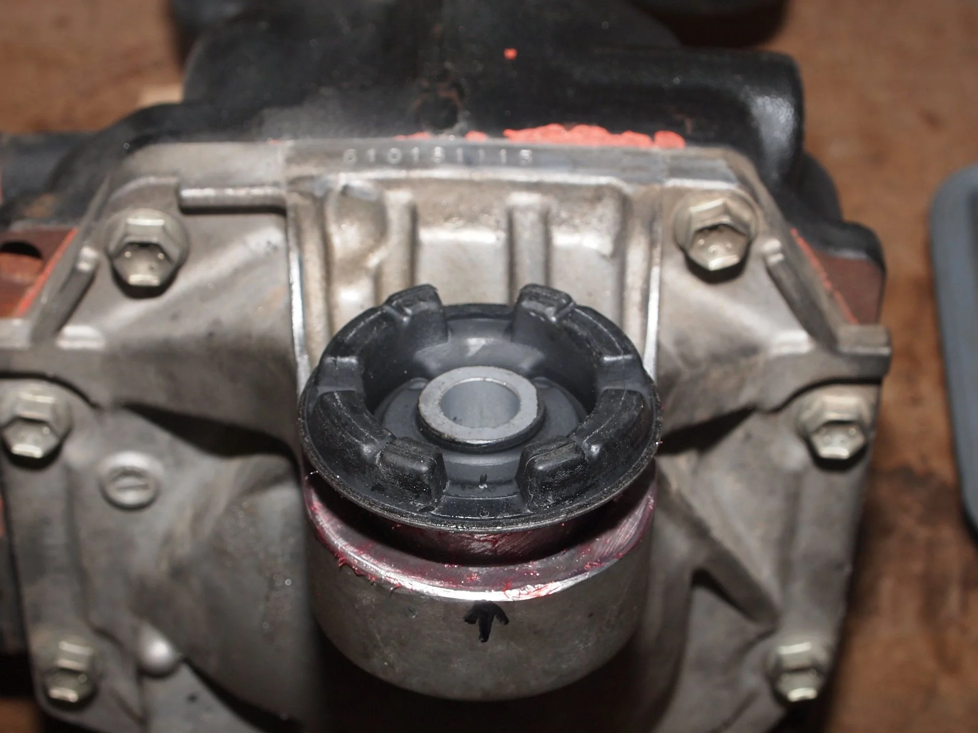

Clean up and grease before pressing in new.
For proper orientation, I like to mark center point of diff with arrow making alignment with single dot on rubber bushing easy.

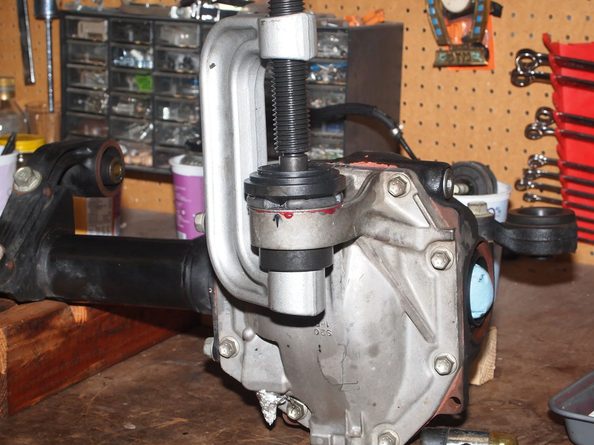

I take my time getting started, keeping square as I can.
Then once started, I just crank it on down.
My grease squeezing out, signals I've seated.

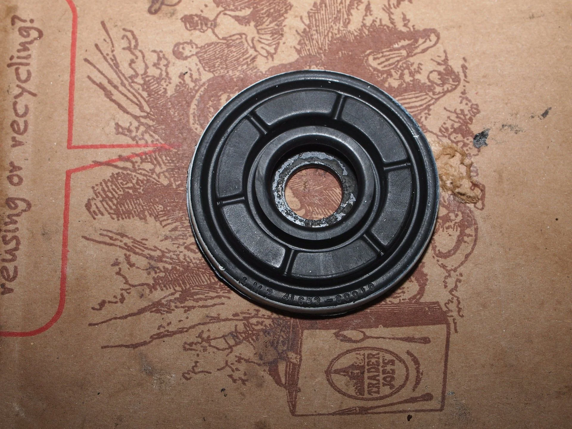

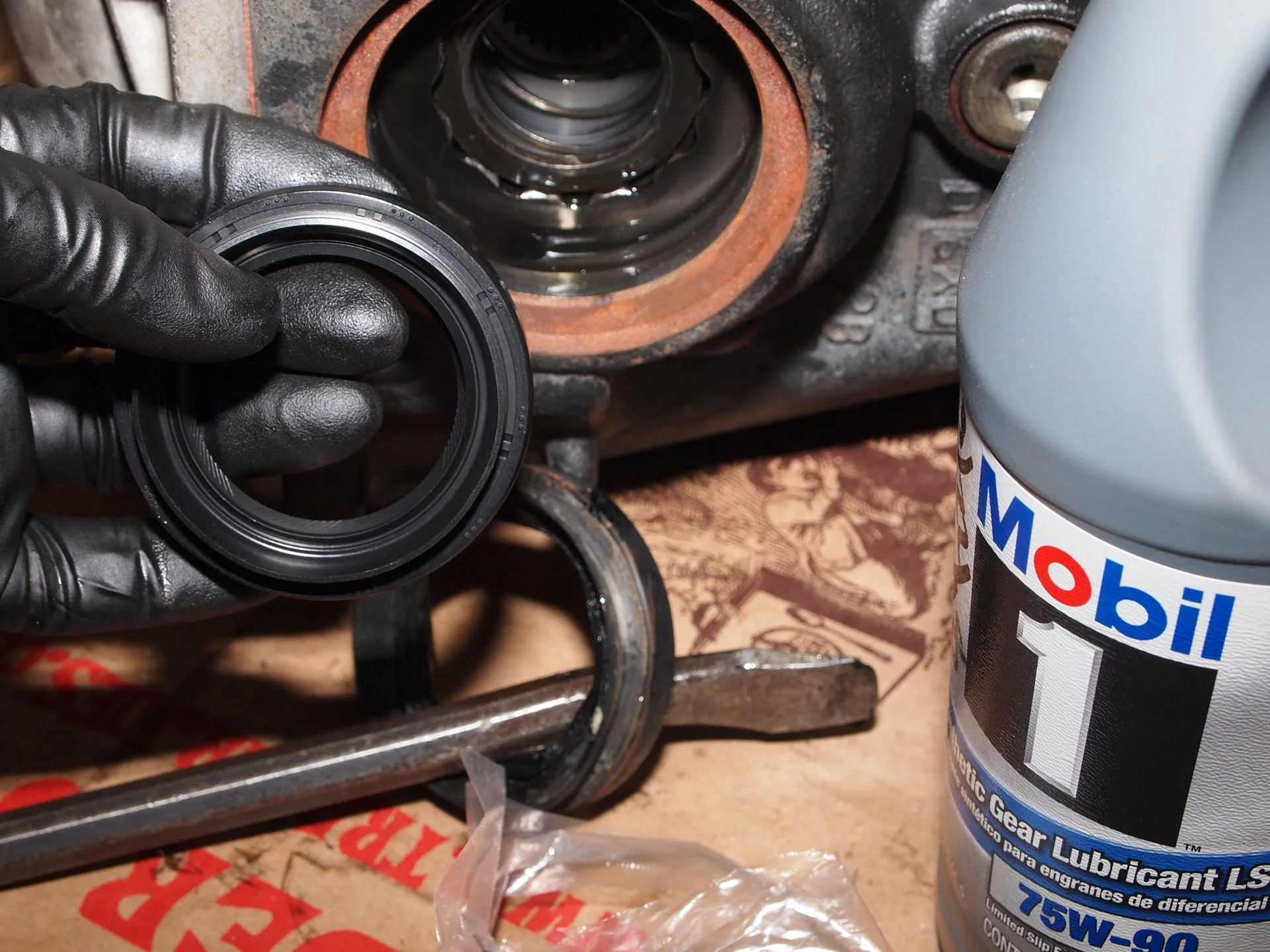

I like to replace these seal anytime I'm replacing FDS, so they seat together.

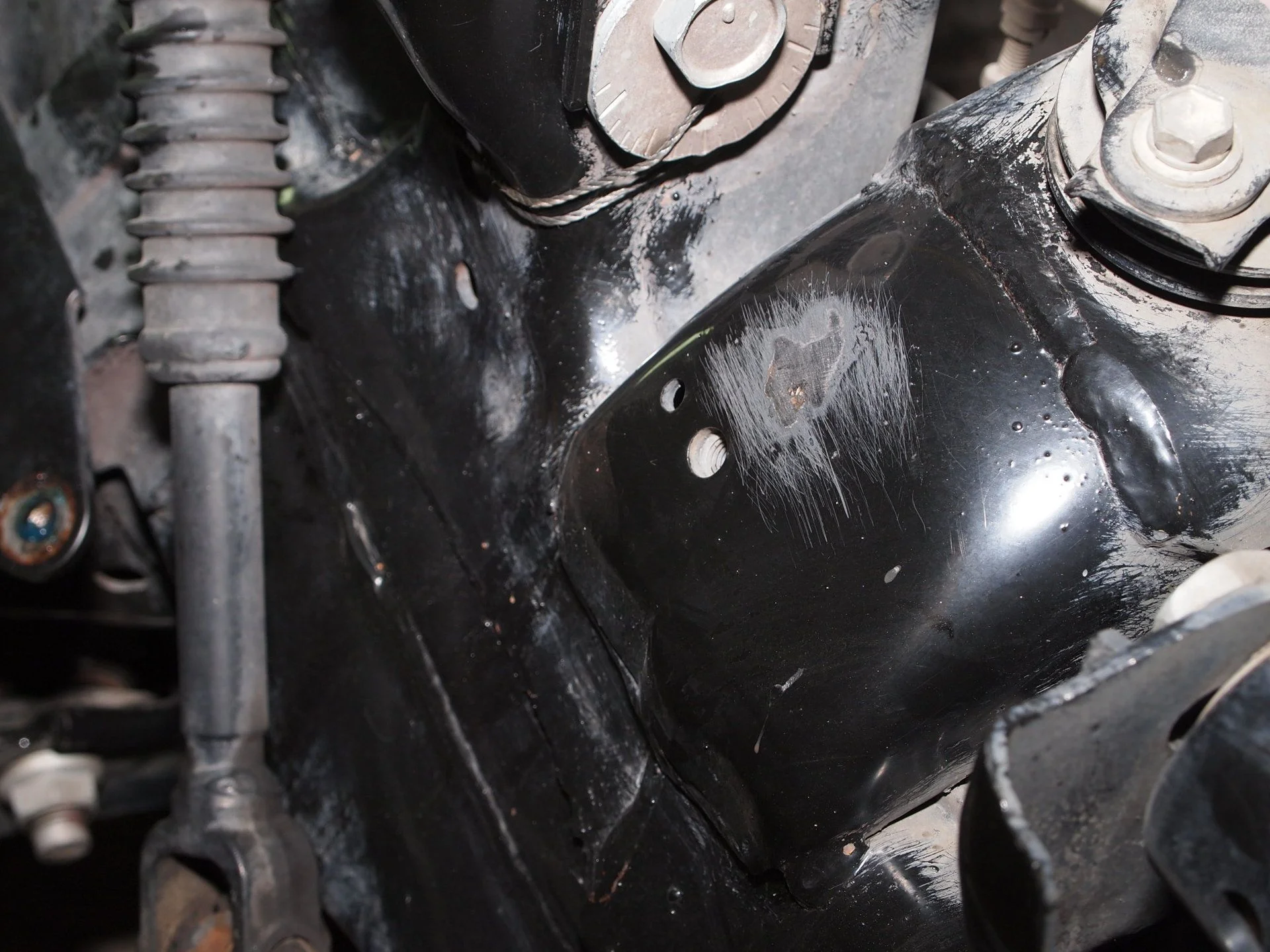

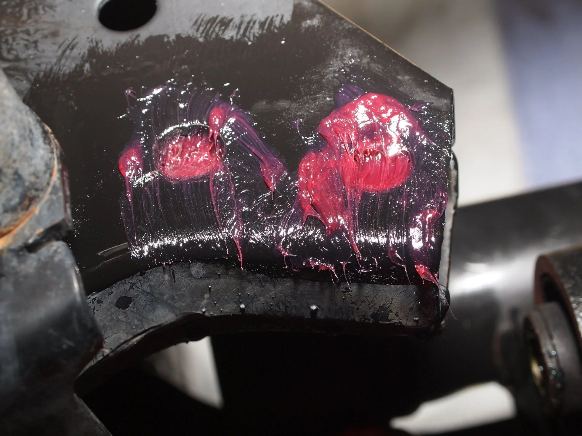

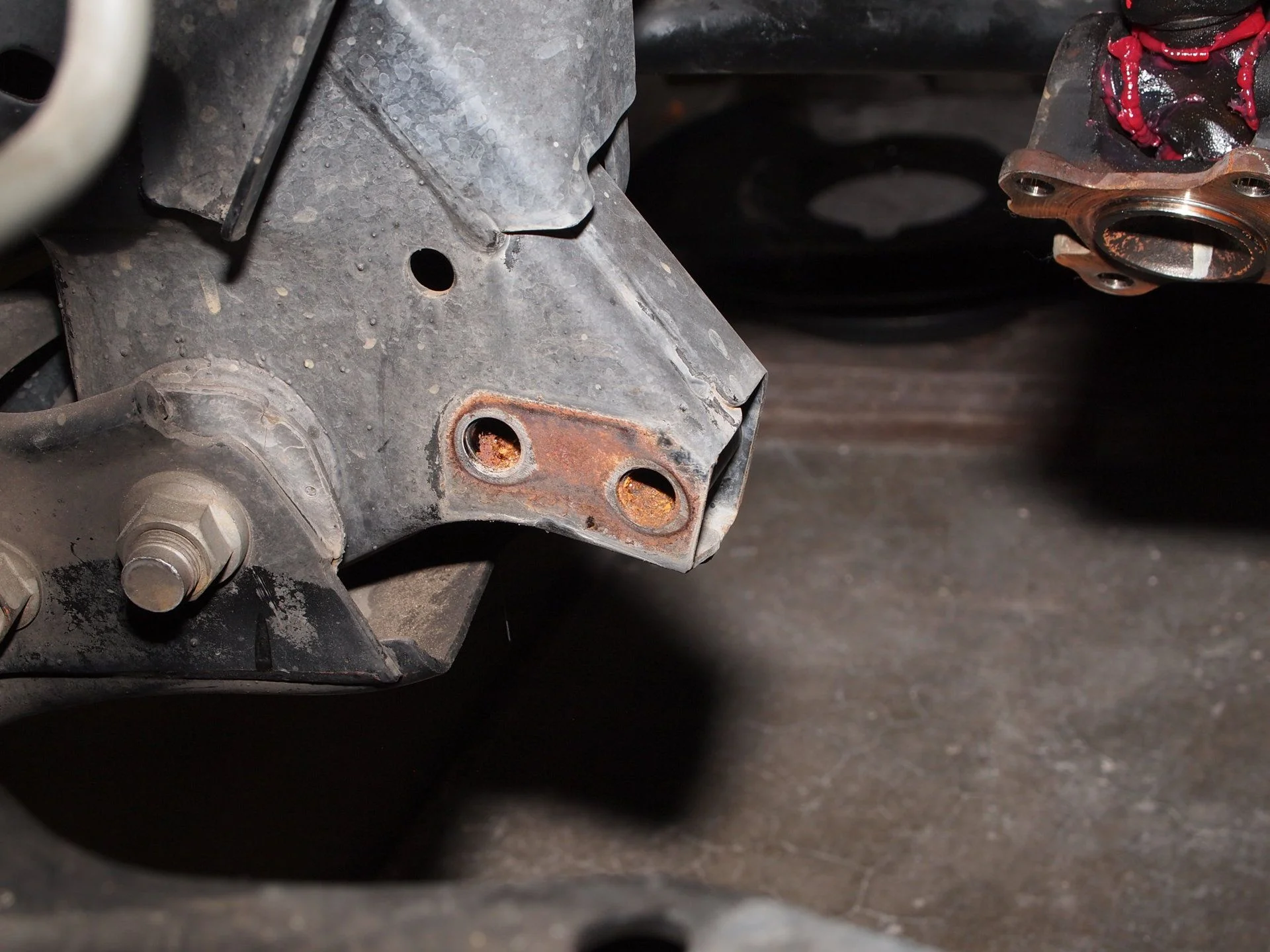

#3 crossmembers bolt, bolt guide and contact points are rusting. I'm find rust here, on every rig I've looked. Even on this very clean rust free Southern 07.
I cleaned out bolt guides with a plumbers carbon brush, works good.

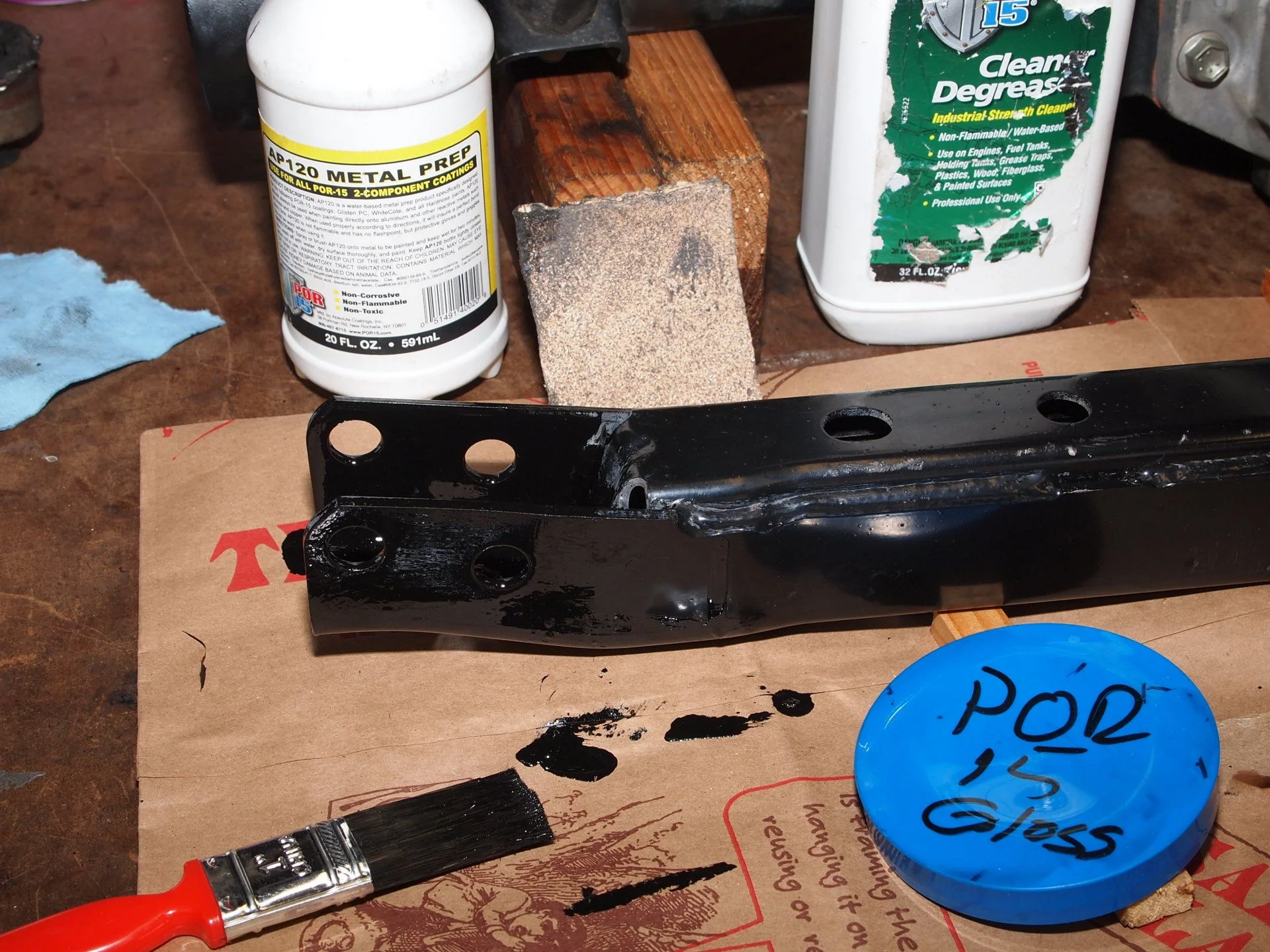

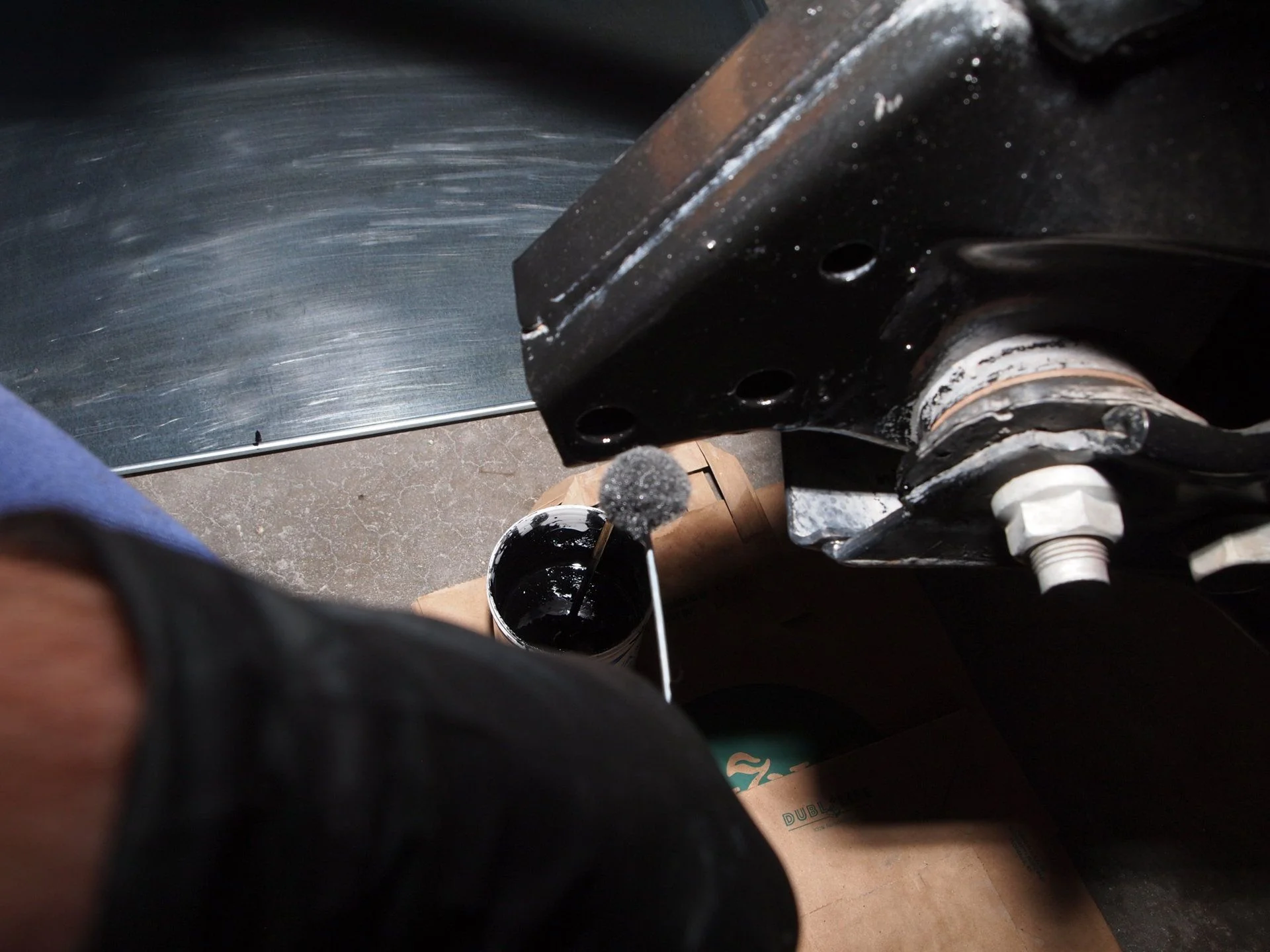

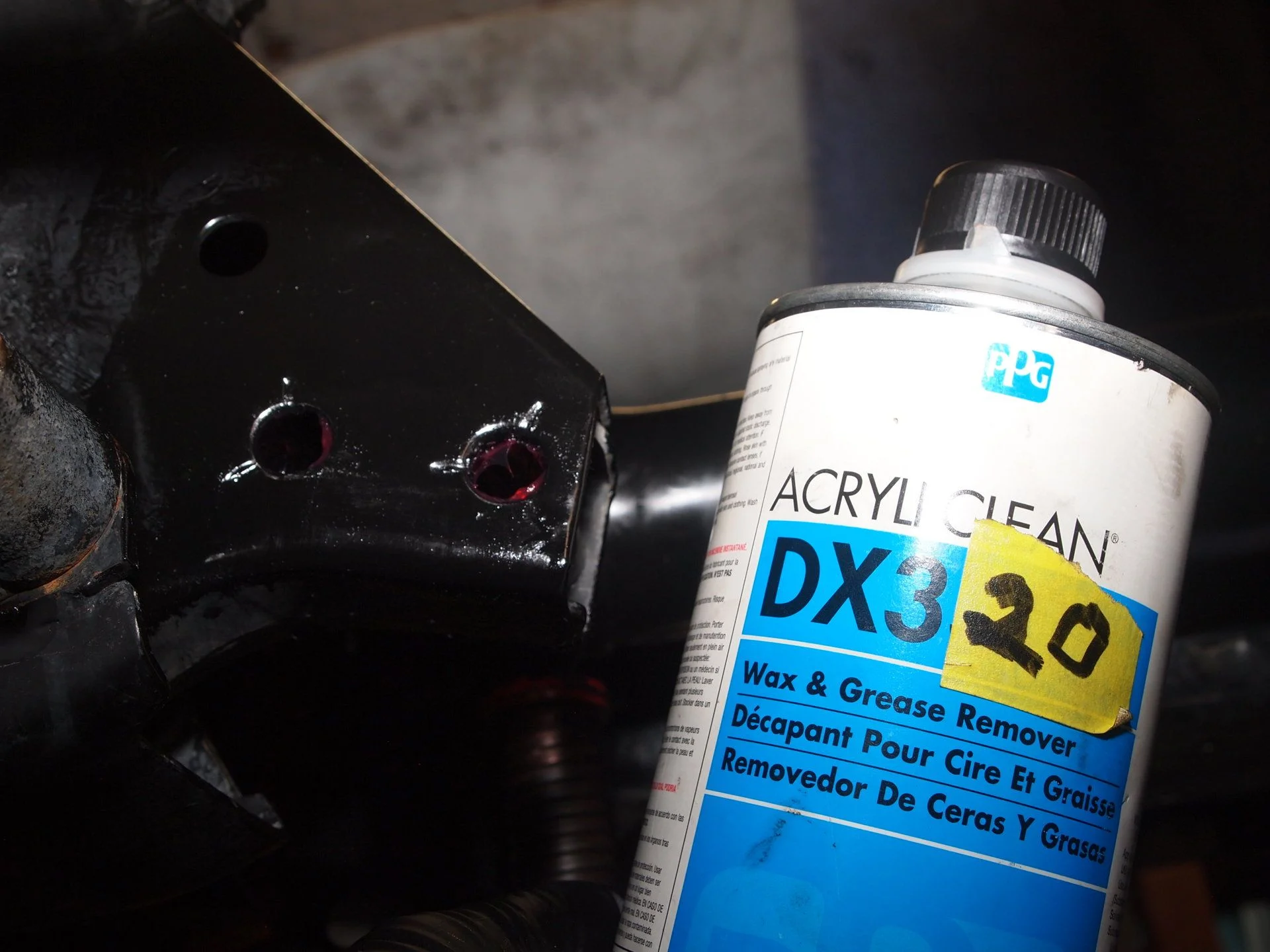

Before painting, I clean with POR-15 cleaner and then POR15 metal prep.
I even painted in side bolt guid holes with this cool little brush.
This was done while engine out which didn't make easier, but I did hit a few spot in the bay while working in area. One was under steering rack mount RH. The other above engine mount LH. Also hit the front of engine mounts.
I scuffed all painted and bare metal before painting.

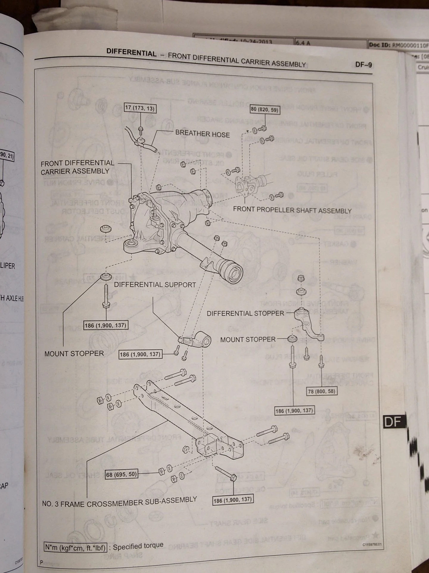

I was careful to degrease mating surfaces to ensure solid clamp force of #3 CM to frame.
I over torque by ~9Ft-lbf to 59ft-lbf.
