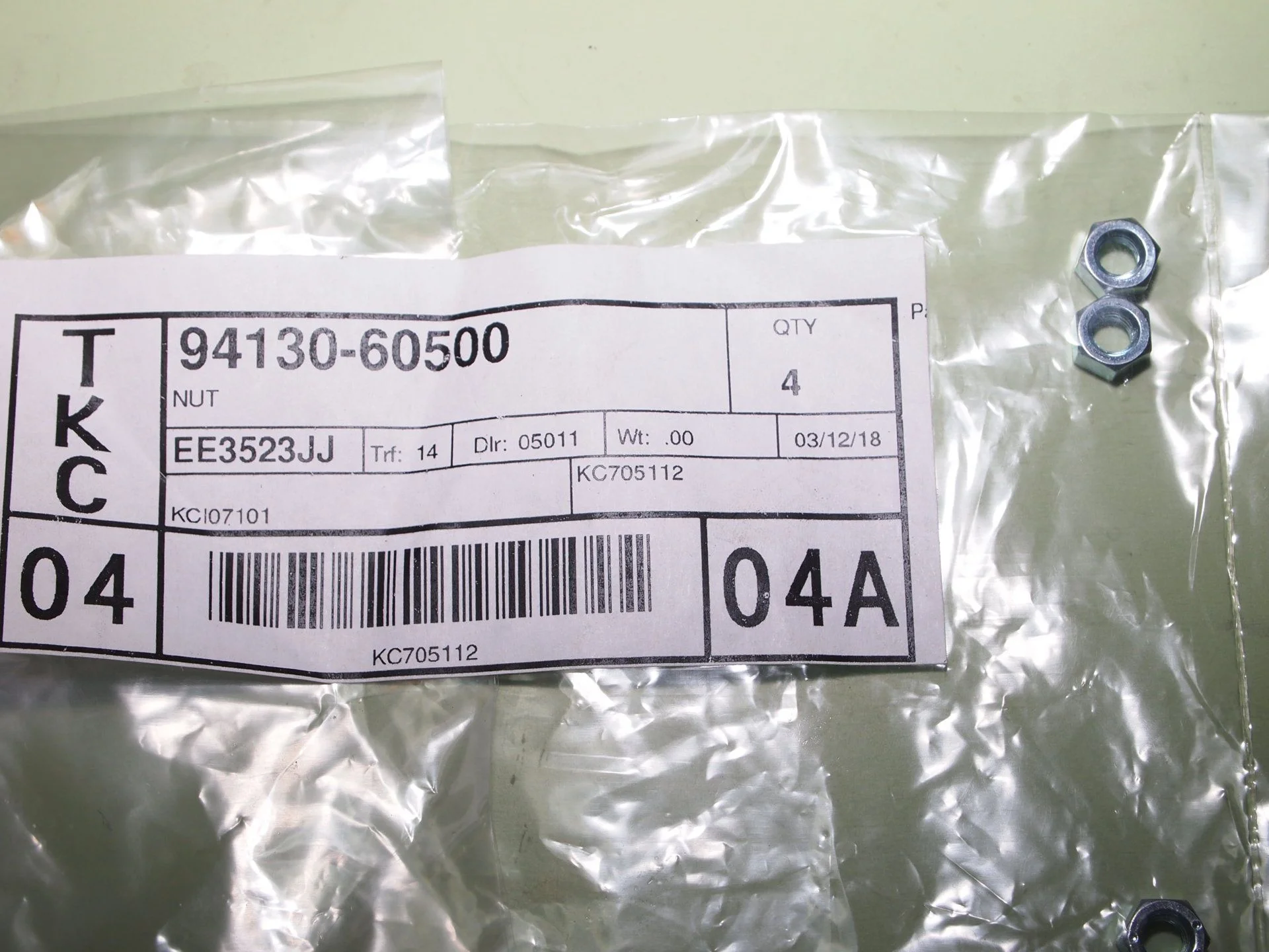

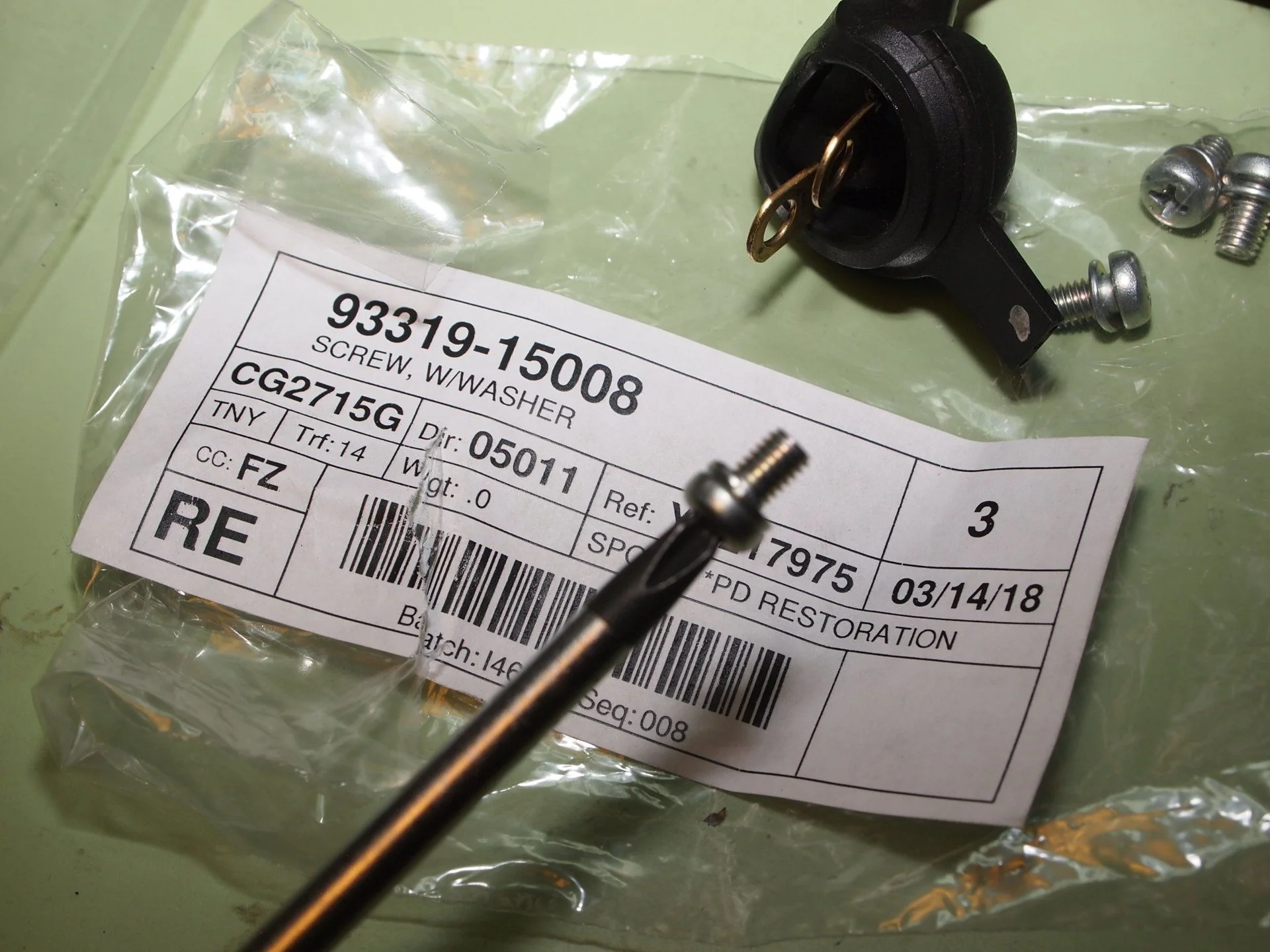

I was pleasantly surprised Toyota sell the screws & nuts.

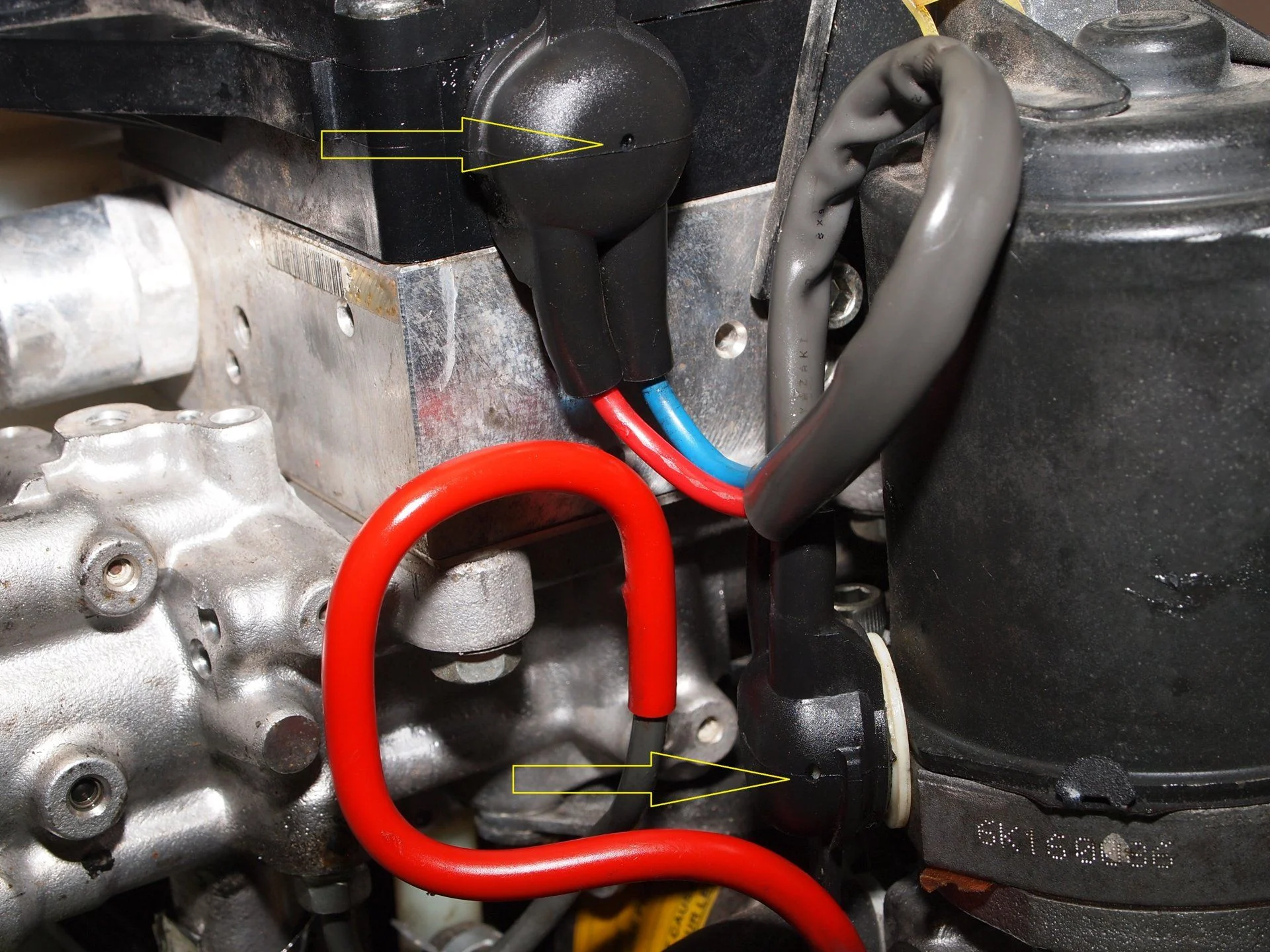

Wires look good.

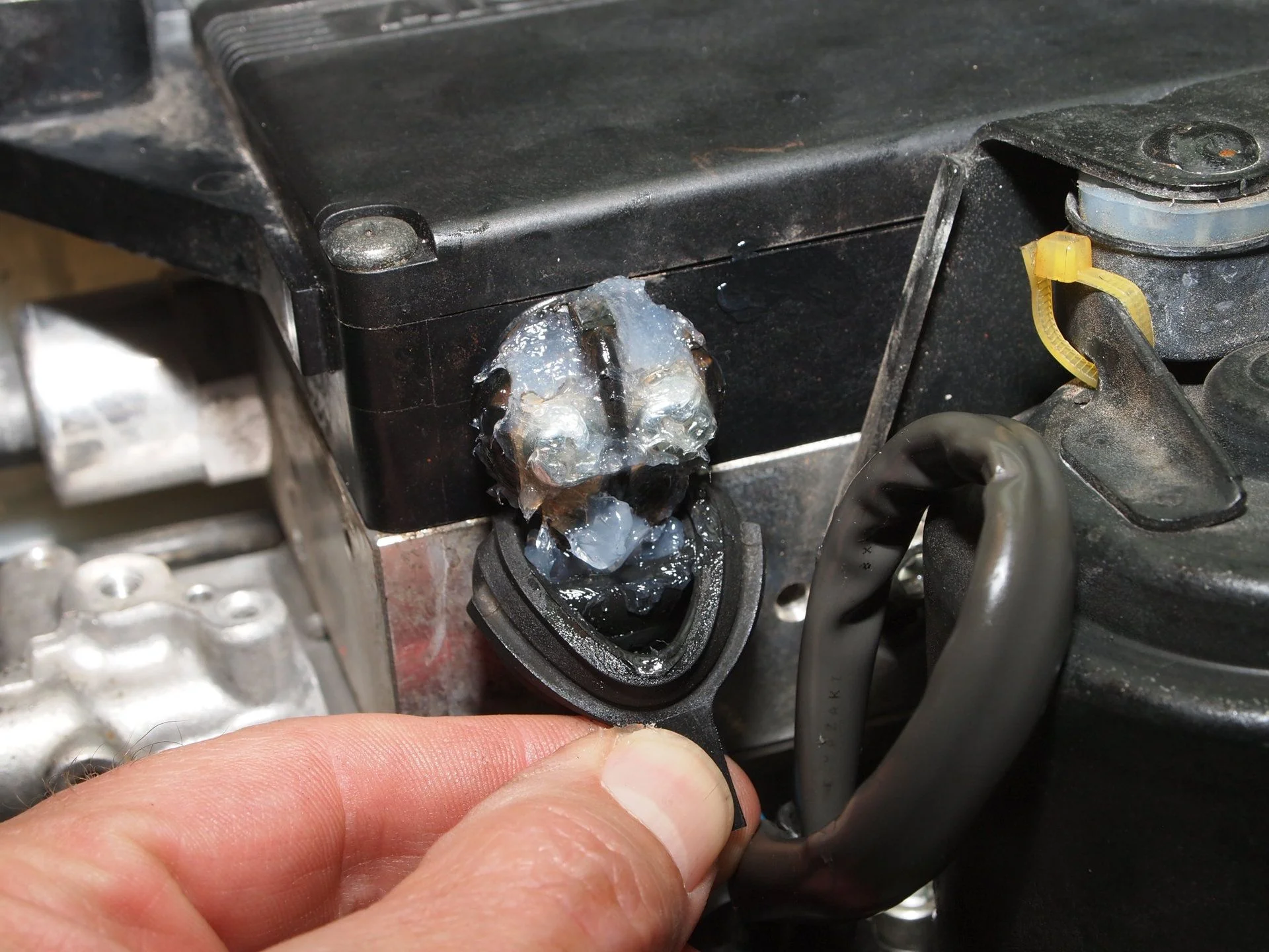

Coated during all phases to stop return of corrosion. Infact I packed boot with dielectric grease
Punched small hole in boots to allow drainage and air drying.

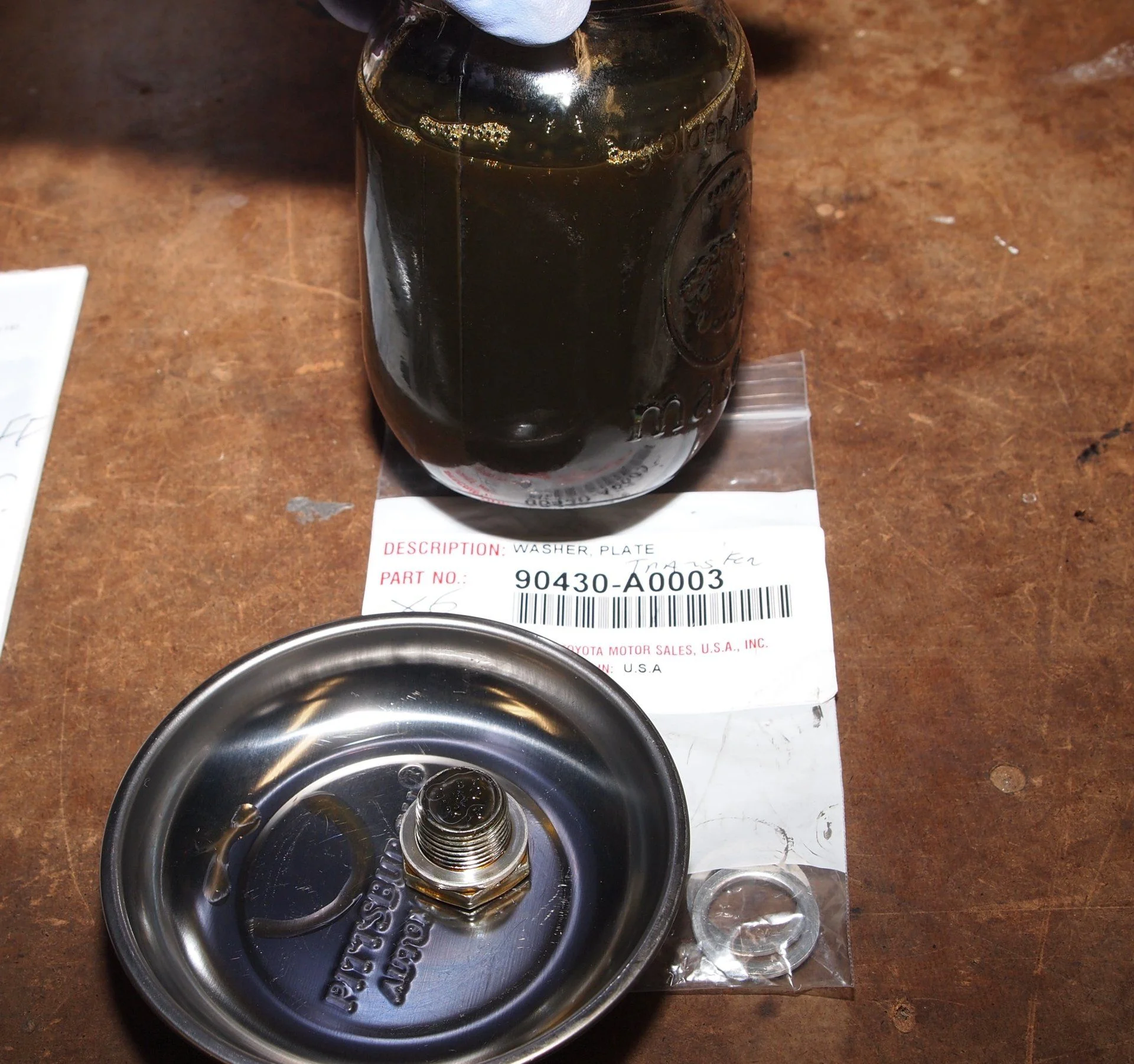

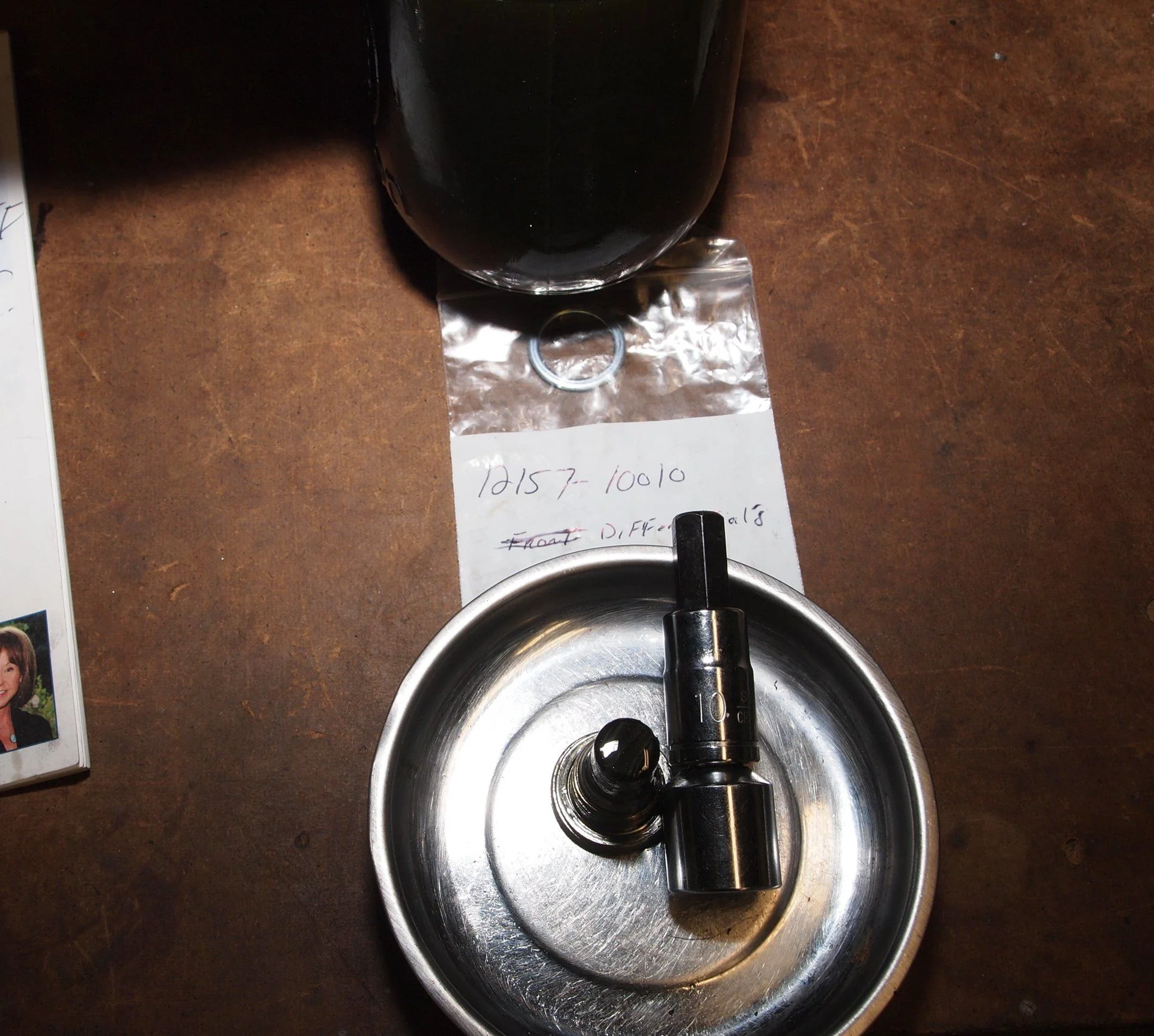

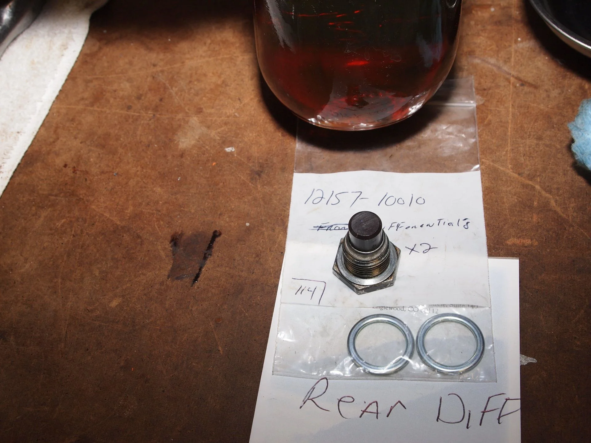

All gearboxes flushed with Mobil 1 75W-90 full synthetic.
Two key to changing gear lube in Rear & Front differential and transfer case, is: After topping let rest for 15 minutes (30 on colder days) then top again until lube flows out a second time. Second key is use new gaskets (washers) and torque to spec.
Fluid of rear diff looked so good I felt guilty for dumping it. I do at 35K as PM. Magnet was clean even before wiping (as seen here).
Front Differential look good but ready for change. I do at 25K as PM.
Transfer case is one that needs changing the most. I do as PM at 25K with front.

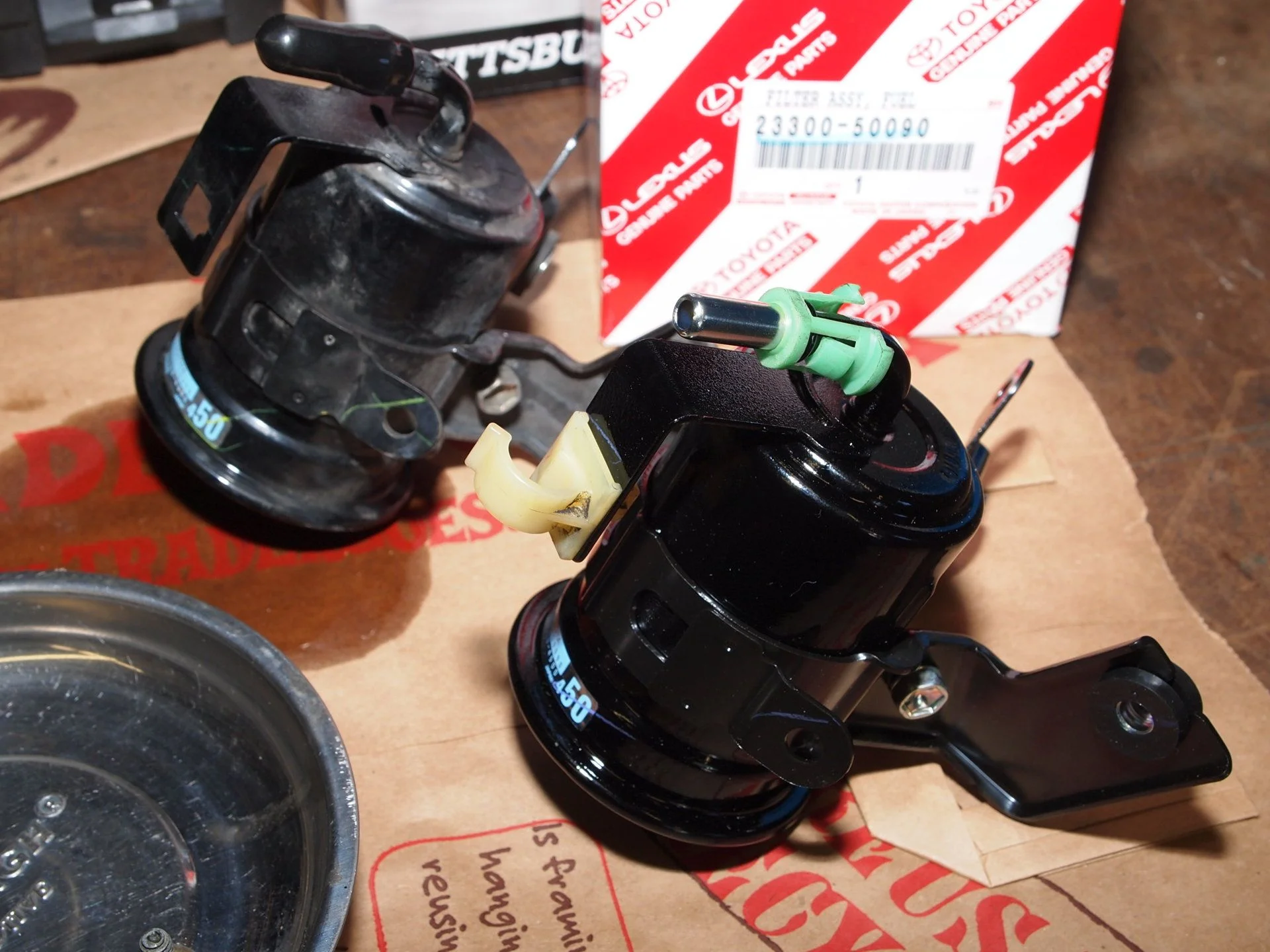

Fuel filter installed.
Getting ready to fire up engine for first time.
We keep our green retainer clip on the out flow side of fuel filter, and white fuel line to bracket retainer clip.

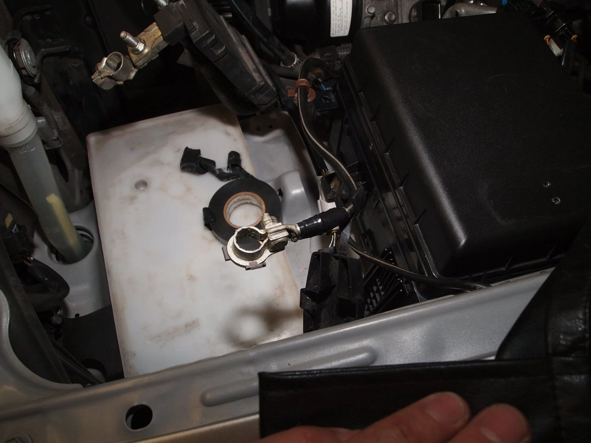

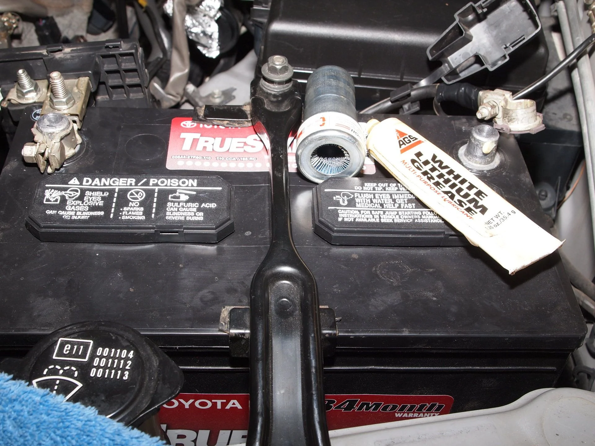

Battery Post cleaned & greased.
Almost ready to crank this puppy over.
Finished running battery wires and downing a little tidying up.

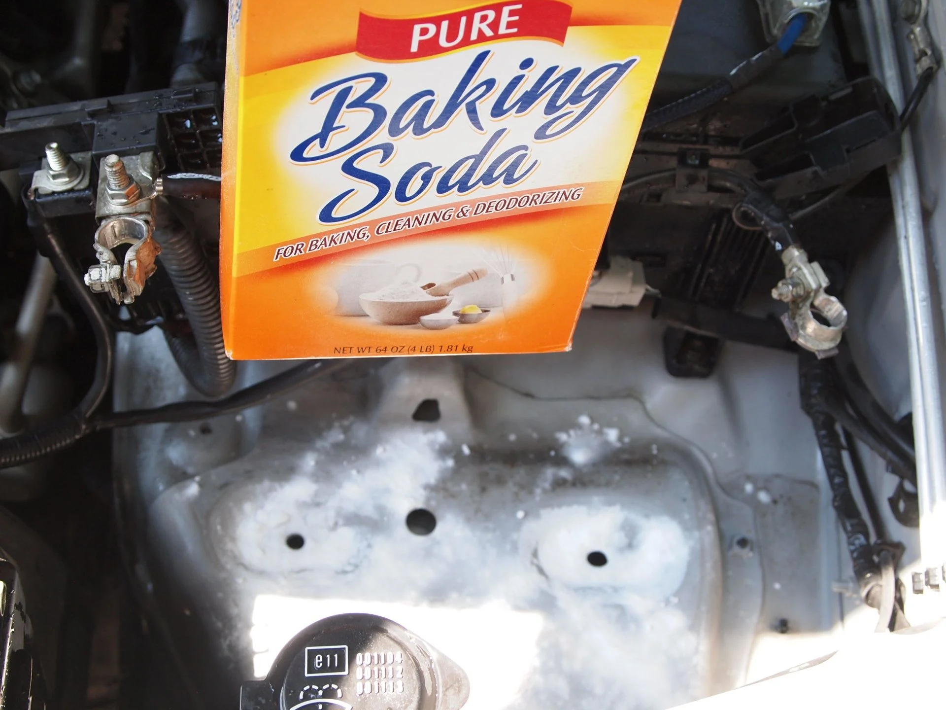

I always neutralizes any battery acid that may be in area before rinsing with water.
Plastic tray factory gives helps isolate battery and catch acid between cleanings.
factory tape needed a little redue.
I like to clean and grease battery post once every year, in the fall after fuel blend changes at gas station.
While battery disconnected for 30 minutes to reset ECU; I clean MAF sensor, throttle body and inspect vacuum lines.

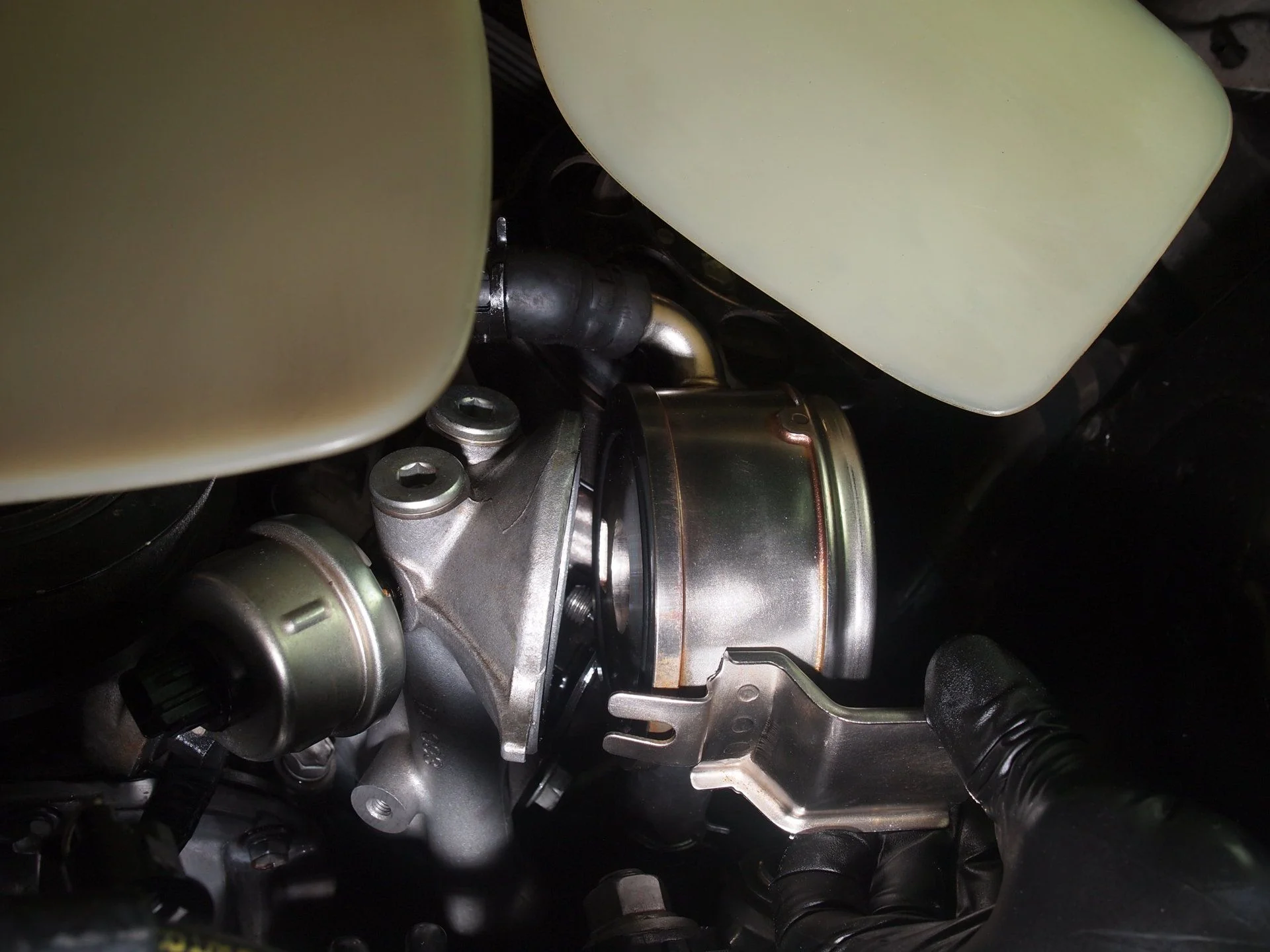

On the VVT engine, the VVt cam sensor on inside center of each head next to intake, are bit tricky to get wire house block to release, but no big deal.

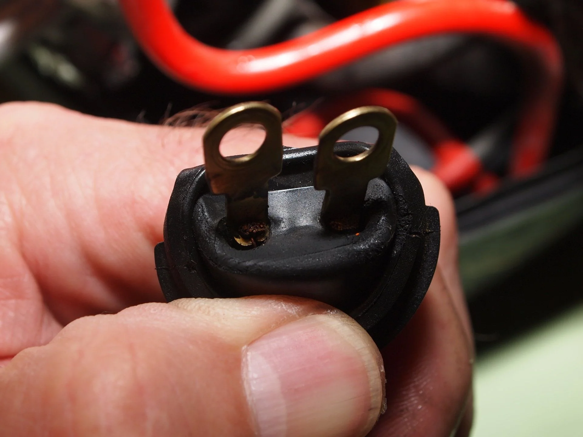

I had some brittle wire housings blocks that I replaced, which Toyota sell all of them that I've ever needed. But since I had two extra main ECU harnesses (GX470 & 4runner), I just pulled from them what I needed. Easier once you have the new OEM wire housing block(s) from Toyota, as it becomes apparent how to disassemble and assemble the puzzle within them when you do!

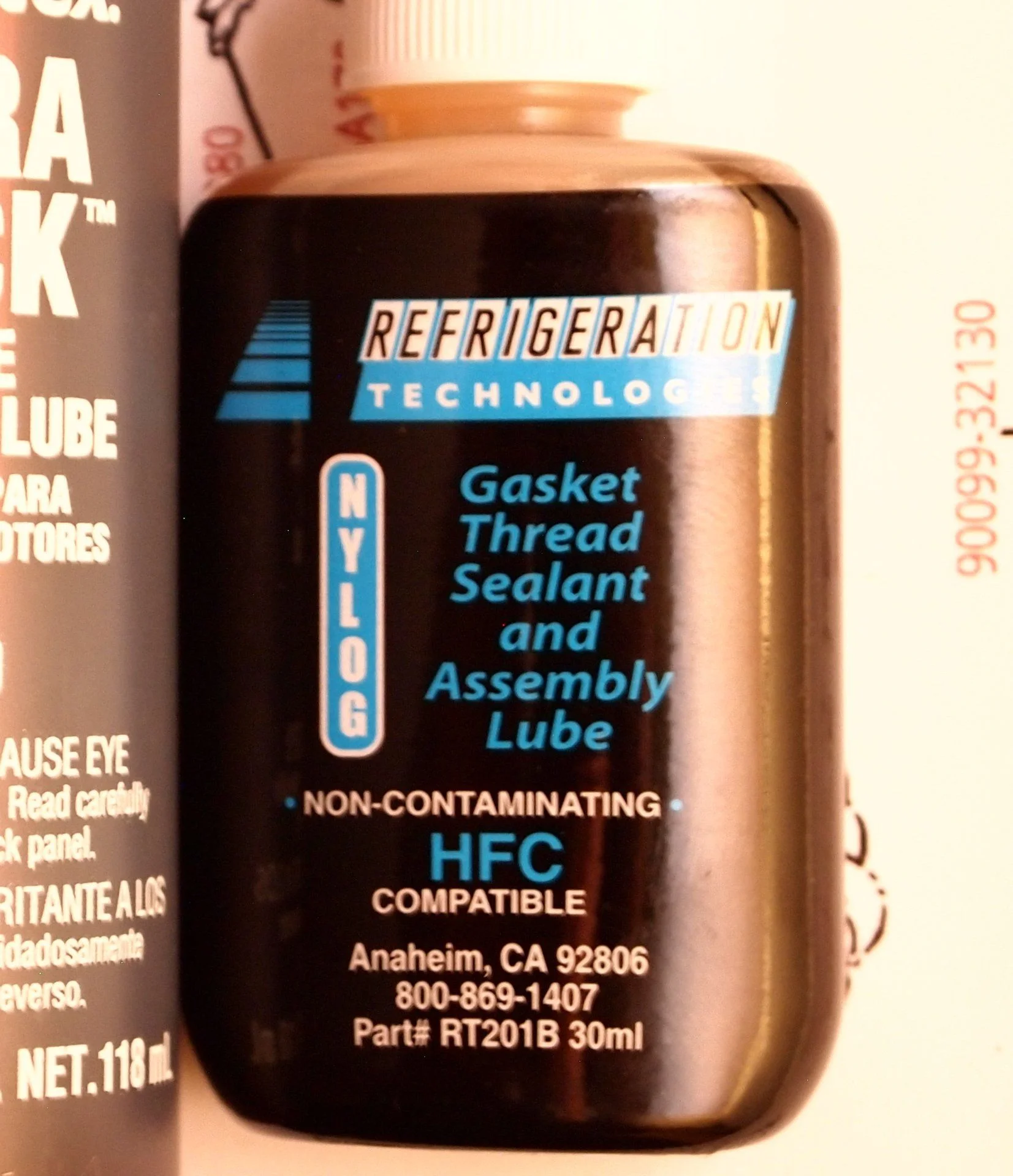

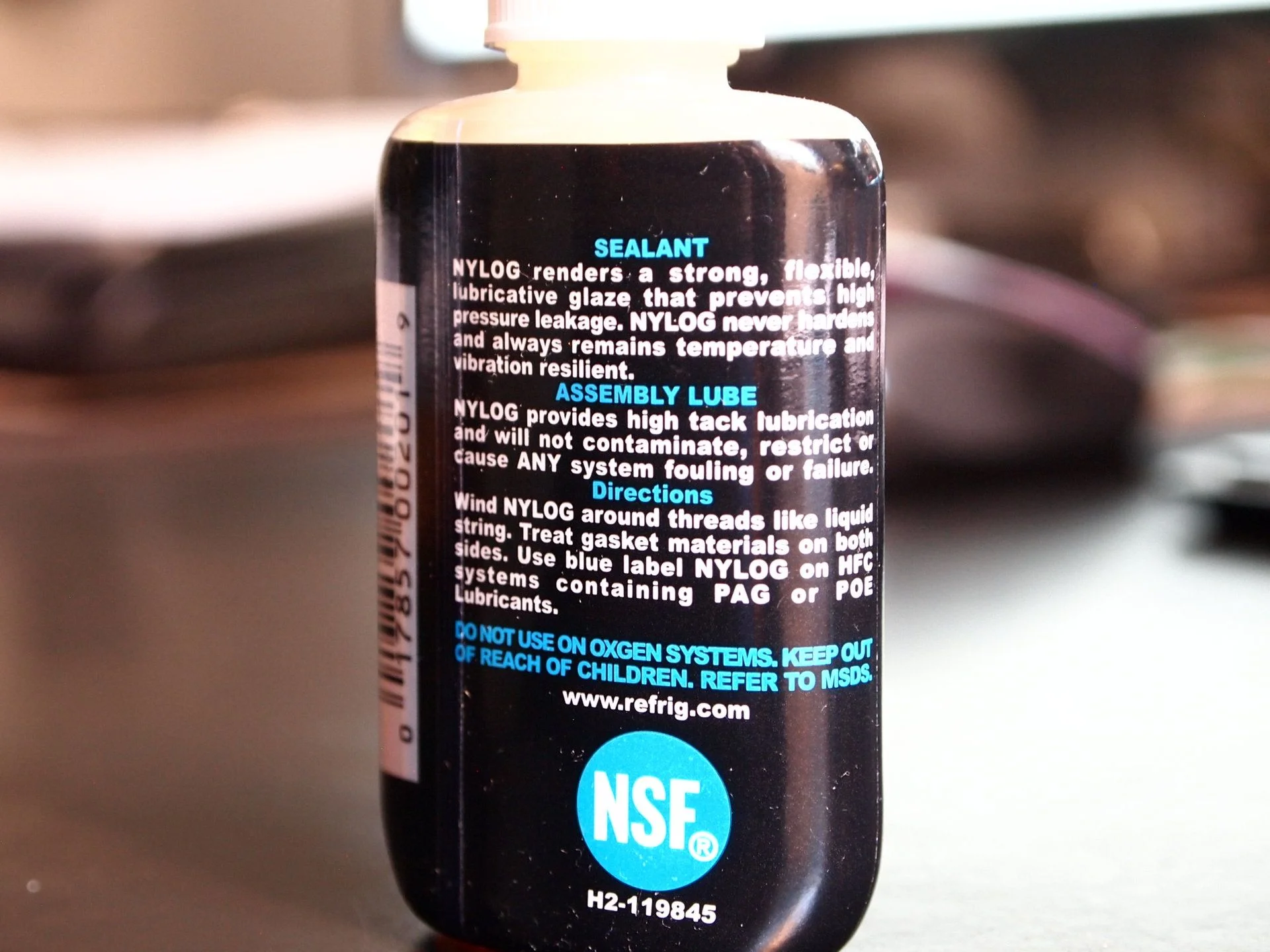

@flintknapper I picked up Nylog from a HVAC wholesaler today, the stuff you recommended.
It state: "Gasket Thread Sealant and Assembly Lube"
So it's safe for O-ring anywhere in AC system including compressor, and used inplace of or with the Denso PAG oil on O-rings correct. I called company to confirm, they said yes!
I'd also like to use in engine, on rubber O-ring where heat and motor oil will be present. Like oil filter bracket and oil cooler O-rings. I called company to confirm, they said yes it will work fine
Thanks my friend.

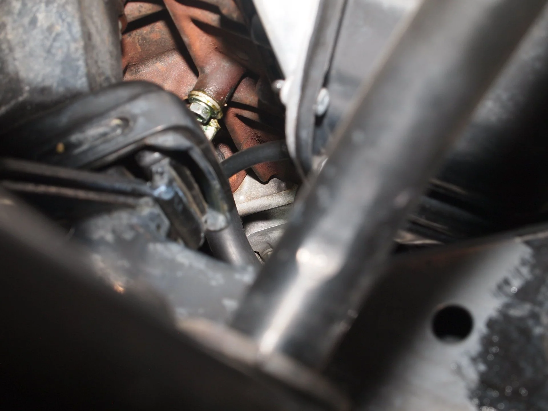

First issue was with the factory over torqued of flare nut of rear upper brake line, then Stoptech SS brake lines leaking.

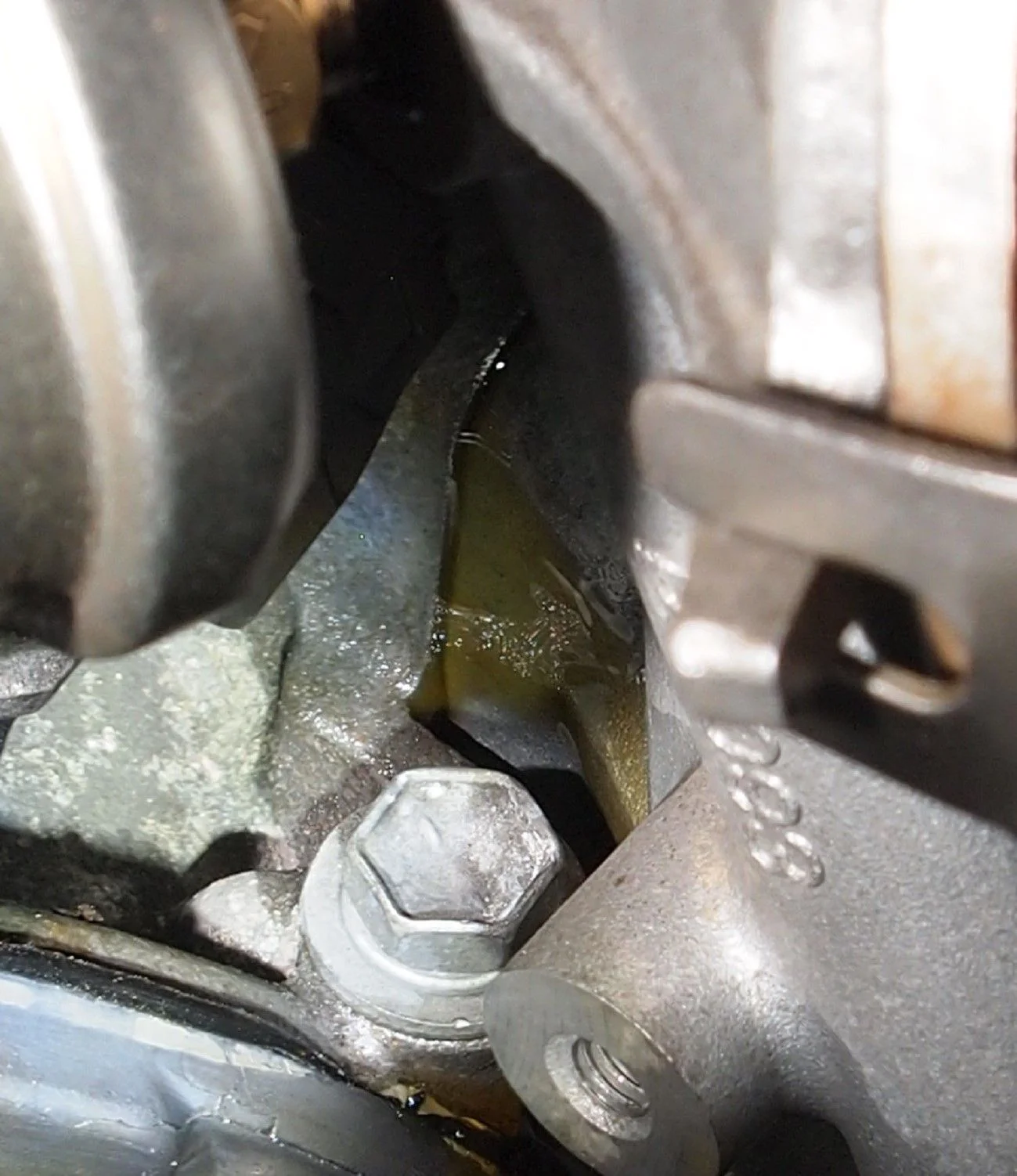

Once I fired it up, I found two issues "leaks".
One was coolant leak at lower radiator outlet to hose. This was the one I was concerned with. So I pulled the bad part (Spector Radiator) and shipped back. Waiting on a new Denso Radiator now. Edited: Denso from Amazon was out of stock. So picked up a CSF locally, which is same Toyota Dealership shop is using on customer car.
Other was and oil leak. After a run of bad parts and tools, this was frustrating. I can't say whether this was part's issues or my bad. Leak was at oil filter bracket to oil pump seal. A figure 8 O-ring is used here. I had noticed during engine assemble, the O-ring seemed a bit loose in it's groove and it came in a non standard plastic bag (not a Toyota package). It (o-ring) possibly sat open to the air in a parts bin for years, shrinking, or it's possible I messed up during assemble, IDK.

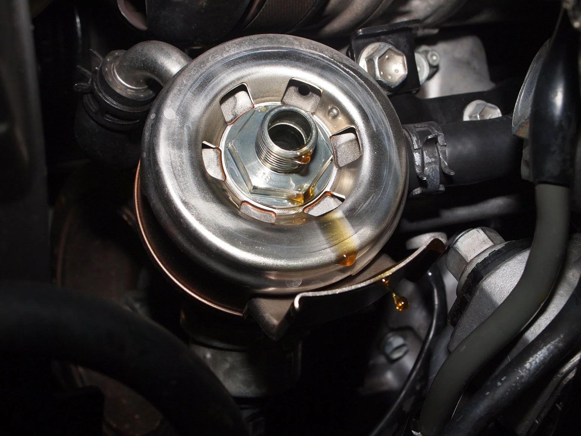

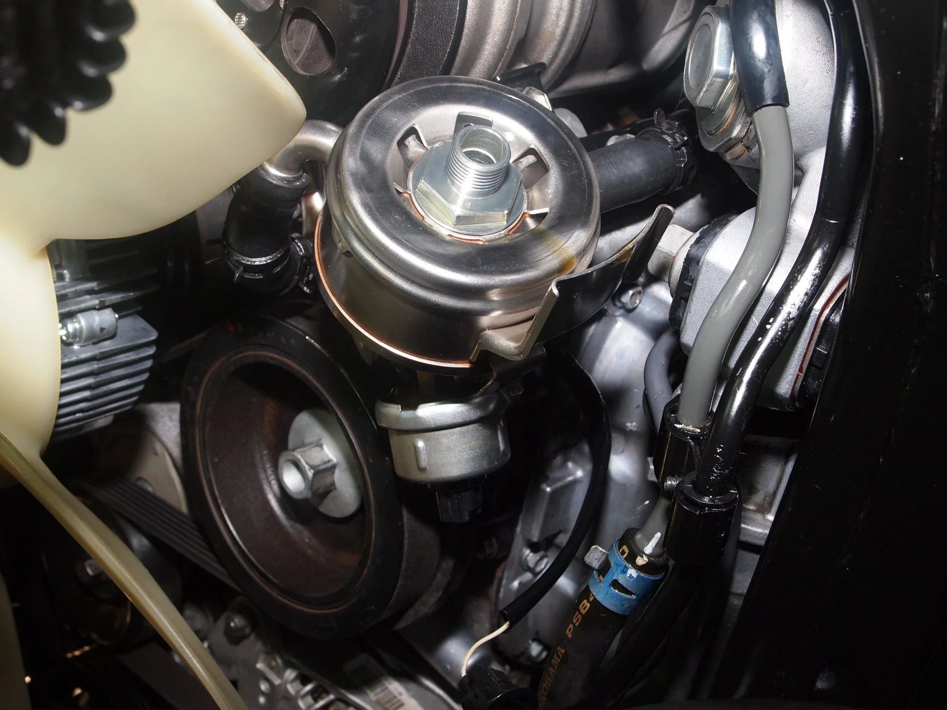

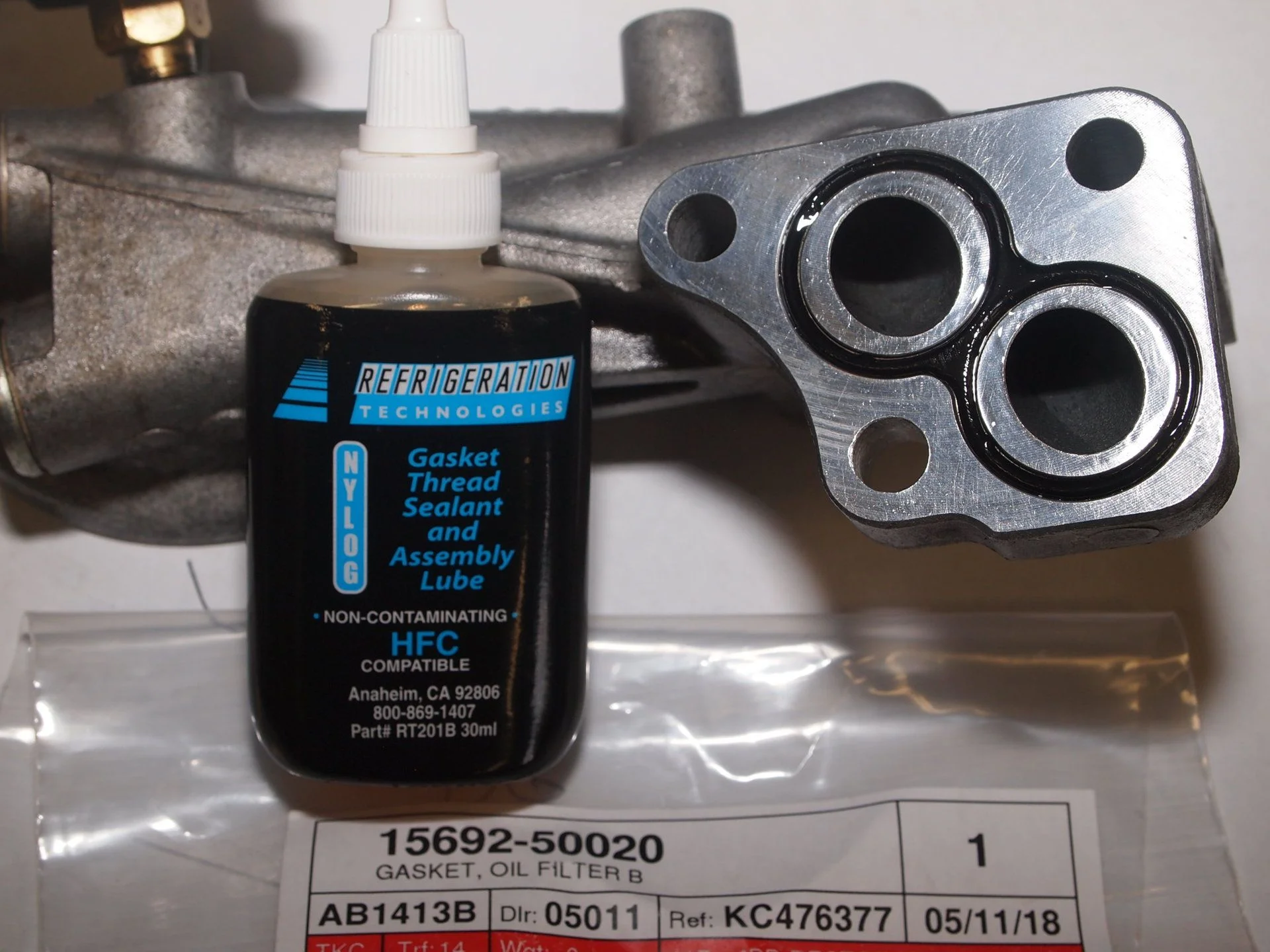

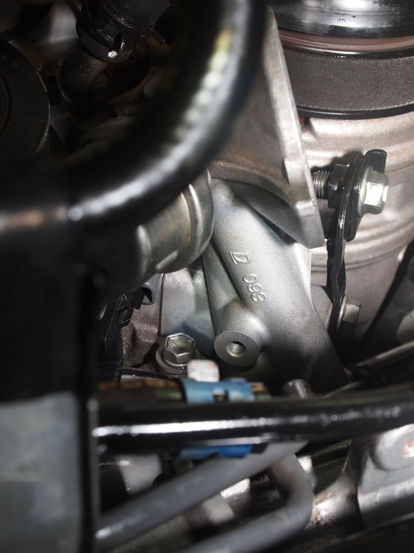

Oil filter bracket resealing, we've two oil seal here:
One is between oil filter bracket and oil pump, a figura 8 rubber O-ring. This one was leaking.
Engine off
Engine running:
Used the Nylor @flintknapper turned me onto, after reading label and speaking with company. I was then comfortable using Nylog (sticky) to hold O-ring in place during assembly.

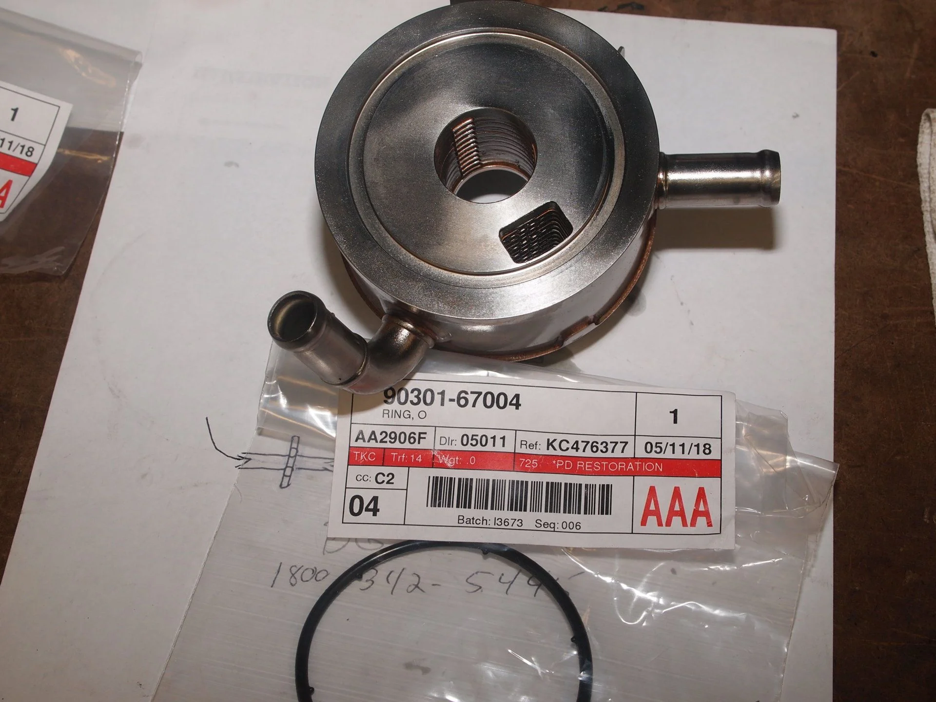

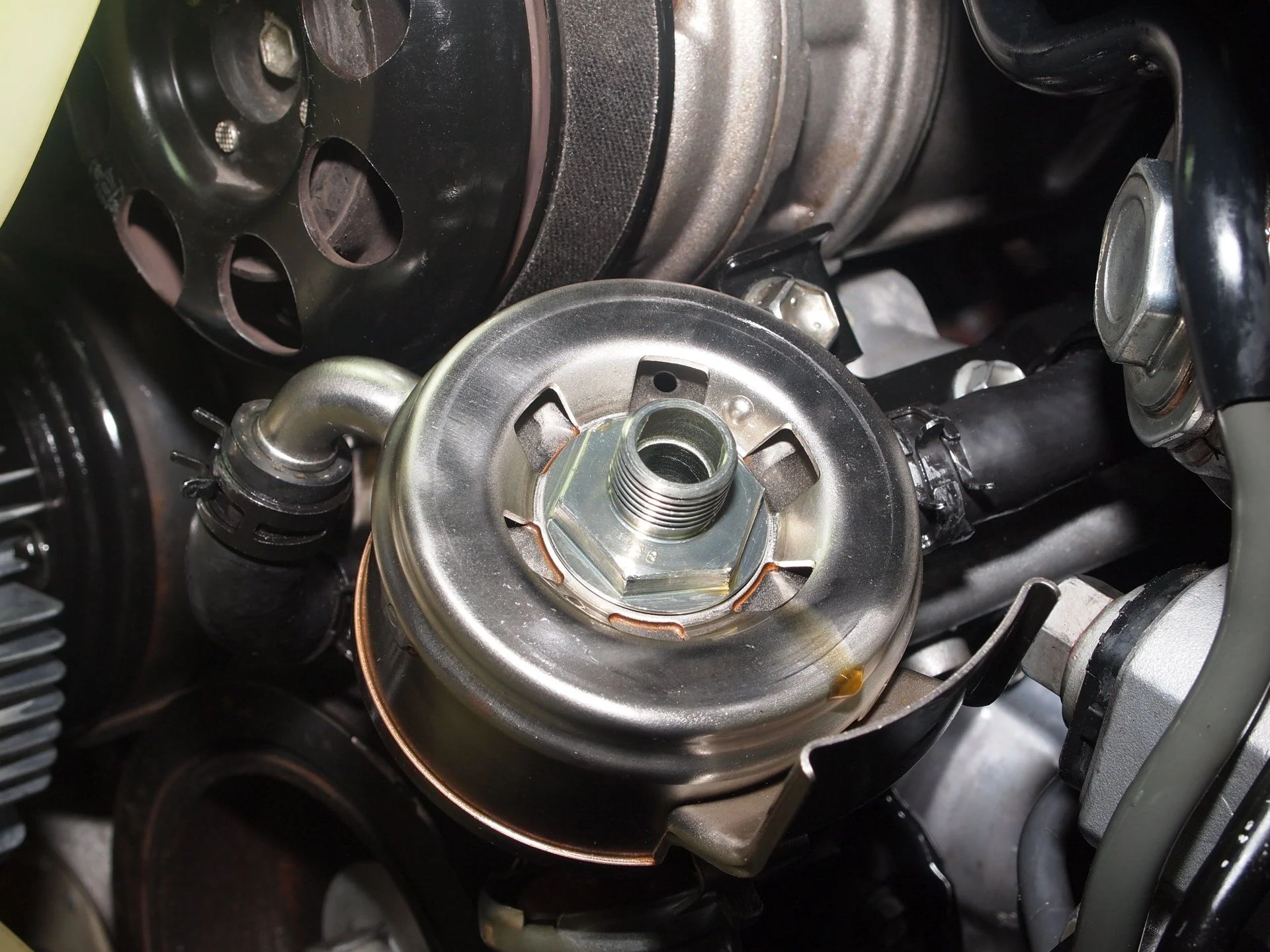

The second is between oil cooler and bracket, large rubber O-ring. Was not leaking but replaced again anyway.
Even though both these O-rings were just installed and only brought engine to operating temp twice for a few minutes, I replaced them both again.

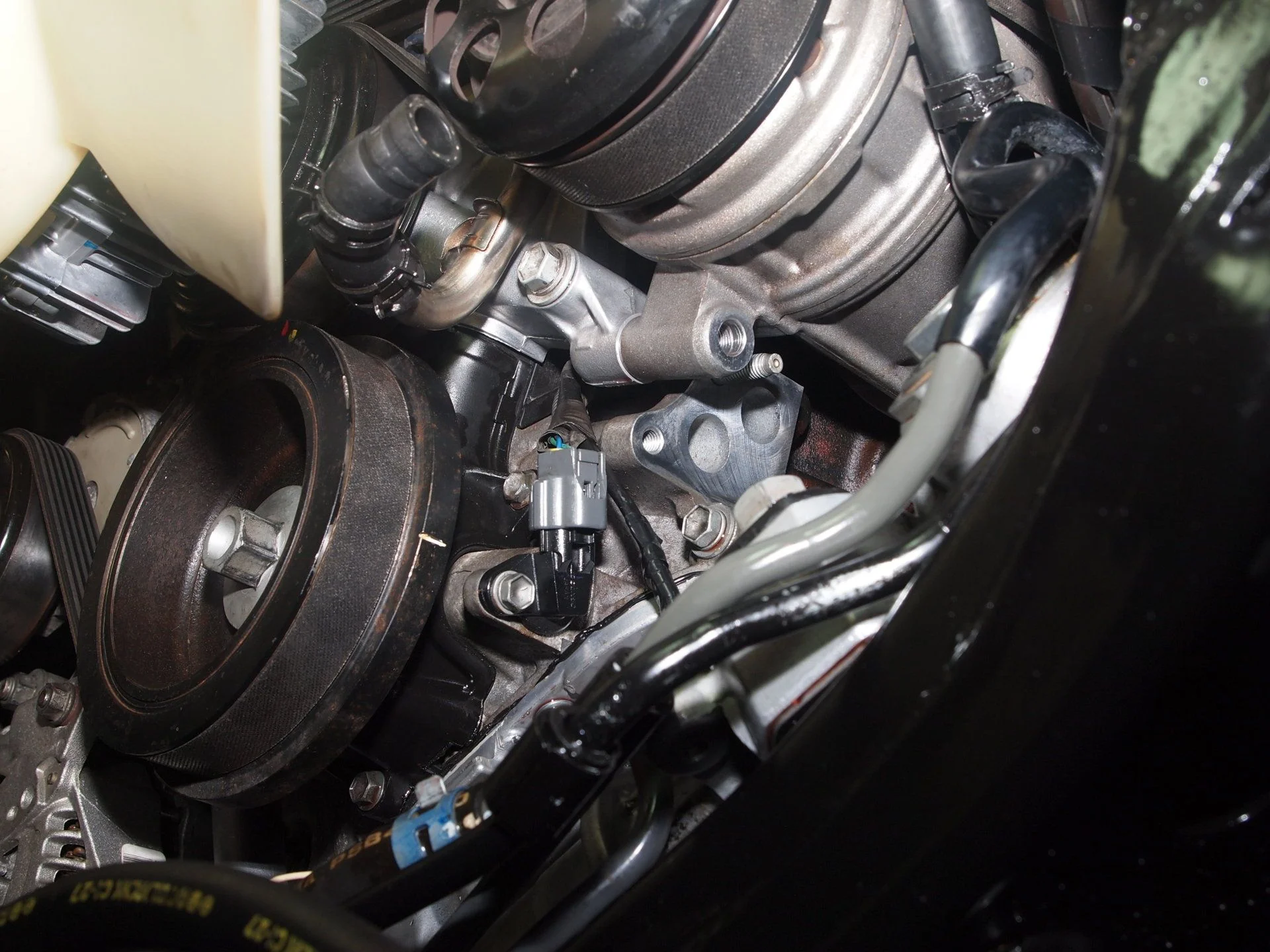

After drain coolant from Radiator and LH side of block. I removed oil filter, oil cooler & hoses and oil filter bracket. Most bolts are accessible from between crossmember and steering rack arm boots.
Oil bracket off
I can't get a view of O-ring between oil filter bracket & oil pump during install to see if still in groove. This is why I used Nylog to hold in place. Wheel bearing grease or assemble oil can also be used here to hold O-ring in place.
I torque the two bolts and one nut of bracket to 13ft-lbf. Then the one long 14mm bolt holding AC compressor retainer placement bracket to 36ft-lbf.
The short bolt holding the two pieces of AC placement bracket together was not removed. It's take 45ft-lbf torque IIRC
Largar O-ring for oil cooler to oil filter bracket can be seen during install, so no "sticky" holder like Nylog was used.
Large oil cooler O-ring was inspected after I slipped on both coolant hoses, before bolting in oil cooler.
I torque the oil cooler bolt to 54ft-lbf.
Placed coolant hoses clamps back in same place they were in, once I had everything torque in.

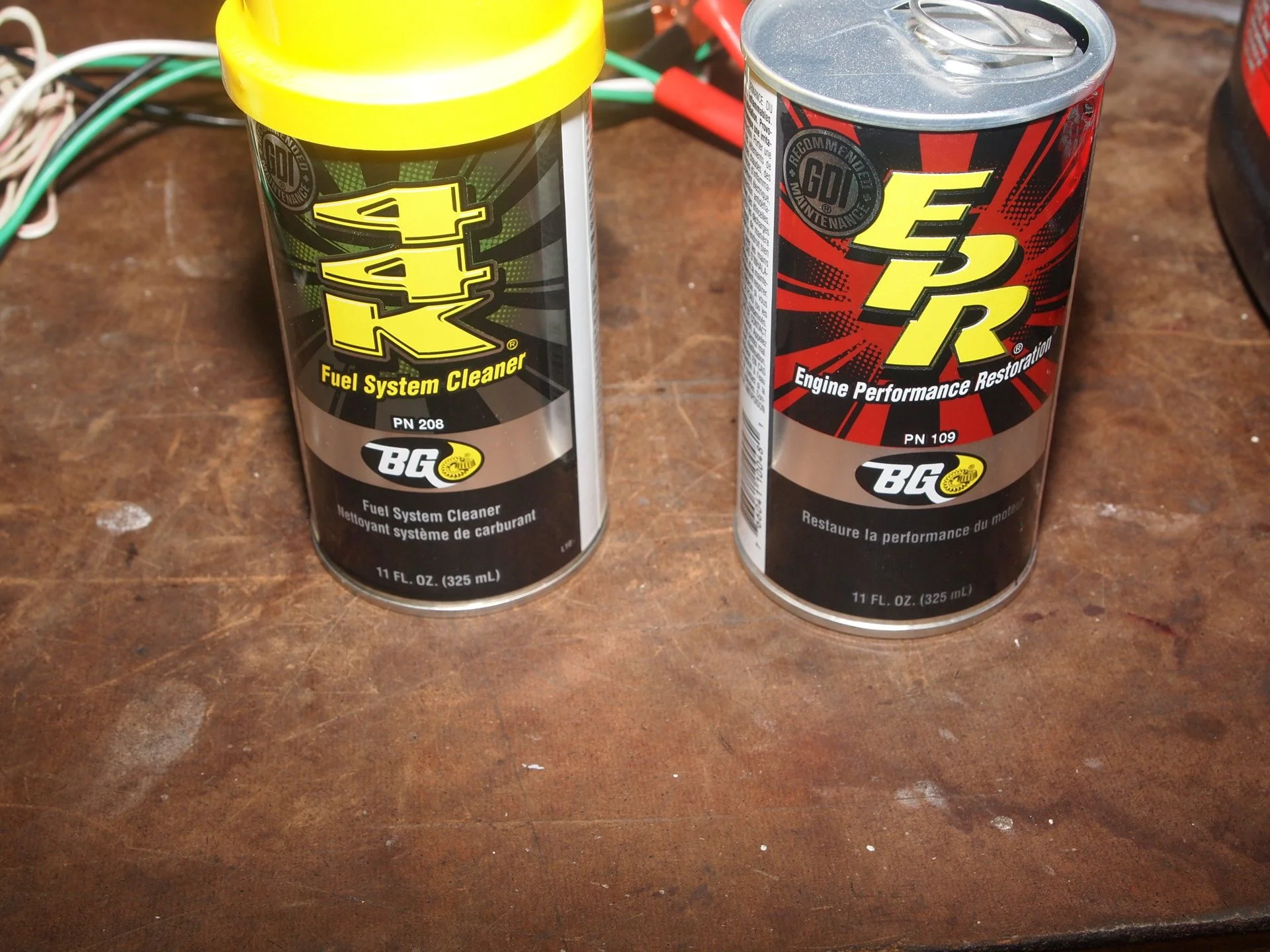

I as added BG EPR, filled with gas and add a can of 44K to the gas tank, and drove about 30 minutes before flushing the oil I had just put in. Oil came out looking like it went in very clean. This is one clean engine internally, even before flush.
I then refilled with M1 and a can of BG MOA the liquid gold.

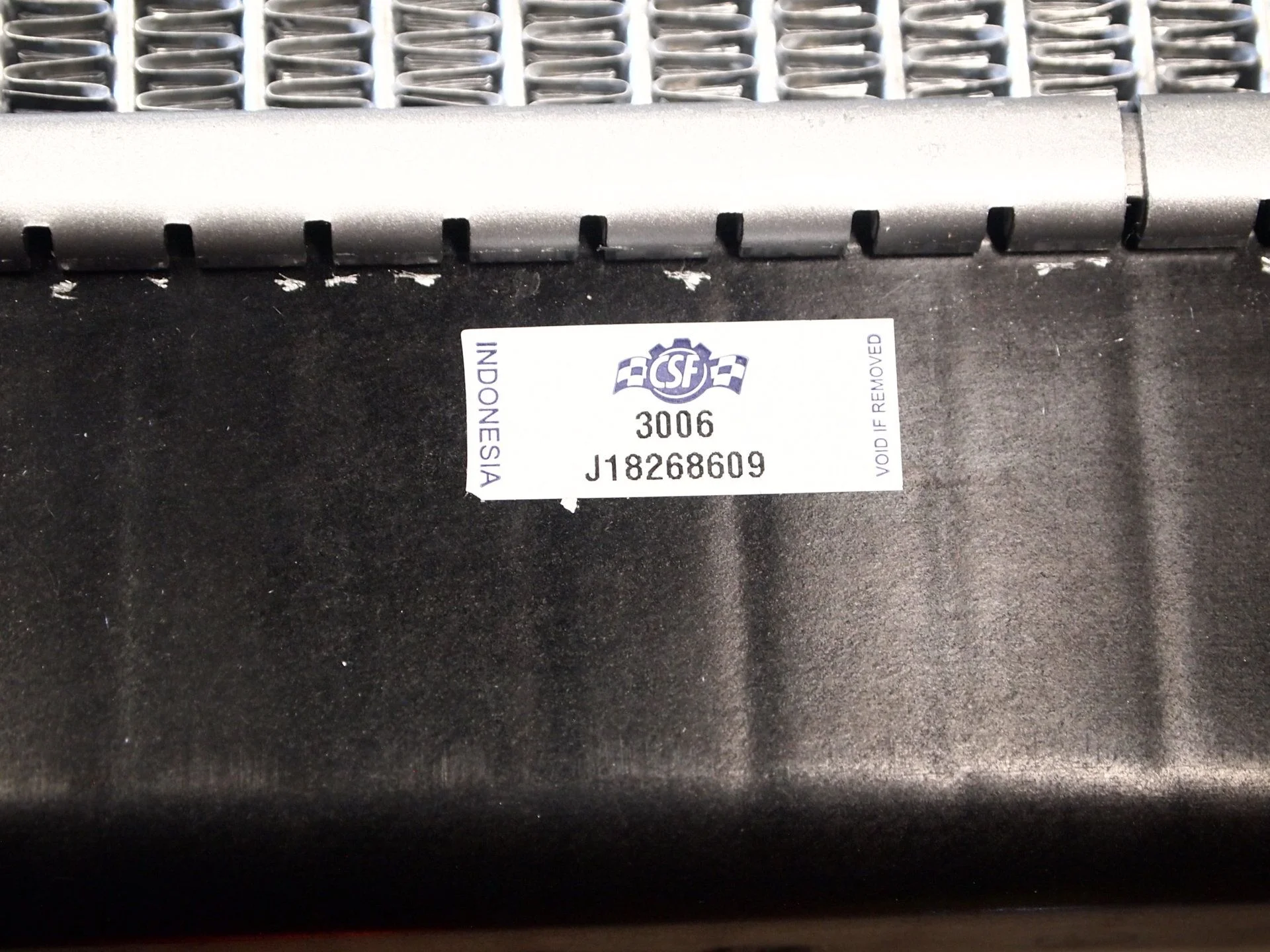

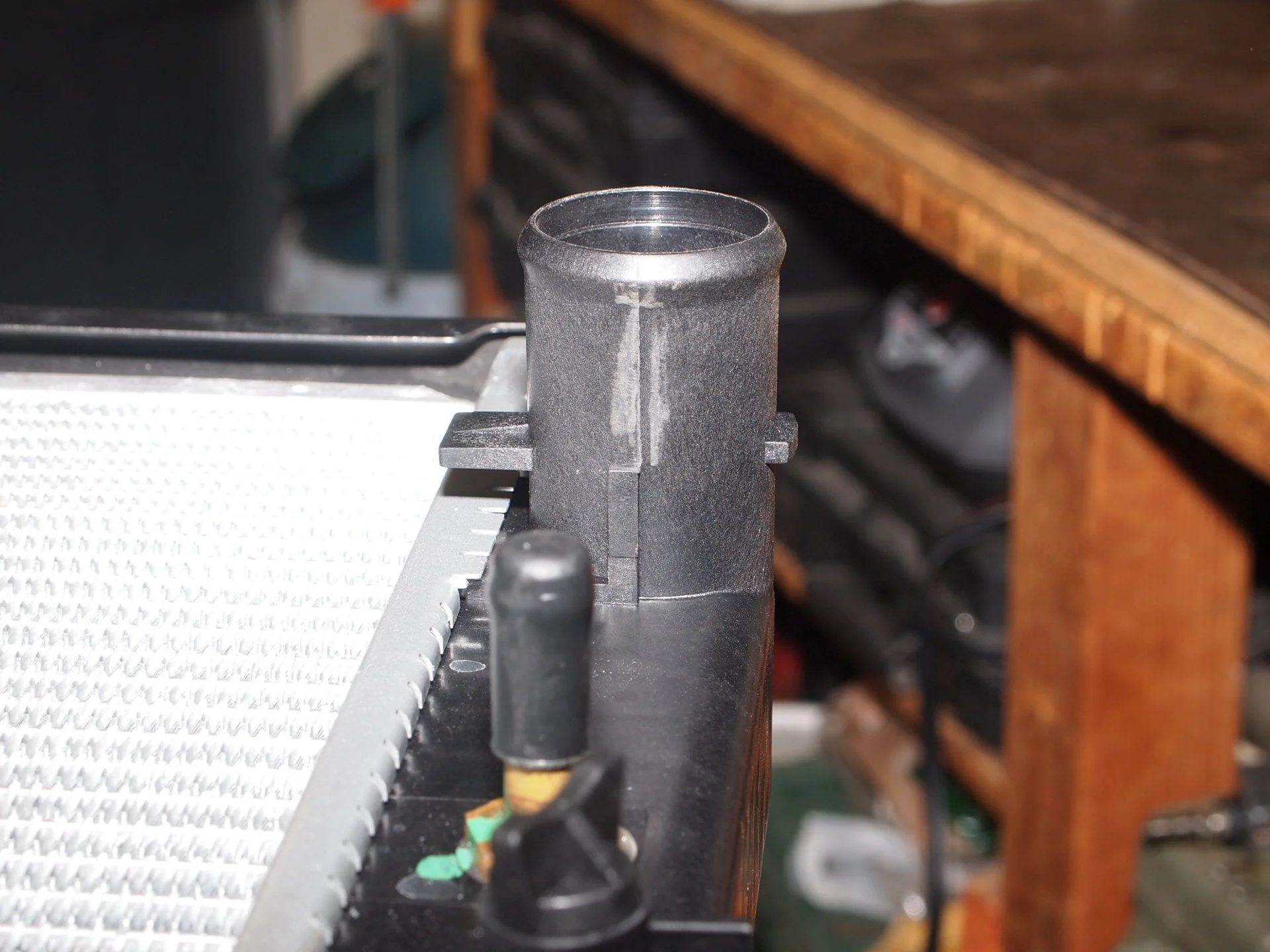

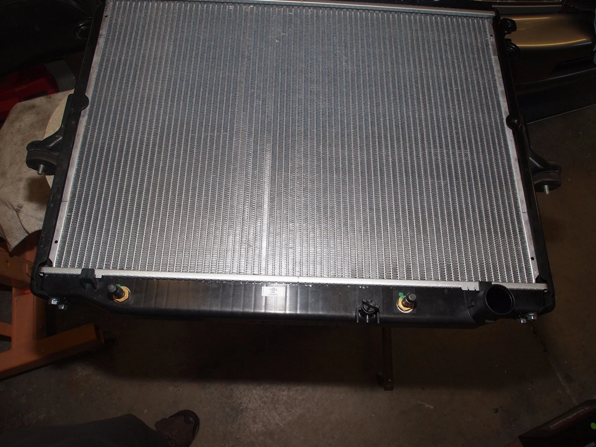

How'd the CSF radiator look upon arrival: as good of packaging as they claim in their marketing material ( drop tested from 10ft)? Did the inlet and outlets measure to factory spec? Are you satisfied with CSF as a quality replacement?
Packaging was good. Rad was firmly held in box, with styrofoam all good and in place. But keep in mind it was picked up from Advance Auto, not an online order delivery.
It measured the same as the Spectra. Small on all measurements compared with the Factory's that came out of my rig.
The CSF differences as compared to the Spectra:
1) Casting marks at sides of lower CSF's outlet, as opposed to top and bottom of Spectra.
2) Cast marks less pronounce on CSF and smoothed out nicely without the V (valley) I found on the Spectra.
3) Felt heavier out of the box. Not as heavy as OEM, but heavier than the Spectra.
4) Took ~1/3 qt more to fill.

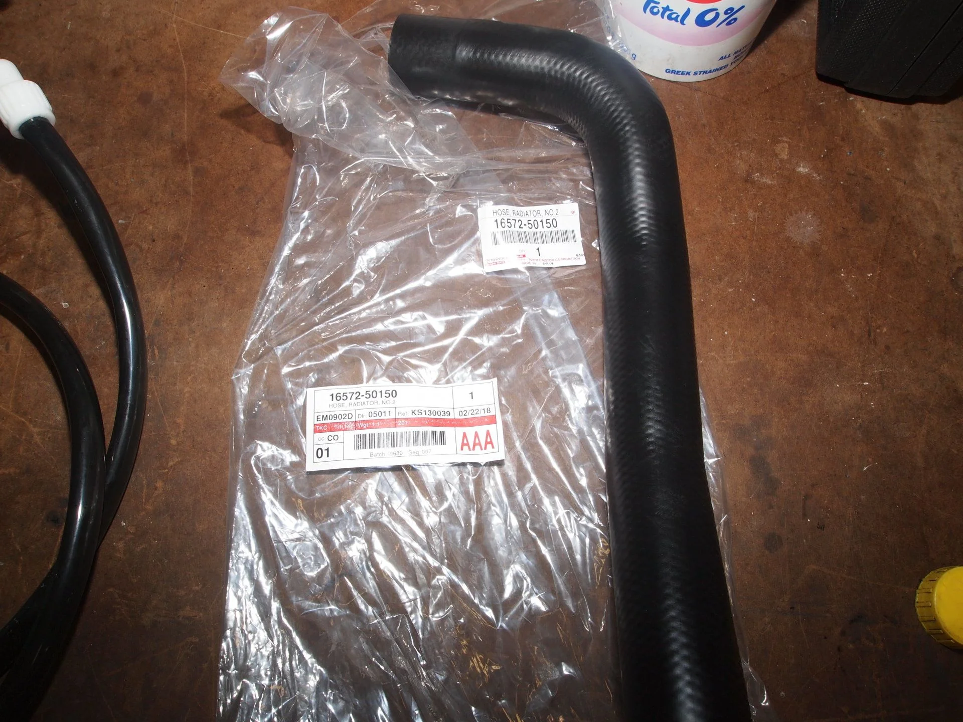

I did use a new OEM lower hose with the CSF so not a fair comparison. But without V seen in casting marks, I was more comfortable with the CSF than the Spectra. It is also what local Toyota Dealership is using in the shop on customer cars currently. Seems even the Dealerships aren't using OEM.

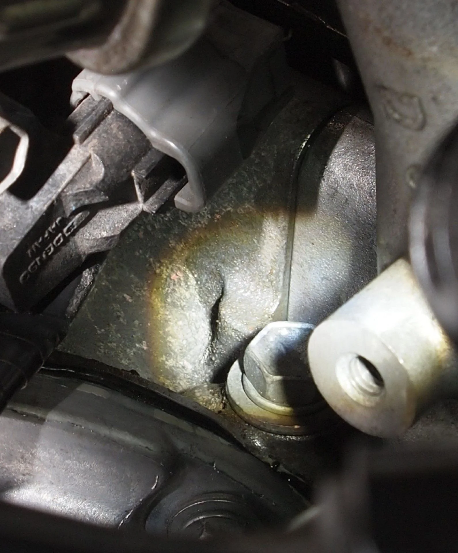

With all the dust from dirt roads I'll be washing today. But first I'll get under to look for leaks. If any, the dust should aid in spotting.

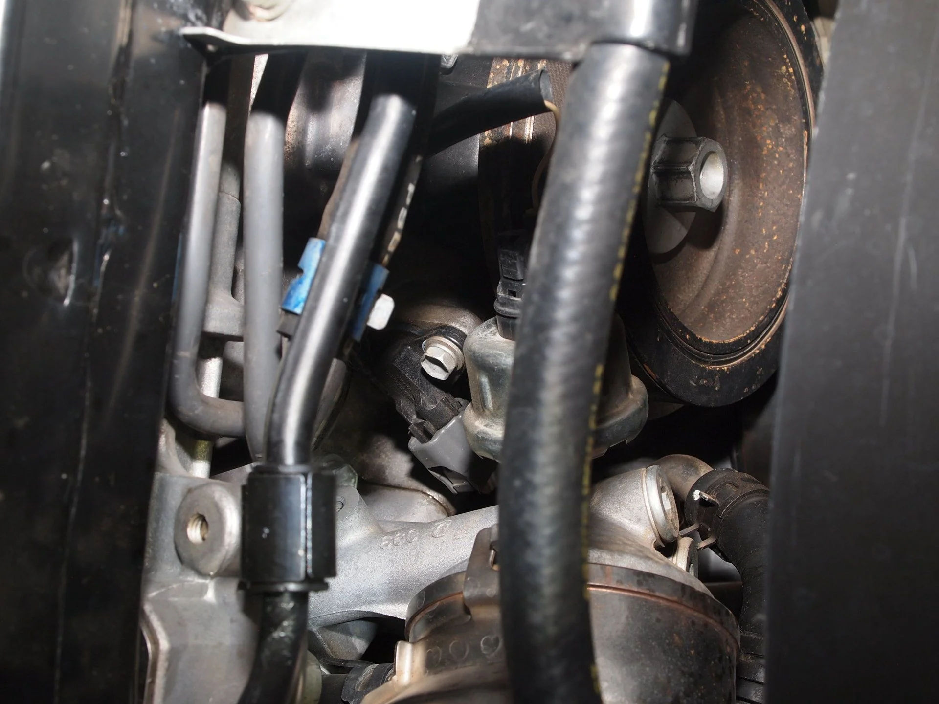

Looked dry under the rig. I did see what may be some of the Nylog I used on oil filter bracket. I re-cleaned with degreaser and will spot check after each time I run engine. All brake connections dry. No coolant leaks. No gear lube leaks. Both weep holes dry. Both valve covers dry.
Front view of oil bracket. Has oily looking spot, looks stationary so I suspect it's the Nyloc I used to hold seal (fig 8 O-ring) in place.
Oil filter bracket after fix and first cleaning.  Recleaned and will inspect again (1).webp
Rear view of oil bracket, it is dry.
Oil filter bracket after fix and first cleaning.  Recleaned and will inspect again Rear view.webp
Oil bracket, after cleaning with a degreaser and driven for 5 minutes. Looks dry, but I'll keep checking.
