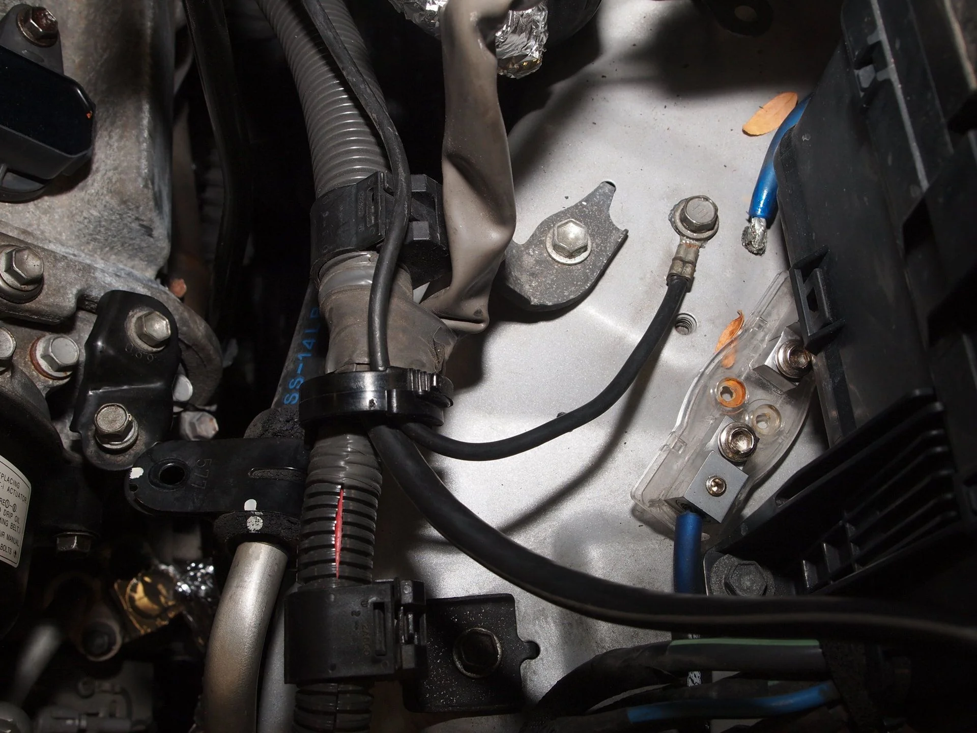

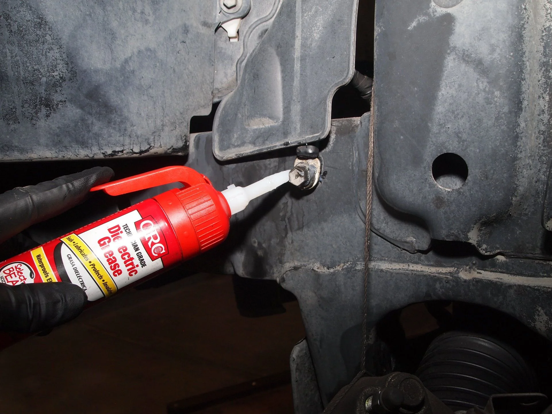

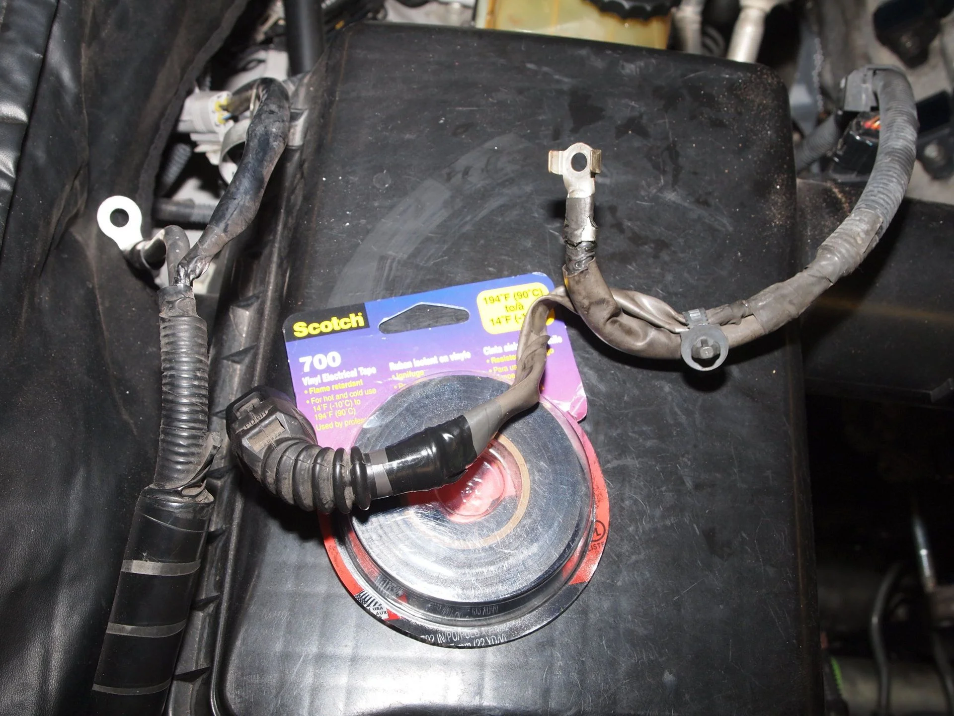

Frame ground wire.
Firewall ground wire.

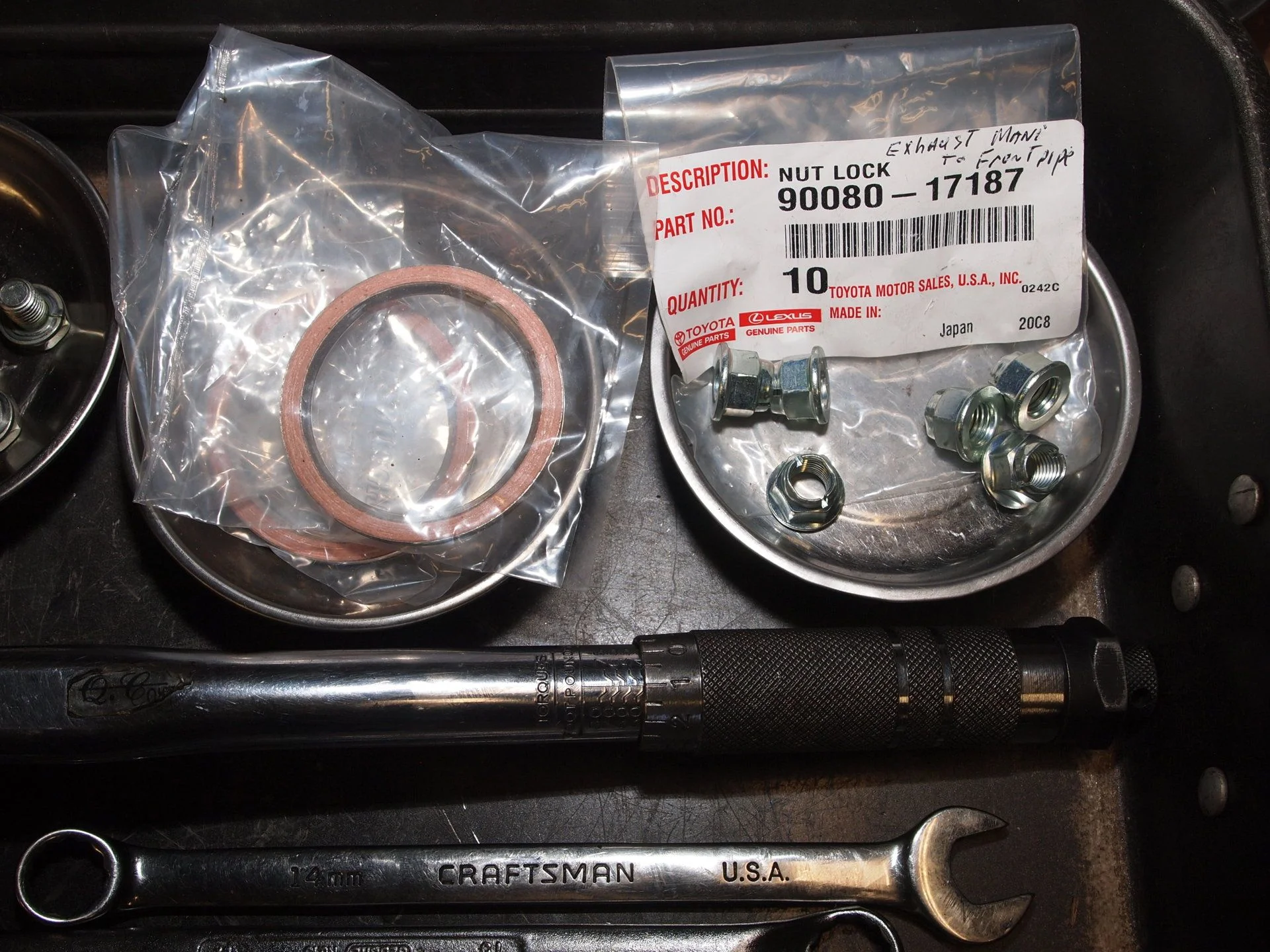

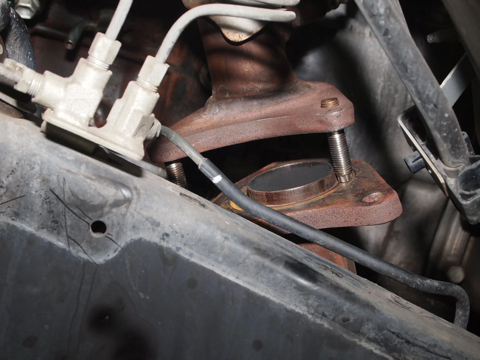

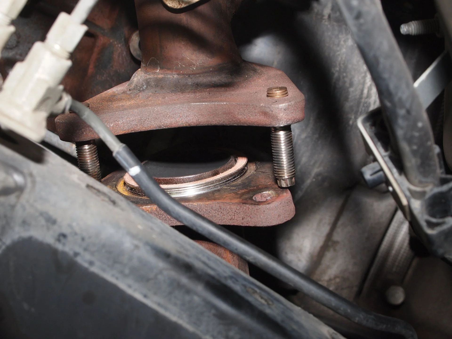

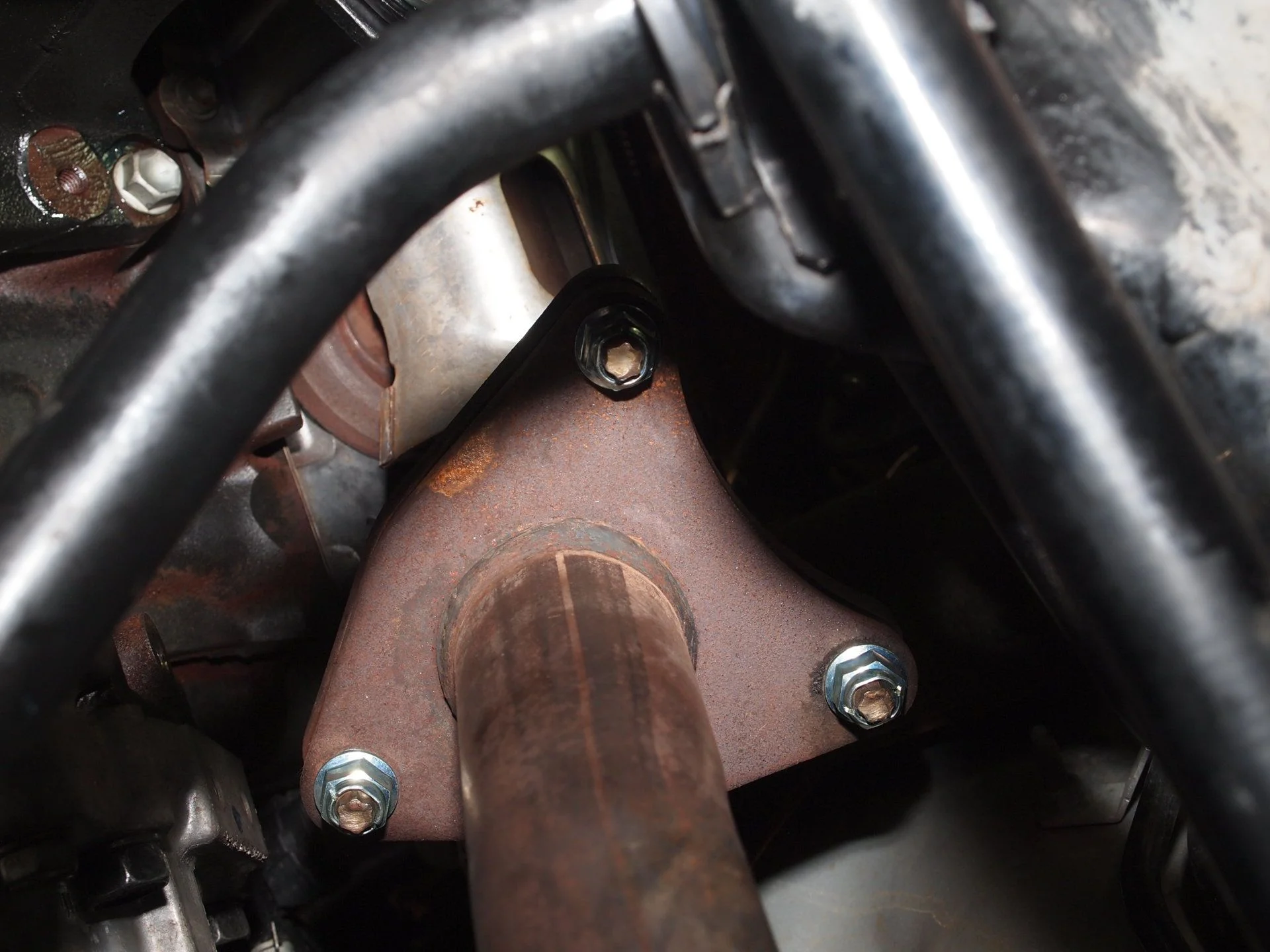

New pipe flange to manifold Exhaust Gasket and Nuts.
I did not place exhaust pipe gaskets on pipe flange pre install of engine, to mitigate risk of damage. Good thing, as it would have been hit with stud for sure!
New OEM gasket on cleaned surface.
Torque 46ft-lbf in steps

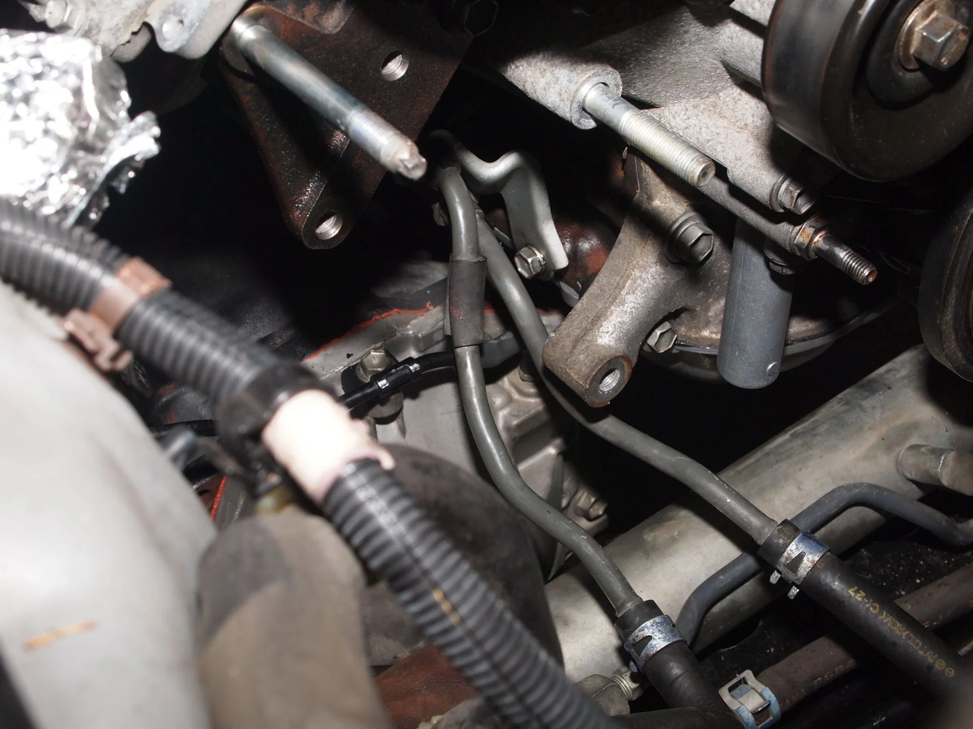

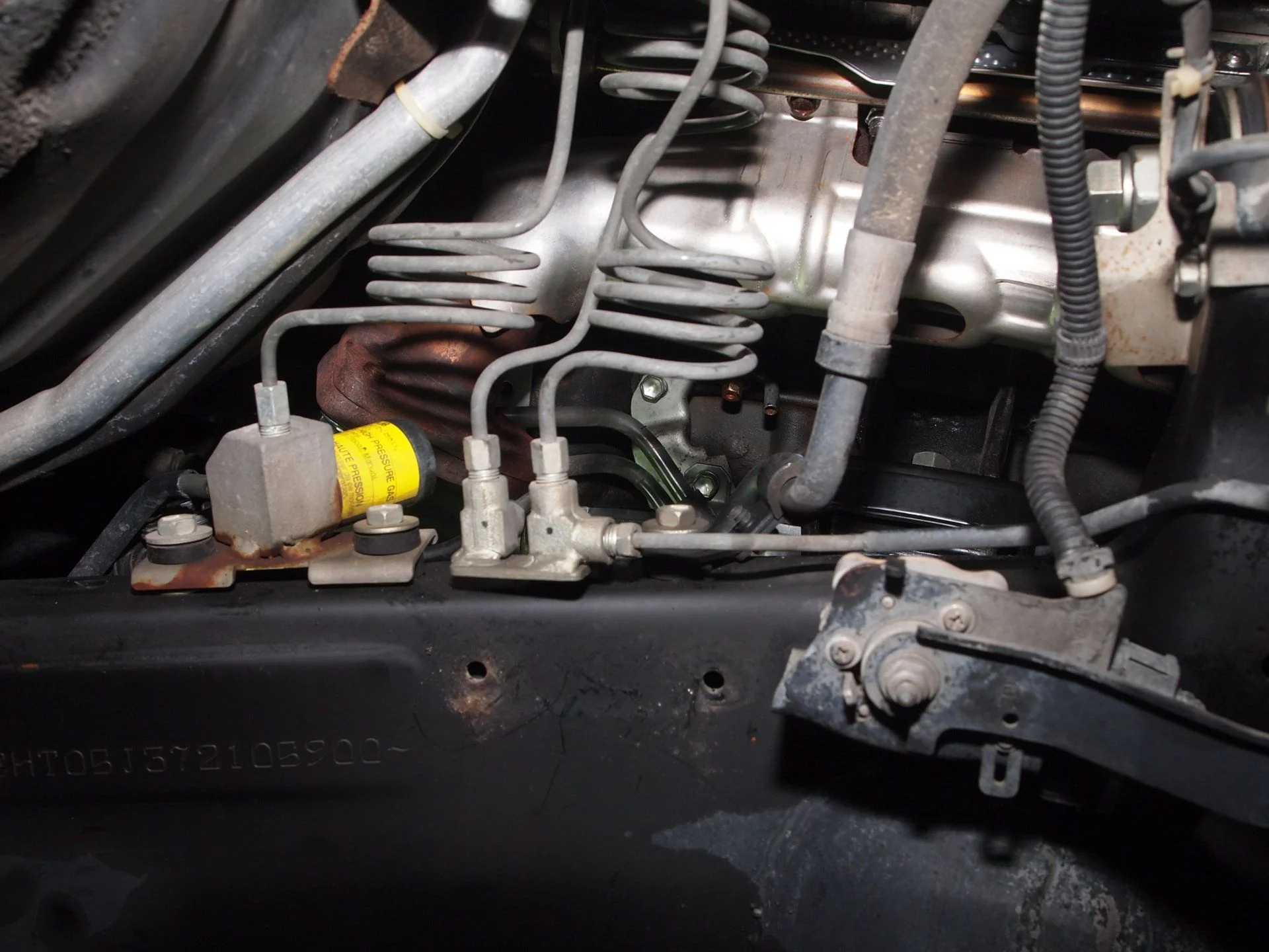

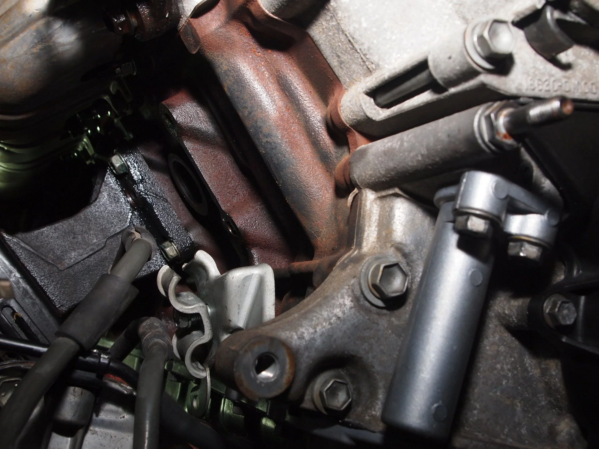

Transmission cooler lines along engine block attaching to bracket would have been easier with front differential out of the way.

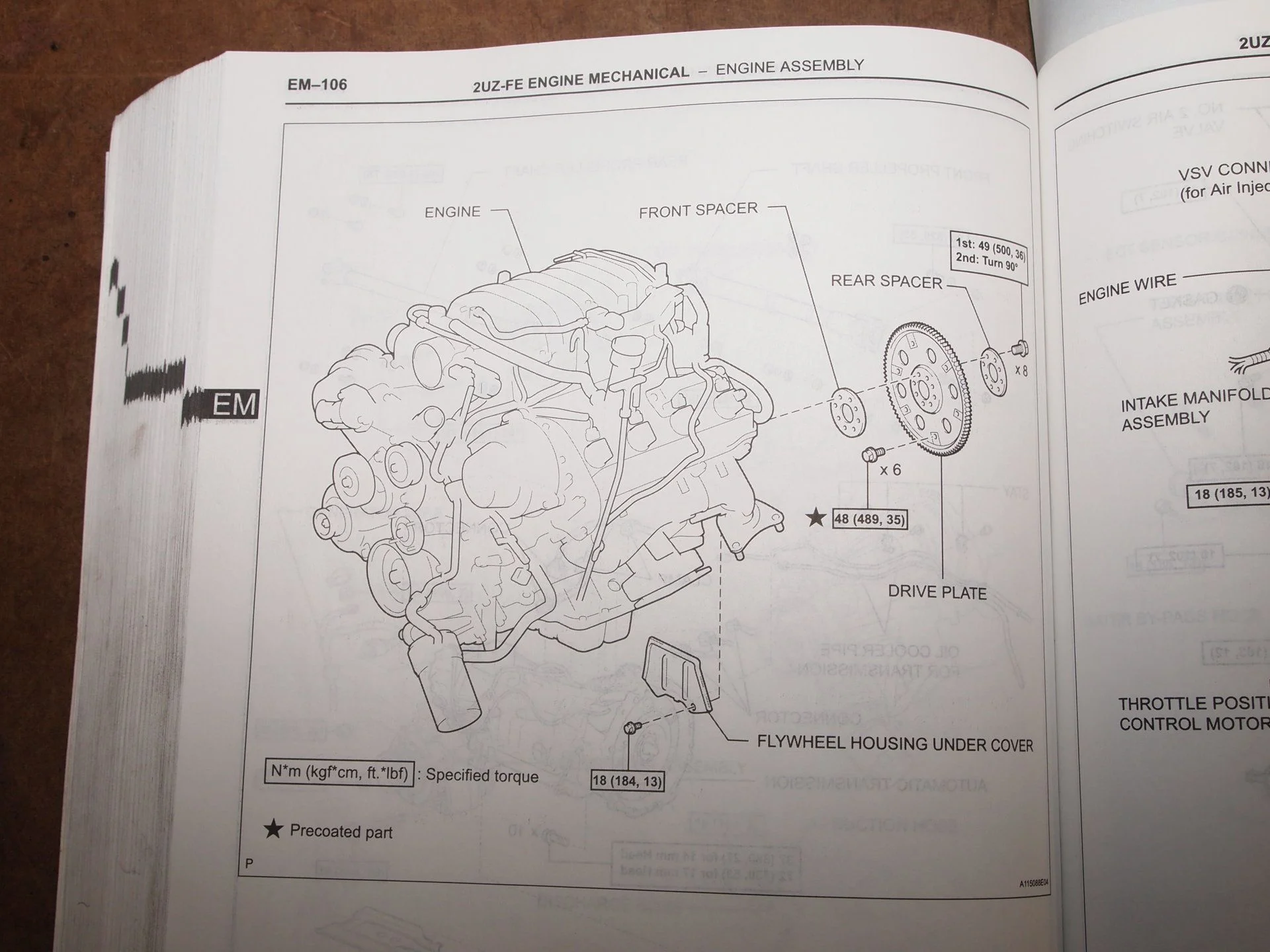

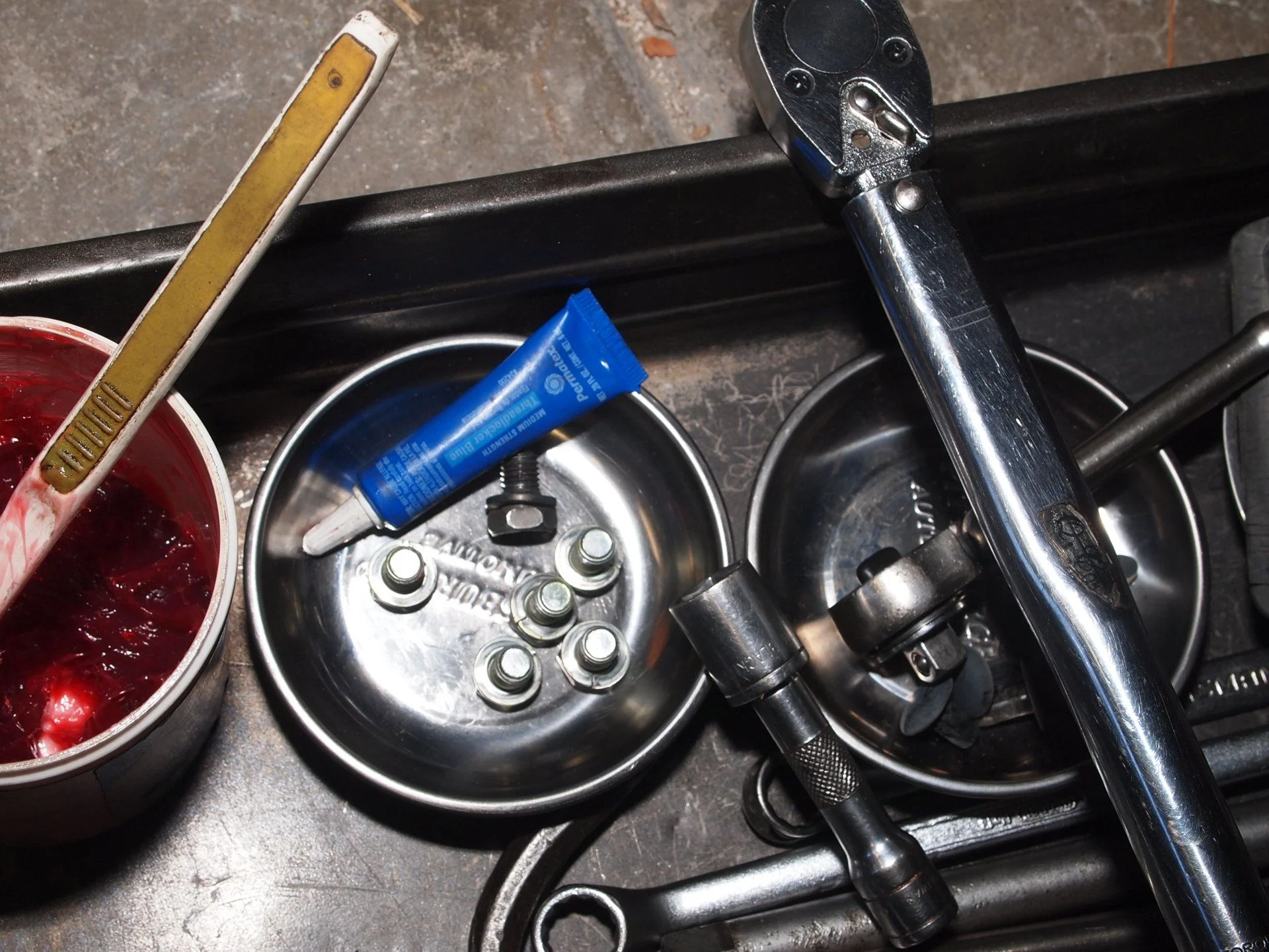

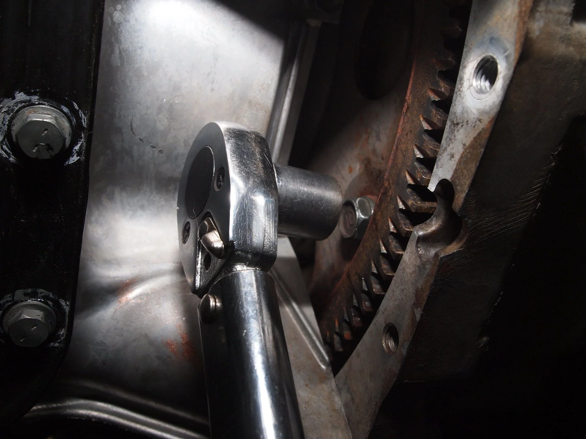

Drive plate (AKA Flexplate) to torque convert bolting up, using sealer on threads.

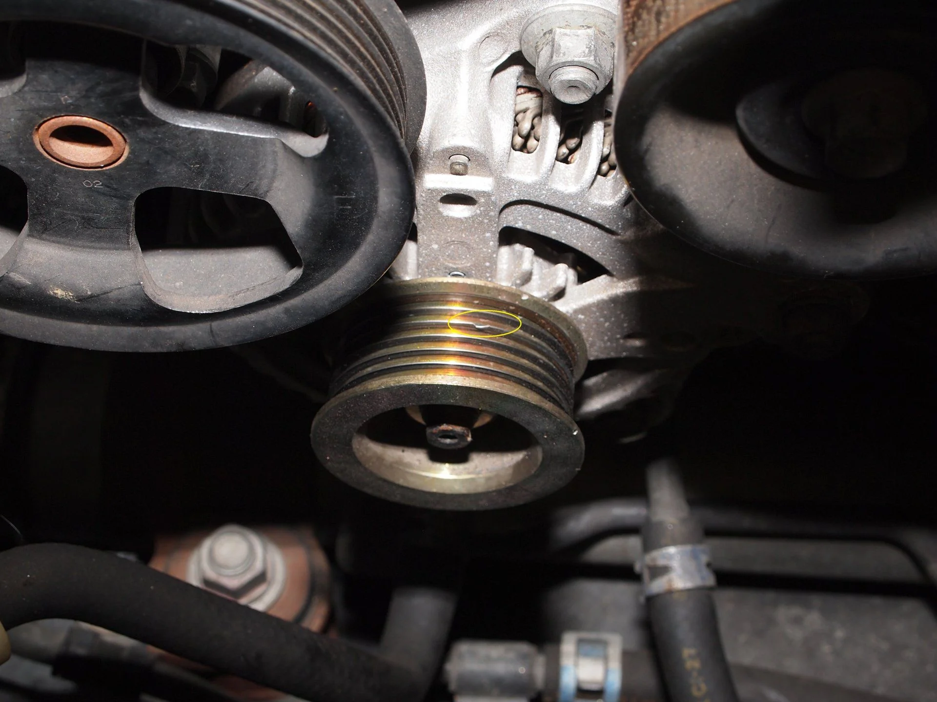

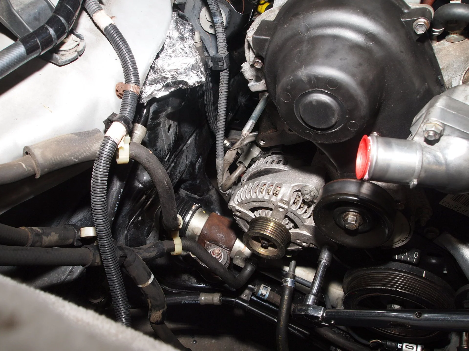

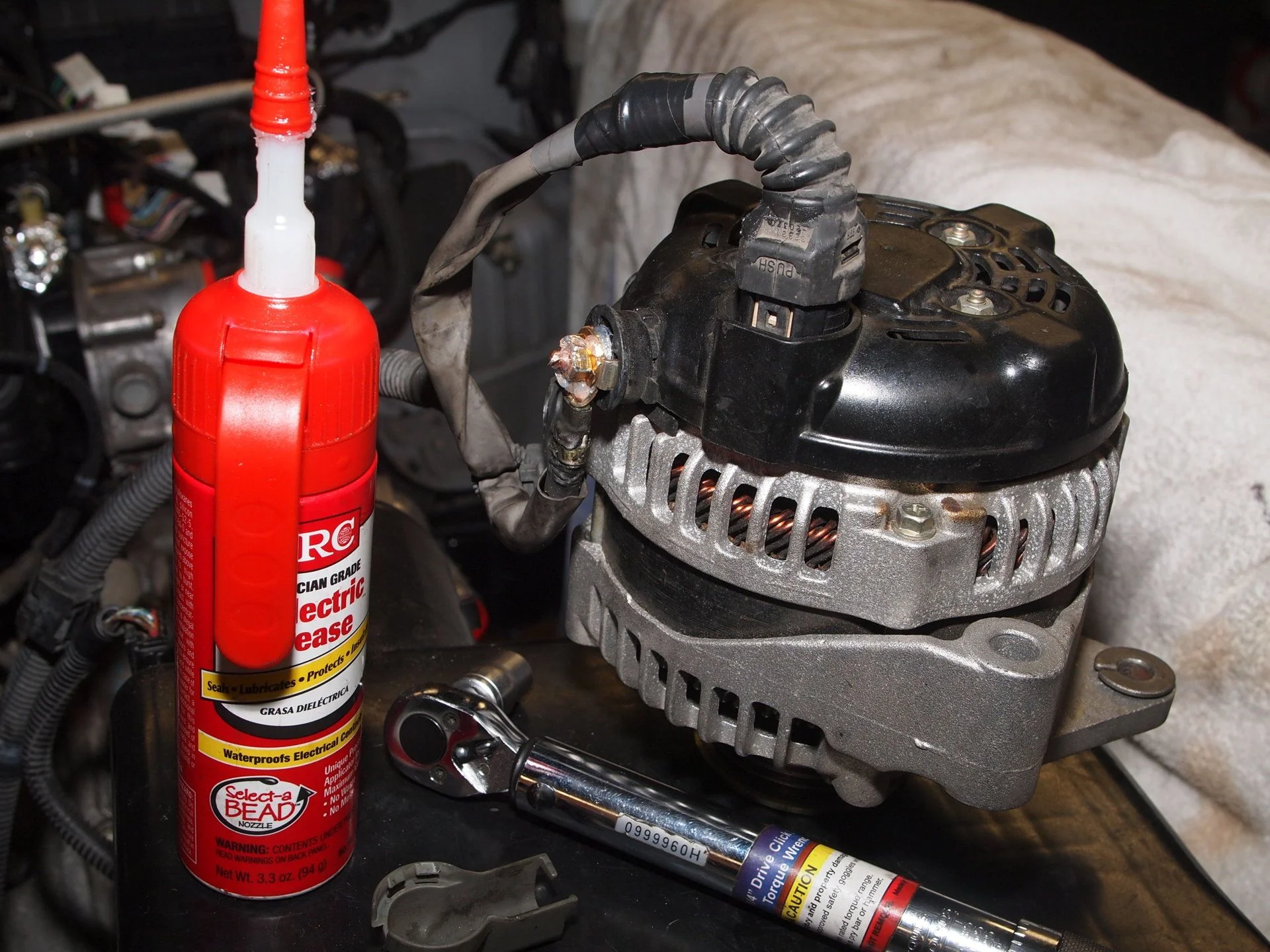

Generator Assemble (AKA Alternator) install.
Found a chip on pulley I filed out.
7ft-lbf on wire nut
Torque 12ft-lbf on 12mm nut, 29ft-lbf on 14mm nut & bolt.

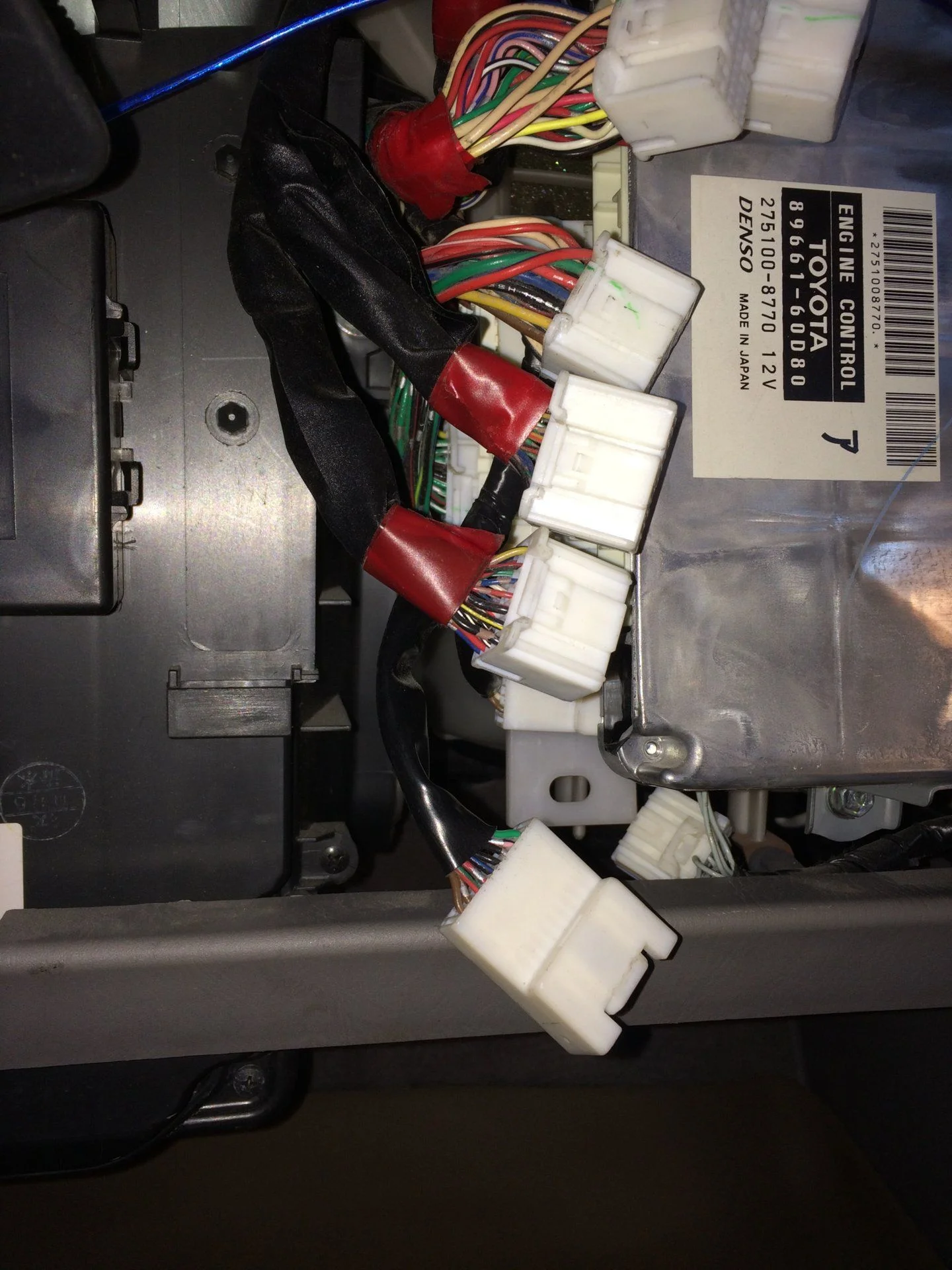

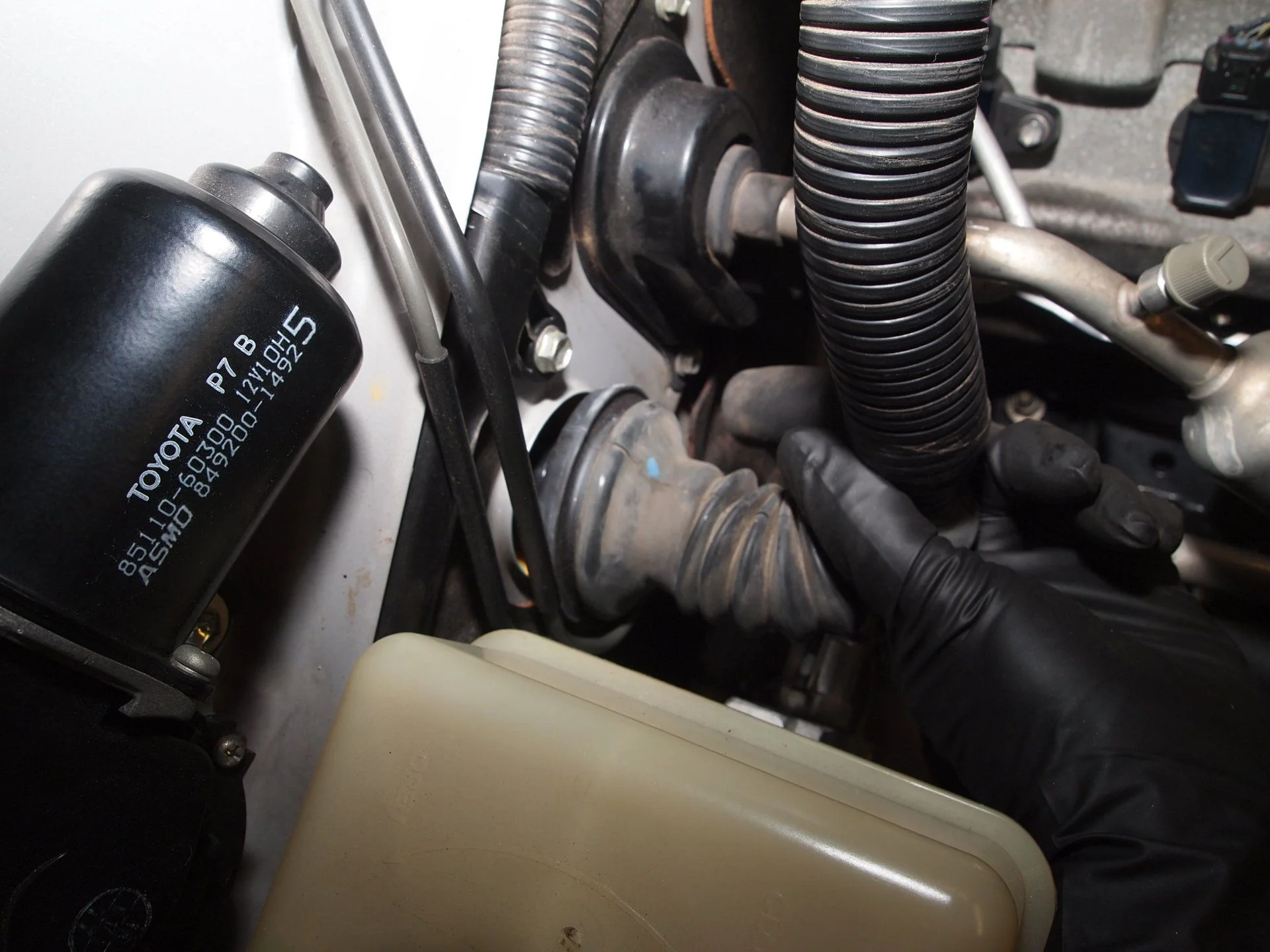

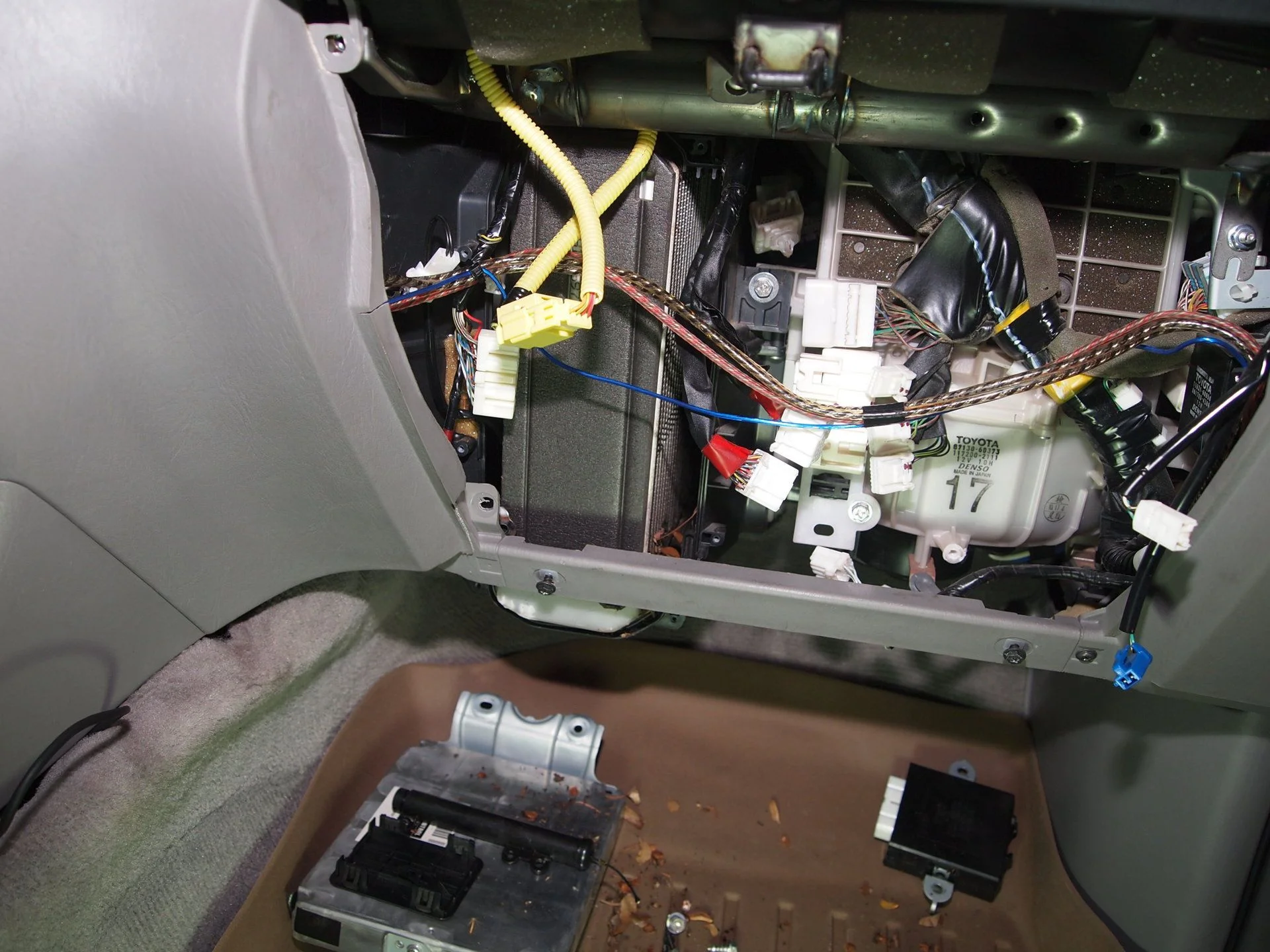

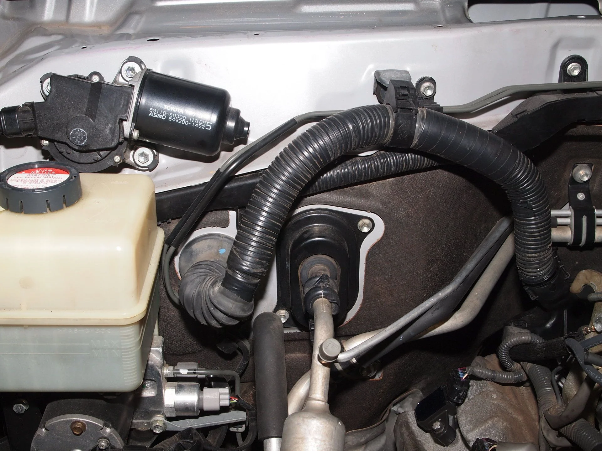

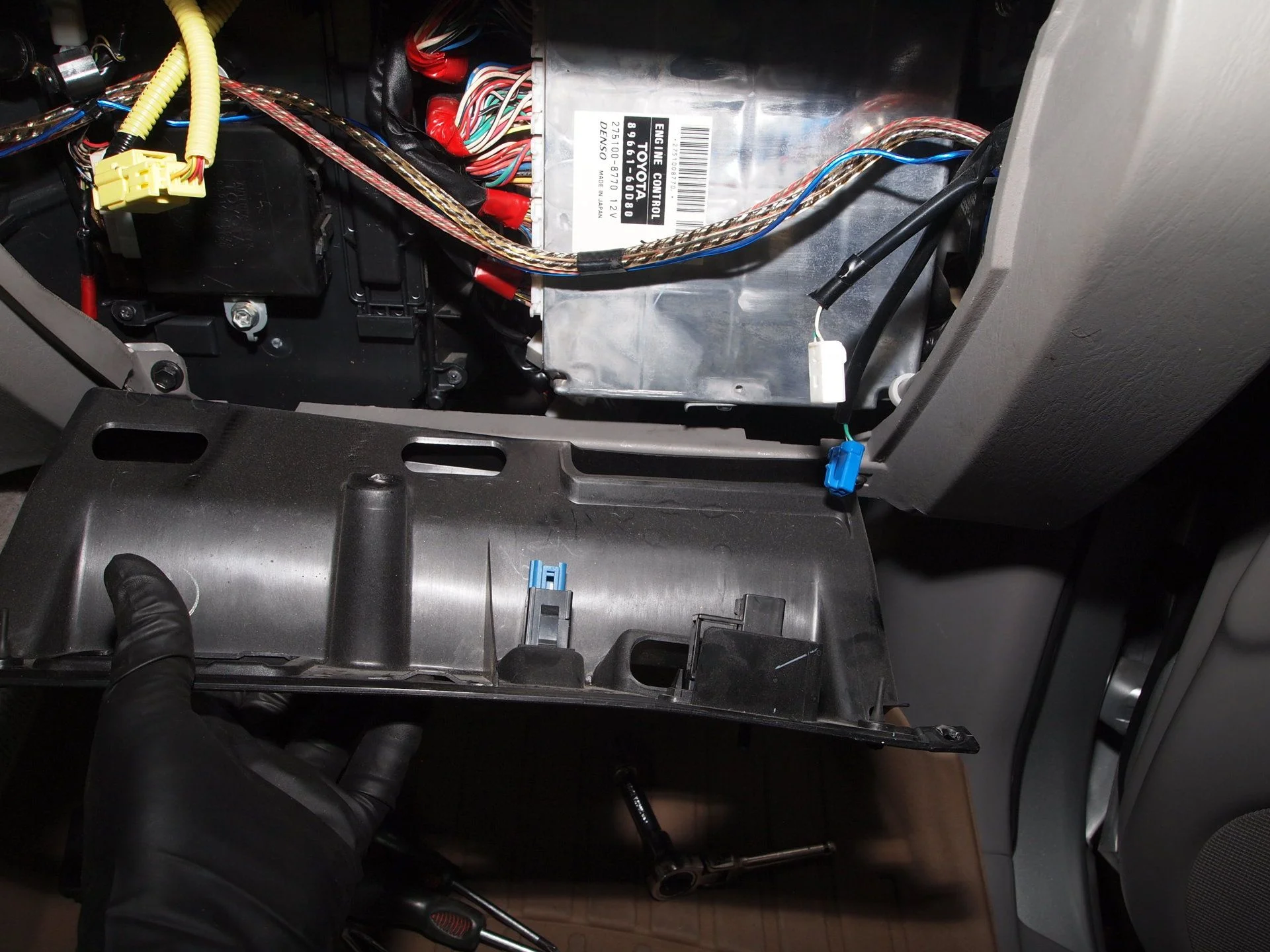

ECU wire harness pushed through into cabin, hook up to ECU and buttoned up.

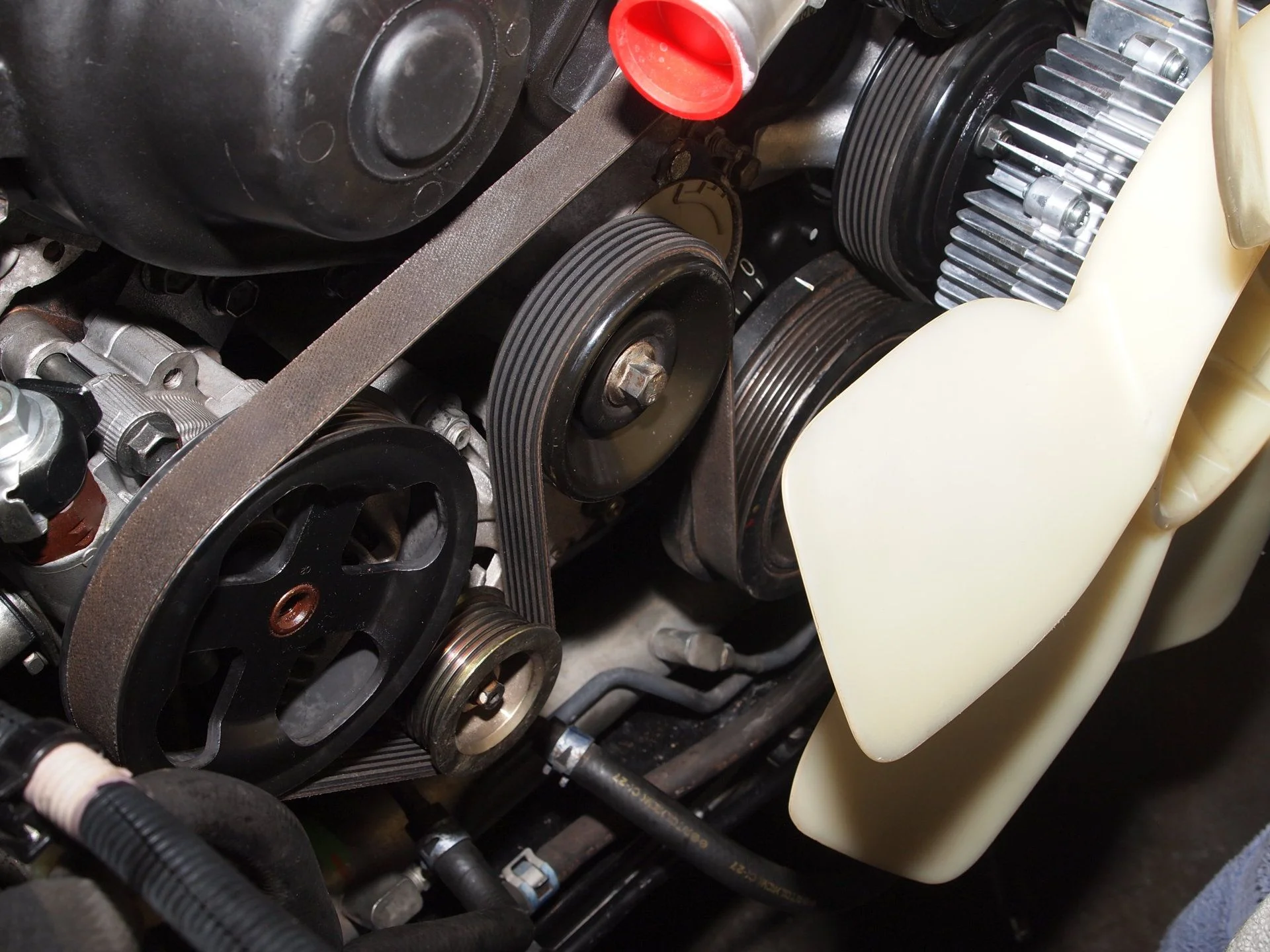

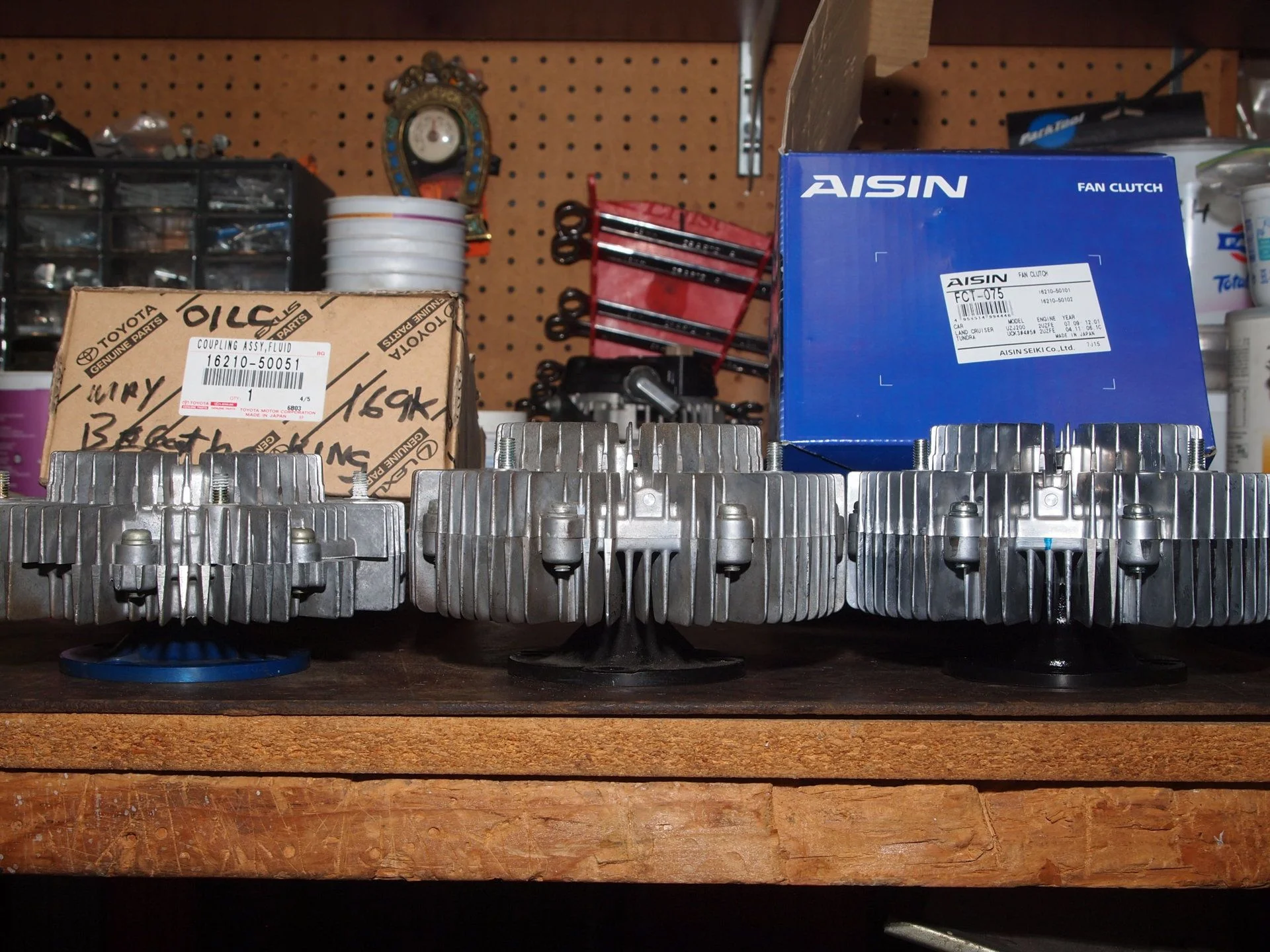

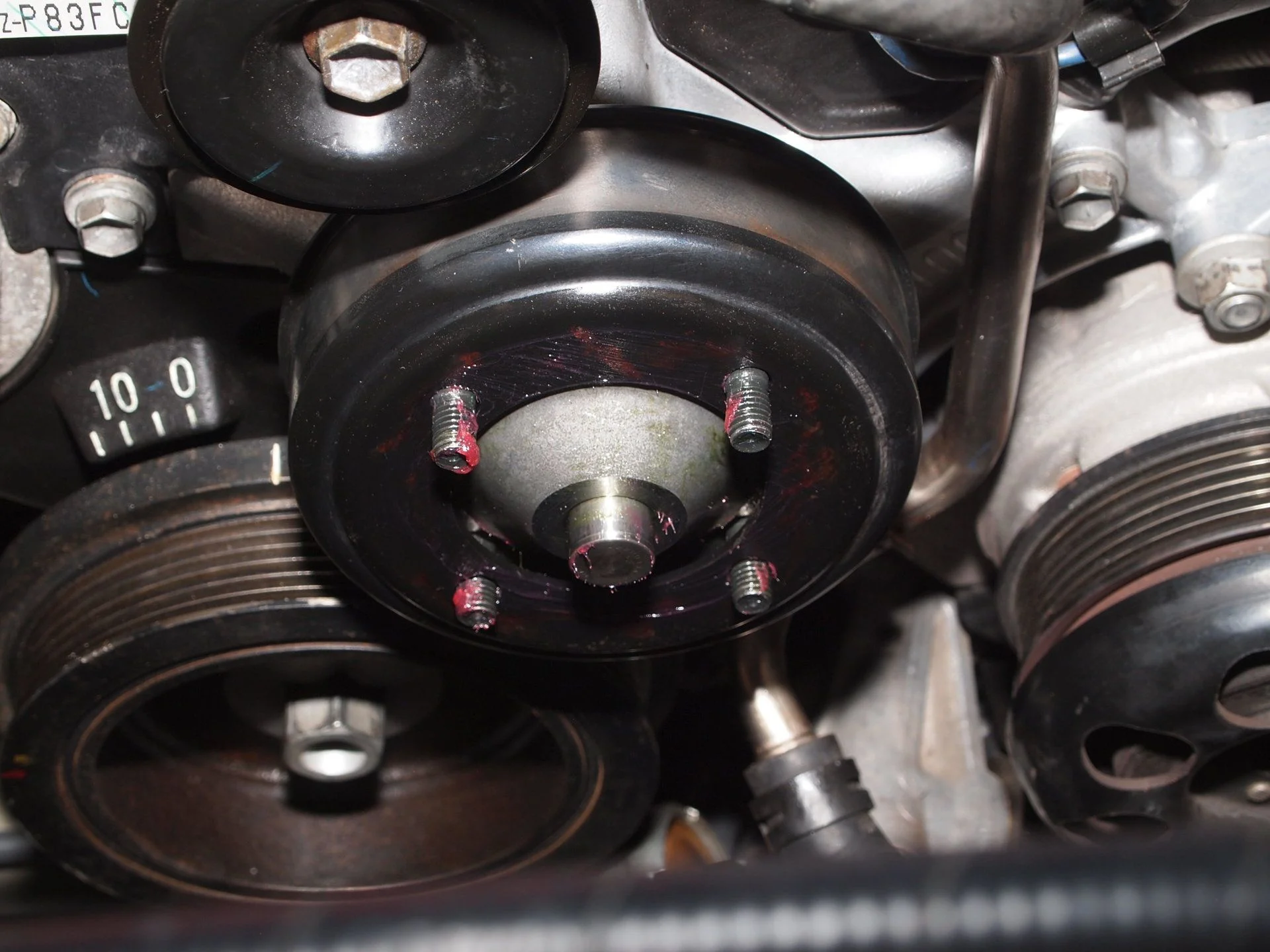

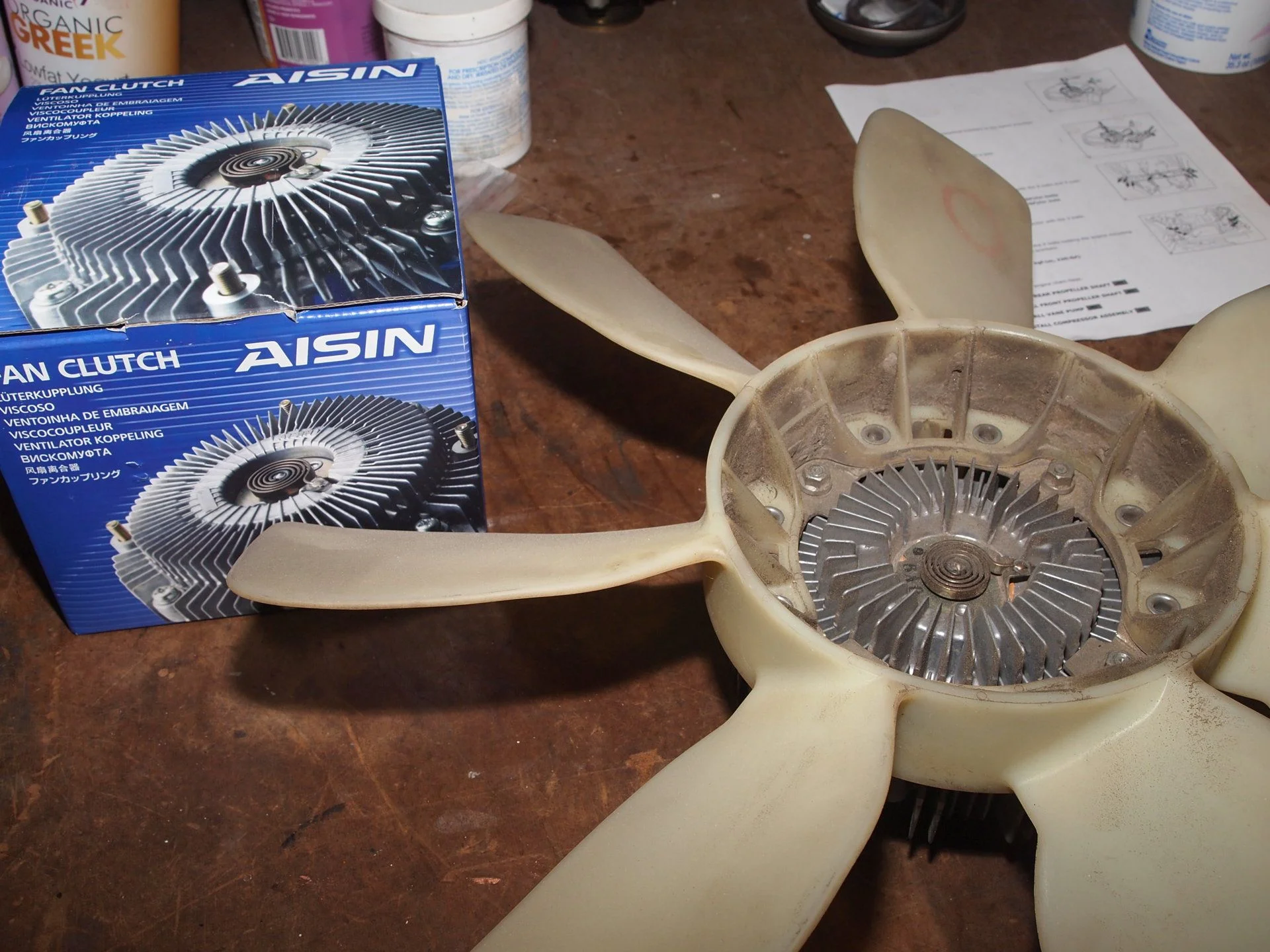

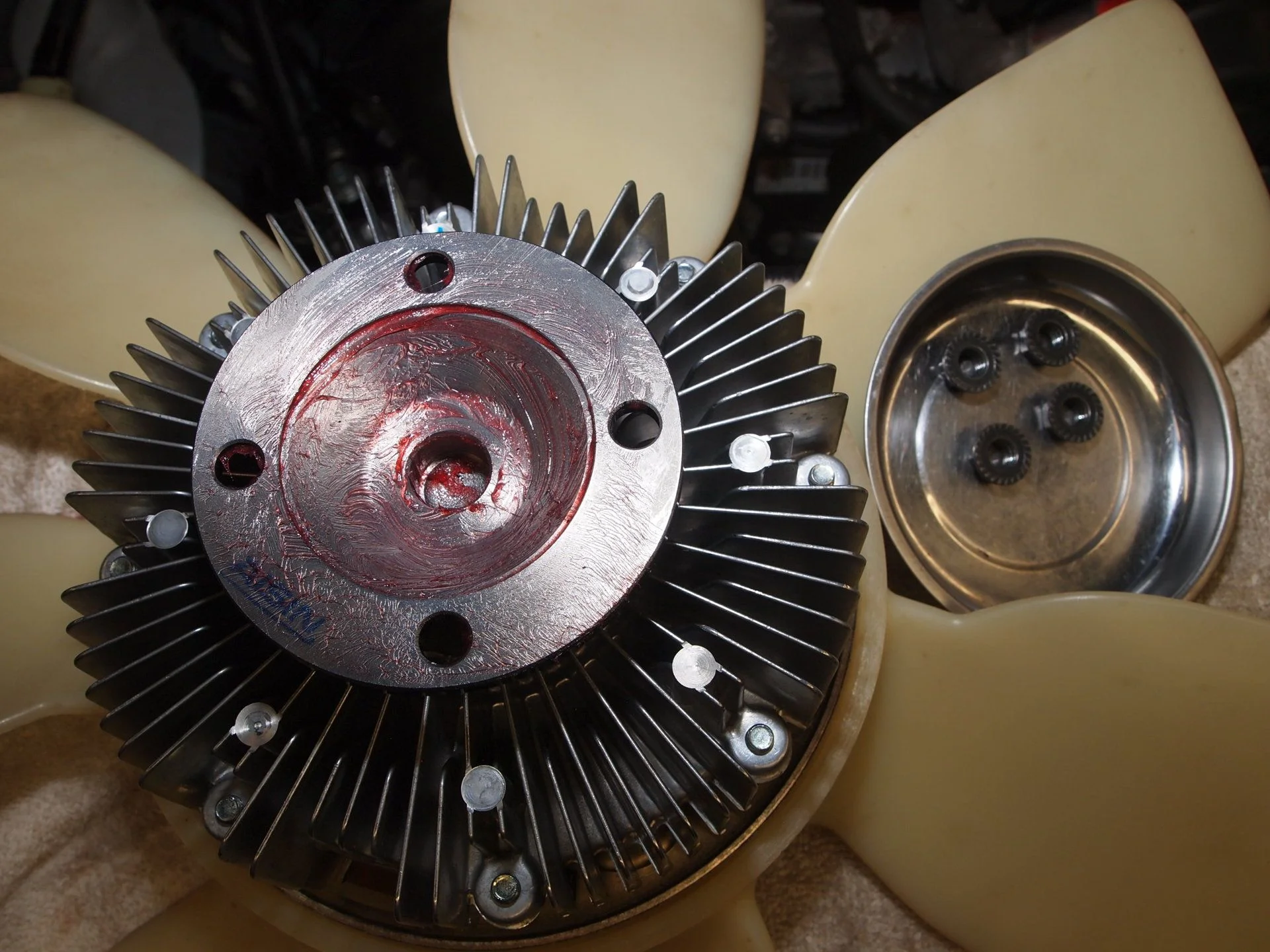

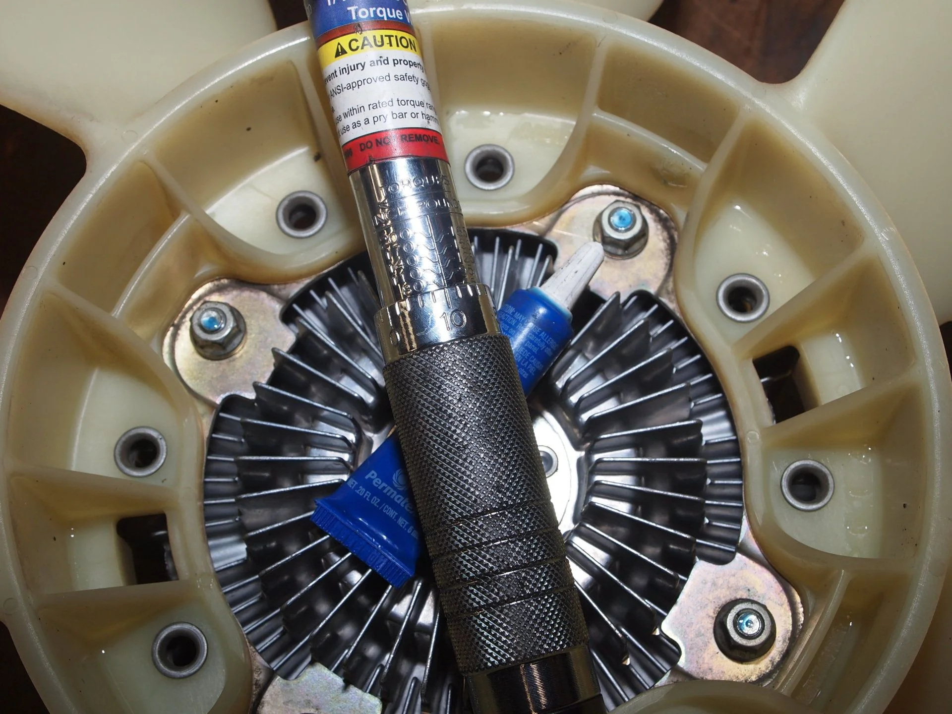

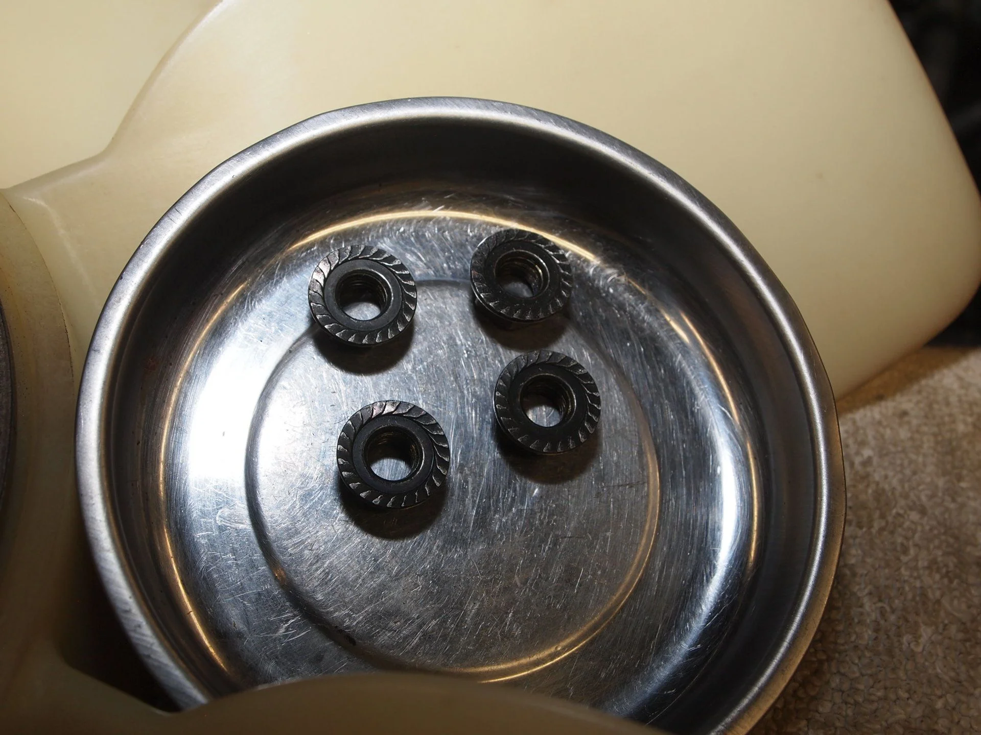

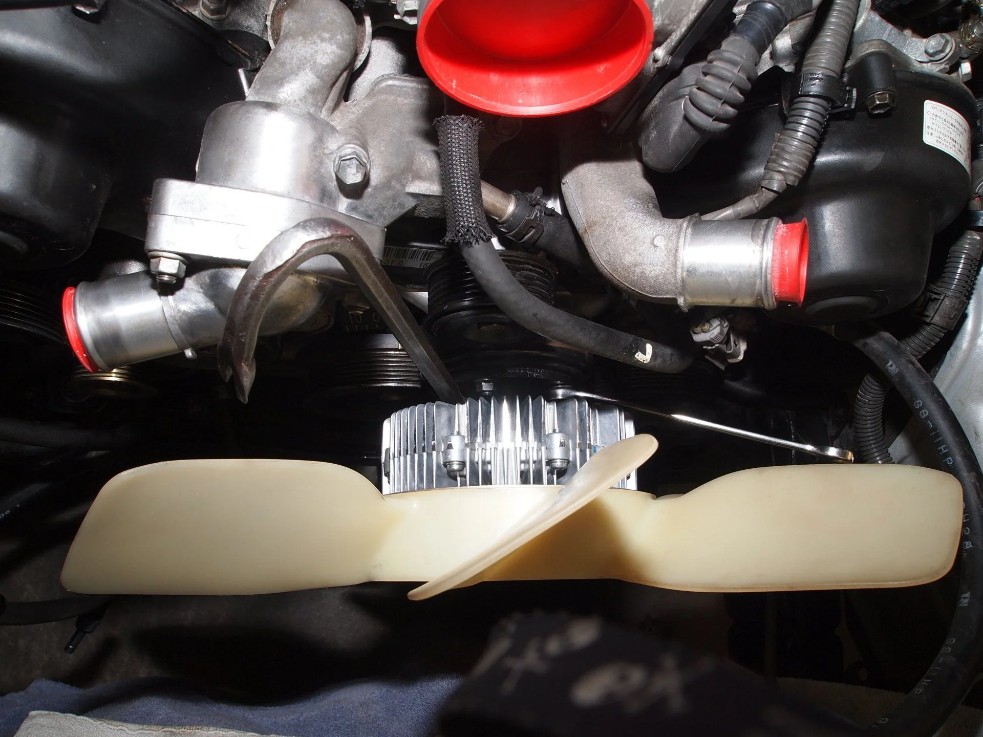

Fan & clutch assembly & install.
Interesting the 07 is thicker than the 01's fan clutch.
Replace with Aisin which is OEM.
torque 70IN-lbf (INCH)

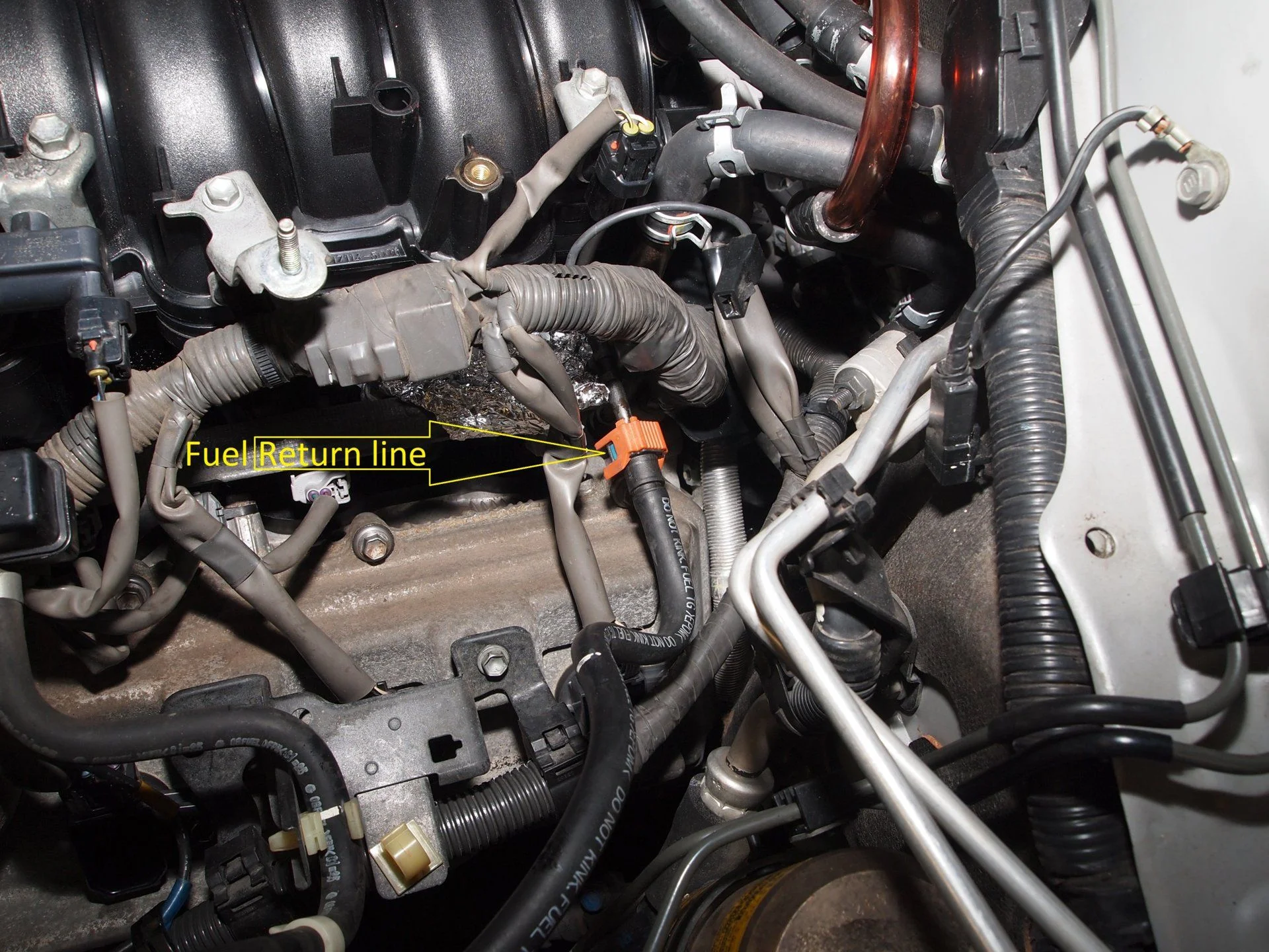

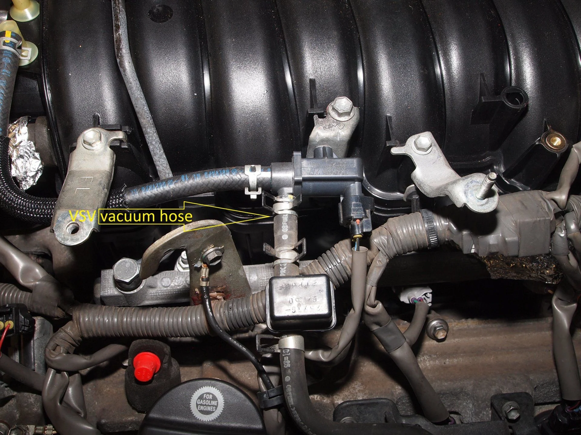

Fuel return line & VSV vacuum hose LH side connected.

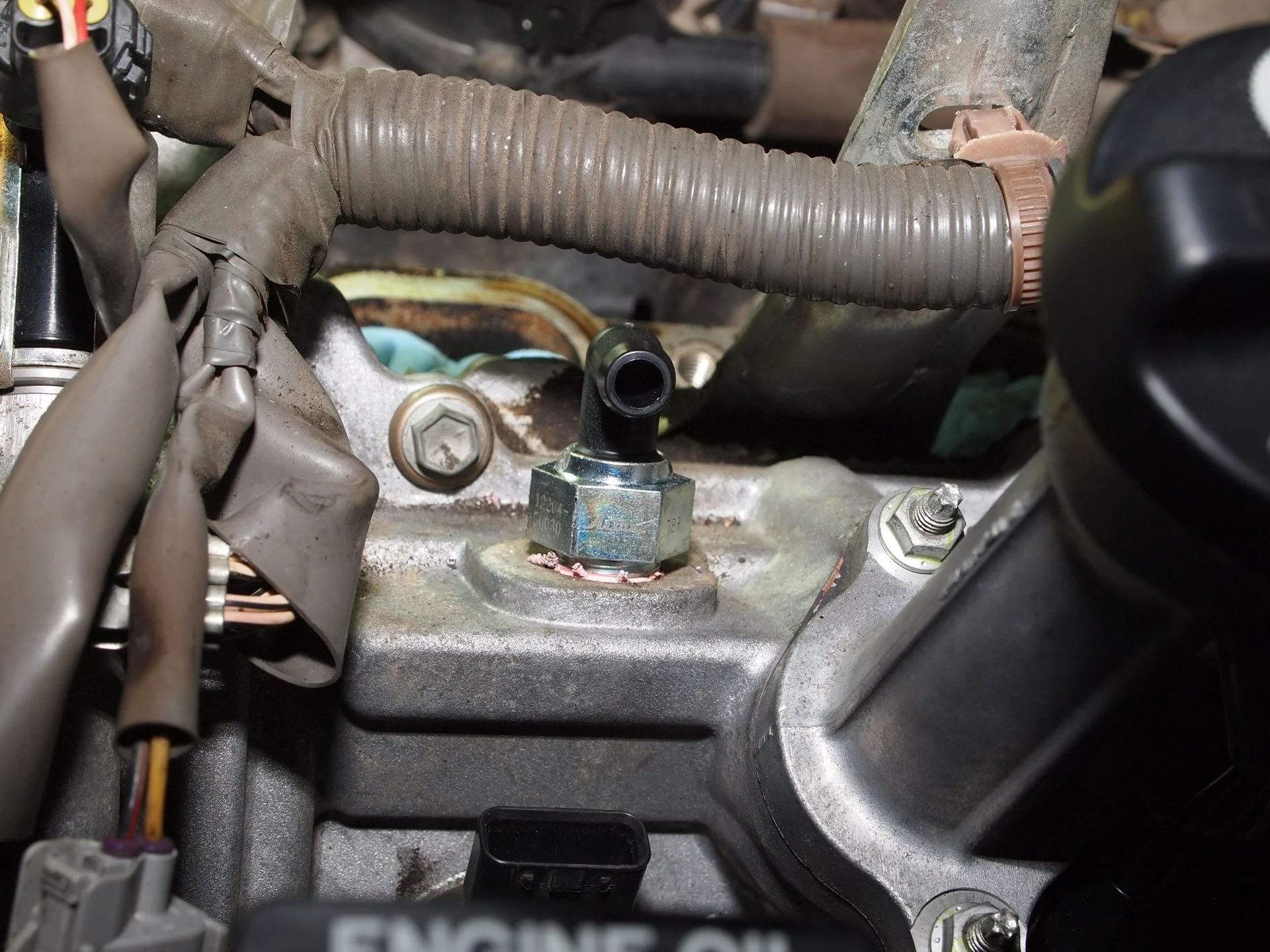

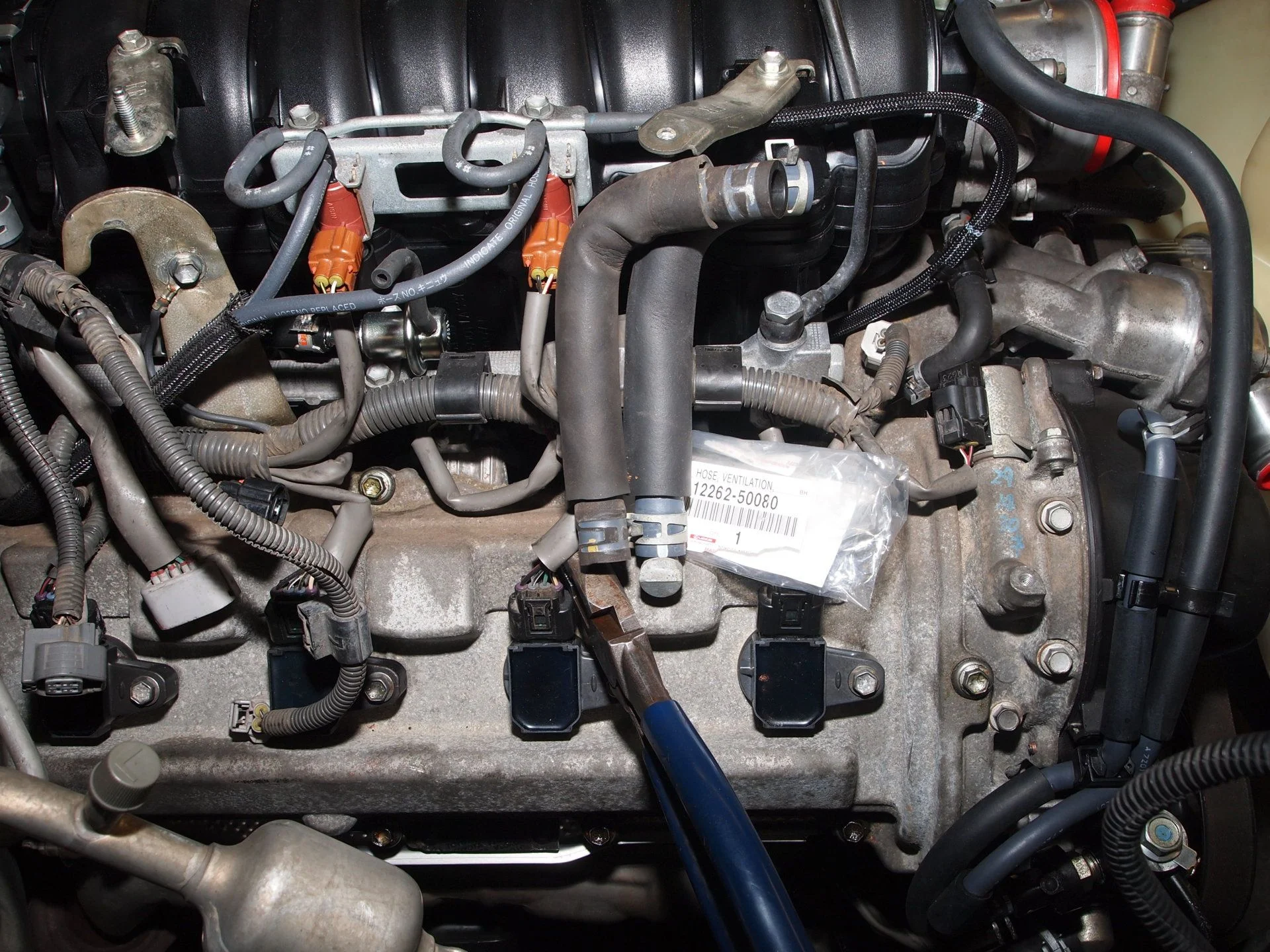

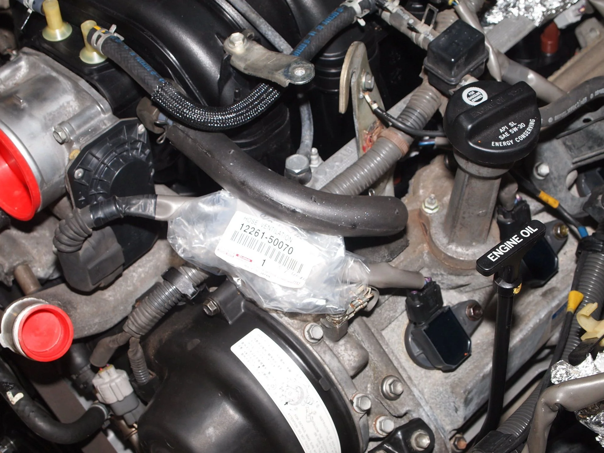

PCV valve & hoses.
After clean & inspecting PCV valve I installed it with thread sealer. (Stock photo)
I use old hose for indication of clap position. RH PCV Hose.
LH PCV hose.
(Old PCV stock photo) Once I see cracking at about 7 years, I replace.

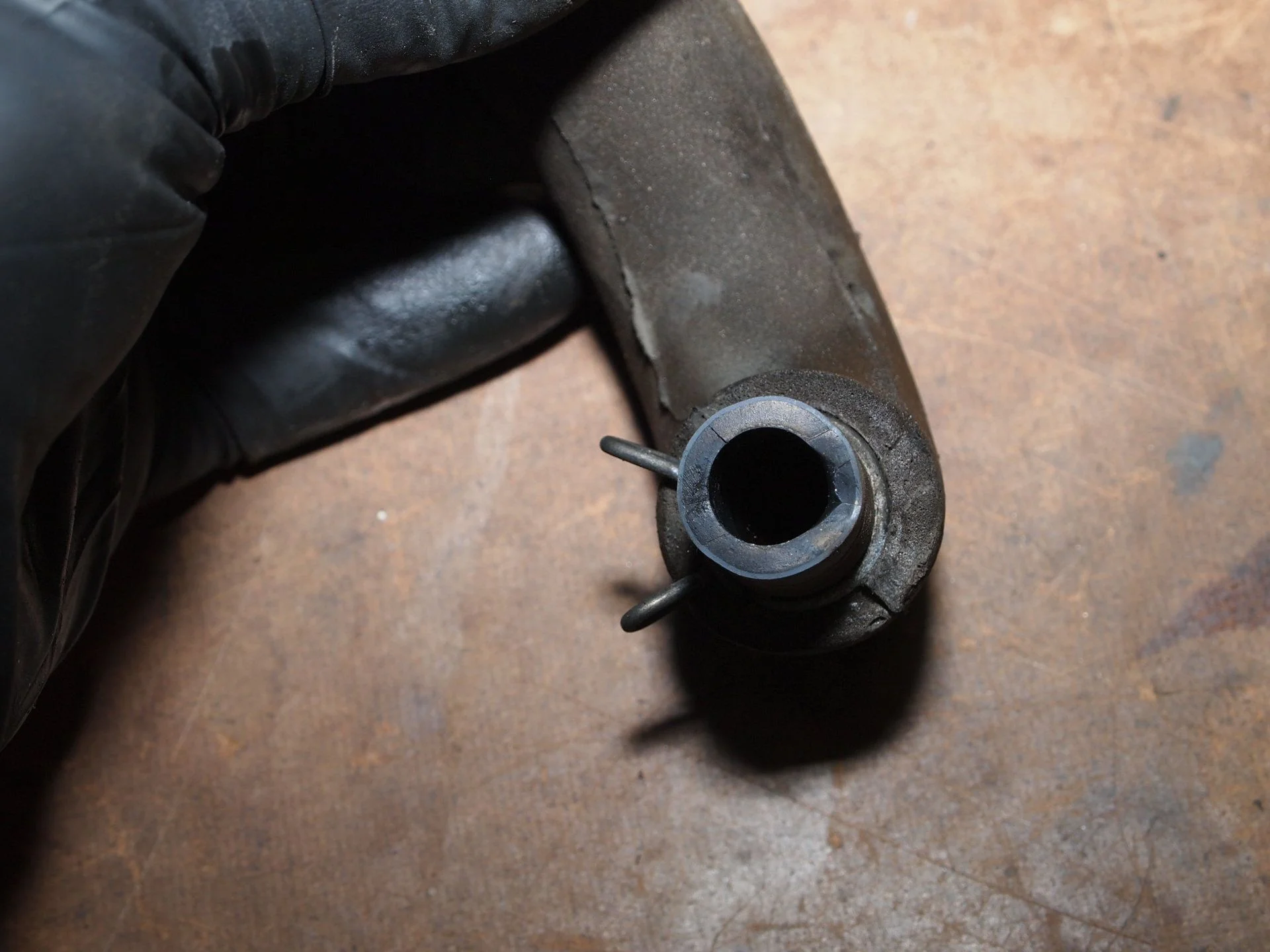

Heater Tees install, is a snap with right pliers (wish I had themo_O). But just follow the correct sequence of clamping and it's no problem. I use soapy water (Dawn Dish Soap is best), to lubricate hoses for install. Lubing helps reduce strain put on pipe during installation, make hoses just slip right on.
With new hose on engine, I can place clamps turned as I wish. With old hoses, I must put clamp in same position they have been sinces factory. Notice distance each hose is from end, to far in on lip of pipe and they may leak.
