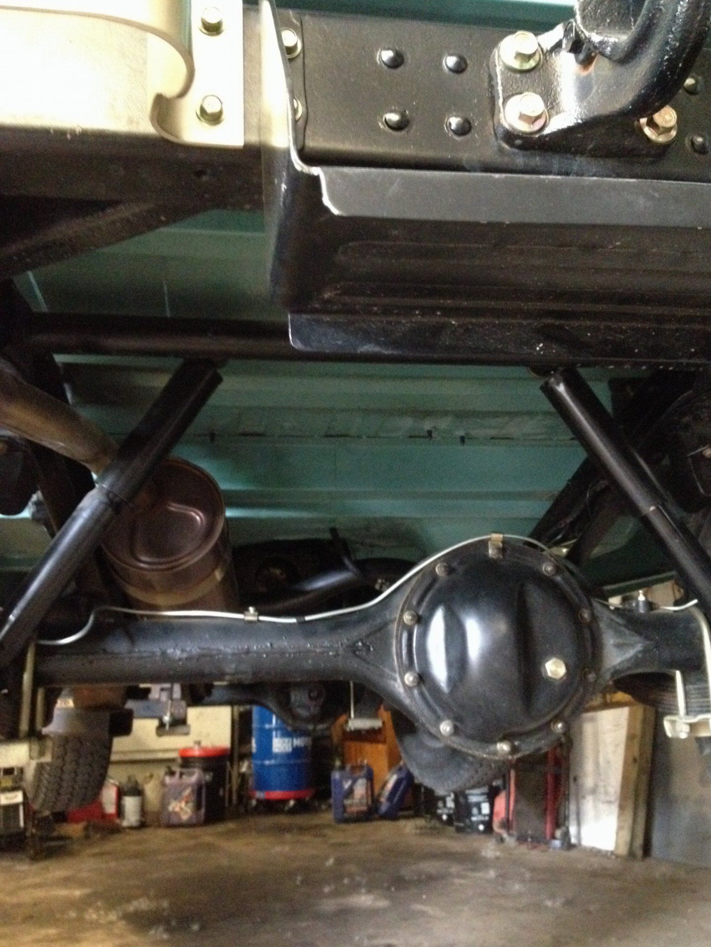

Will you be welding on them at all? Cause you just have grind galv. off anyway. Seam sealer for sure. Primer won't protect from rust. Even paint won't last long. Primer/ paint then spray on gravel gaurd inside and that will protect the paint. Do it when they are new, not after the paint is chipped and rusting. It works very well. Any hole you drill paint before inserting hardware. Be fanatical while assembling them. This is a road driven vehicle but you'd never know it. Rust never sleeps but g gaurd does work
