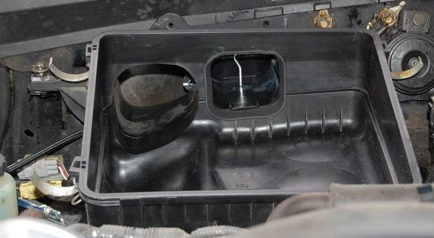

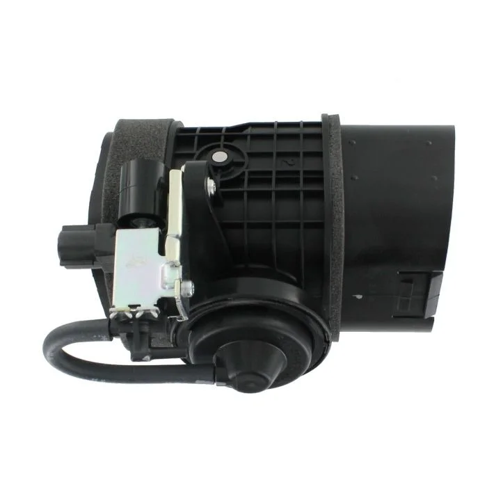

Snorkel restriction can be solved with a secondary intake flap. The one I use here would require a little work to make water tight enough for submersion, but great for everything else. VSV valve switches the vacuum diaphragm to close the flap.

Very interesting. Are you using these on URJ applications currently?

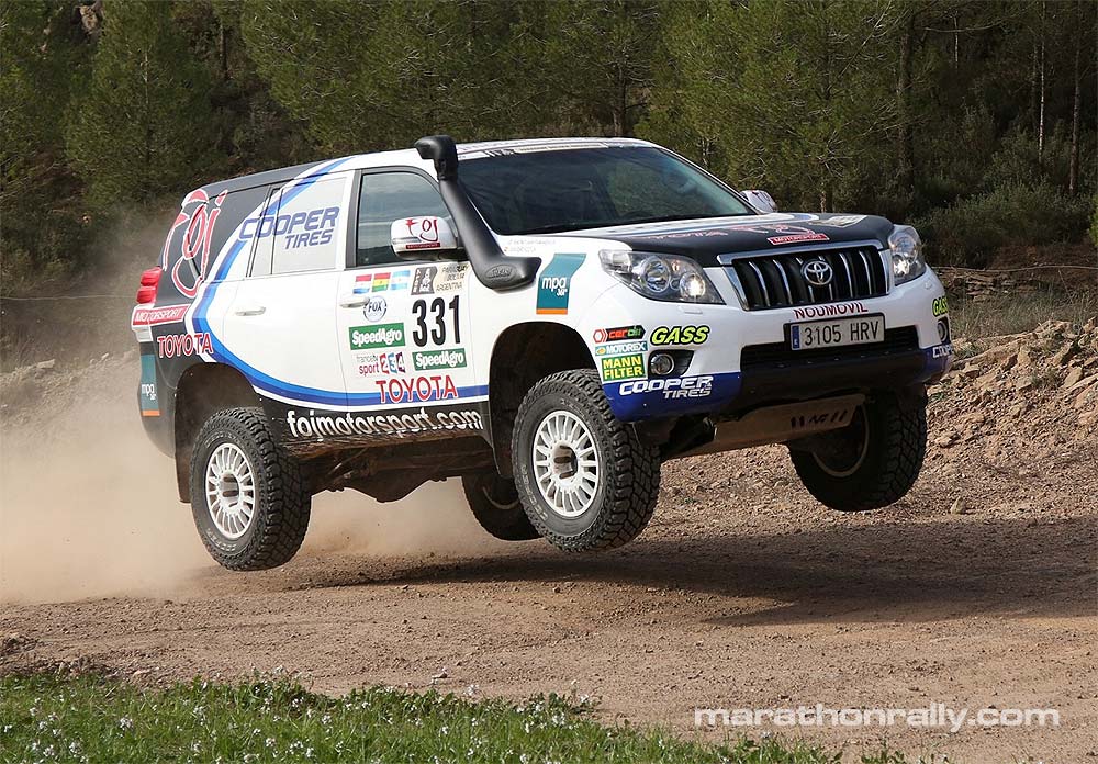

The Toyota team Darkar LC uses the same snorkel. Yes the engine is a biodiesel, but I would imagine that it's air intake requirements are equal to or above the 3UR V8.
I agree, a twin turbo no less. Despite lower RPM's and displacement, the volumetric efficiency is much, much higher and needs more air. That said the fuel injection and computer system of the 3URFE might have been the issue and concern? I can ask the gent from Toyota that worked on that build and spec'd the snorkel and suspension. Perhaps someone needs to order all the OE Toyota snorkel parts and test it for us. I have all the part numbers cued up and ready to order :D
I suppose we need to compare apples to apples as the OEM Toyota snorkel has a much larger cross section than the low-profile snorkel being discussed.

The one on my old 2008 5.7 Supercharged Tundra was utilized with an ARB 200 Series snorkel (not the newer Armax). It was very much required, anything more than half throttle would pin the Donaldson Filter Minder. The second flap eliminated the issue.
More info if you want.

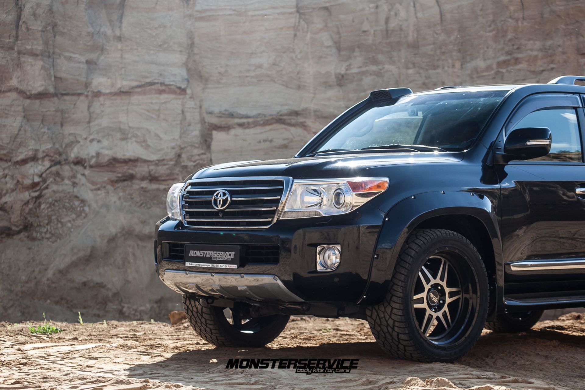

OK, when considering this snorkel:
What happens when one is driving in heavy snow? Since the entrance cannot be reversed, like the Safari snorkel and similar models
or have the inlet pointing permanently backwards
readBlob.do
what's to stop the inlet from becoming packed with snow and restrict all air flow?
Seems to me that having an inlet permanently mounted facing forward is not a good idea in snow country.
Thoughts?

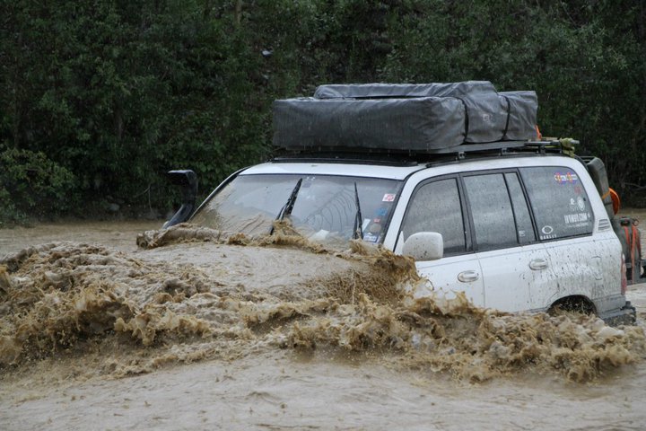

I think river crossings might be an issue as well. Though I don't foresee a 200 on 22s with street tires fording many rivers.

@gaijin, maybe they think the rammed air effect will offset the snow catchment. :rolleyes: I mean, Mr. T couldn't have possibly known what he was doing when he designed a snorkel that sucked the air from the rear of that ugly mushroom head thingy.
Snow ingestion can be a real issue, 07 - 10 Tundra had a TSB for it, they would implode the airbox lid as the filter became restricted with snow. It wouldn't be terribly difficult to give that snorkel a rear entry.
