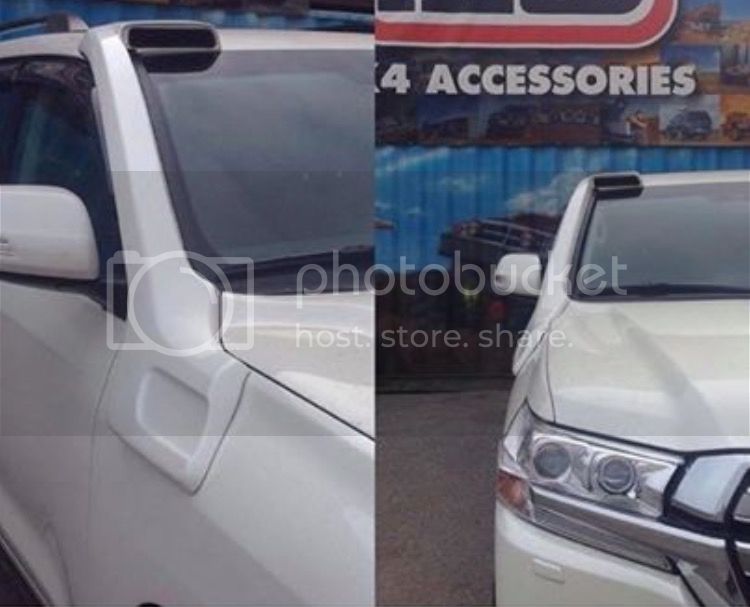

not sure what this one is but saw it on FB. the person said even though it appears to be parked in front of an arb sign it is not an arb product.

This is the above option, appears to be fiberglass, so will need some finishing work and painting. It does look good, I think someone here has it and said it may not flow enough air but I think that was for diesel.

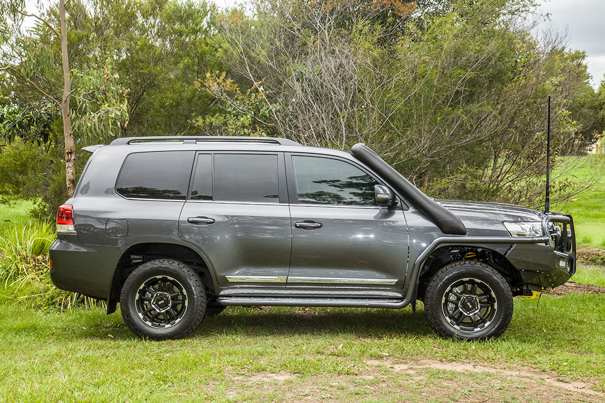

Snorkel for the Toyota Land Cruiser 200 car 2015-2017 years
TJM also makes one for 2015+ I had one on my 100 series and I loved it, will be getting another for my 200.
TJM Airtec Snorkel Suit Toyota Landcruiser 200 Series 2015+ | TJM Australia | 4x4 Accessories
Love the idea of this low profile snorkel, however the link is dead. Does anyone have an updated link to it?
Not sure which engine you have, but I can’t see that low profile model flowing anywhere near enough air for a 3UR V8.
Keep in mind that if it was designed for the twin turbo v8 diesel, that engine makes about 100hp less than a 3UR. And the fact that horsepower is a decent predictor of airflow needs.

Also tough to tell from the pictures (of the low profile options), but it doesn't look like there's a good seal from outside piece to the inside piece. Maybe have to silicone the two? Def looks good though.
