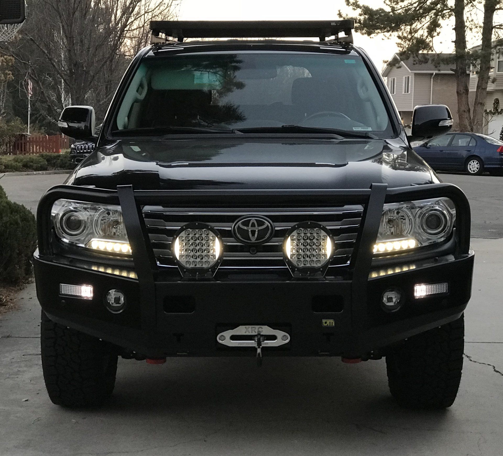

Below is my build so far.
Tough Dog Lift
Front 41mm coilovers heavy springs
Rear 41mm rear shocks light springs
SPC Upper Control Arms
OEM Front 1" Spacers
Spidertrax 1.25" wheel spacers
Falken Wildpeak A/T3W 275/70/18 set of 5
TJM T13 Front Bumper
Trail Tailor Front tow mounts
Smittybilt 9.5K XRC Gen II with synthetic rope
Smittybilt aluminum winch shackle
Aurora 7" round LED lights w/ harness
Rhino Rack Pioneer Platform with Backbone mount
Husky Weatherbeater floor mats

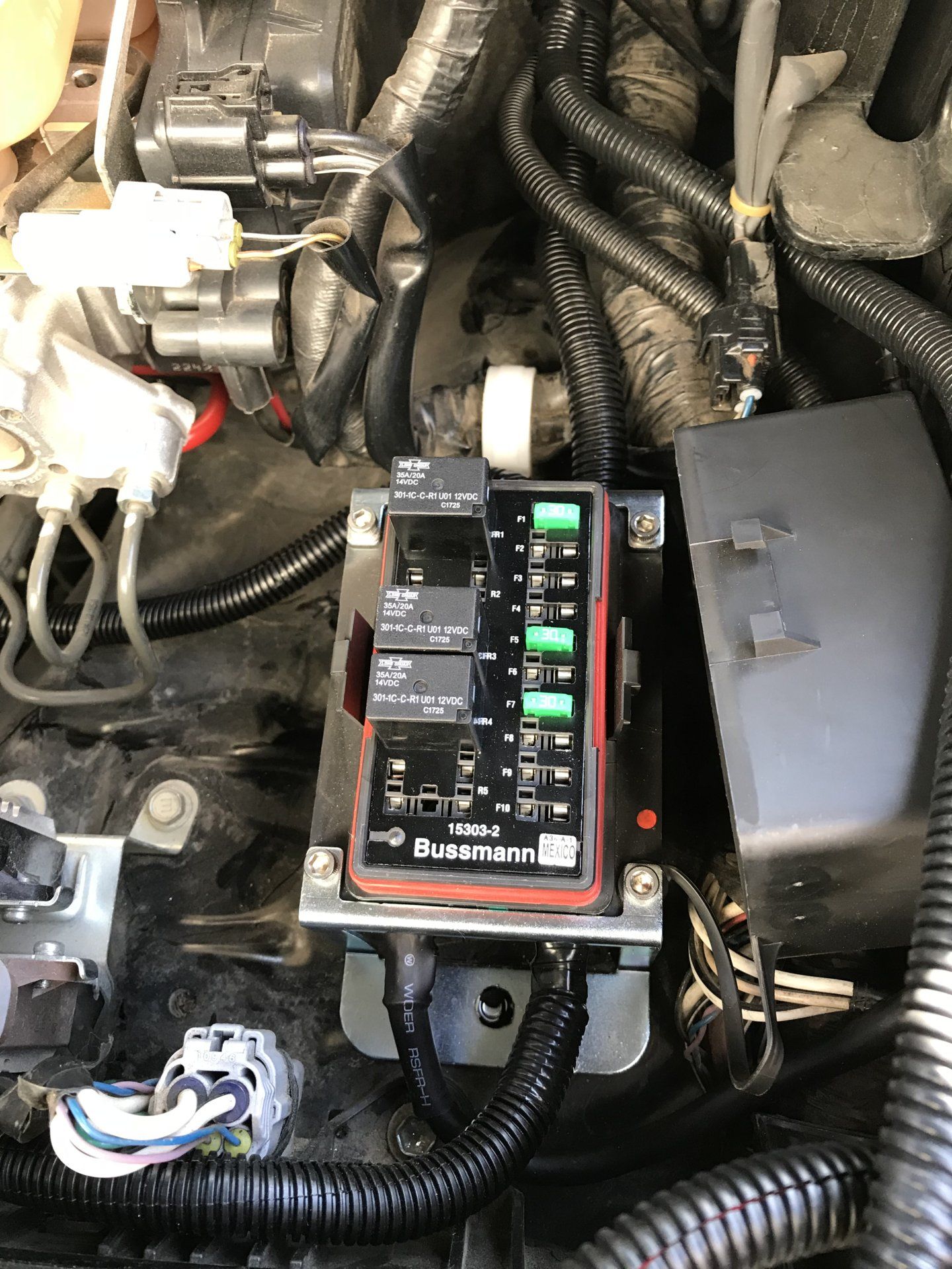

Waterproof fuse / relay panel from eBay
Philips xtreme ultinon HID bulbs
Toyota OEM look fog light switches
TMax dual battery kit
JEGS universal battery tray
Duralast industrial Marie battery

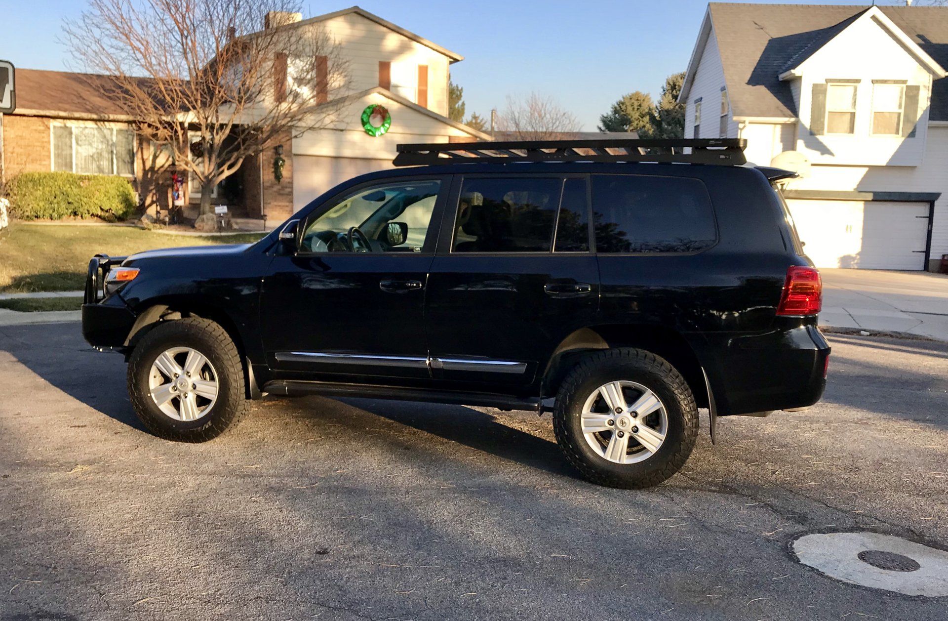

Ditched the Frontrunner rack, the damn thing wouldn’t sit flat on my roof. Frontrunner sent me new rails and it was still wonky, they have some sort of QC issue over there or maybe it the multi piece design they use to make shipping easier. Replaced it with a Rhino Rack and it sits perfectly flat. I also like the looks better and the fact it doesn’t sit so high off the roof.

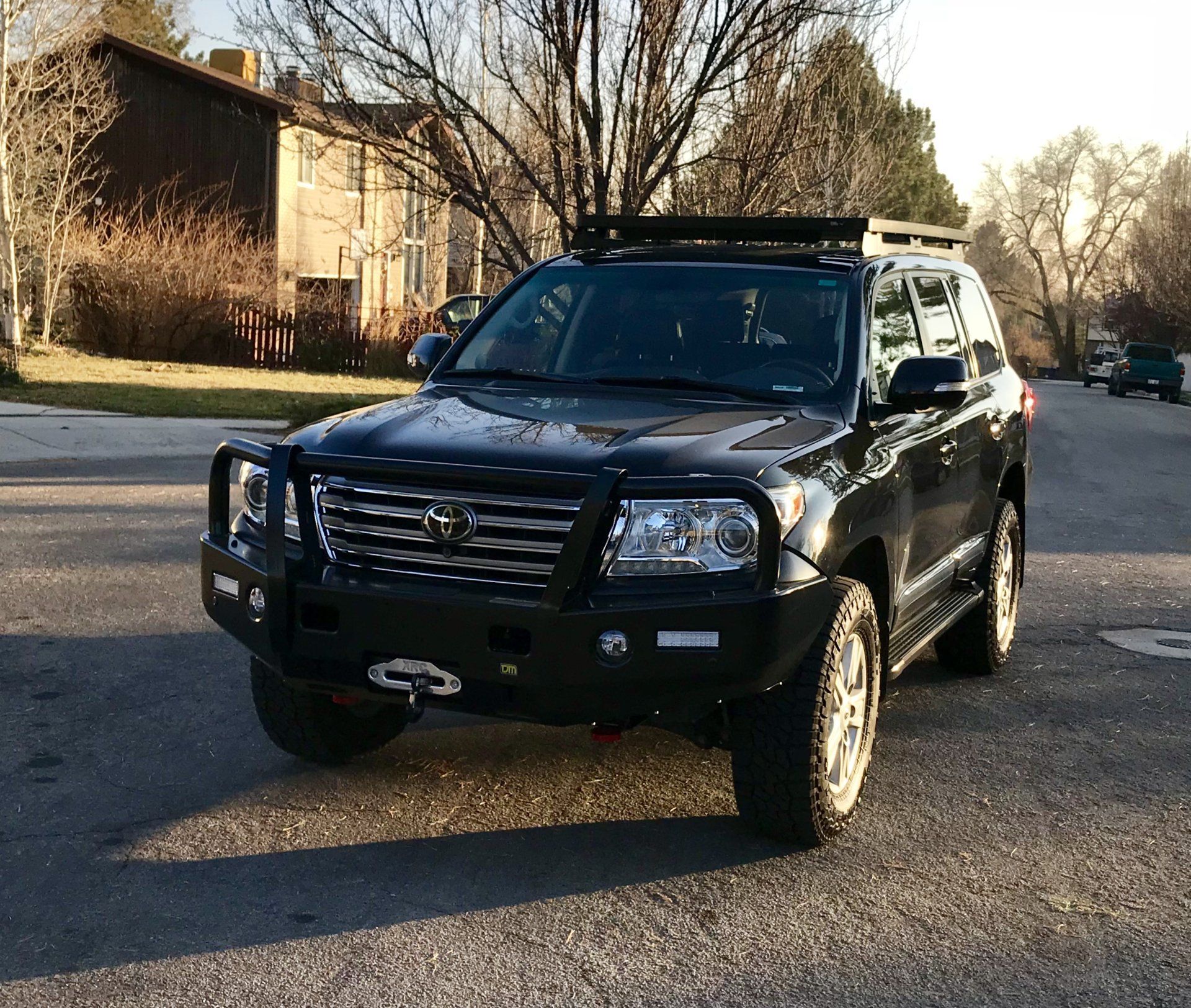

Also some more recent pics of my 200:

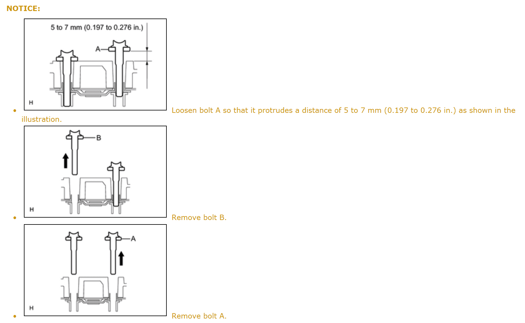

Best pointer I can give is to pick up a set of allen wrenches that have a ball end, you will have a hell of a time getting the bolts tight otherwise. I bought this kit from HF:
9 Pc Metric Hex Key System
Also when removing the factory rack follow this guide for bot removal:
capture-png.1576569
Thanks Chris! I'll make sure to follow that. I recall some threads about losing the backing plate by removing the first one all the way and then trying to do the second. Great reminder! Does the FSM give torque specs too?
What size pioneer platform did you go with?
84”x49” part number JA8647. I got it from autoanything.com for $950 shipped (they usually run a 20% off sale every few months). I can’t say enough positive things about it, it’s a great rack.

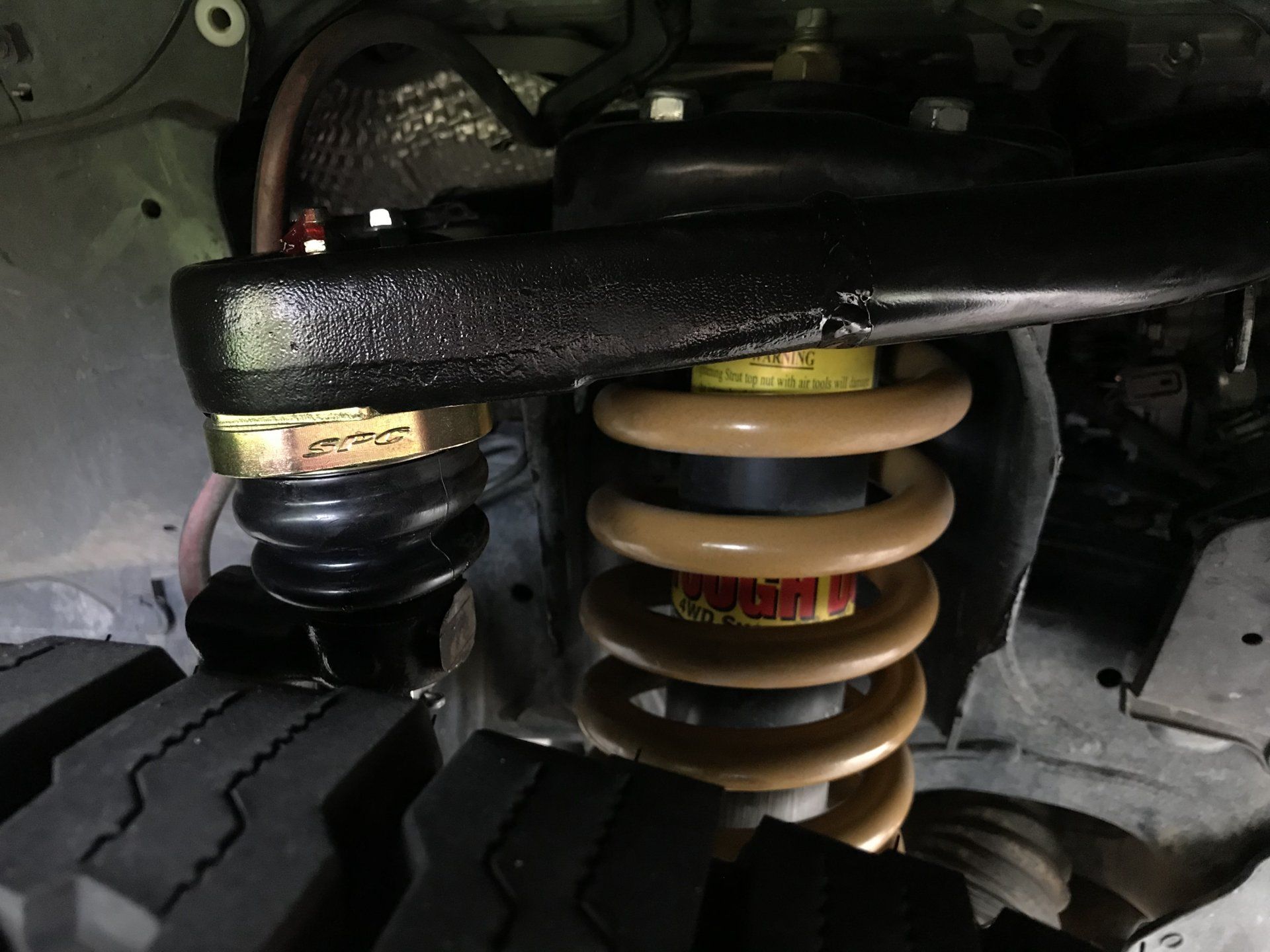

I wanted to add the front spacers to level out the lift, the caster was already off from the lift so I thought it would be off even more with the spacers so I decided to install the upper arms. Lift before the spacer was ~2" front and ~3" rear, so its pretty much at ~3" front and rear now. I installed the upper arms preset to +2° caster and after alignment it came in at +3.5°.
Nothing that exciting but finally installed my SPC upper control arms and OEM spacers.
The front raised up from 29.75” to 31” measured from bottom of rim to top of wheel well.
Can we see how it is sitting now?
