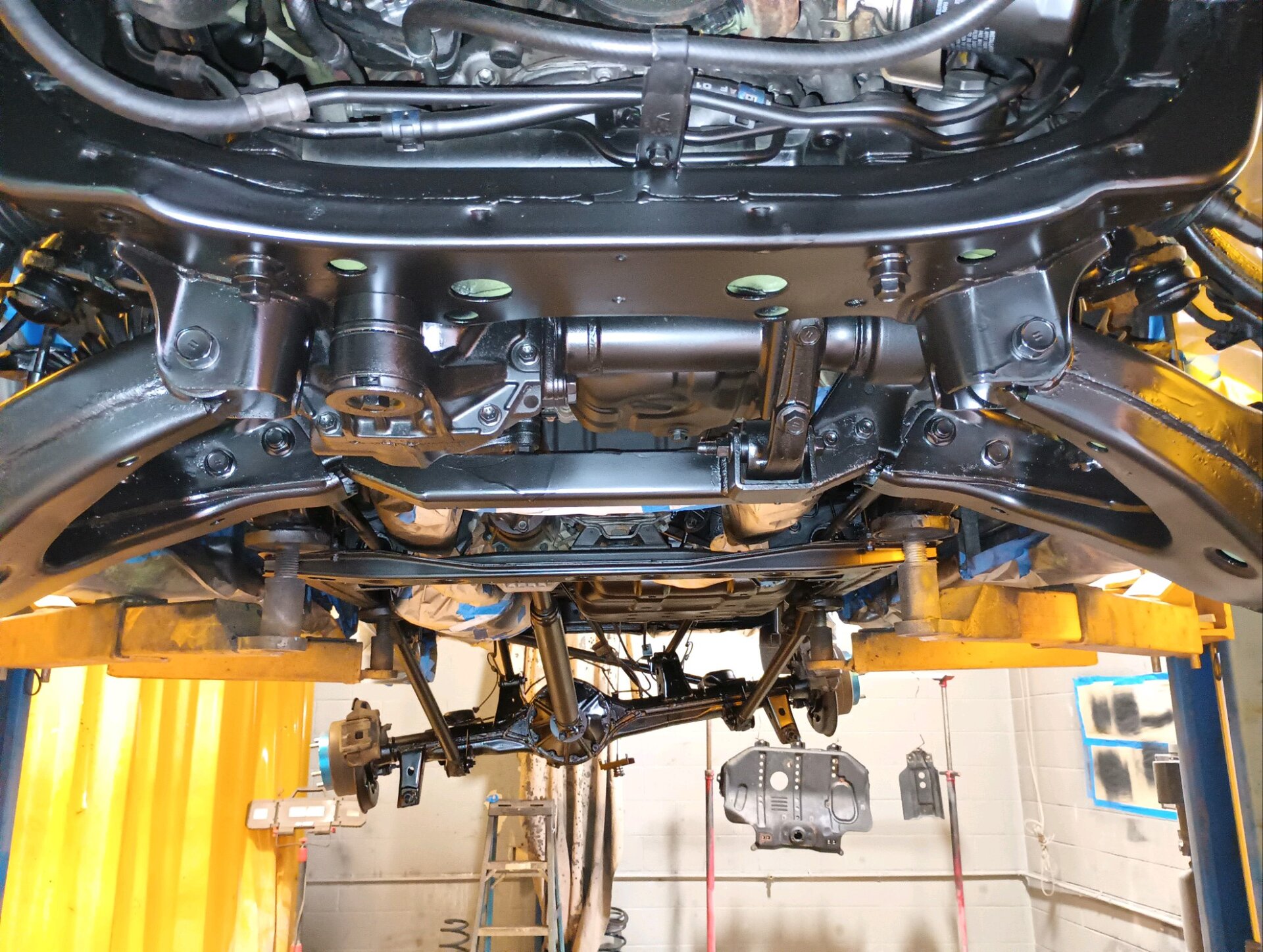

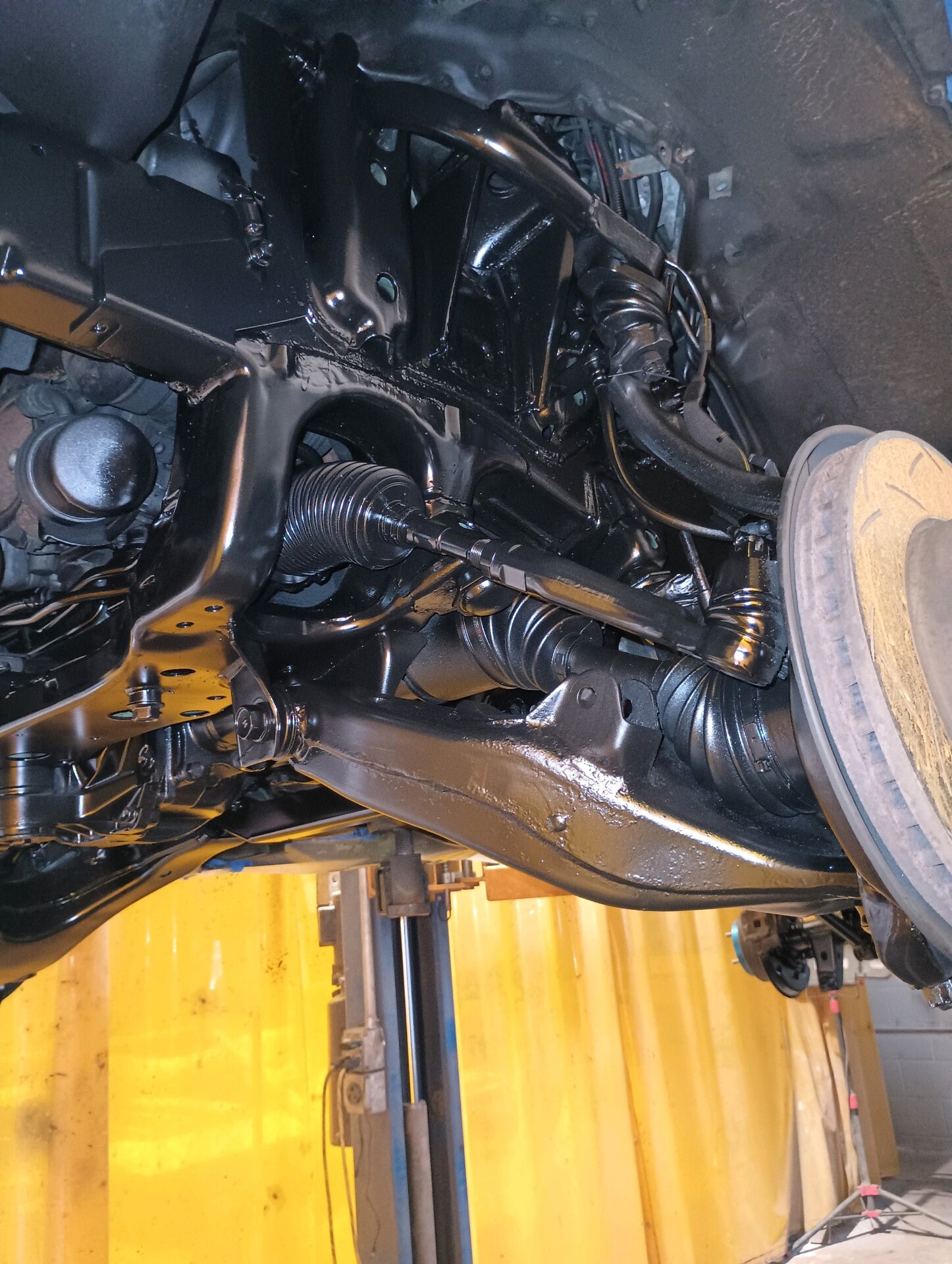

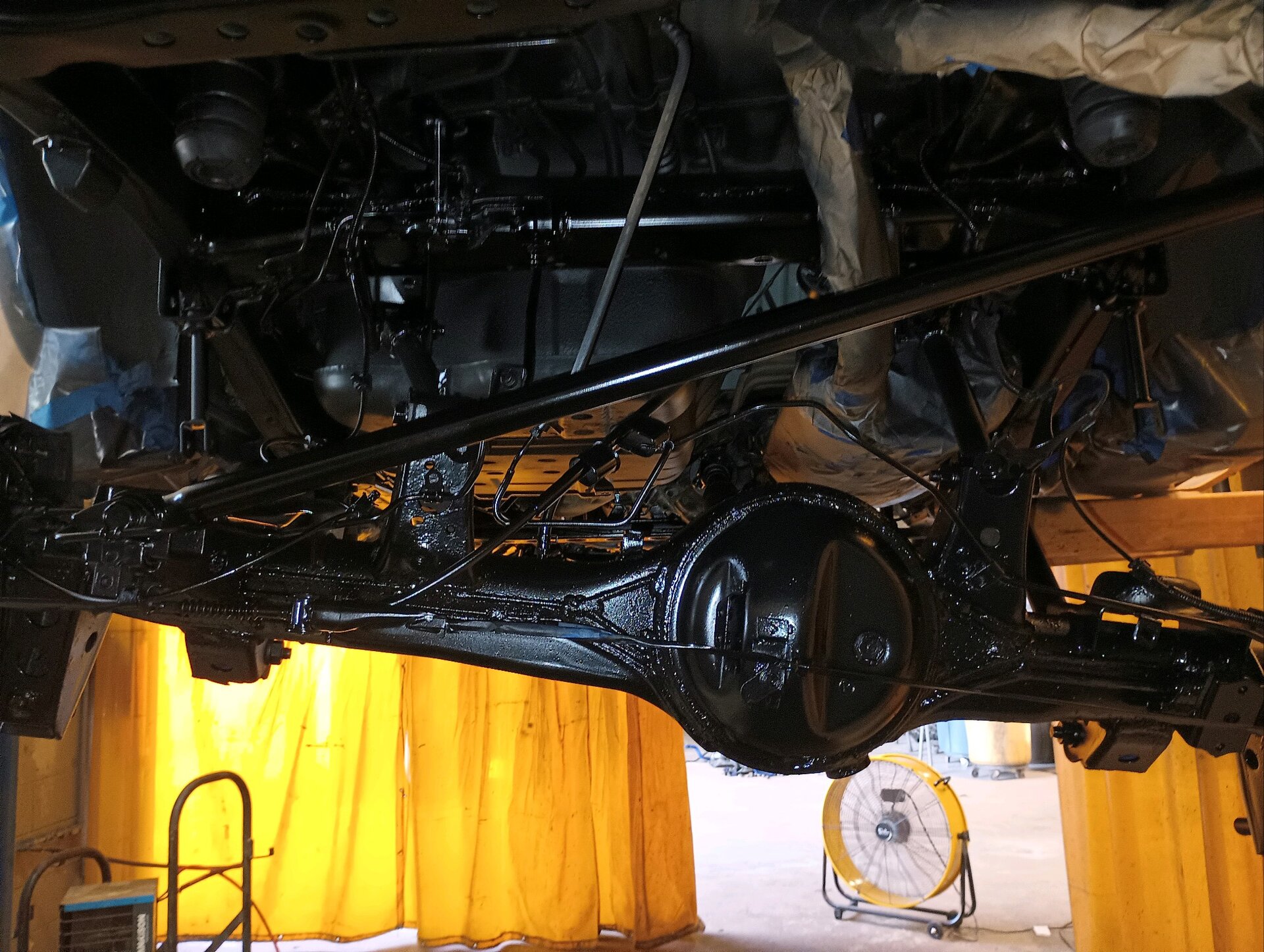

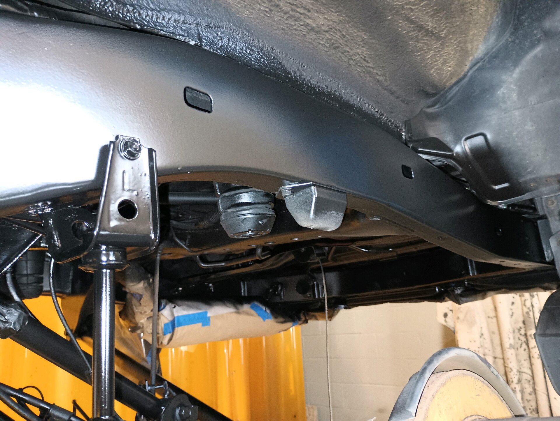

It's worth the effort, the end result pays off. This is my originally CA LC100, now a winter vehicle in IL. Pictures are of the clear cosmoline product, so nothing is hidden.

I'm not a fan of Cosmoline and the other wax-based undercoatings. They're not as forgiving, and could easily leave a gap in protection if you don't know what you're doing.
Yup exactly. You can heat it all you want but the bottom line is it cures dry within a 10hr period and stops creeping once it’s dry. Fluid film and similar wet products keep creeping for months/years.
I have two cars I fluid filmed and together theyve seen close to ten winters, never undercarriage washed and never garaged. Over 100k miles of driving in the nastiest chicago weather. Stuff work is the bottom line. You only touchup only around the high splash areas aka around the wheel wells every fall if you’re only using fluid film. There’s zero need to re-coat the entire undercarriage. It takes me less than half hour to touch up those spots and it’s easy since I remove the wheels anyways to swap for winter tire setup.
