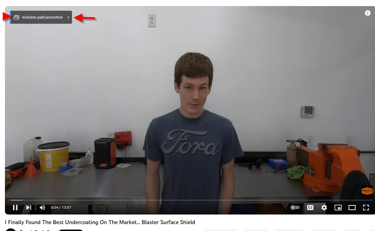

I would just like to point out that the product a couple posts up represented as a "test" is not unbiased. That is the only one of our competitors that uses paid influencers to hype their product. The video comes across as some guy reviewing all the products. That person is actually a full time employee of Blaster. I guess I could also be considered a "paid influencer" as I am certainly biased towards Woolwax™. But everyone knows who I work for, and I don't disguise it as an unbiased reviewer looking for the "best" product. Maybe I should not say anything, but it is a pet peeve of mine. The poster above believes that he was watching a "real review" as he said "This guy ultimately recommends PB Blaster Surface Shield". What else would he recommend? He gets paid to "recommend" that one. I have to say that we have many competitors (Fluid Film, NHOIl, Krown, PFC, Rusfree, and more) . And without exception they are all ethical and honorable in their advertising and all their products perform well.
The company above with the paid hypester is the exception. You will notice at the very beginning of the video they post in the upper left hand corner a very discreet disclaimer that this is a paid promotion and paid hype.. They only leave it there for a few seconds.
