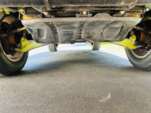

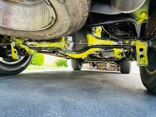

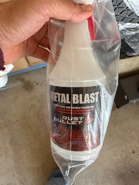

Just finished rust cleanup on the LX. I used a chemical rust remover, which works well if mostly surface rust. It especially worked well on the accumulator valve units (fins, fasteners). Next, I applied a primer for steel boats and zinc chromate on the cleaned fasteners, then John Deere Blitz Black tractor paint over everything. It’s a close match to the black on the chassis of my 23 GX.

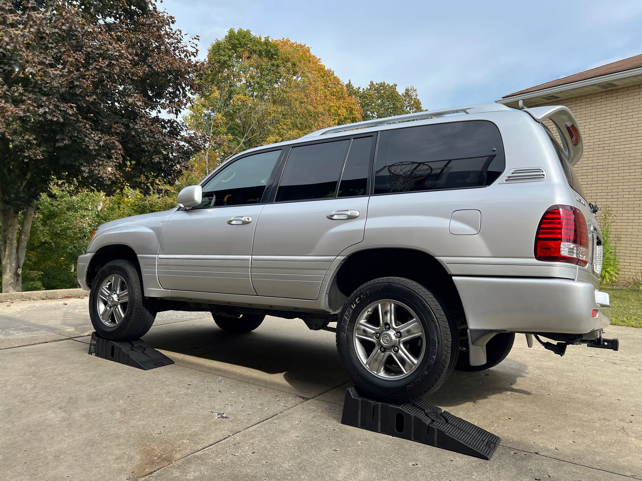

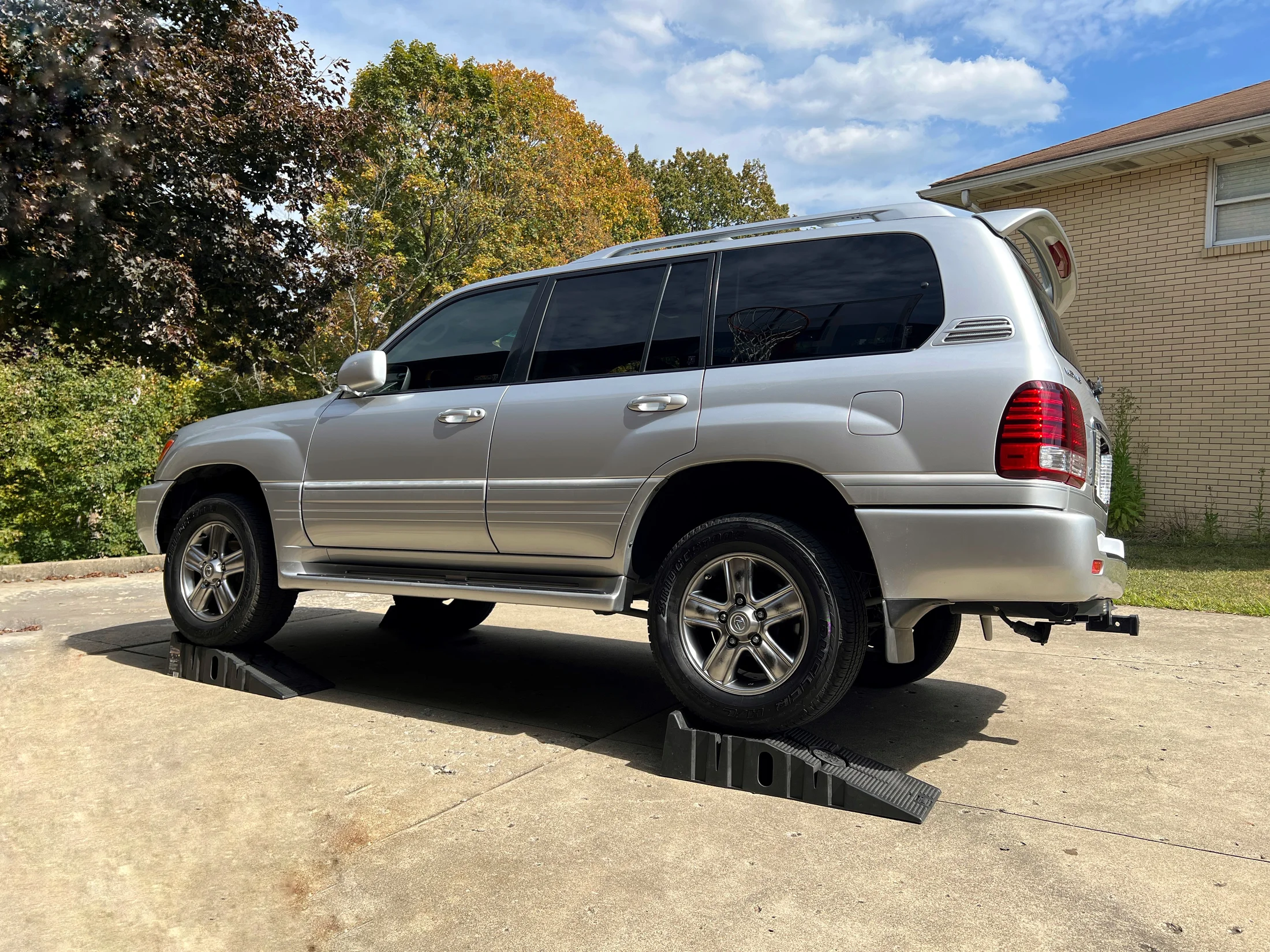

Pulled the boards, spare, and did some cleaning underneath (though it was hardly dirty) in preparation for undercoating next week
Amazing how nice it is to work on a car that isn’t rusty.. not used to that at all

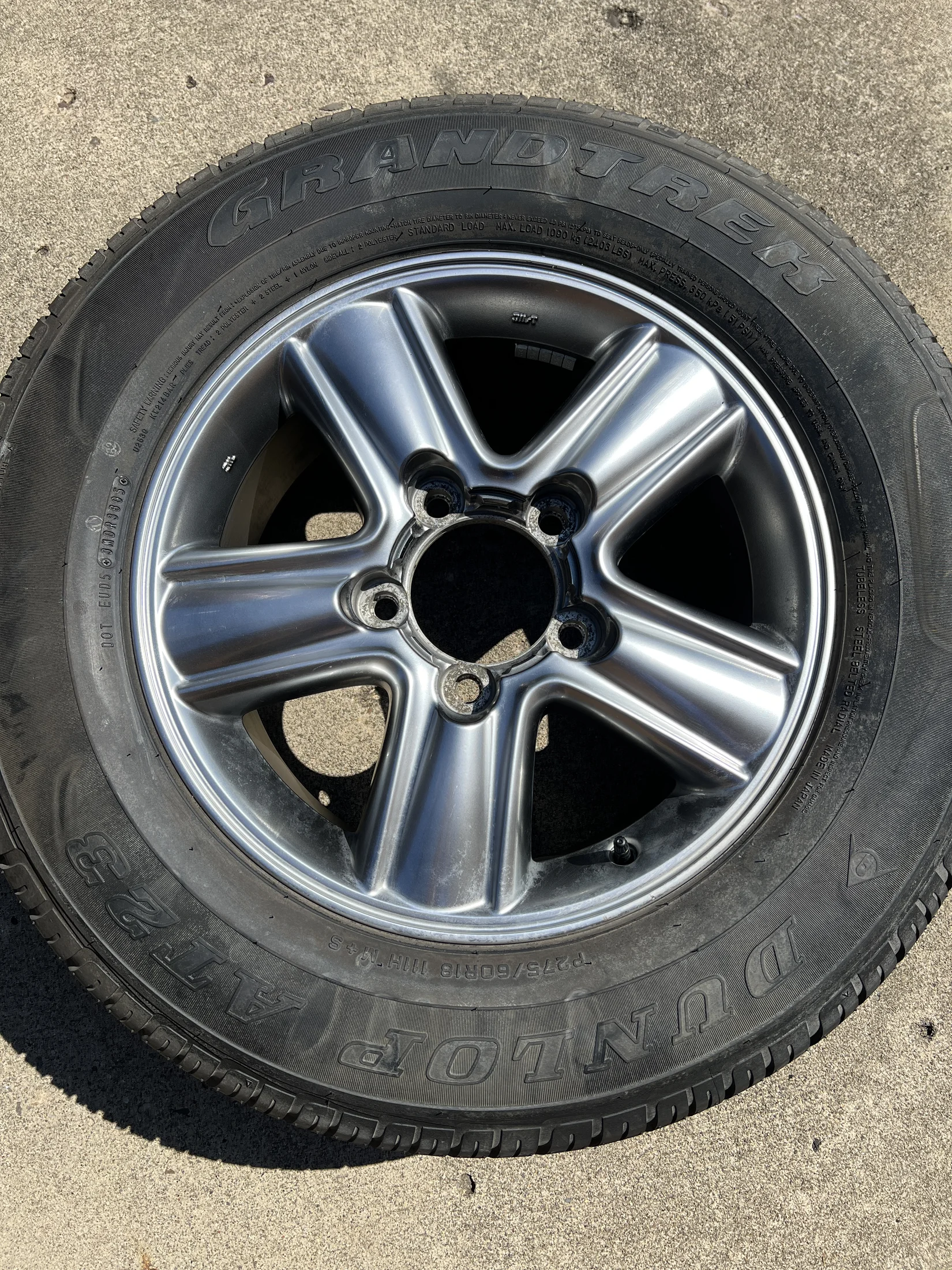

And the obligatory like new spare with a 2005 date code. Hoping I can polish out that haze on the wheel which is otherwise perfect
