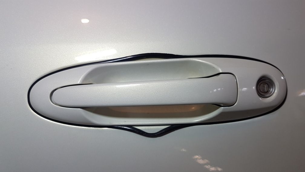

The benefits of Krown rustproofing have been discussed here. Krown-ing a vehicle does have some disadvantages as well. First, it requires drilling into doors and door jambs. Secondly, the undercarriage will attract dirt and working on the vehicle becomes less fun.
But the real problem arises when Krown comes into contact with rubber and plastic.
Our 2000 LX470 has been Krowned since 2005. Because we do not drive this vehicle a lot in the winter, we probably had Krown applied about 4 or 5 times since then - and maybe 1 or 2 more times on the undercarriage only.
Despite skipping a year (on average), rubber and plastic materials have swollen over the years. After replacing my headlight bulbs, I was unable to re-install the cover as a result of excessive swelling of the gasket. Especially softer rubbers become very gooey. Before the application of the Krown, silicone is applied to the rubbers. But this is only a temporary barrier. Krown will continue to ooze out from the weep holes and attack the rubber.
This is not a complaint. I just wanted to give a heads-up to anyone considering a Krown treatment. Going forward, I may decide to only have the undercarriage treated and not the body. Some Krown shops have offered to do this for a reduced price, but lately they seem to charge the regular amount.
Here are some samples of what to expect.

Door handles:

I like the idea about this kind of treatment, but that kind of damage isn't ok. Any issues with rubber parts under your truck?
Haven't found any issues. Maybe because the undercarriage gets washed off more? The trim around the headlights for example is the perfect spot for the material to pool. Also, the bushings are probably made to be oil-resistant.

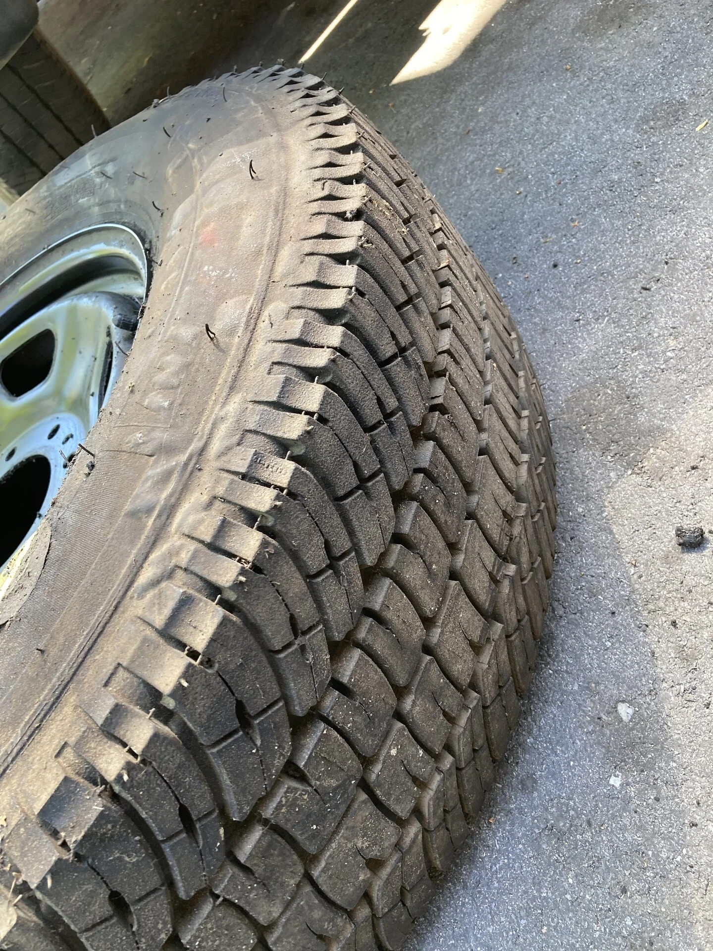

Has anyone have issues with spare tire mounted under truck after Krown spray. Mine now has several small bubbles on the sidewall that got Krown on it.

Never seen this, but I always removed the spare tire and kept it inside the vehicle till the dripping stopped. What you are seeing does not surprise me it if it pooled on top of the tire. I recently replaced the headlight trim shown in the first picture in post #1. The trim has rubber parts and the Krown had turned it into a chewing gum like substance. I noticed the rubber gasket material underneath the doors is also sagging. After the reading the responses in this thread I started using Fluid Film and have not looked back.
