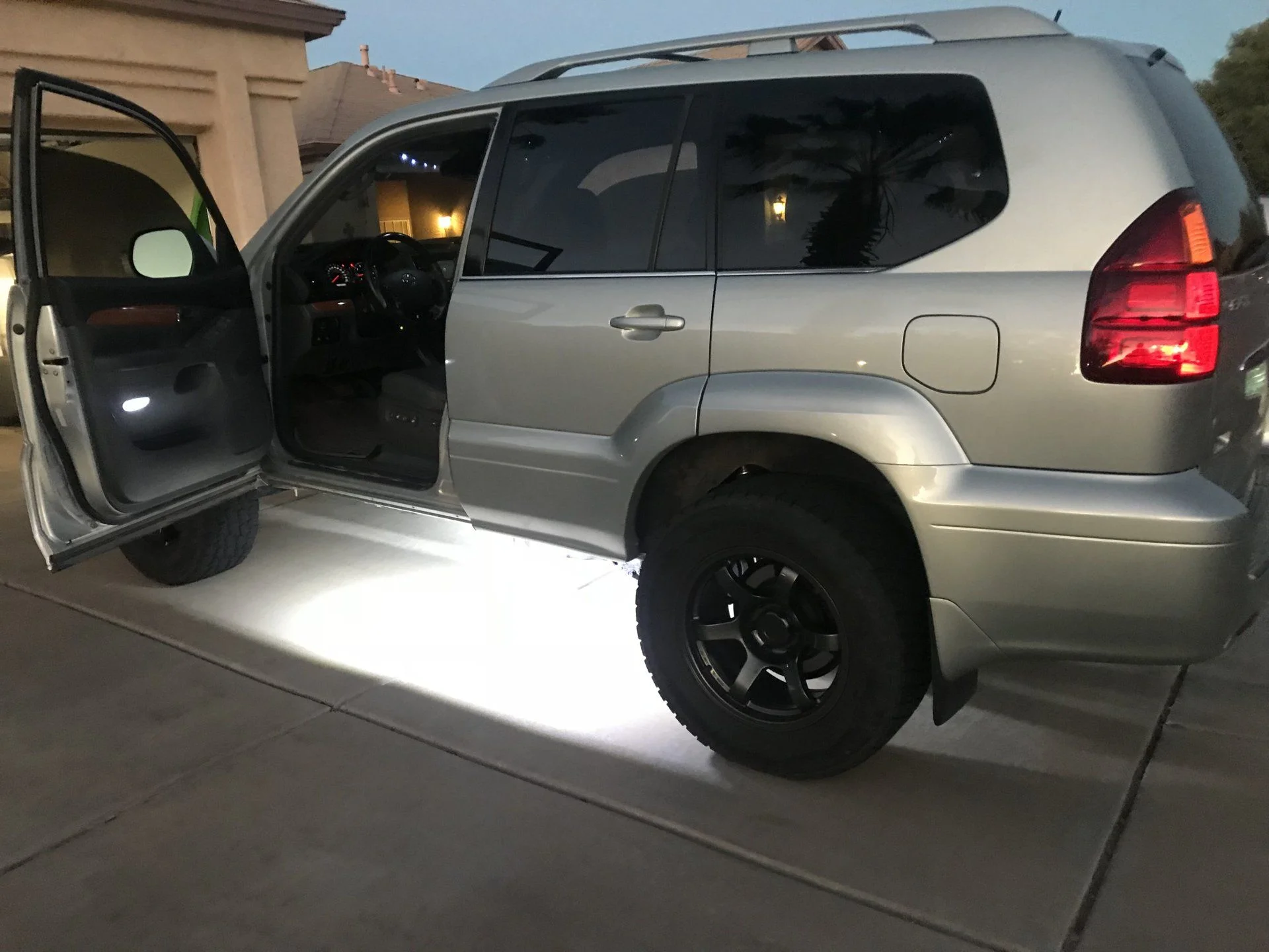

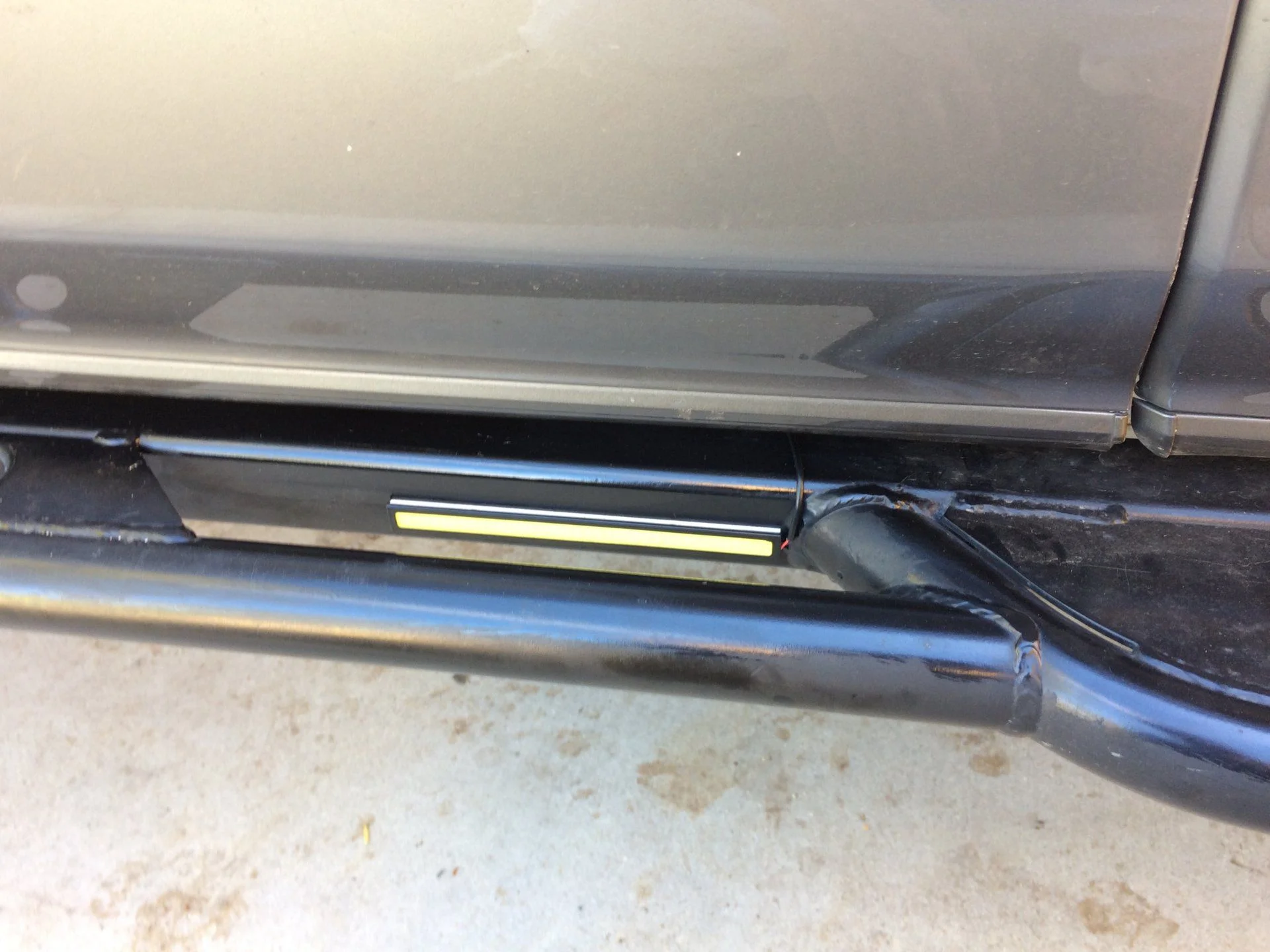

I just stuck some cheap OPT7 LED strips to the frame and spliced into the factory wiring for the door lights. Works great! I think there was someone selling an adapted harness on GXOR to make it super simple. *edit* found it: Josh Lee
Mine did. I cleaned the frame with some purple degreaser then some windex and stuck it on once it was dry. Have been on for almost a year now.
Could also hot glue some heavy earth magnets like Josh did.
Yep - we are working on a plug and play solution. :)
Did the same a few month back, using 3M, and no problems so far.
But sometimes I wish I could add a switch somewhere, to turn the lights off with the doors open.
Two of my LED strips have died already. I'm going to replace them and see if I just had bad luck..
I mean, for $16 who cares. Haha
The next ones are going on with magnets - I did adhesive at first. I don't mind replacing them annually if need be, but I want magnets if that's going to be a habit!
look into rare earth magnets - stronger

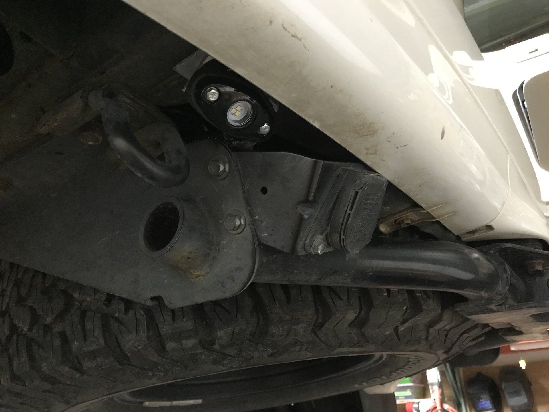

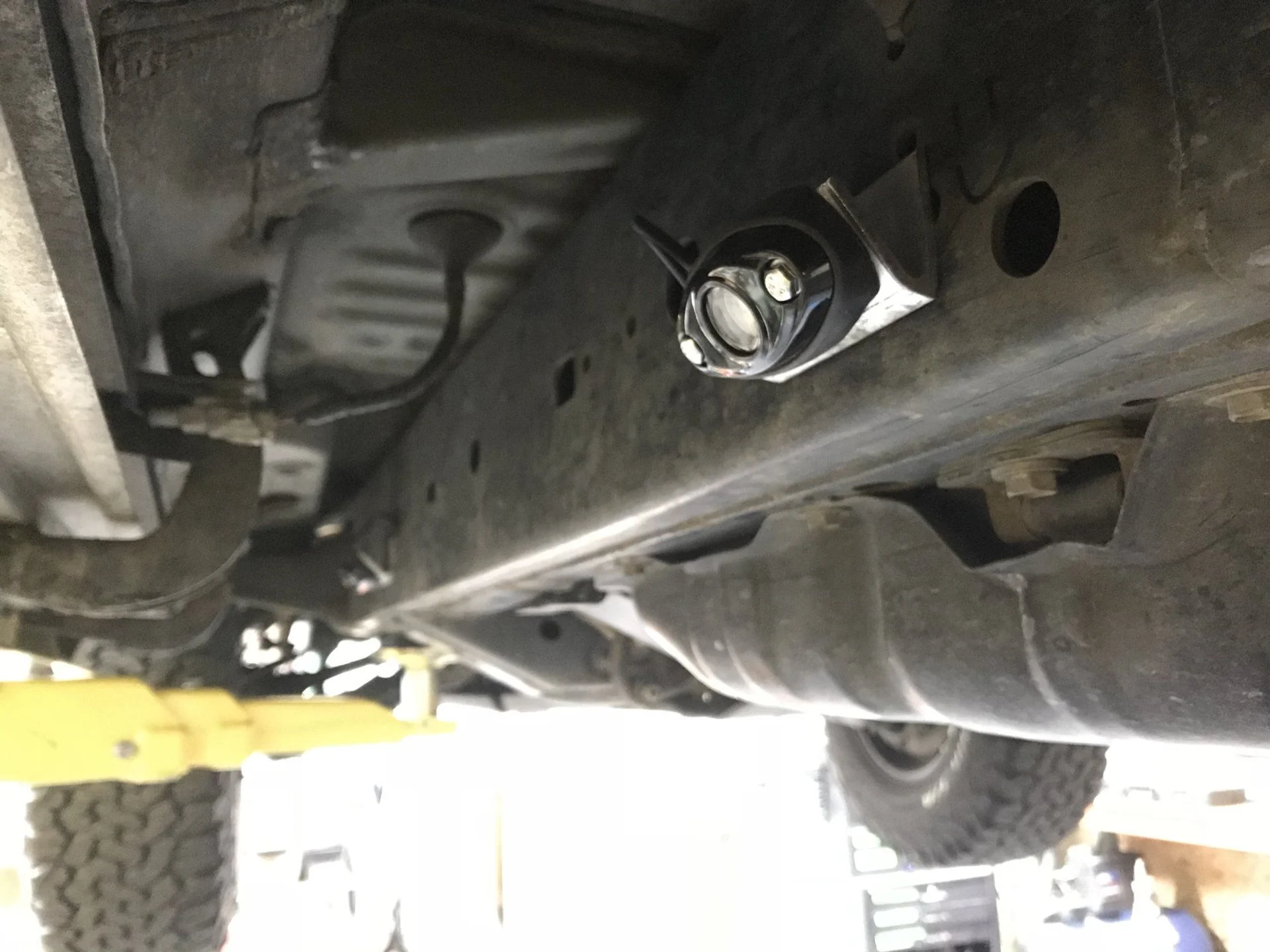

Sliders are soon to come but in preparation I picked up the OZ USA rock light kit for install. I used an aluminum “L” piece cut in to 2” lengths and bent from 90deg to about 45deg. Used self tapping screws to mount the brackets to the frame and rand the wires inside the frame rails. Two lights on the rear and one under each door. More pics to come.
Oh, I wired to my Switch-Pros controller. Plans to wire into the factory courtesy lights at some point.
